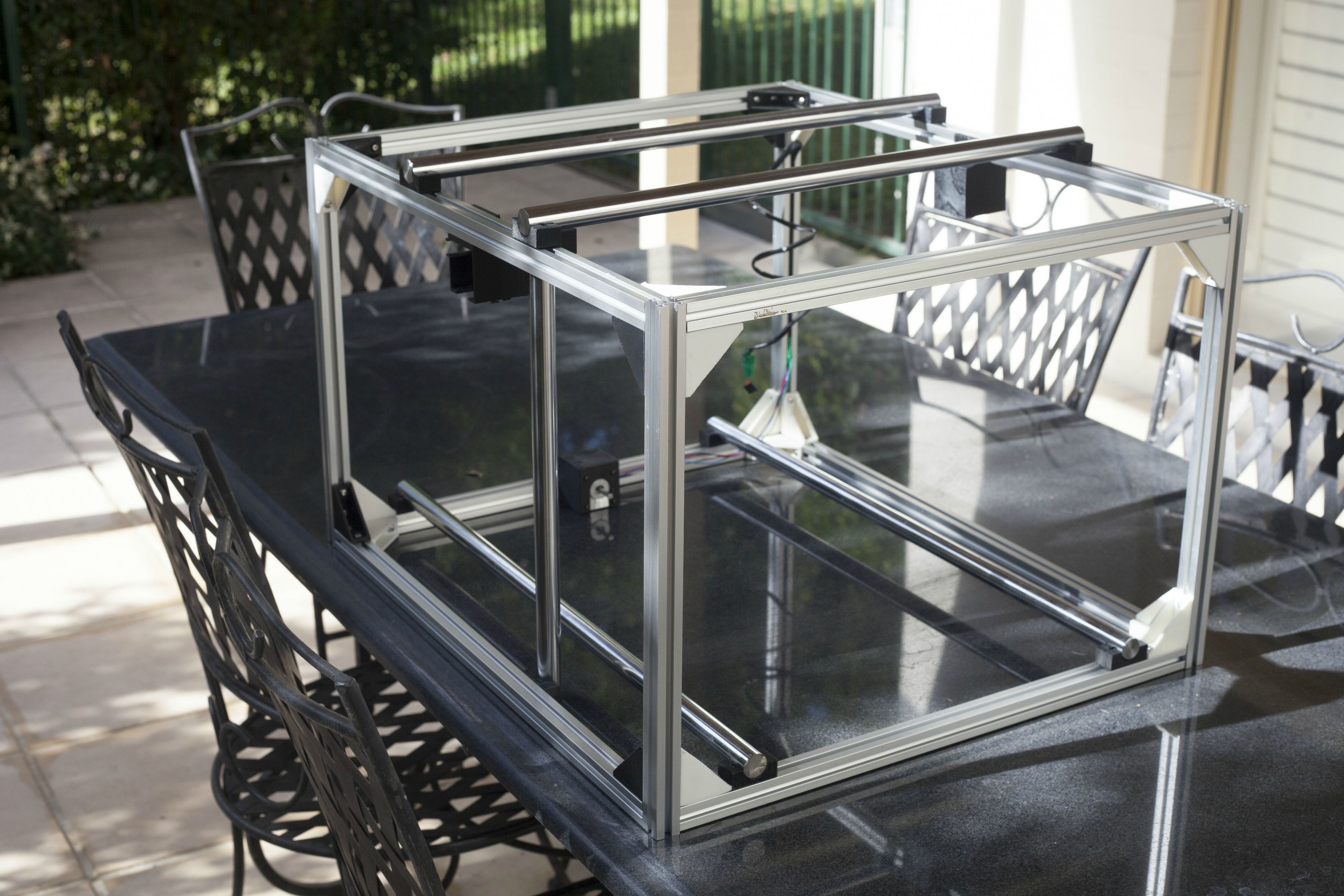

Its frame is made of 20x20mm aluminium extrusions. It will use 20mm rods with LM20UU bearings. The fame will be simular to what is shown below except there will be 2 rods on each side for the Z axis.
The 3d printer arraignment for the build will use a piece of 10mm wood for the y axis base with a Mk3 heatbed attached. The extruder will be a Mk8 extruder.
The mill attachment will use a dremel flexishaft as the tool head.
The plasma cutter head would be a from a ROSSI Cut-40.

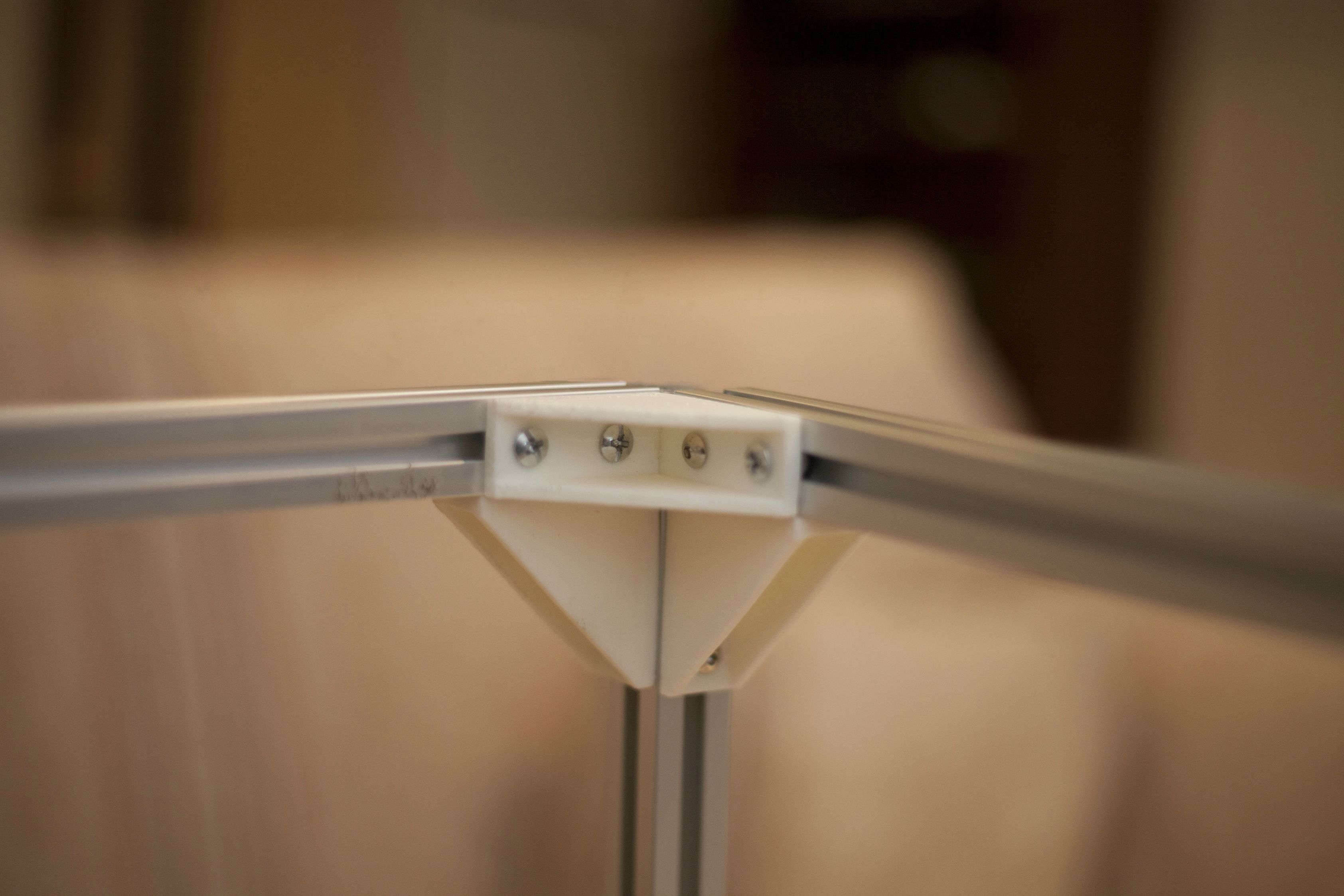

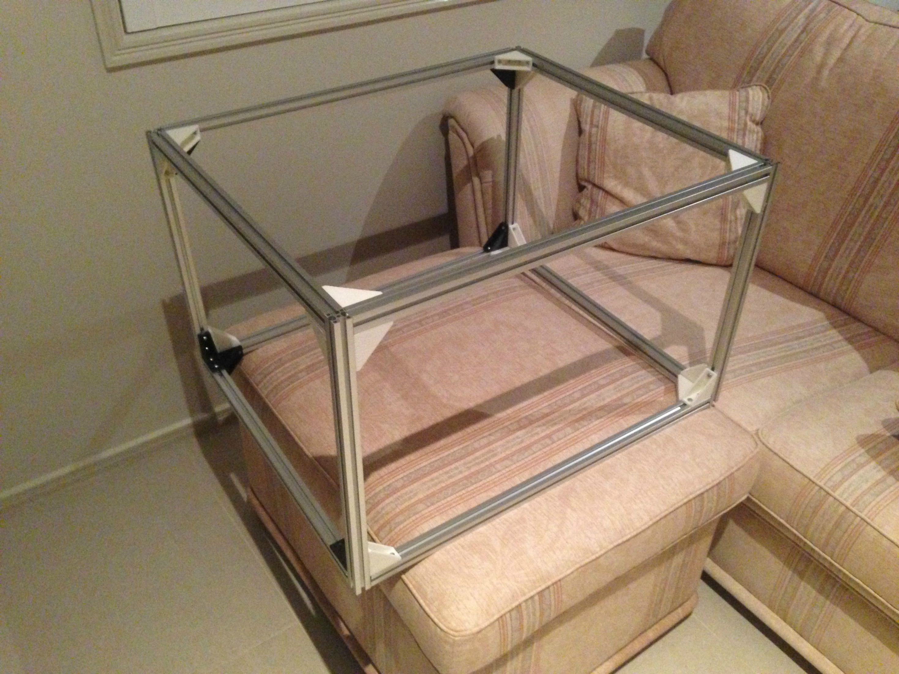

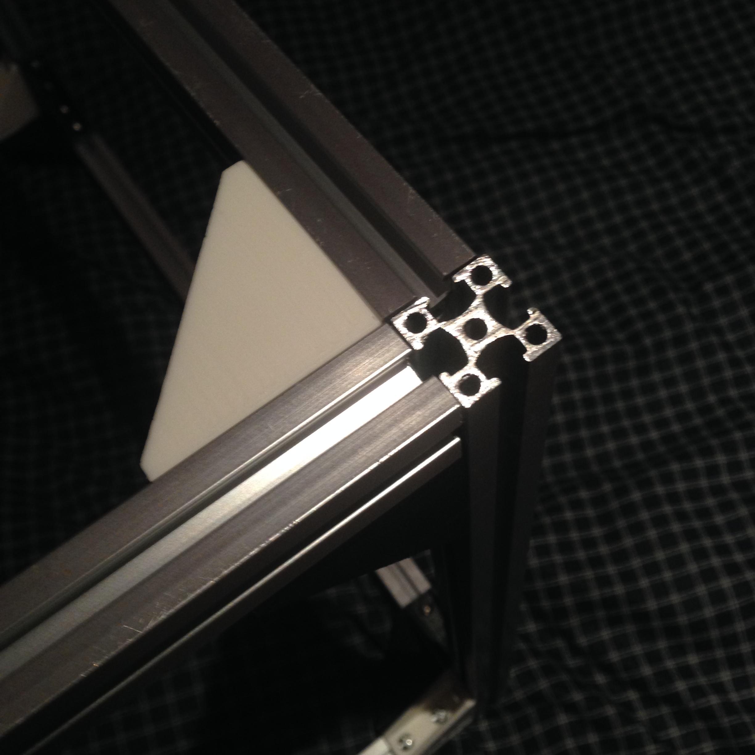

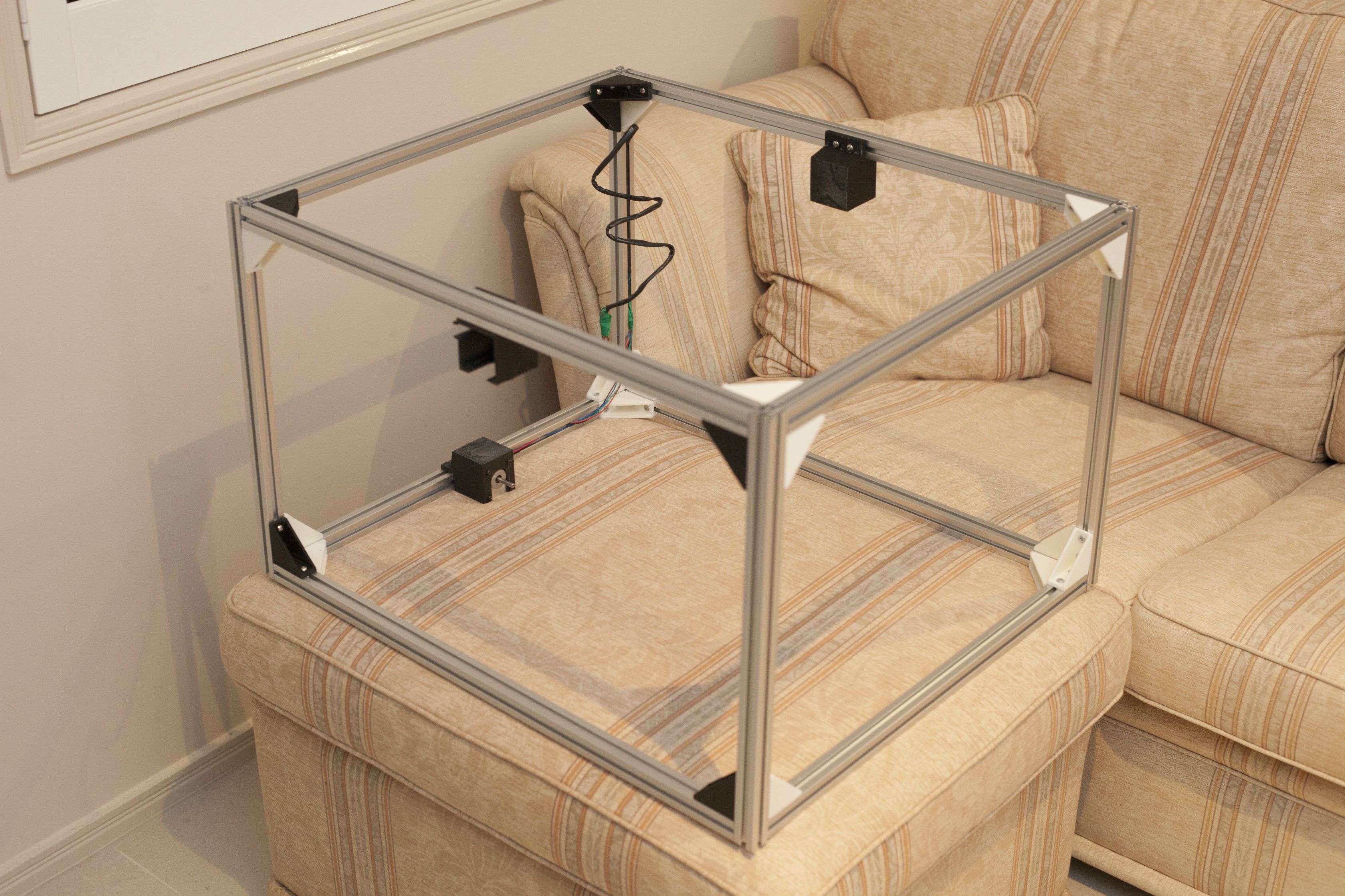

So far the aluminium extrusions have been assembled as shown. I used https://www.thingiverse.com/thing:59398 to connect the extrusions together. It was very fiddely with each piece being interconnected. I used M5x10mm bolts and M5 nuts for half of the brackets and I used M4 Slim T-Nuts and their M4x10mm hex screws from Core Electronics for the remainder of the brackets.

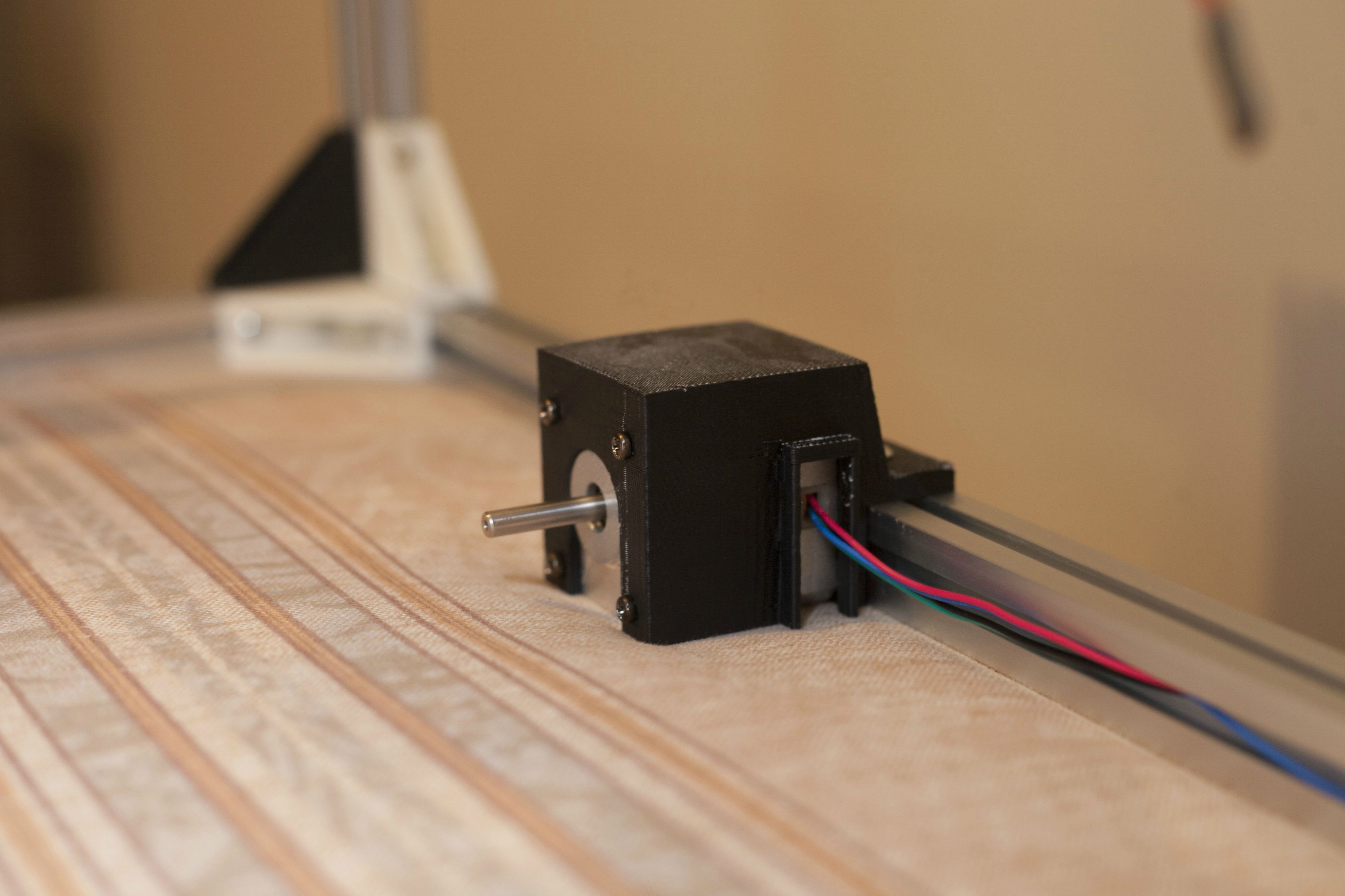

Designed Motor mounts. http://www.thingiverse.com/thing:890083
Printed Motor mounts and attached them.
Added the 20mm rods.
