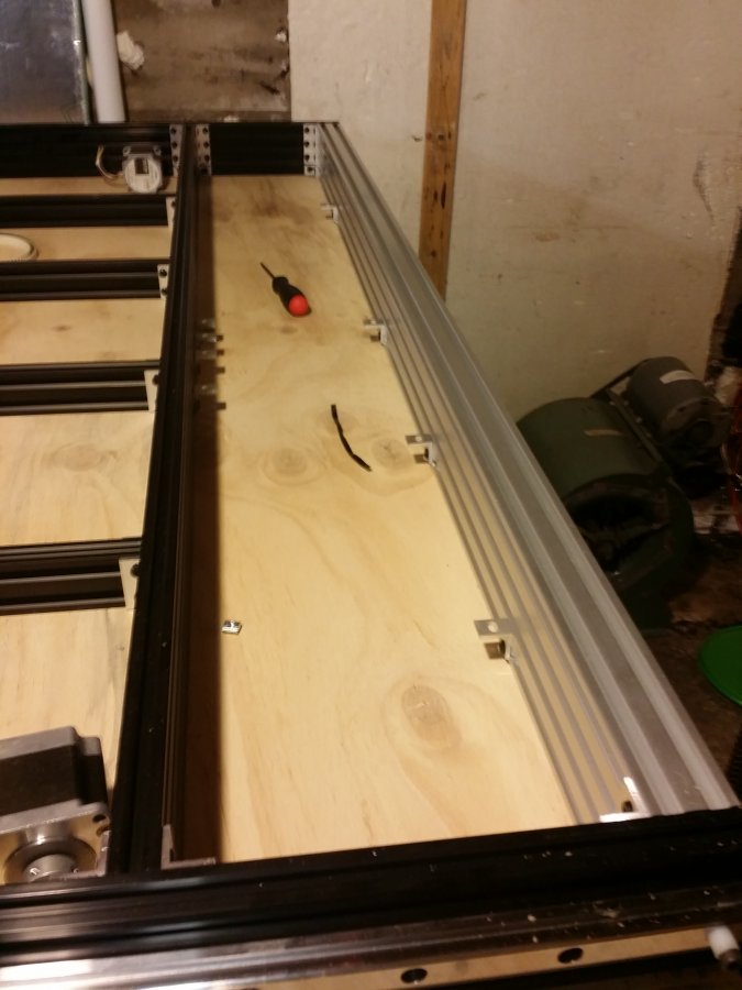

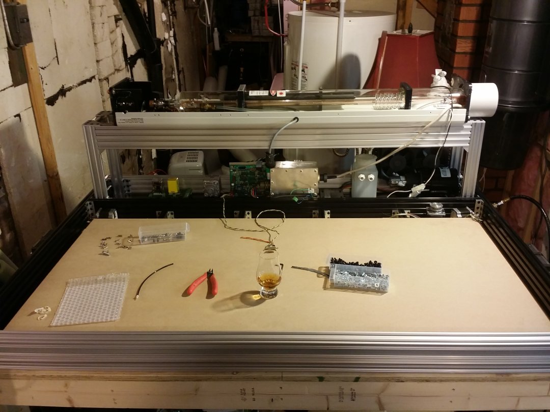

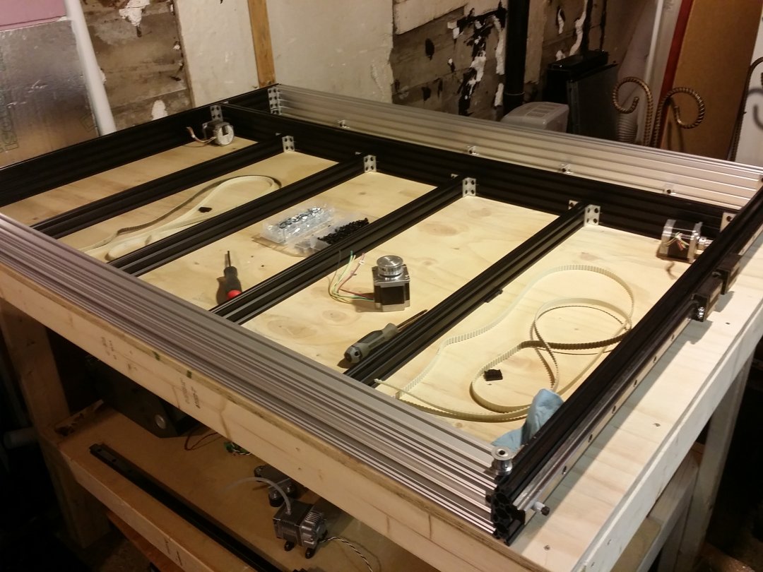

This is the base frame for the CNC assembly. The power supplies, pumps, electronics will be on the back, with the laser tube over it (on it's second floor (to be made)). The gantry will be powered by 0.9 degrees stepper on linear bearings.

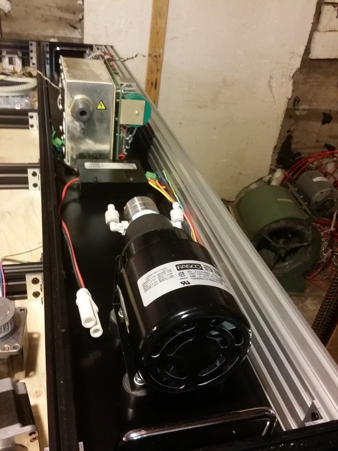

This is where the electronics will sit.

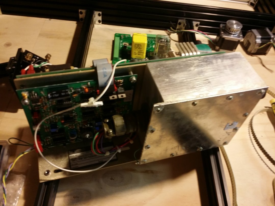

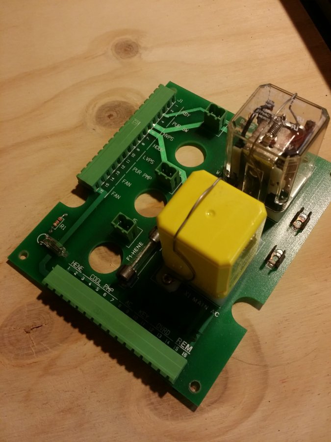

This is the AC breakout board, I did not back-engineer it yet, but it takes 120V and split it in different outputs! The yellow relay is time delayed and the other one might be connected to the security key.

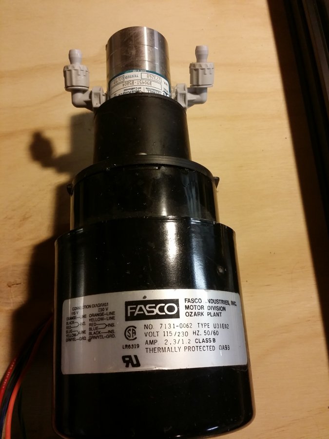

This is the oil pump used for cooling the laser tube. Note that this tube is actually OIL cooled, not watercooled. I don't know if it is just to prevent evaporation or because it cools better.

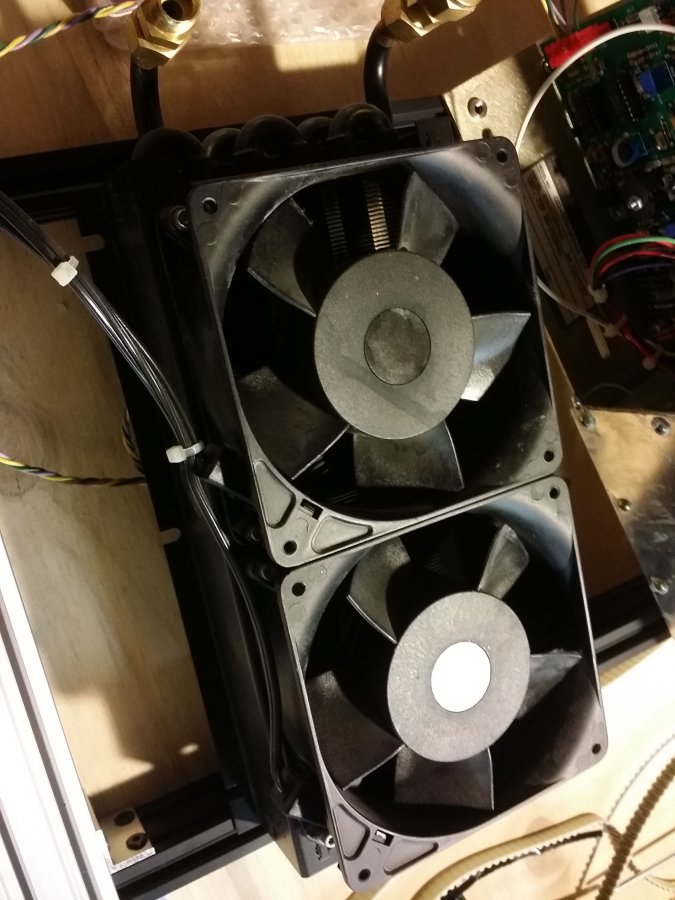

This is the actual chiller. I will mount it on the back of the frame pushing hot air outside (I will have to separate the cutting zone from the electronics zone to prevent fume and whatever particles to get everywhere)

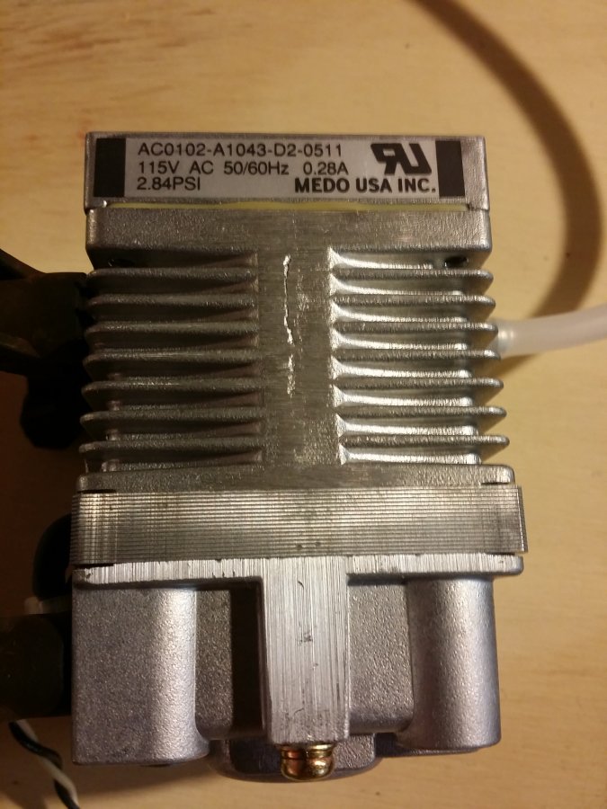

This is the air assist [air] pump to prevent fume to go in contact with the focusing lens. I will have to add an inline air filter to remove humidity. I might replace it in the future with a CO2 tank with a regulator. I might have read somewhere that laser prefers to travel into CO2 than into air (less particles, less humidity)... Yeah, I know, the beam coming out to the laser, reflecting on the mirror to the laser head isn't in CO2, but you know... just because

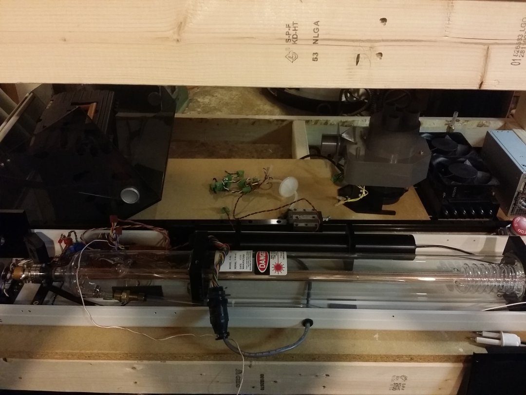

The actual laser tube, which I will leave in its cradle to keep alignment and adjustments with the HeNe Laser (red laser pointer, the black tube on top of the CO2 tube)

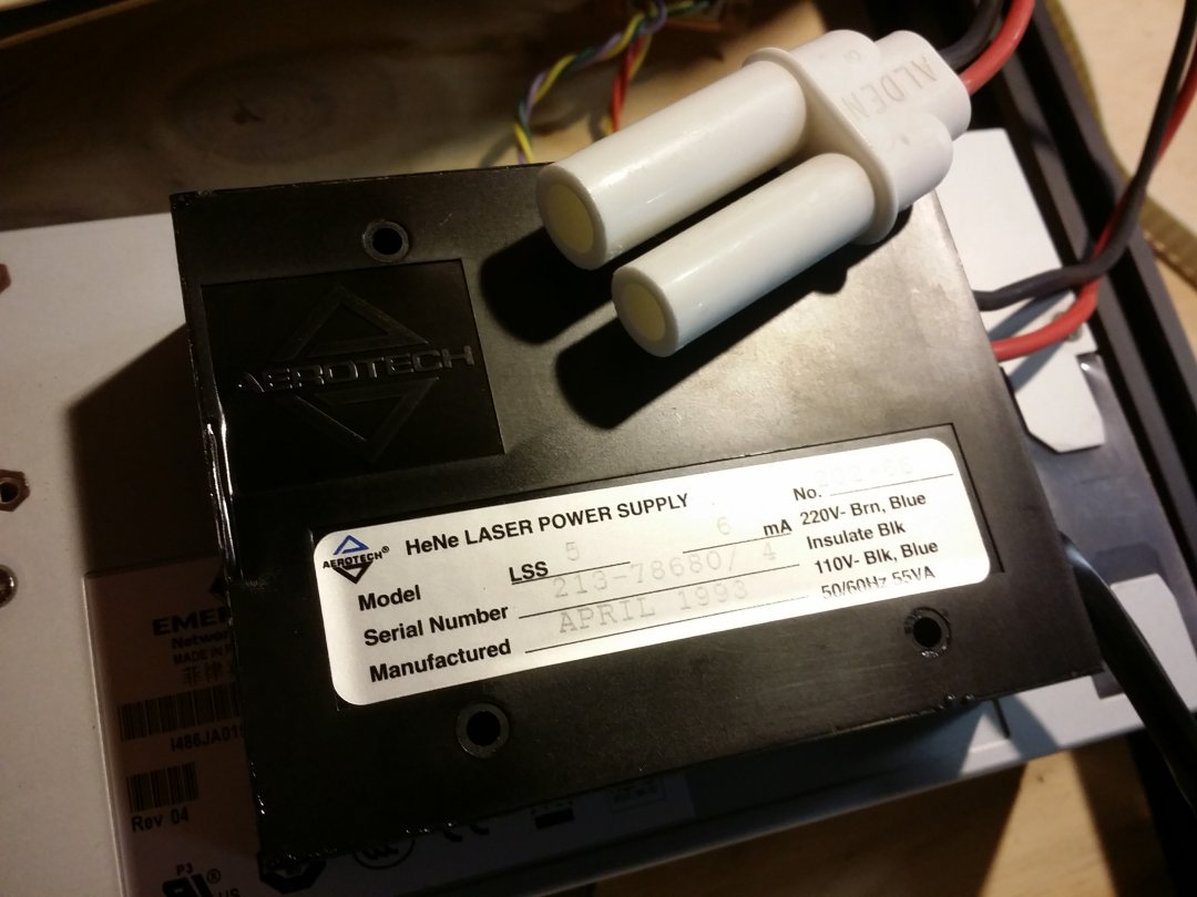

This is the high voltage power supply of the HeNe laser

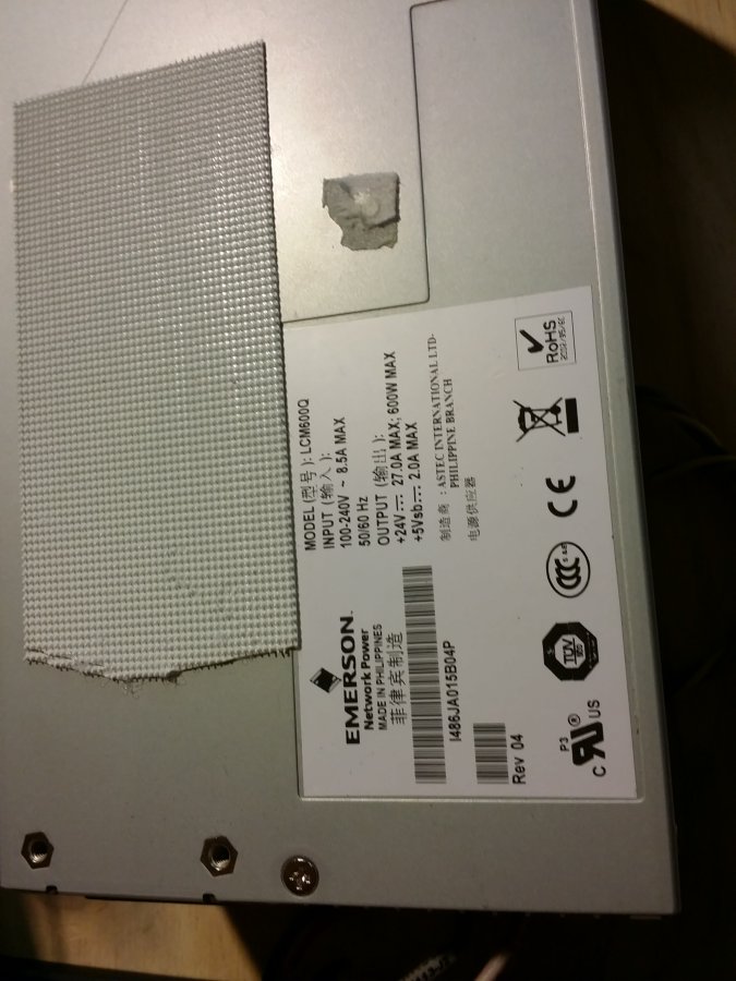

Finally (for now), the low voltage power supply that will be used to get some juice to the stepper motors.
Here are most of the components mounted to a steel plate, a lot of wiring to come...

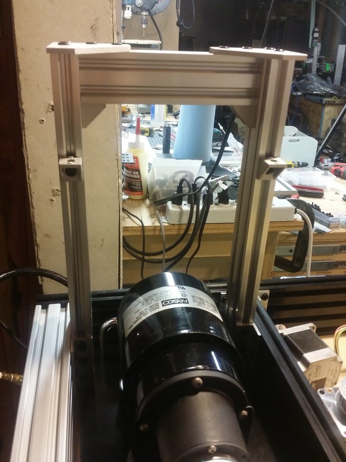

Here are the pillars to support the laser cradle:
Laser tube assembly is now mounted, I Might have to add a mirror to lower the laser beam.
To be continued...
