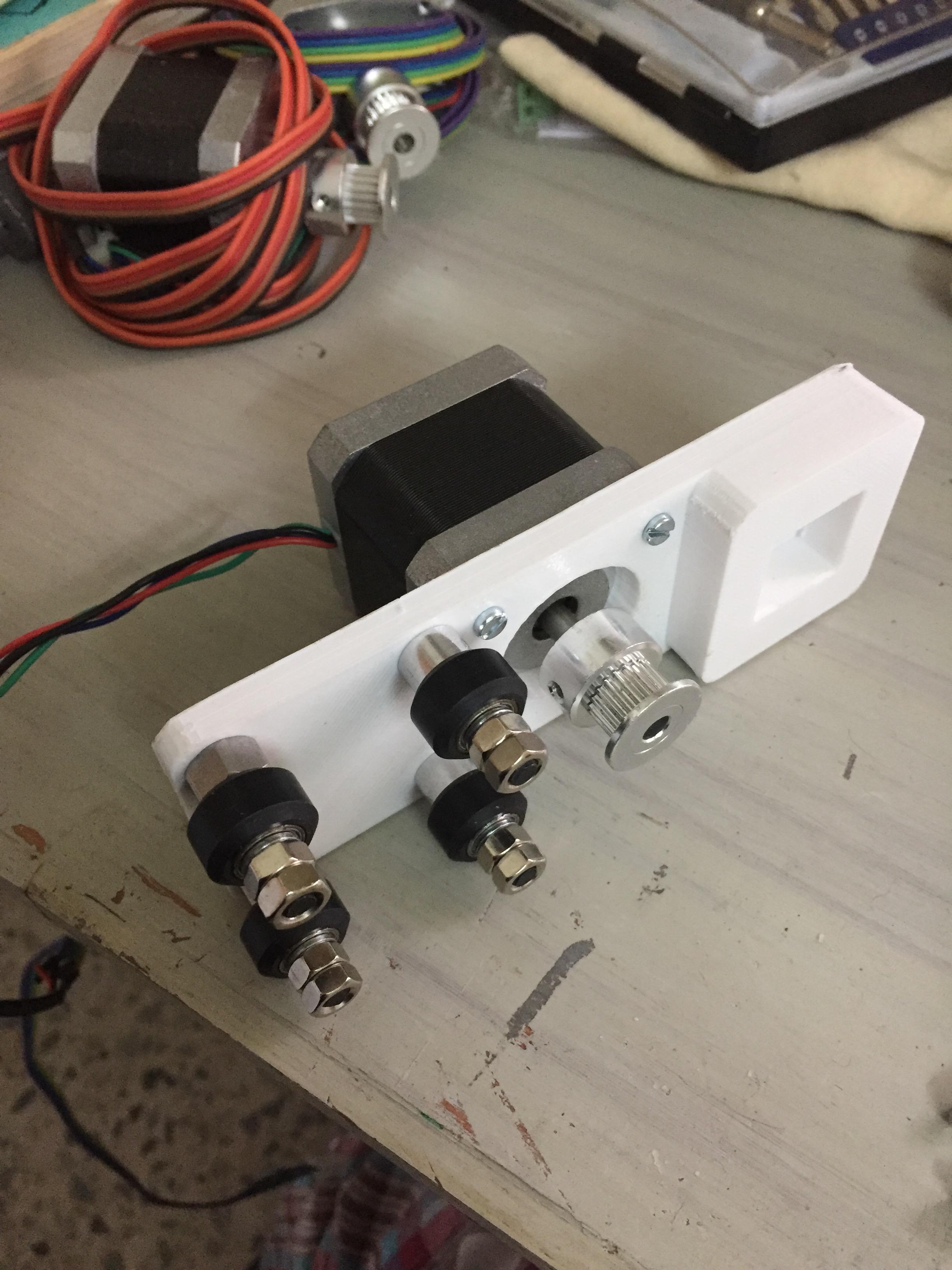

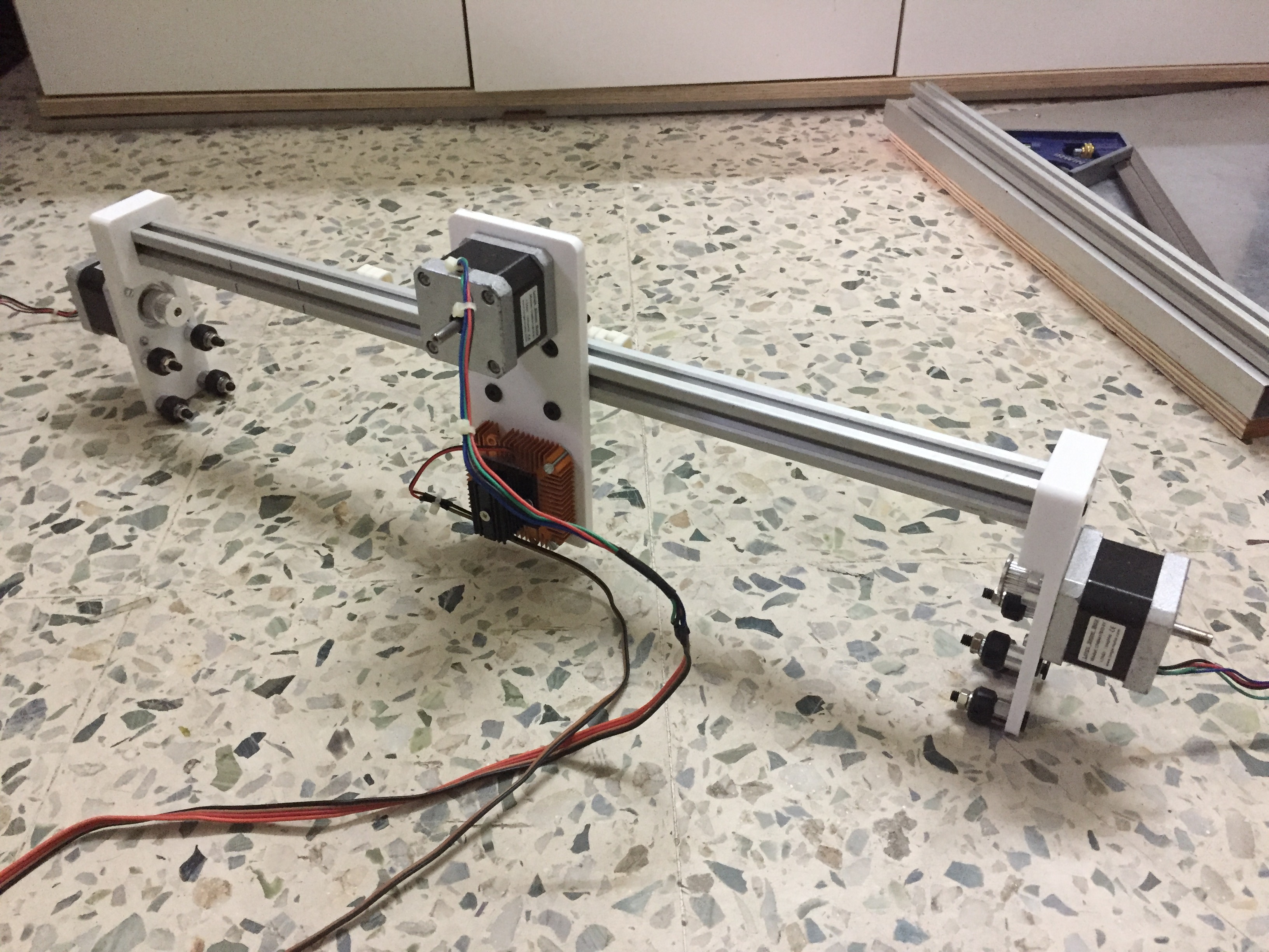

      I started off by assembling the Y-axis motor mounts. I first assembled the 4 M5x30mm screws followed by eccentric spacers on the bottom two screws and 1/4 in aluminium spacers on the top two screws. Even though the eccentric spacers have grooves on them I marked them with a permanent marker just to make it more visually accessible.
      Though I've not put any shims between the eccentric spacers and the wheels in the model that I built, it is recommended that you do. The 3D model also shows aluminium spacers at the end of the screw which are optional. If your M5 nut is smaller than the wheel then this spacer is not necessary since the nut will not obstruct motion on the rails. The last step is fixing the stepper motors using M3x10mm screws. The GT pulley will go on the motor shafts after this. Note that the pulley width needs to be aligned with the width of the wheel to ensure the belts are straight on the rails.
      The finished Y-axis assemble for one side. I had initially used two M5 nuts at the screw ends but eventually I removed one of them since I didn't quite think they were necessary. You could also use a shorter screw length.
      After you've built the second side of the Y-axis, you'll need to link the two sides using the 2020 V-slot. However, before you do this, you'll need to insert a single M5 T-nut on either side. These essentially help you screw down the endstops in place. This is important since if you do not do this, you'll need to disassemble the two sides, add the nuts and then reassemble which I'm sure would be quite a painful and tedious. Secure the X-axis 2020 between the two Y-axis gantries with a M5 10mm screw on either side.
      Next you'll want to slide the Y-axis rails and slowly turn the eccentric spacers inwards to snug the wheels on to the rails. Do not make them too snug. I follow a simple rule: while holding the rails if you can turn the wheels with some effort then you've snugged it right.
      The X carriage plate is done the same way. Here the rail hugging assembly lies between the motor and the laser mount.

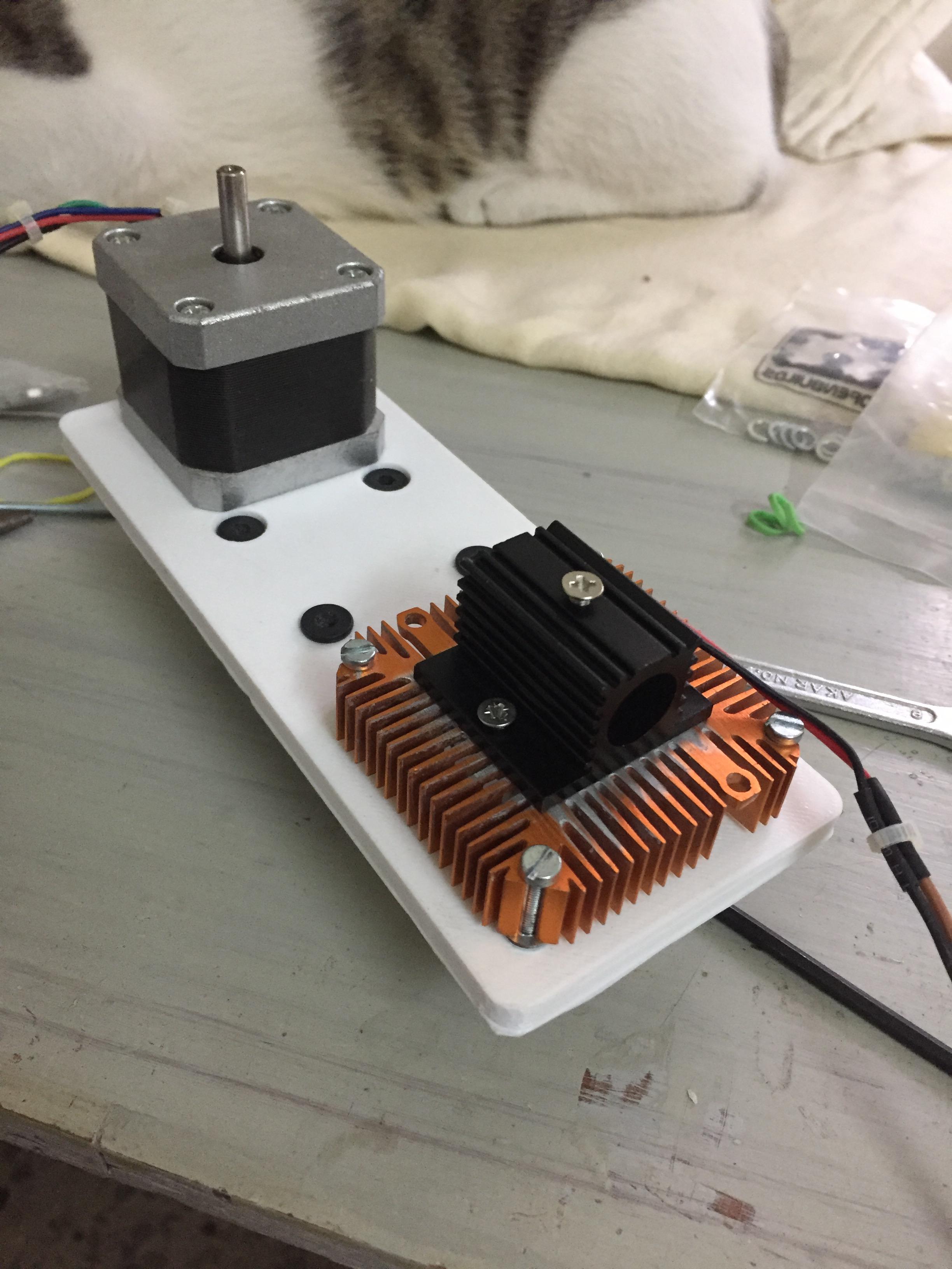

      The Laser
      I bought my laser from DTR. I blew out one laser during testing and got a different model the next time. This particular model becomes a very expensive LED when the current limit is exceeded but goes back to lasing when the current is within limits again. Make sure you get them in a copper housing with a 2-element lens and the 12mm Aixiz mount. This also comes in a 3-element glass which is cheaper but not recommended since there is significant loss in power transfer. I also got a heatsink with a fan and attached the laser mount to this using M3 screws. If you are going the same route to assembling your laser, I suggest adding two M3 washers between the heatsink and the X-axis mount plate. This is because the fan on the heatsink sits slightly higher than the top edge and the washers allow the requisite clearance.
      The finished laser assembly is shown below.

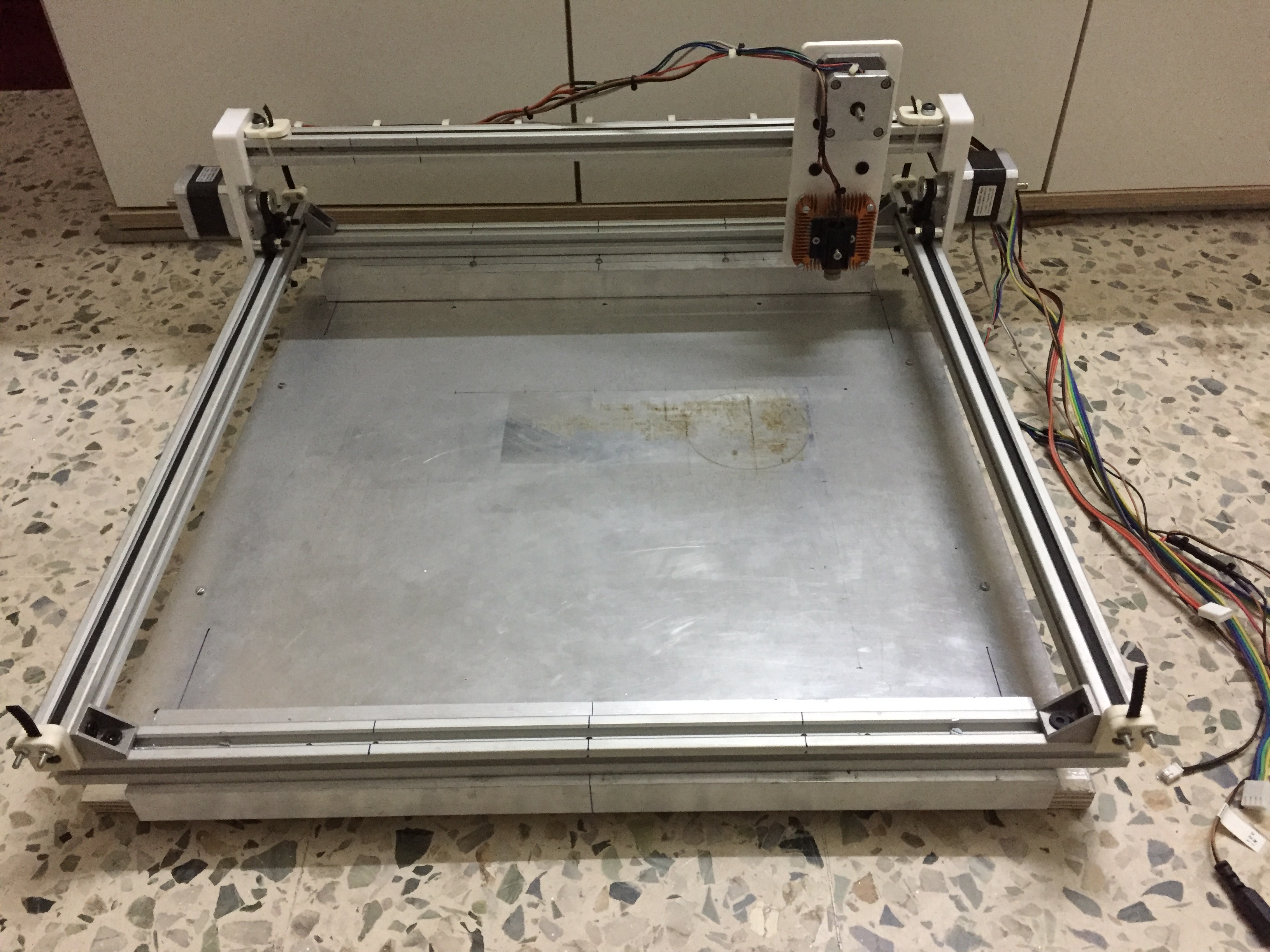

      The Frame
      Once you've made sure there is no play between the rails and wheels, its time to square everything and put it together. Though the design suggests the use of 2040 rails parallel to the X-axis 2020 extrusion, I didn't have any so I used regular 2in x 1in hollow aluminium bars and these worked out just as great and they were cheaper as well.
      I used corner brackets to align and join the extrusions at right angle. Some might differ with this approach with the argument that there might be play in them at a later stage. However, they seem very nice and tight without any loose couplings. Note that these brackets come with ridges on either side since they are meant to hold two extrusions perpendicular to each other with their slots aligned. Which is why I had to file off the ridges for one side. For the moment they seem to hold good. Use M5 6mm low profile screws to secure the end brackets.
      'Scout' tests wire integrity and verifies that everything is squared up.
      The finished assembly.
      Note that the entire system sits on an 1.5mm aluminium sheet screwed to a 12mm sheet of plywood underneath it. This makes it somewhat heavy. The assembly shows end-stops from Much 4's build since I already had them from an earlier version and didn't want to print them again in the interest of saving cost.

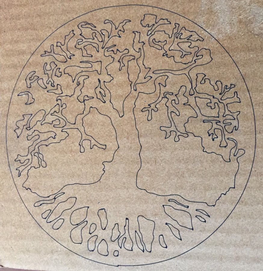

      This build in action

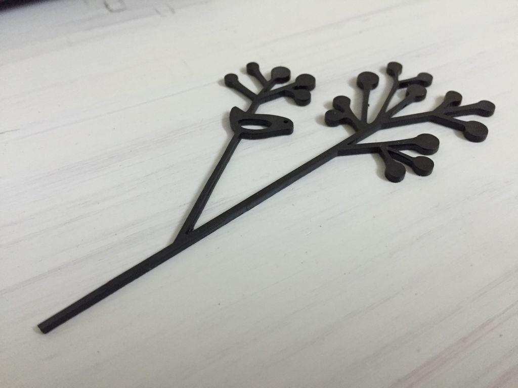

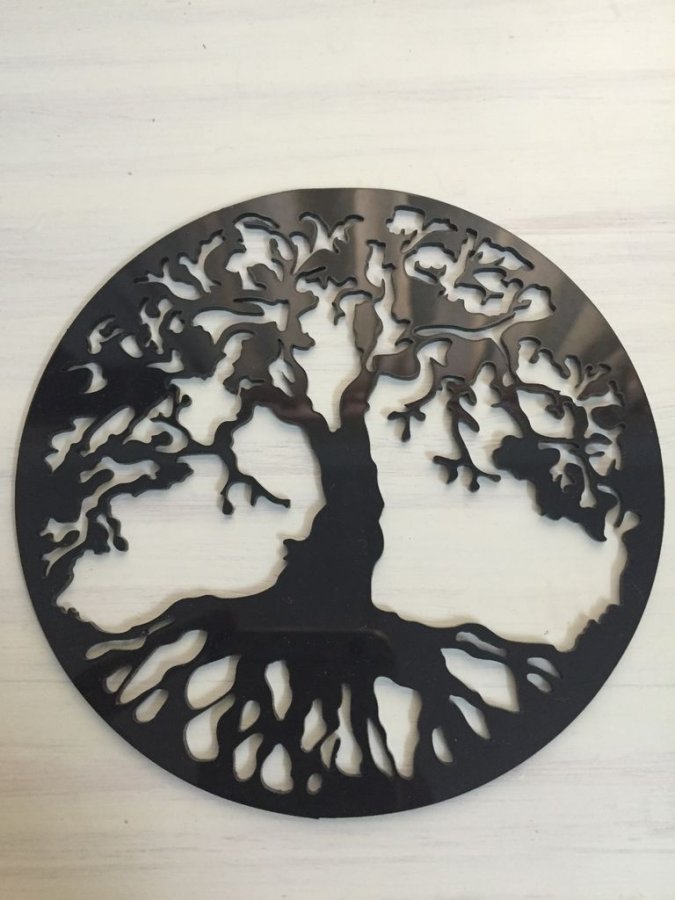

      A few samples from what I've engraved/cut with this build. The plastic took several passes but came out nice and clean.
