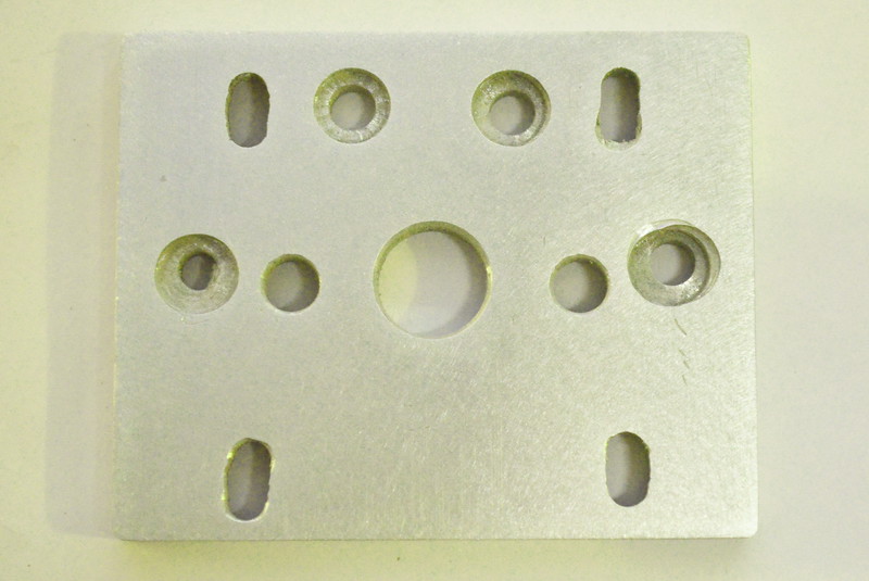

The first plates I cut were for the z axis. I hit the center of the template holes with a screw after rough cutting them. On the longer ovalish holes, I drilled two and connected them with my scroll saw. Not all turned out pretty. To finish them up, I sanded them to the lines on the templates with 80 grit and a benchtop sander. Then I tried to make them pretty with a random orbital and 120 grit. This also knocked down the edges so they were not sharp. I used a 3/8" endmill in the drill press to make all the countersunk pars of the holes unless the screw needs to adjust in spacing, then I used a 7/16" endmill.
Finished:
z bottom with 8mm pillow block bearing.
I did the z plate and the x plates the same way. Then I did a test assembly and found my hole spacing was a bit tight so I re-drilled the 5mm holes with a 6 mm bit which did the trick. I used a 19/64 bit for the eccentric spacer holes.

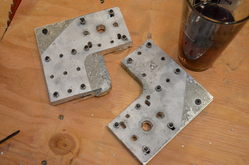

When I got to parts that needed to properly line up, I cut two plates the same size drilled them and tapped one of them with a 5 mm tap. I then screwed them together (screws were countersunk) then repeated the cutting/drilling process.
I was only able to cut so far on some with the table saw. Then, I switched to the scroll saw with a metal cutting blade. With a lubed blade, it cut surprisingly fast, and well. The beer helps steady the hands. Plus it's Portland--You can't do anything without a delicious craft beer.
I bolted the plates together so I could cut off the angle piece the original screws were in with the chop saw. After cutting that off, I used this sander to sand everything down to the template lines. The multiple screws kept the pieces level on the sander.
Voila
After sanding
These scared me the most, but they seemed to have turned out.

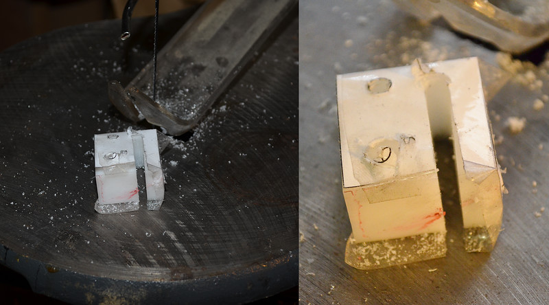

As a side bet with myself, I bought a piece of White Delrin ® Acetal Resin Sheet, 3/4" Thick, 6" x 6"
(McMaster-Carr) for about $19. I figured, if successful, I could make many 1/2" ands 3/8" nut blocks for the price of one. To tap them, I cut small pieces of each rod and, using a metal cut-off saw (abrasive blade) and a jig I made to hold the rod and keep my fingers, I made my own taps by cutting grooves across the threads. The 3/8" works, but I am concerned about the 1/2 inch. I may have to rebuild that one.
So, on to the home made 3/8" nut block. I cut the blocks to the size I chose (copying the openbuilds template somewhat) then drilled the required holes after taping on the paper templates. For the rod hole, I drilled it slightly smaller than the 3/8" rod.
For the slot, I drilled a hole at the inner end then used the scroll saw to connect it to the edge.
Finished block

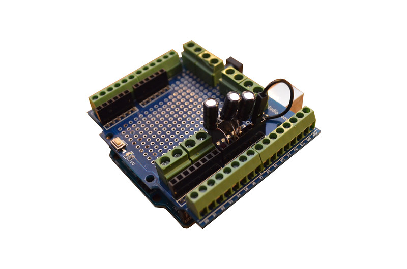

I got a little more done today. I soldered on the additional screw terminals to the screw shield As pictured on the previous post. The top looks decent, but the bottom is not as pretty. However there is continuity throughout all the grounds. The pins on these screw terminals I installed (the six not professional looking ones) are bigger than necessary so I had to ream the holes prior to mounting. Amazon.com: 30Pcs 2 Pole 5mm Pitch PCB Mount Screw Terminal Block 8A 250V: Computers & Accessories
Now I just need to track down some .47 uf capacitors.
8/23/2016-- I swung by Frye's today and grabbed some .47 uf capacitors. Rather than soldering them to the board, I removed some pin headers from an Arduino board I damaged, soldered that to the screw shield and connected it to ground. Then, I installed the capacitors to the ground pin headers and their respective limit switch pin header.
9/5/2016: I finished updating the electronics and put everything in a computer case. I made a z probe and I wired it up using an old car cell charger wire and an old headphone jack. Since I am using a computer case with a headphone jack, I used those existing wires inside from the jack as the z-probe wires to the Arduino board. I did the same with the USB wires. If I do hold and resume buttons, I will use the existing computer tower power and reset switches, as well. I am using a 36 V power supply so a "cheat" I did was to wire three 12v computer fans in series since an additional fan was cheaper than other options.

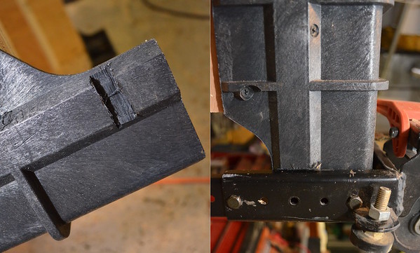

Then, I assembled the mobile base to the right size. I basically stretched this thing to the limits.
I had to notch out the plastic on two legs to get it to fit.
