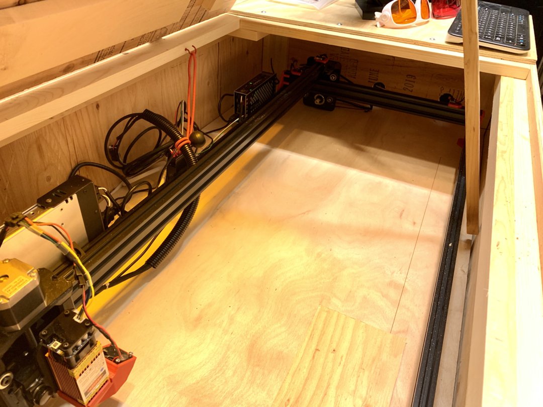

Finally, in mid-October I get back to my ACRO system. I mount the frame on a piece of 3/4" plywood and assemble/mount the BlackBox motion controller. At that point I decide to order a 24V Meanwell PSU from OpenBuilds rather than using an old no-name 24V supply or wiring two HP server power supplies into a 24V supply like I did for one of my 3D printers. By the time the PSU arrives, I had prepared a Raspberry Pi running the OpenBuilds CONTROL software to be my main GCODE sender. Then, I wire/test the steppers, 3D print some custom limit switch mounts, install/configure/test the limit switches, install a 24V-12V step-down converter, and mount/wire the 2W OptLasers module.

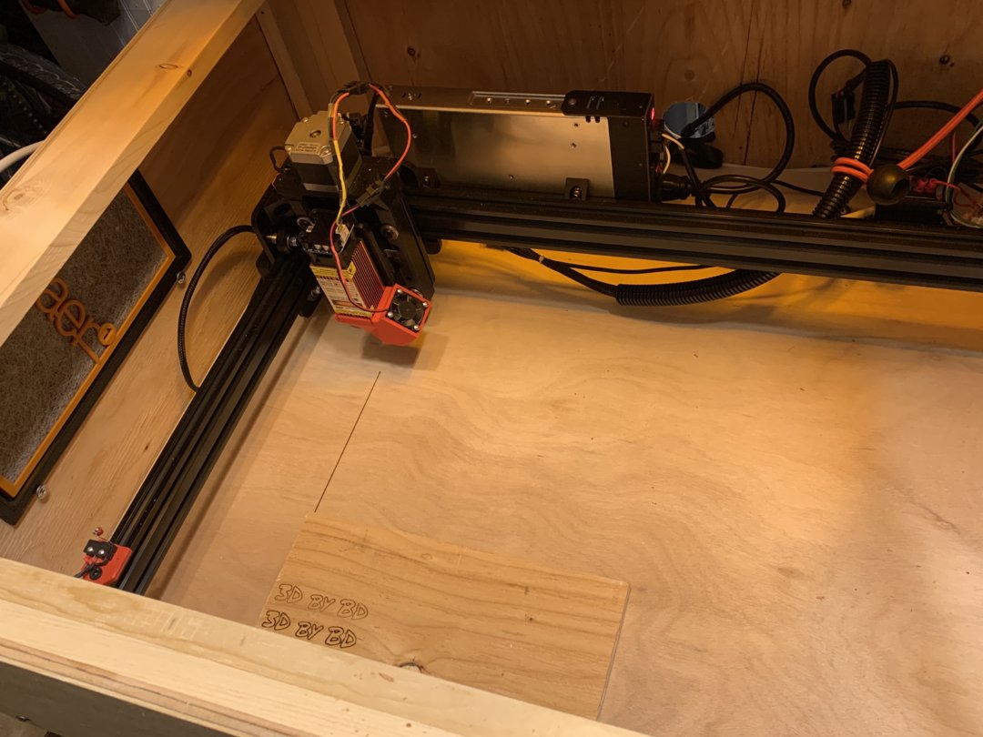

When I first tried a laser test, I did NOT see the light. The laser module was not activating, and troubleshooting quickly showed that when the laser module was turned on the 12V supply was dropping to 2V. Not a good sign. Fortunately, the guys at Opt Lasers have great customer service, but return/replacement shipping would take a while; so, I turned to Amazon and found a 4W laser engraver module with Prime shipping so I could get back on track with my build.

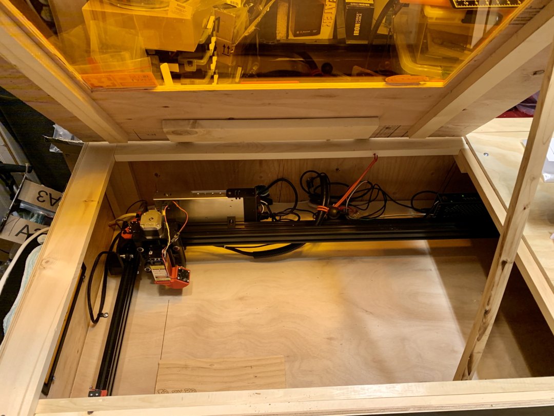

The new laser module arrived. I mounted/tested it/got it focused and was happy to start burning things. I quickly realized that I did not want to manually adjust the laser height each time my material thickness changed. So, I decided to make a custom Z axis rig which I have detailed in the forums: ACRO Z-Axis Mod
I made some tests on various pieces of scrap wood learning how different laser percentages and feed rates affect things. Then I cut up an old belt and do a test on leather.

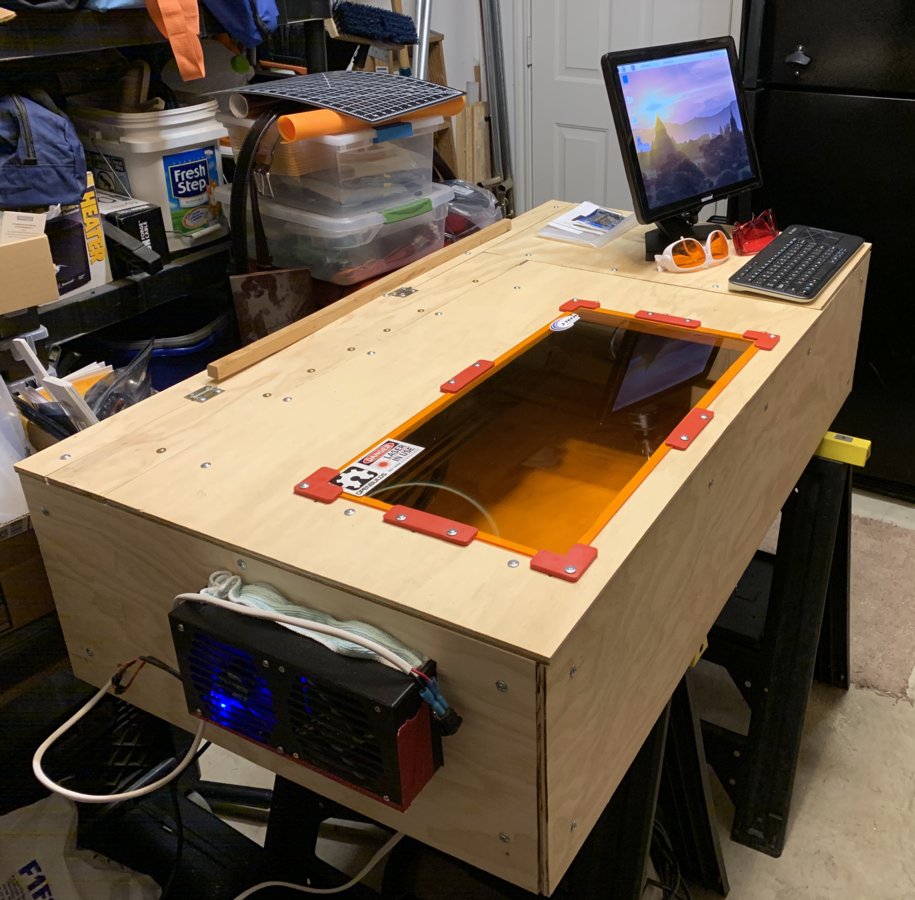

The engraved leather looked great, but the smell it made convinced me to take a break from testing and complete the enclosing box I had intended to build. I knew I wanted to build the box to protect people's eyes from the laser, but after the leather test I decided building an airflow/filtration system would be important, too.
I build the frame/box from miscellaneous leftovers from other projects (1-by framing, 5/16" plywood, random hinges, 120mm PC fans, etc.). The one new purchased piece for the box was a 12"x24" plexi laser shield from J Tech Photonics. I also 3D printed the fan/filter box and the plexi window clamps.

Two plus years in the making, I finally have a working ACRO 510 laser engraver system complete with enclosure and air filtration.
