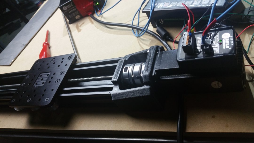

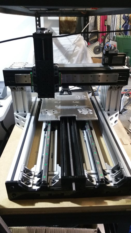

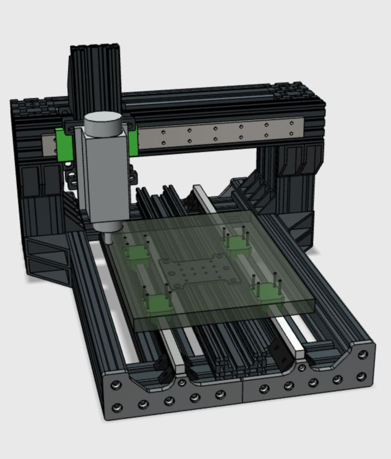

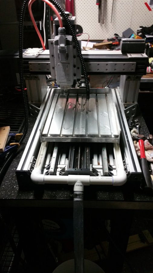

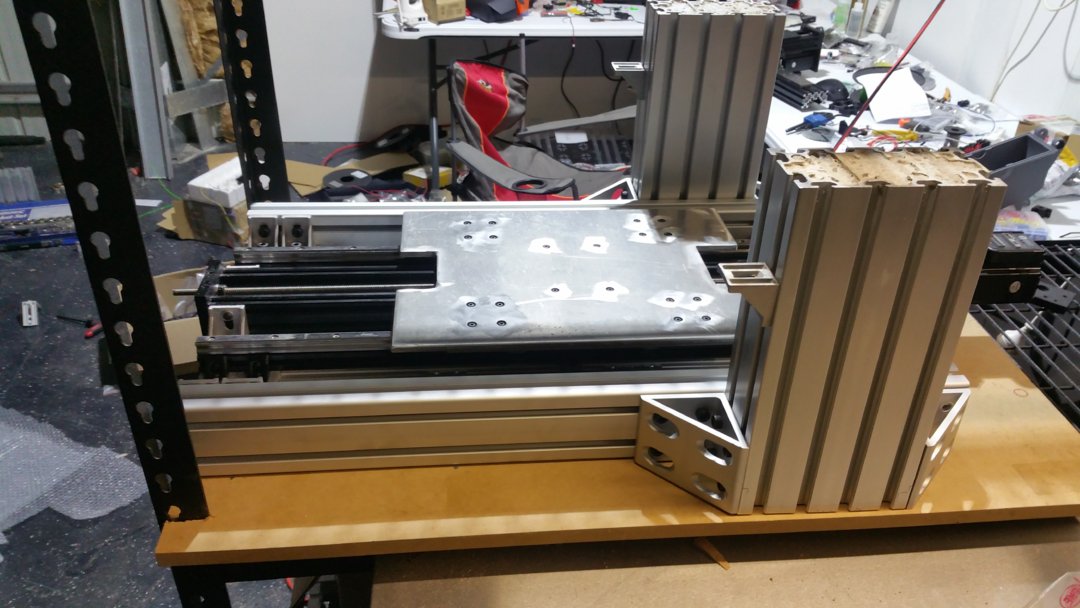

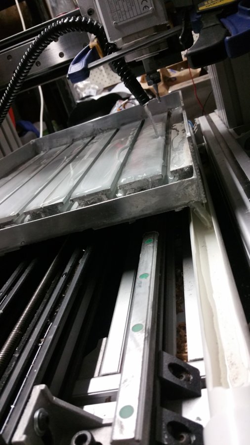

Hi all, this is my 1st time posting here on openbuilds but i have been planning this build for roughly 6months. Also would like the thank everyone for the ideas i might of gathered from your builds and i hope i can return it with my own design. I went through many changes and alterations with my design but have now collected all the parts and have started the build.
The build:
1. hiwin rails on both x y axis.
2. Intergrated closed loop servos

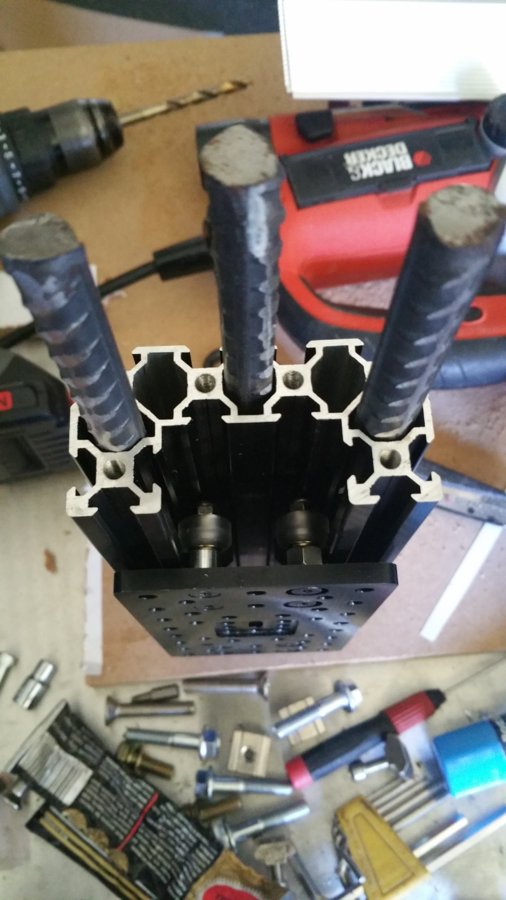

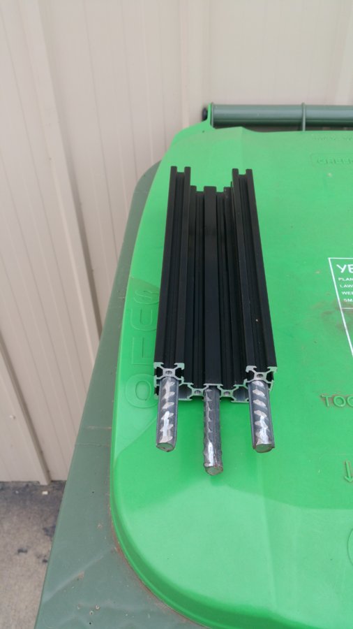

3. All profiles have been filled with 12mm reo bar, epoxy and grout. the machine will weigh around 150 to 200kgs.
4.1.5kw air powered spindle
5. all in one cnc controller
Behemoth cnc router with linear rails
Build in 'X/Y Table Style CNC Mill' published by dreys, May 8, 2018.
Behemoth cnc router build in progress using hiwil rails and closedloop servos.
