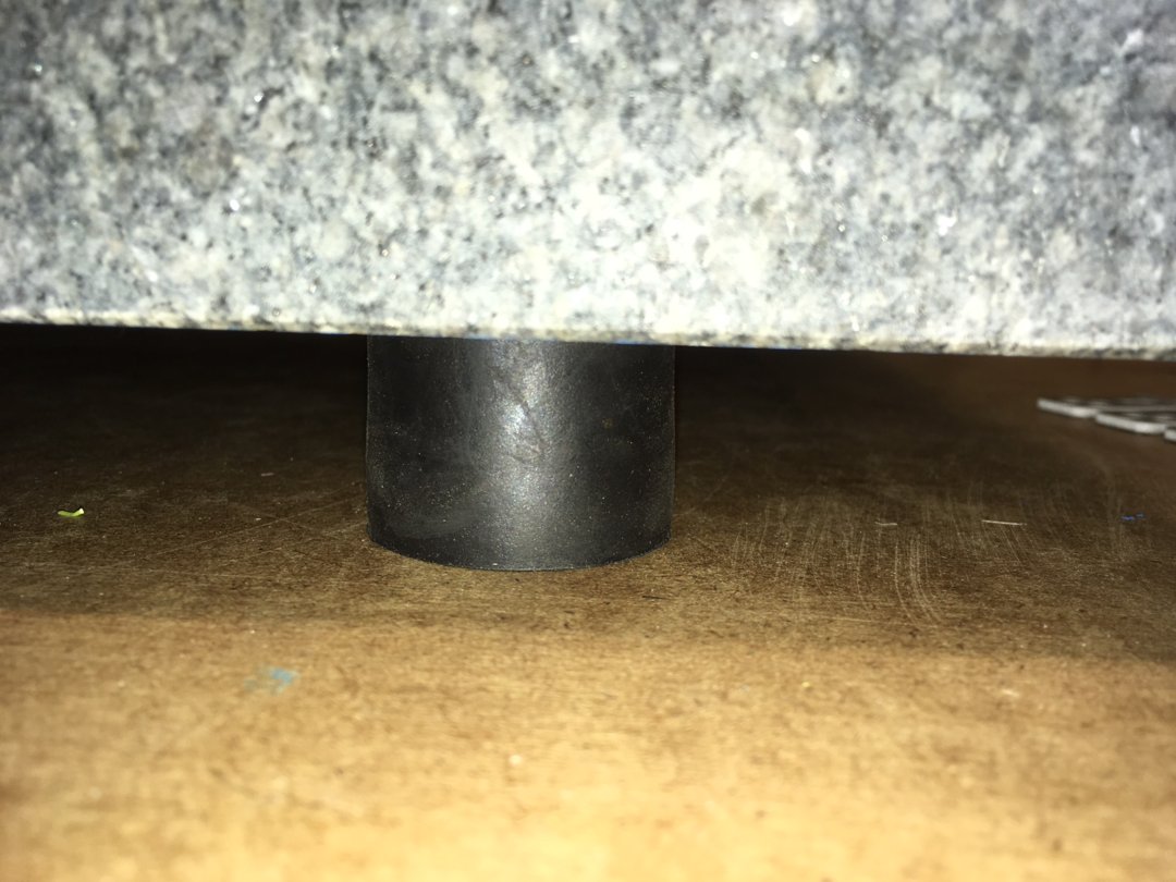

      Base: I have choosen to bolt my machine to something rigid and heavy, and it will be a granite slab of the size 760x550 mm. The machine will be bolted firmly to the granite base to reduce vibrations, and the granite base will be standing on three feets (to not introduce deflection from the surface it is standing on not beeing perfectly flat).

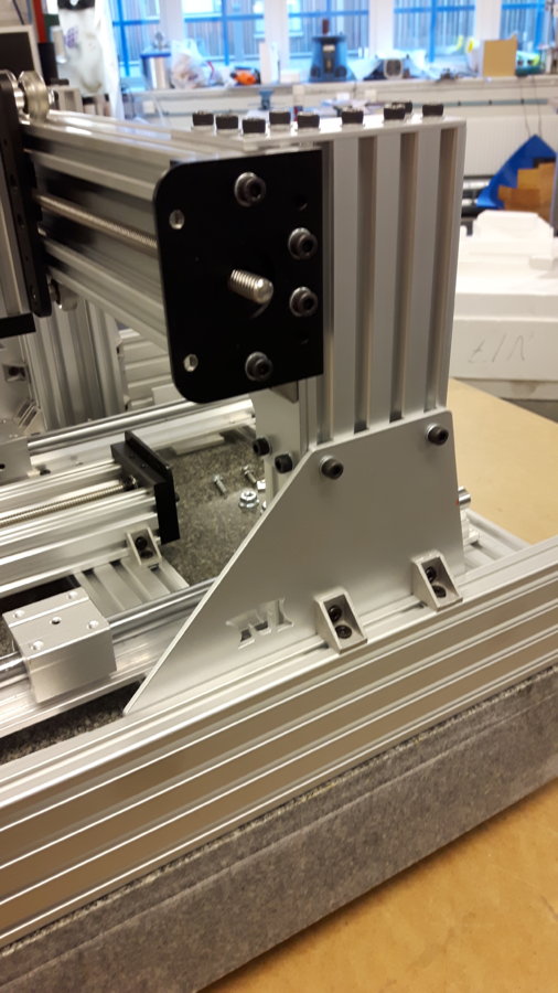

      Frame: I have changed the uprights in the gantry to two pieces of 300 mm C-beam, instead of the four pieces of 250 mm 20x60. I have also decided to extend the frame i Y direction to 750 mm (since I use 700 mm linear rail), and limit the Y travel to 370 mm. I was thinking about maximizing to 450 mm since I'm only using the nut block, but choosed to limit it to 370 mm. This will give me the opportunity to make an encosure attached to the C-beam machine frame without the table travel to hit the enclosure. I have ordered two new pieces of aluminum extrusion in 750 mm length for the sides. I will use my two extra spares of 20x60 (from the sides) to attach in between the (new) sides, and also to give the SBR16 rail a more rigid attachment.

      Build log in pictures:

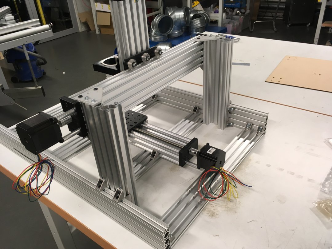

      Picture: First I buildt the original kit (with C-beam gantry uprights).
      Picture: Then I rebuild with new 750 mm sides.
      Picture: Frame done.

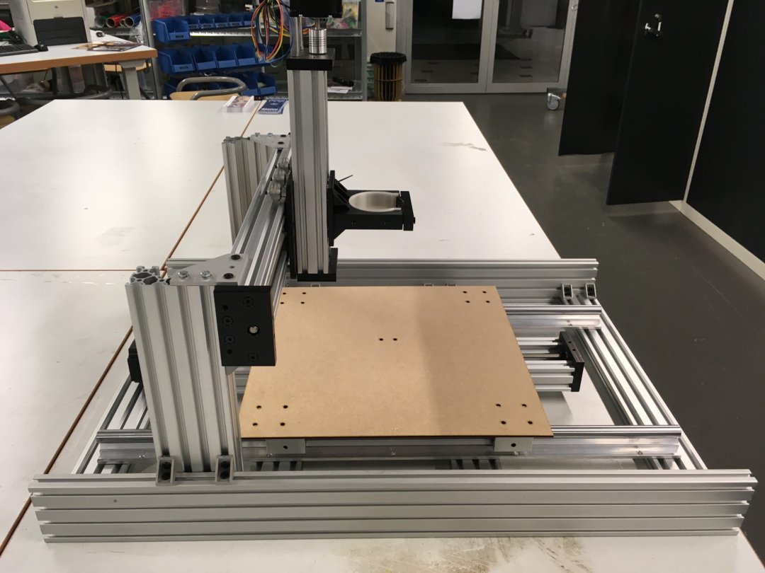

      Picture: Back view.
      Picture: Front view with SBR16 rail.

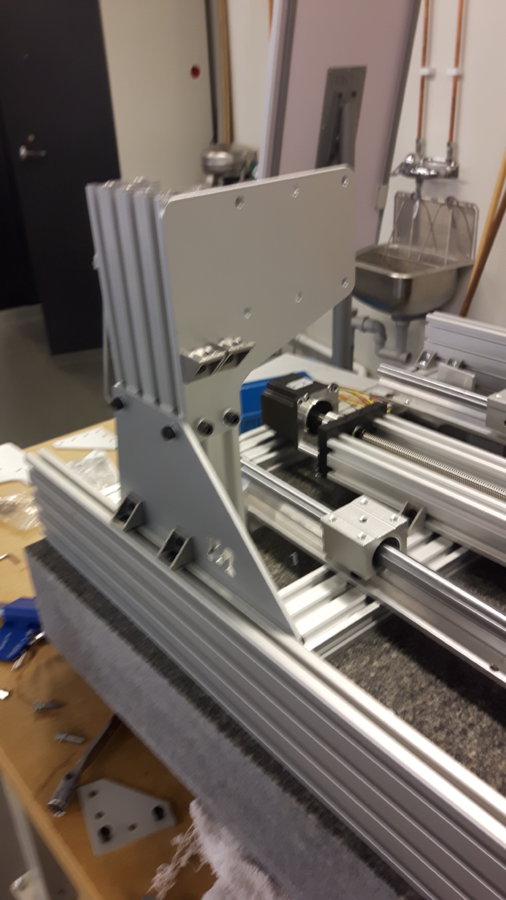

      Picture: The frame is now completed (750 mm long i Y-direction). However the SBR16 rail and working table needs some work.
      Picture: Side view.
      Picture: Front view.

      Picture: The 3 rubber feet bolted to the granite slab.

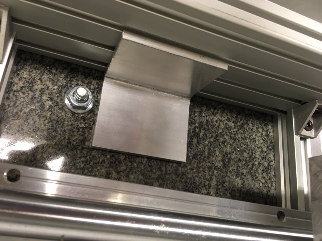

      Picture: Glued bolts to the granite to be able to bolt down the machine to the granite.
      Cut aluminum angles for bolting down (still need to drill holes and mount).

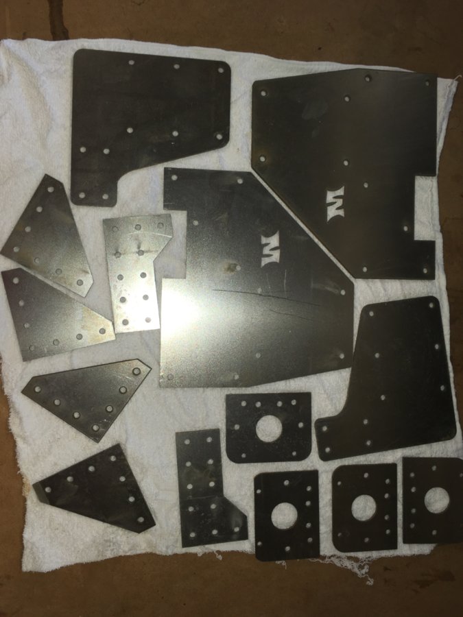

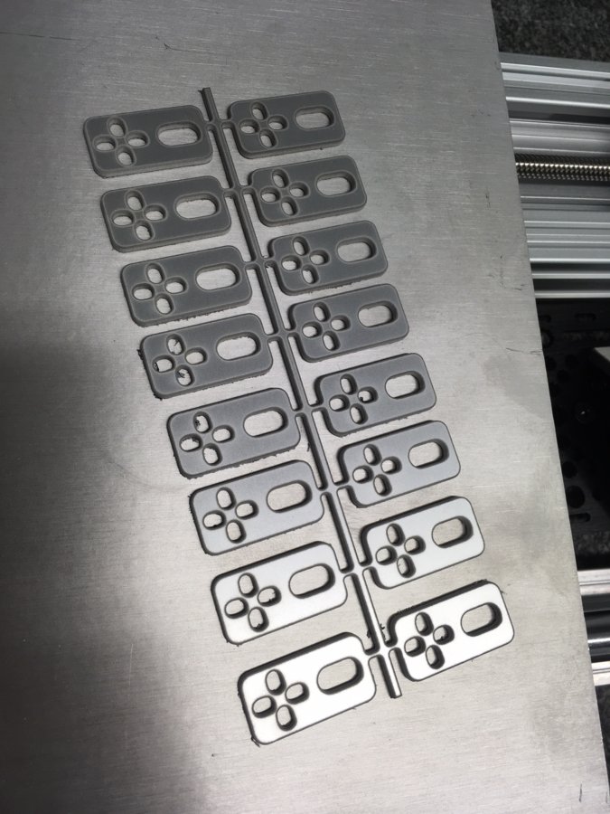

      Picture: Water Jet cut some extra brackets for stiffening the joints in the gantry and frame, and for stepper mounts - all in 3mm steel.
      Picture: And I also cut out some mounting plates for micro limit switches in 2mm alu.

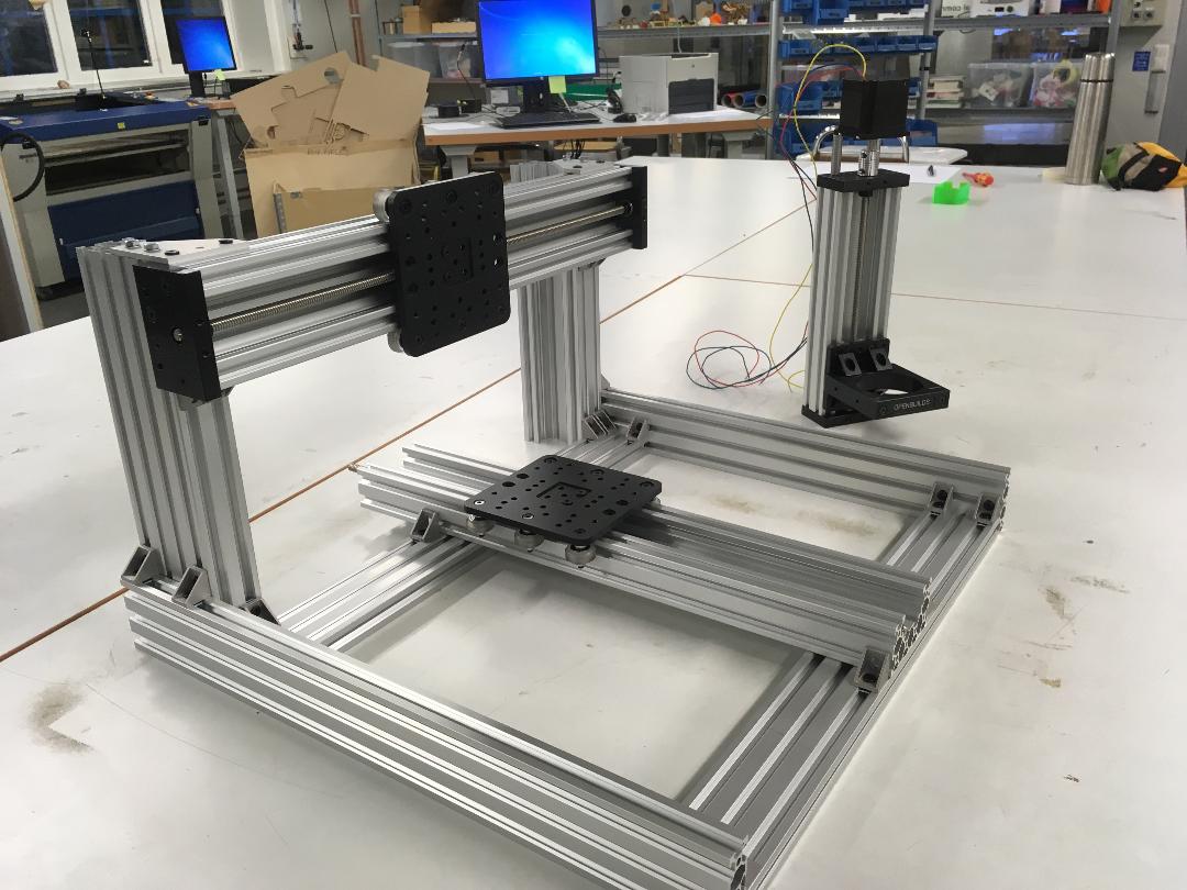

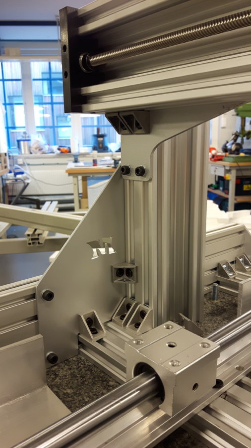

      Picture: Rebuilding the gantry a) - two new plates mounted partly.
      Picture: Rebuilding the gantry b) - all three plates mounted, as well as new stepper mount.
      Picture: Rebuilding the gantry c) - new view.
      Picture: Rebuilding the gantry d) - new view.
      Picture: Machine overview, also note new corner plates.
      Picture: The mounts to the granite slab has been drilled and bolted into place.
