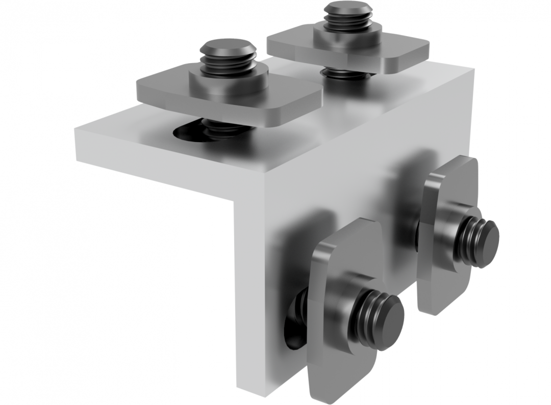

Double L Bracket Assembly (C1)
MINI BOM
Makeup two C1 assemblies and put aside.
- (2) Double L Brackets
- (8) 8 mm Low profile Screws
- (8) M5 Tee-Nuts

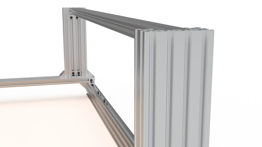

Basic Structure Complete
Well done, things are starting to look cool now that you've got the basic frame or backbone together before you go any further, you need to make up the Y-Axis Table, Spoil-board, the wheels and gantry assemblies, but before you move on check for squareness and tighten all those screws. Don’t tighten them too much or you will strip the threads, less than a quarter of a turn is all that is needed on these little screws; if your worried that they will come loss, use some Locktite on the threads.
If you don’t have a square, one of the plates will do in a pinch. Note: Diagonal measurements from frame corners should be the same if square. That is if the sides of the rectangle are the same lengths.
