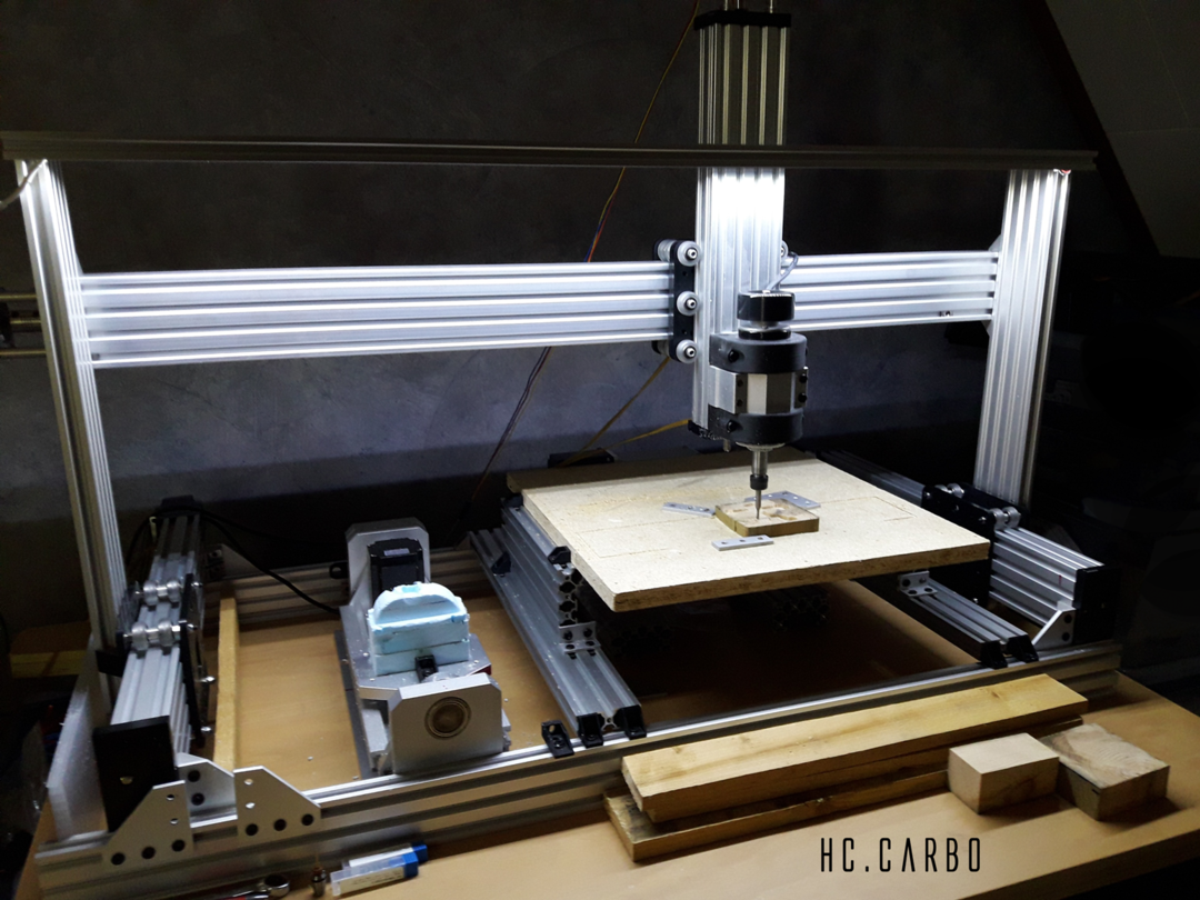

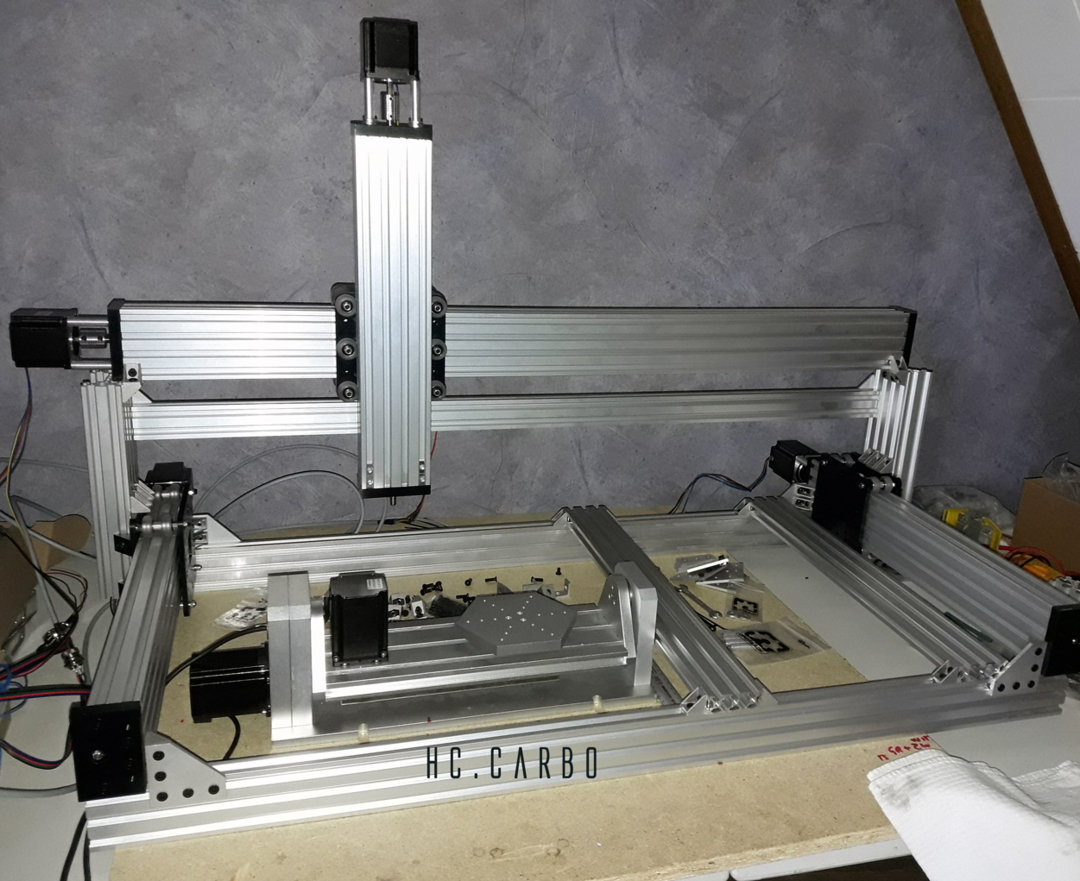

Using all parts from a CBeam XL +(z = 40cm)
Aim is to have the ab table for 5 axis and a small place to do simple small cuts (30x40cm)
When need bigger cuts i can remove the ab table.
Not yet tested, i a see it now: my x need to be higher (think to ad a cbeam on top +8cm)
Ad tank to the build name, seems i was not the first one to flip the y gantry
maybe put the sides on top of the gantry plates ?
how it looks now, (07/18)

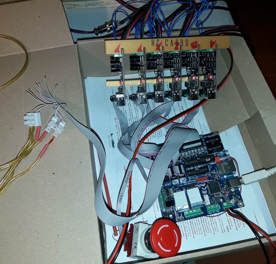

pic of the infamous controller
3 limit/home switches (took some time to figure out how to home the y)

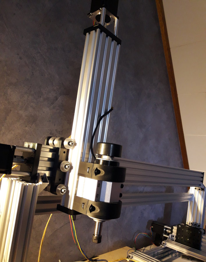

starting with a small 500w spindle
printing the motor mount today (53mm)
53mm CNC Spindle Mounts for C-Beam Extrusion by HC_Carbo
mounted (hope it turns)
