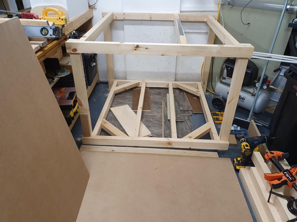

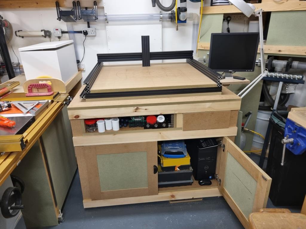

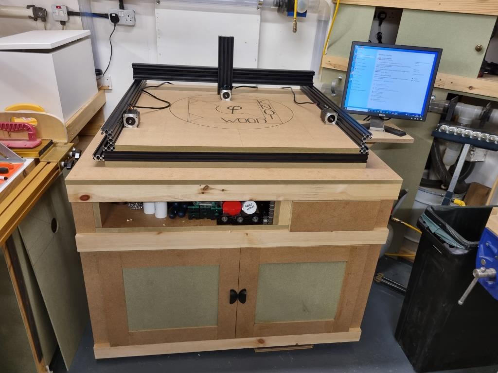

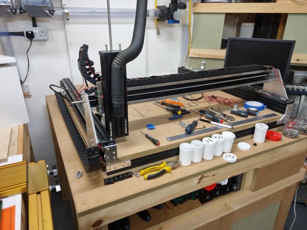

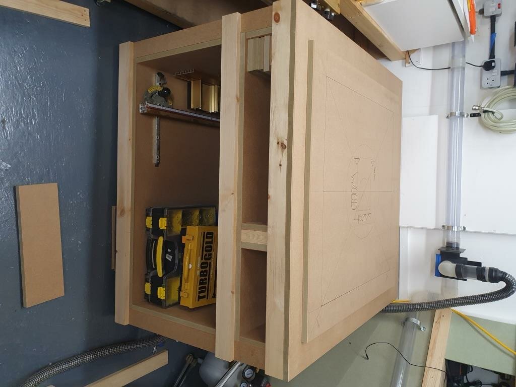

1000mm x 1000mm machine based on 80mm x 40mm C beam with MGN12H linear rails and Sphinx Gantry Kit

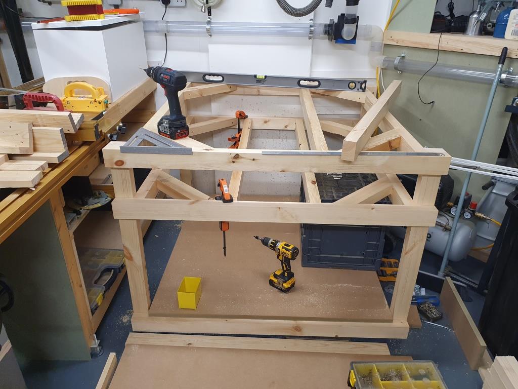

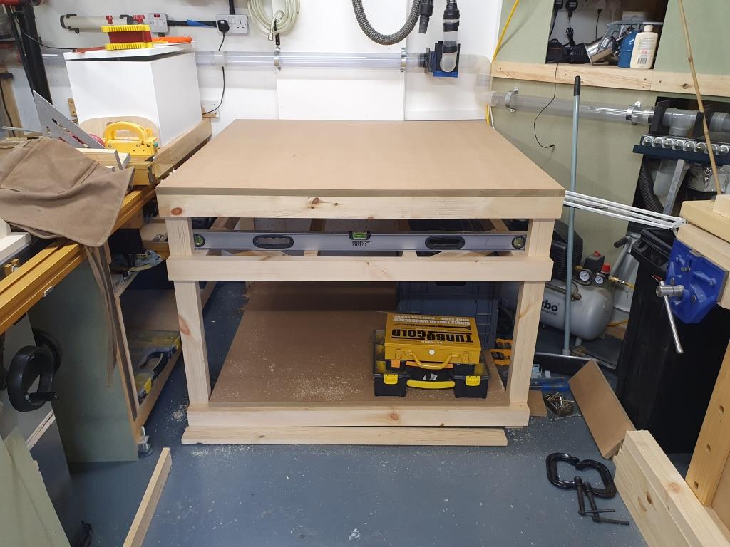

Ok, the majority of my kit has arrived from across the globe and i have been building it stage by stage.
All the plates are on and screws are in, as are the linear rails. I now need to order my fixings for the motors and it should be ready to go by next week hopefully, once i have finished the wiring and added an NVR emergency stop.

Another Cartesian style build with parts from the UK, US & China.
- Build Complete!
Special Notes
Plates from the US, Extrusion from the UK and linear rails from China!

I really wanted to add to my woodworking projects signs and design that can only really be created with a CNC router set upInspired by
My build has been inspired by many of the Cartesian or Sphinx style builds on this site -
Parts list
Qty Part Name Part Link Comments 1 Sphinx Plates from Chris Laidlow - US Link Excellent, well made, very accurate and look great! 3 C Beams Link From Ooznest (UK), Great Supplier of Openbuilds parts in the UK 1 Black Box Controller Link Again from Ooznest (UK) 0 Cap Bolts & T Nuts Link Nearly all purchased from Amazon UK , excellent delivery (on prime!) 7 Linear Rails & Carriages Link From Banggood (China), Another good supplier and good delivery service to the UK 4 Nema 23 265oz Stepper Motors Link Ooznest (UK) 1 All the other bits & bobs! Link Again, many many parts from Ooznest (UK) 0 Link
