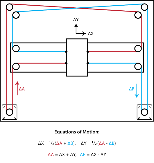

I started the project with search of fast drive systems with low torque requirement, initially I landed on H-Bot design but by further research I got to know that it require unwanted torque. To resolve H-Bot design issue there is a system called CoreXY. I found this design is followed by many 3D Printers and Laser engraves so I decided to build system based on this design.

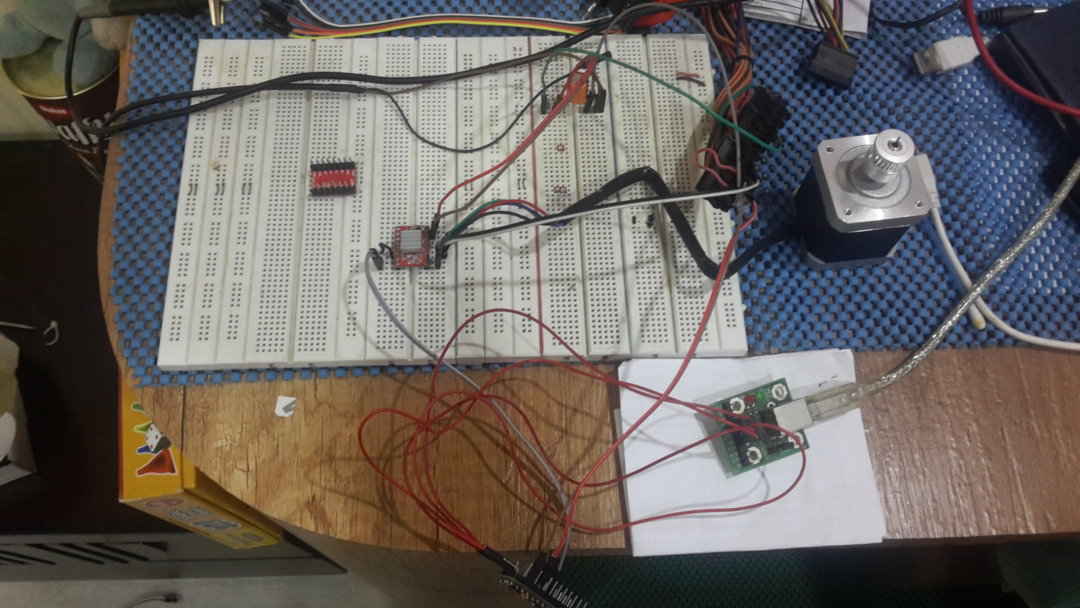

From my past experience with GRBL I selected the electronics based on Arduino. I wanted the circuit compact as conventional Arduino Uno is very big in size, so I took Arduino Pro Mini due to small in size and same microcontroller used on it. Next thing was stepper driver as I planed to use Nema 17 (4.4Kgcm) Stepper Motors, I selected the conventional A4988 Stepper Driver.

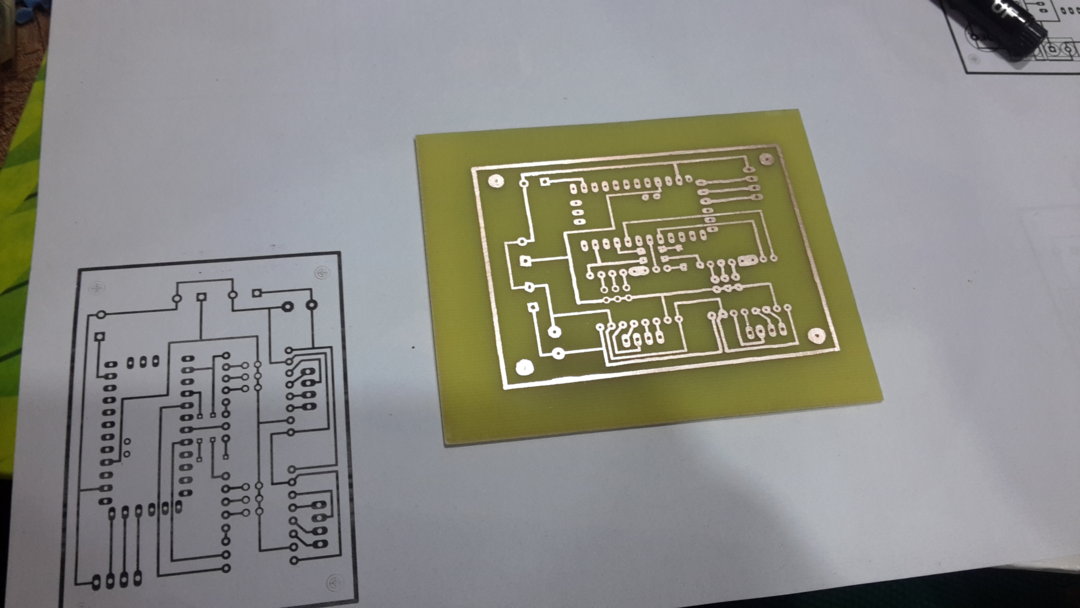

I fabricated the PCB at home to connect all the components together. First I tested the circuit on bread board.
After successful testing I created the PCB at home using toner transfer method. The result was pretty satisfying.

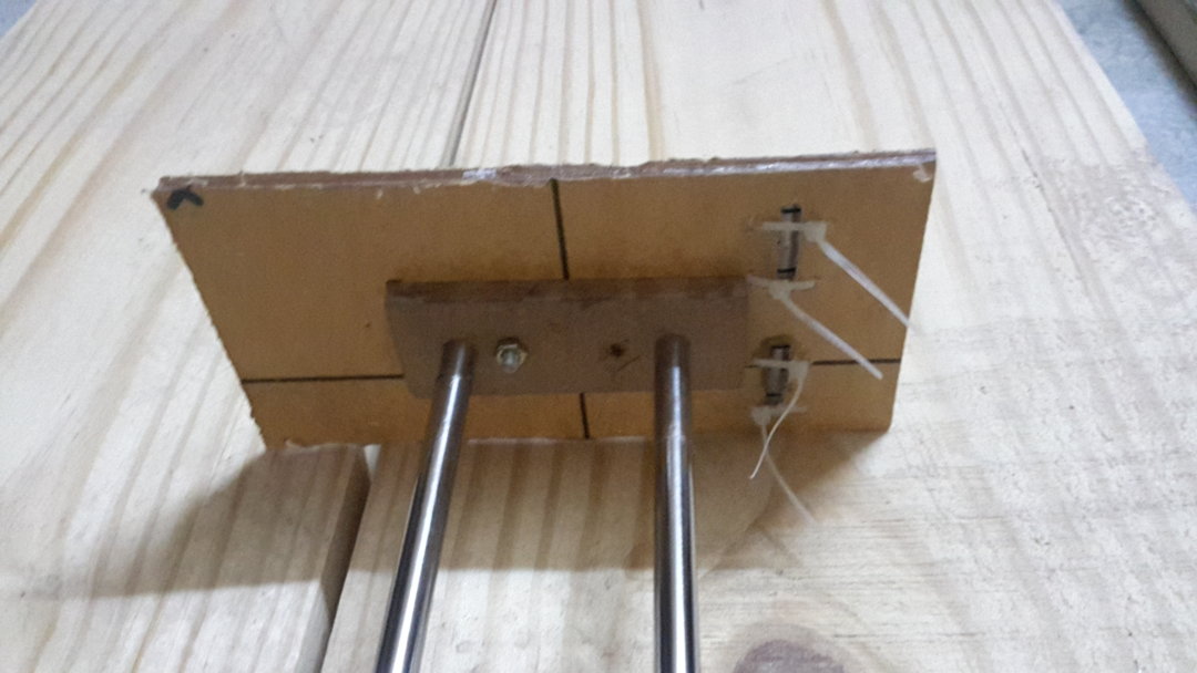

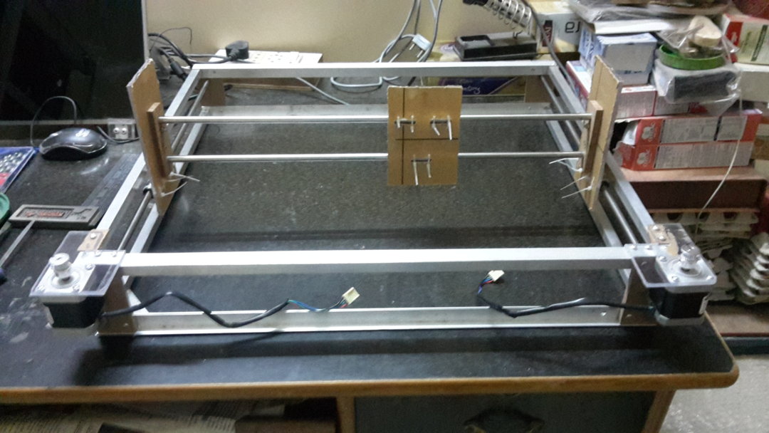

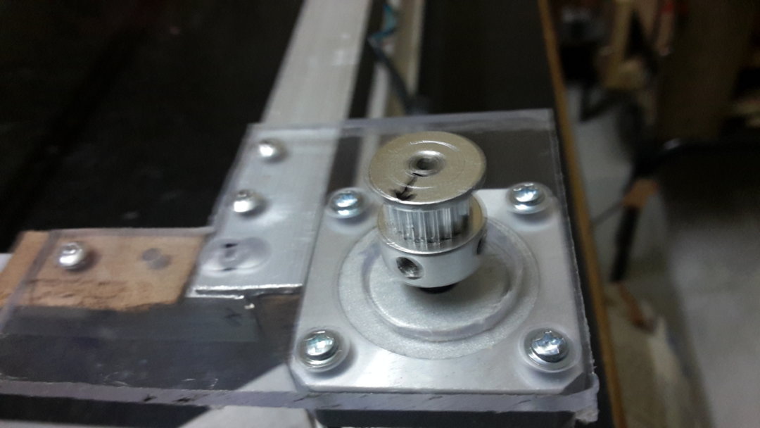

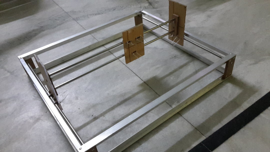

The Body
I wanted the body to be very light in weight and rigid enough. I planned a bed less body as I wanted it to be placed on any surface that is bigger then the working area (and it also decreases the overall weight).

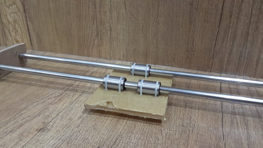

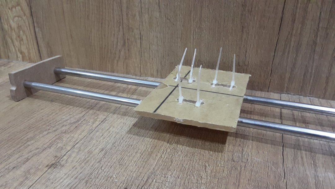

I selected 3 materials 5mm Acrylic, 8mm MDF, and aluminium lengths of three different profiles (Due to lack of availability in local market).
I used 8mm Steel Rods and LM8UU linear bearings for the linear motion. You will get a good glimpse of body with following images:
Conclusion
The build test was very cool as you can see in video attached. The movement is also smooth and fast. Overall weight is also very lite.
