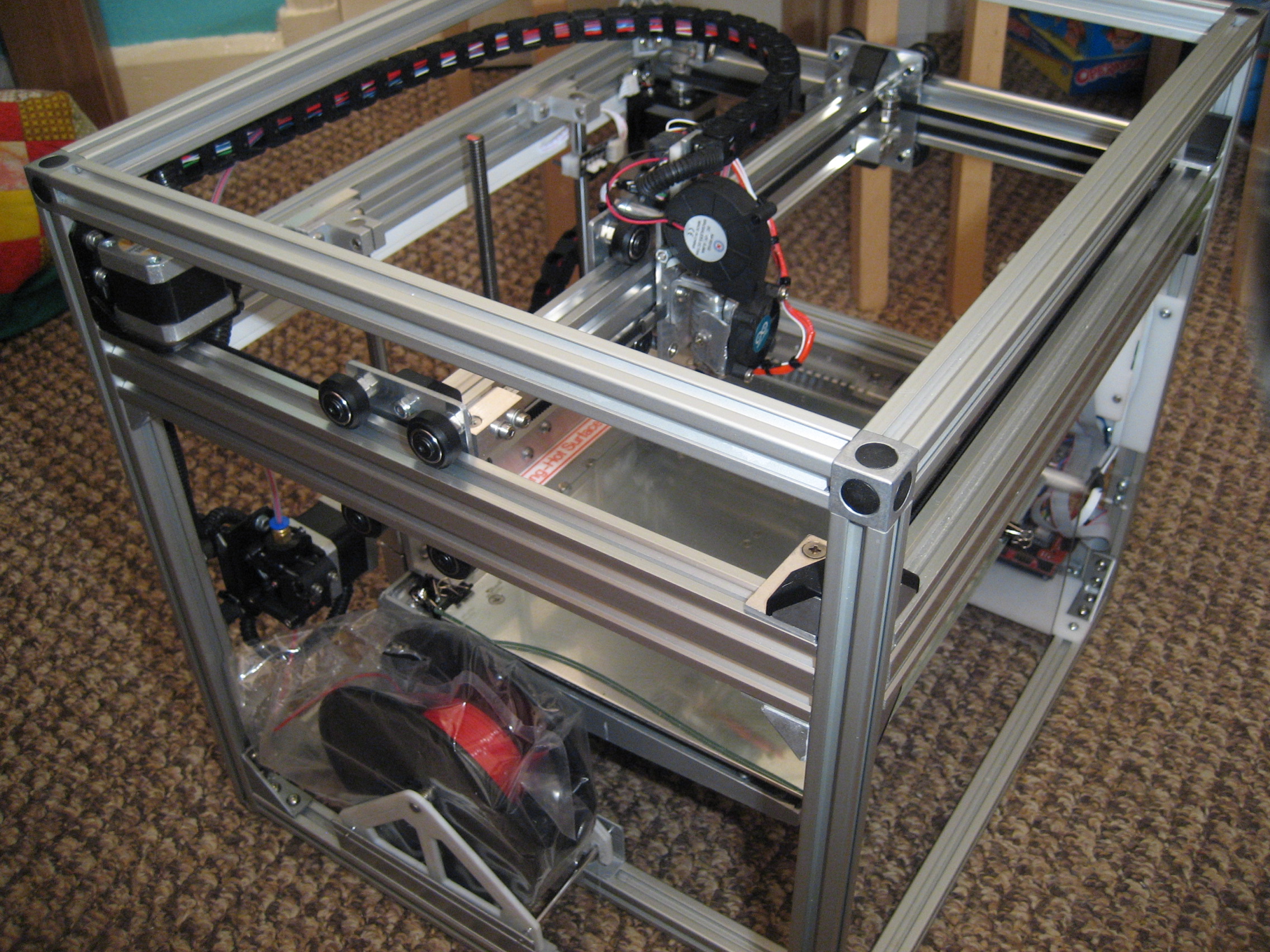

      Here is my printer build. It has a print volume of 305x209x219 and everything tucked inside a box of 490x420x450

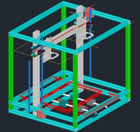

      This design saw a few CAD iterations as I built the frame into an enclosure ...
      A visit to the TCT show in Brum' and a look round a few pro printers led the way to a cube design more in the UM style - elevating Z moving XY

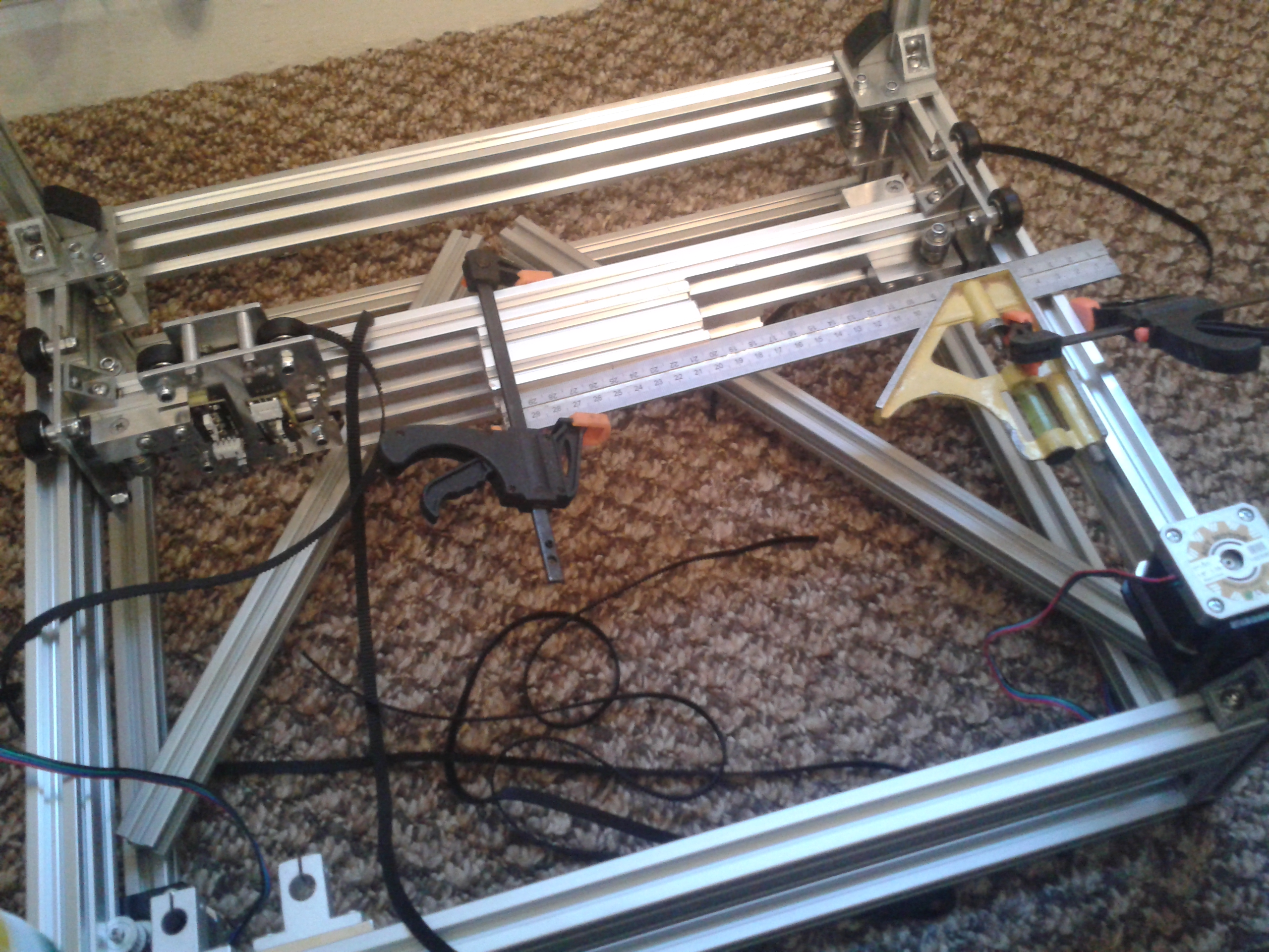

      I liked the idea of fixed X & Y motors and tucking the belt inside the extrusion and that gave me a direction. . . Offset belt path Core XY

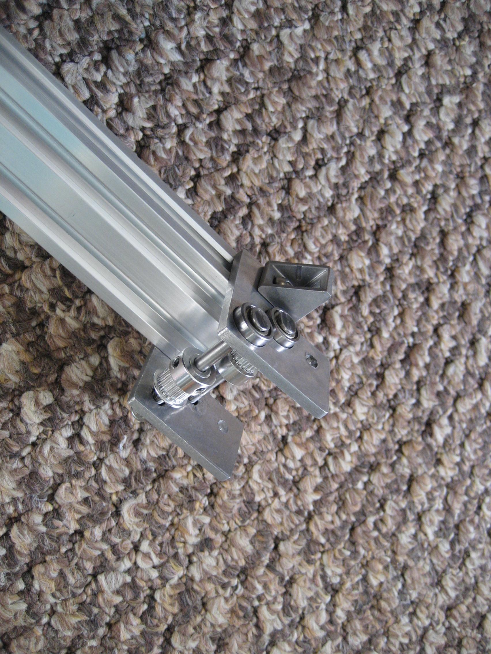

      Running the belts inside the V slot required a little chopping out for the pulley with a grinder-
      I tried a method of using fixed bearings with spinning shafts/ pulleys but found it transmitted a lot of noise thru the frame-
      So I went for 2 605ZZ 5x14x5mm bearings per belt as running idlers-
      I don't have access to workshop machining, only jigsaw/ angle grinder/ pillar drill so used M5 c'sk screws as axles in hand cut Alu plate.
      I opted to put the belt return path to the front of the printer so leaving the rear clear for the Z axis parts.

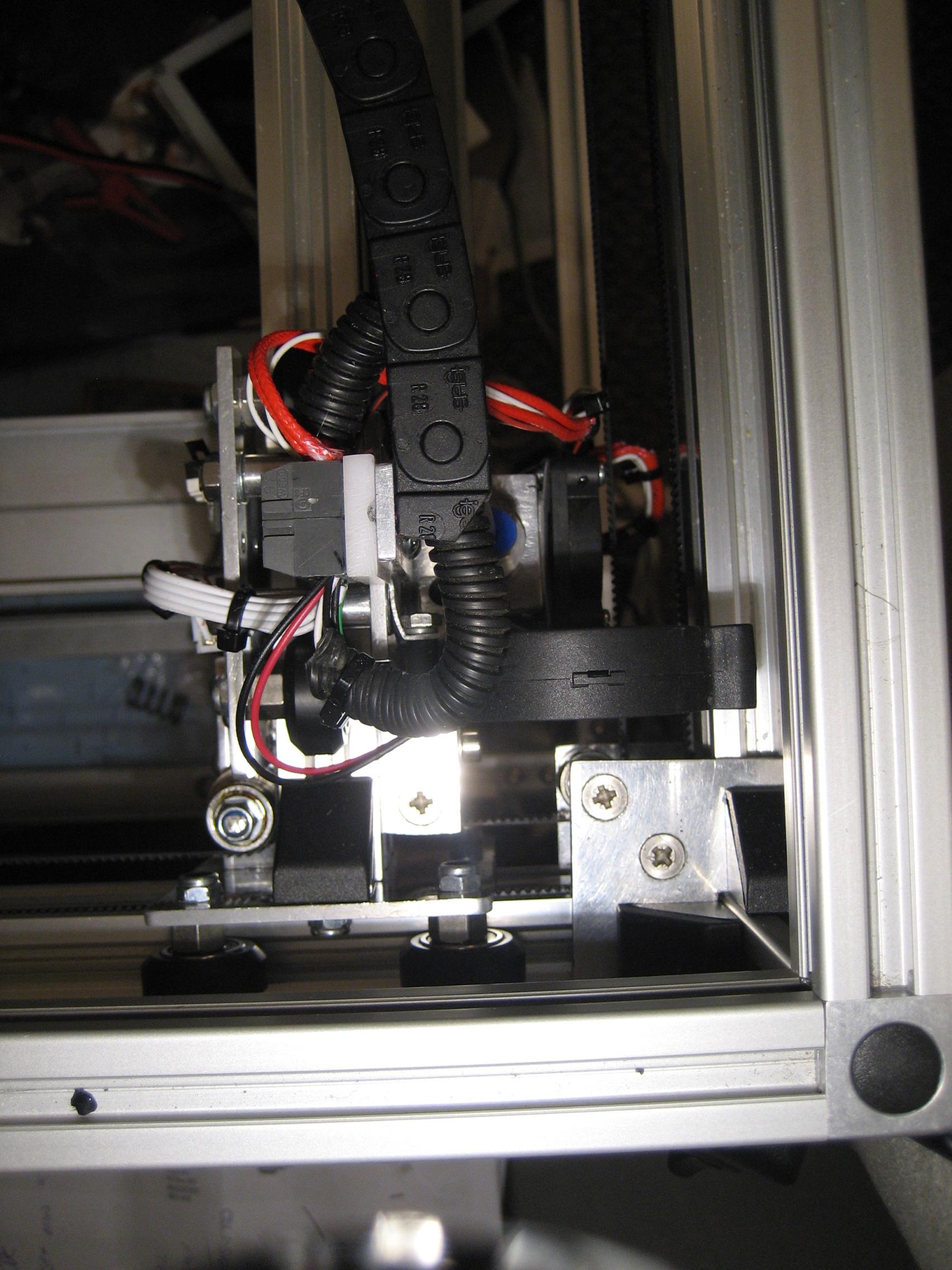

      I like my cables tidy. The cable chain arrangement was inspired by something that Bits-from-bytes once did-
      The extruder is airtrippers direct drive bowden mounted on rubber mounts. The bowden originally ran inside the cable chain which worked but I ultimately ran it outside to reduce friction on the filament.

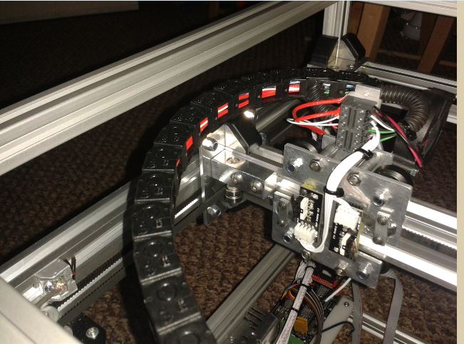

      The X carriage is 2 plates sandwiched on spacers
      The wheels mount to the rear plate along with belt clamps, wire terminals and X endstops, the front plate holds the Hotend assembly and cable connections.

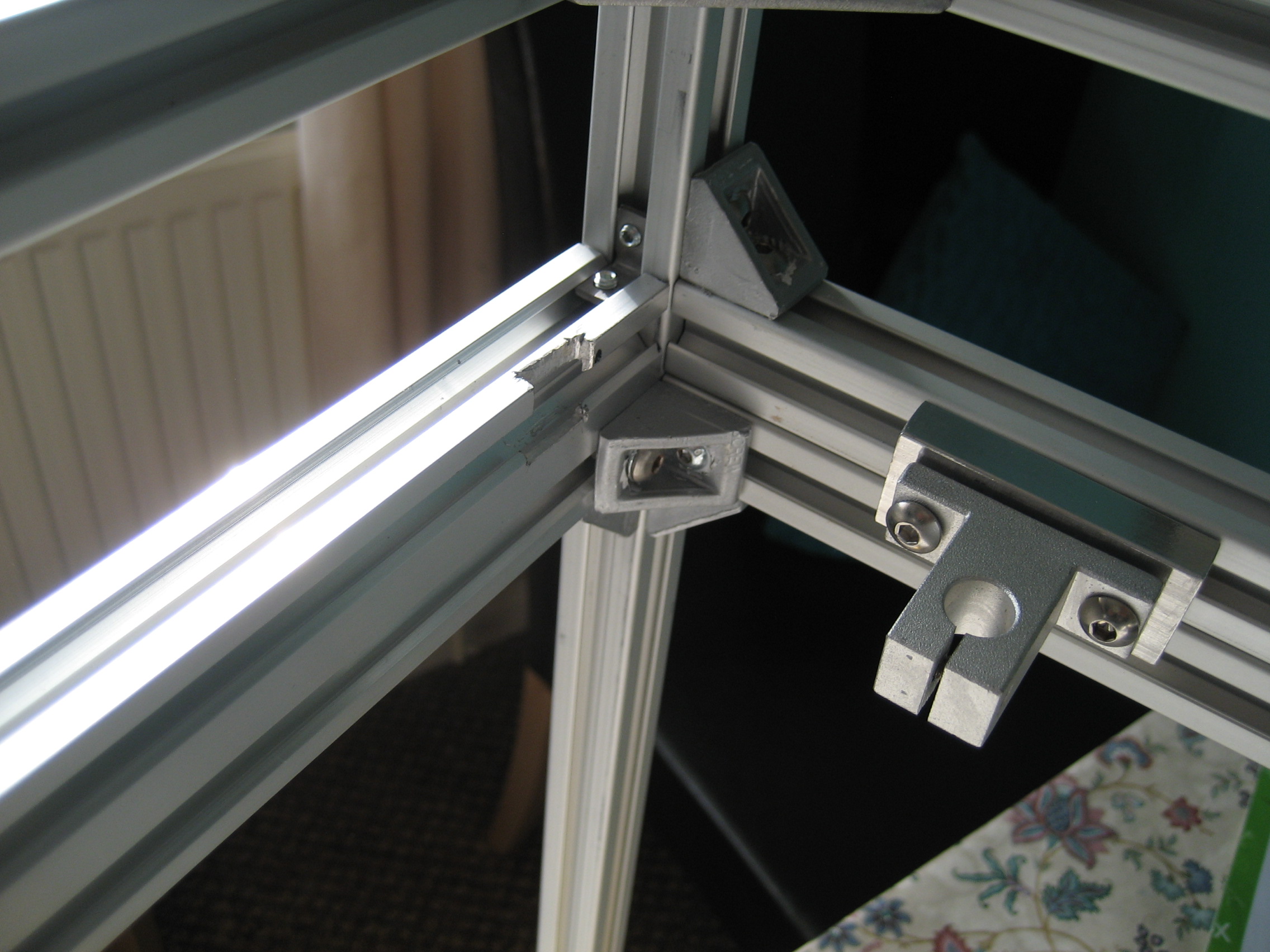

      For cheapskate nut inserts; if you grind the edges of a M5 nut it will slip down the 'V' slot. Put the ground edges facing in.
      Be warned that it can bite a lump out of the inside of the channel if you overtighten it which may be a problem if you intend to move the nut around to adjust something. Better to use a proper insert.
      Thats about it for the moment, I may add more. There's an AutoCAD 3D model and a parts list attached.
