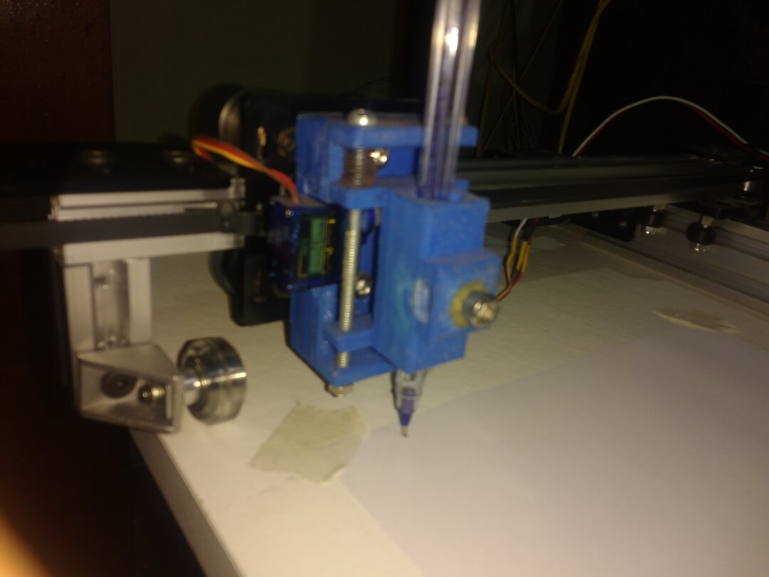

The Pen Holder
The 3D Printed Pen Holder, here the instructable I follow to get mine. and some pictures you can use to guide yourself to bring yours into reality. This is not a minor issue, it's a very important one, a good pen holder, sure result in a very good drawing. Take care about those springs You're going to use, the spring compression force should not be too much strong.

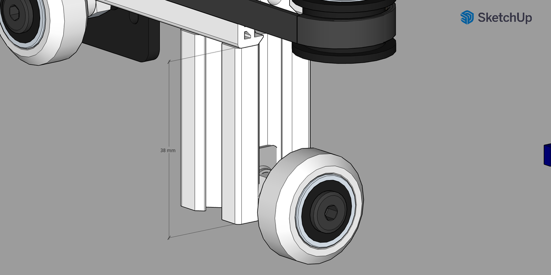

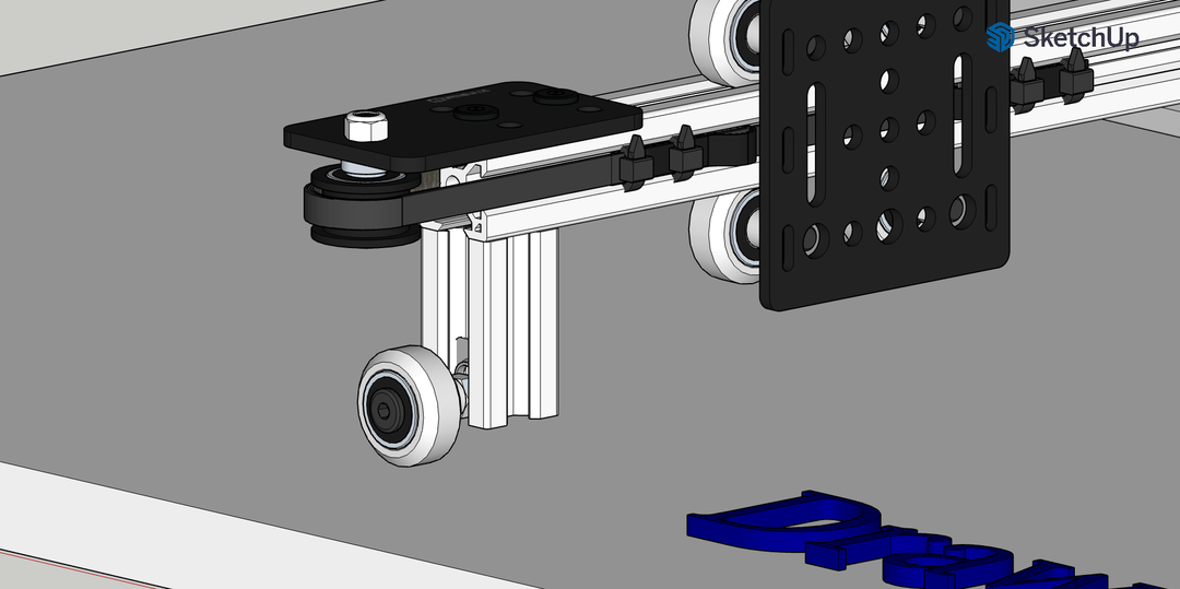

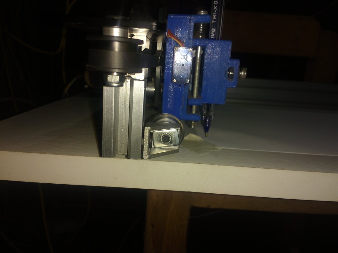

UPDATE - 18/05/2025
I added a leveling wheel, so the Y.axis will be aligned all his way on
The Result...![]()

Check the spring compression force. If you put one with a high force, the servo (small sg90) WILL SOON exhaust... so learn from my mistake.
