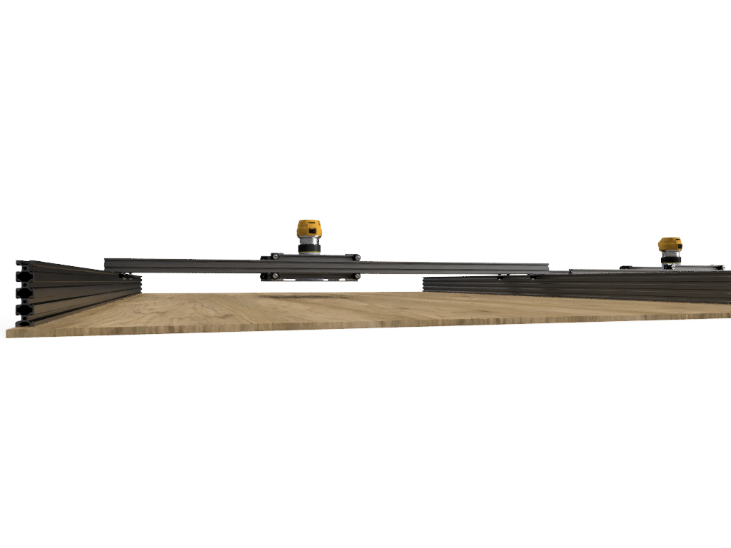

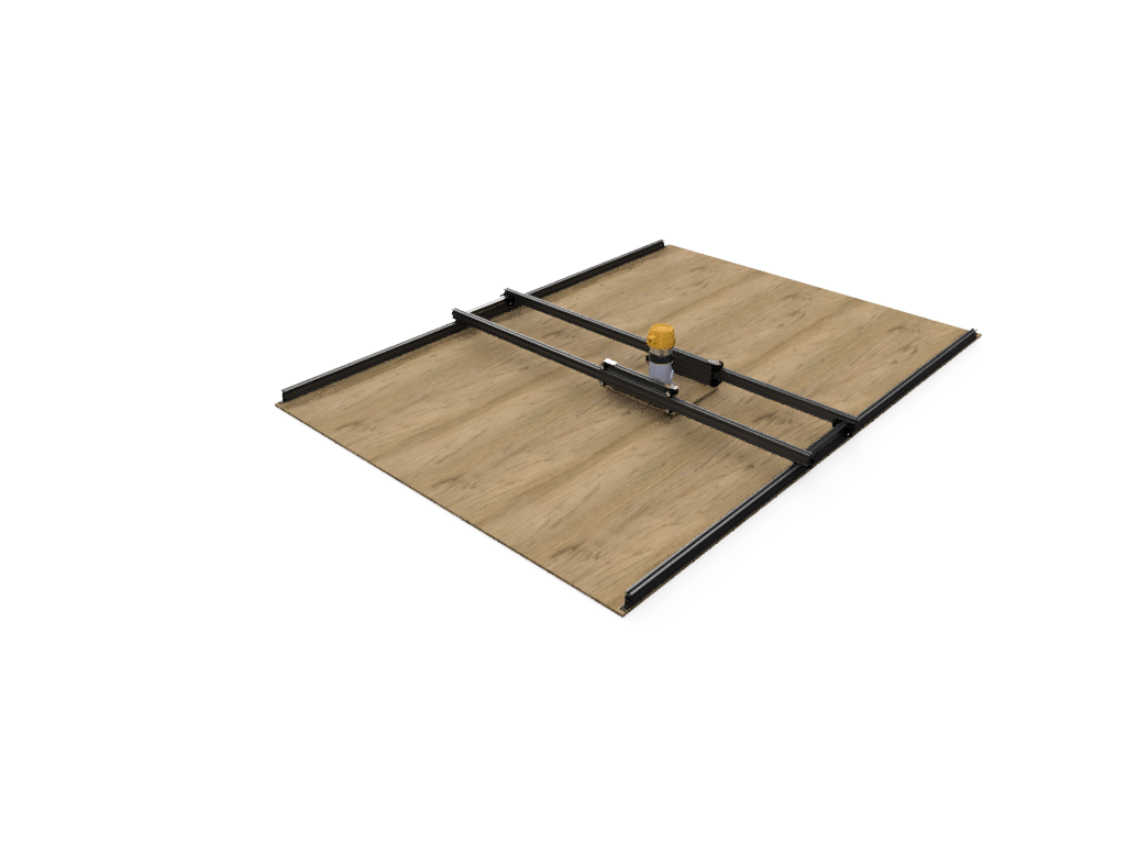

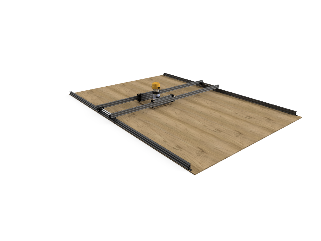

Wood planner - because this can be one of the applications of this construction is easy to build and most importantly available to expand it and many elements you need!
The design of the plan consists entirely of V-SLOT profiles and OpenBuilds accessories.
Thanks to this, you will build a wood planner with dimensions from 500x500 to 3000x3000, e.g. by connecting 1500mm profiles using a BUTT connector.
We have prepared for you a 3D model (basic - does`t contain screws and connecting elements)

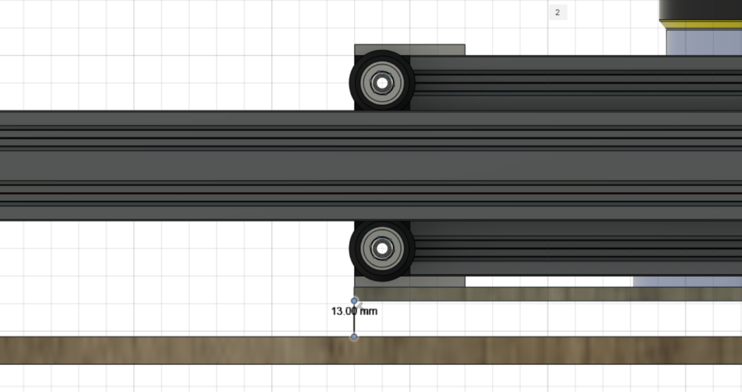

Also pay attention to the working height!
Depending on how high the material you want to machine, it's worth paying attention to the profiles used for the Y axis.
There are several options:
- By using V-SLOT 2040 profiles for the Y axis and a 5mm thick spindle base plate you will get a space of approx. 13mm.
- By applying V-SLOT 2060 profiles to the Y axis and a 5mm thick spindle base plate you will get a working space / height of approx. 33 mm.
- By applying V-SLOT 2080 profiles to the Y axis and a 5mm thick spindle base plate you will get a working space / height of approx. 53 mm.

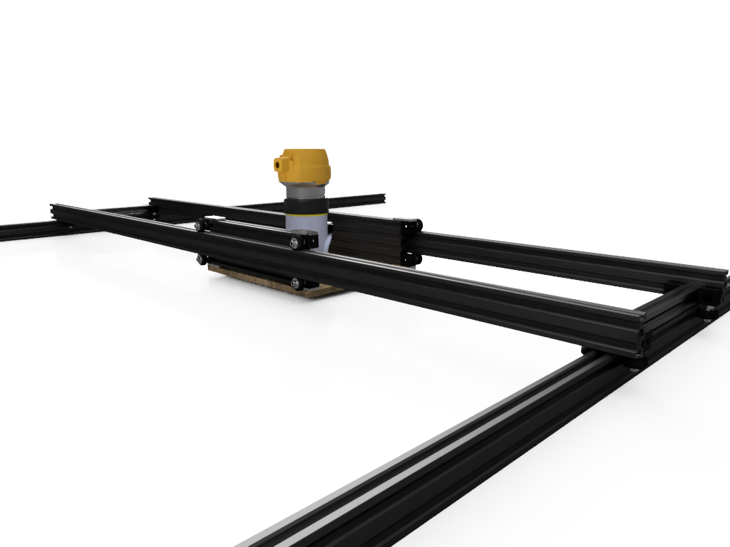

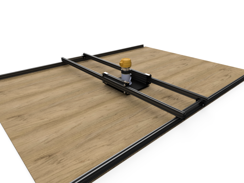

V-SLOT profiles and OpenBuilds accessories give us many possibilities. We decided to build a manual ROUTER SLED using only components of the OpenBuilds system. The design is simple to build, construction takes little time, and the frame is easy to transport.
- Build Complete!
