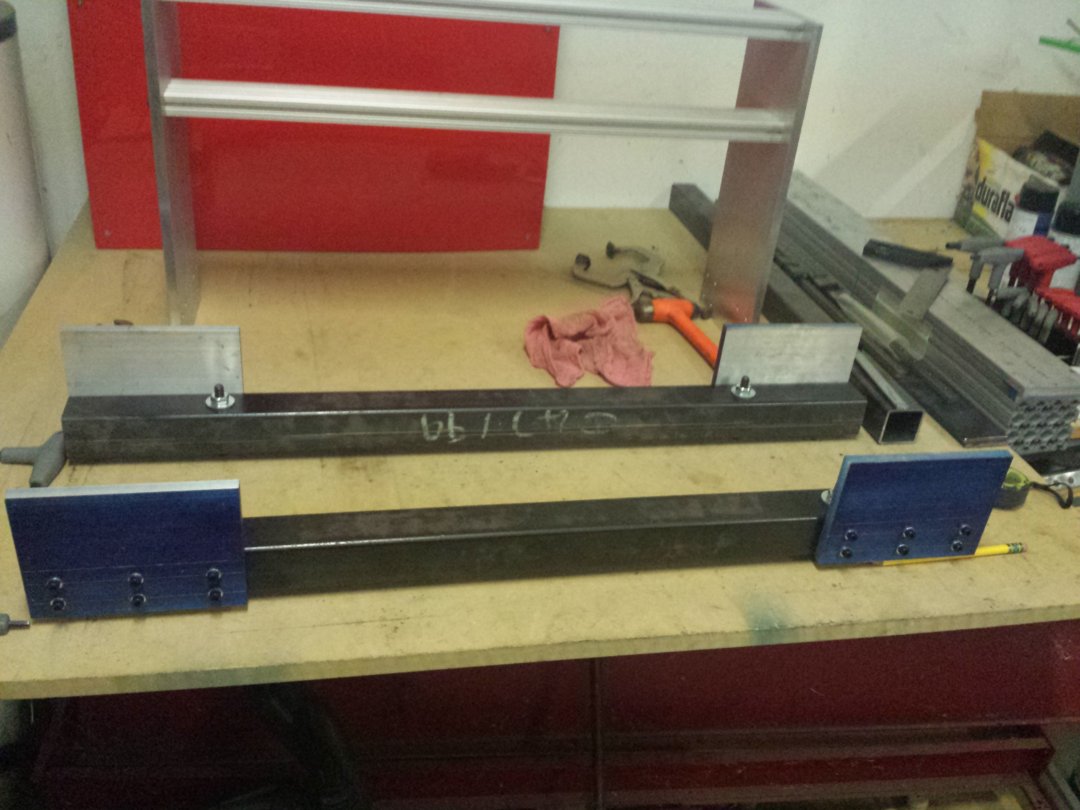

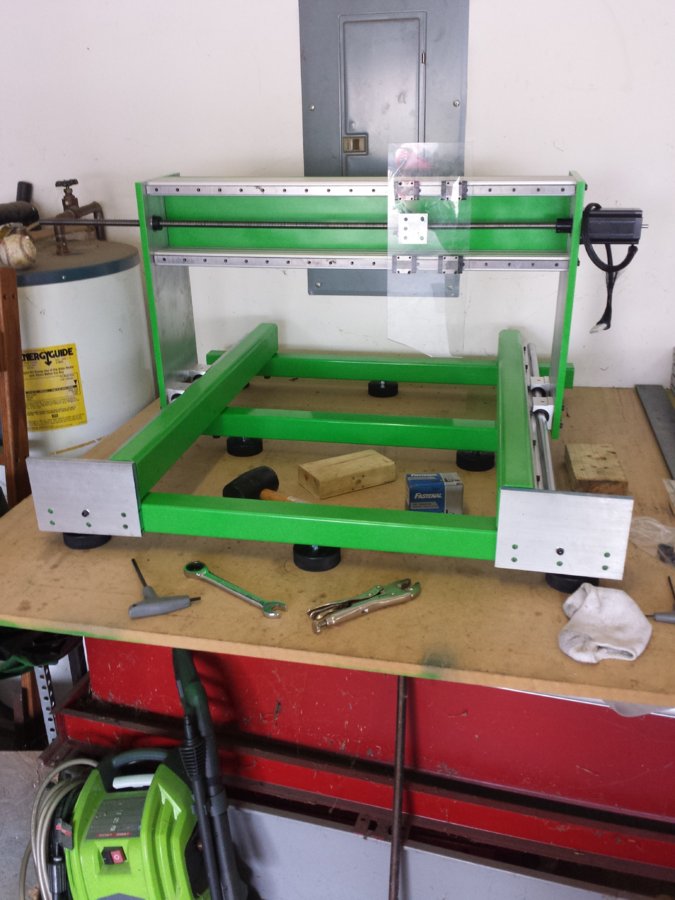

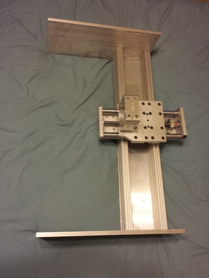

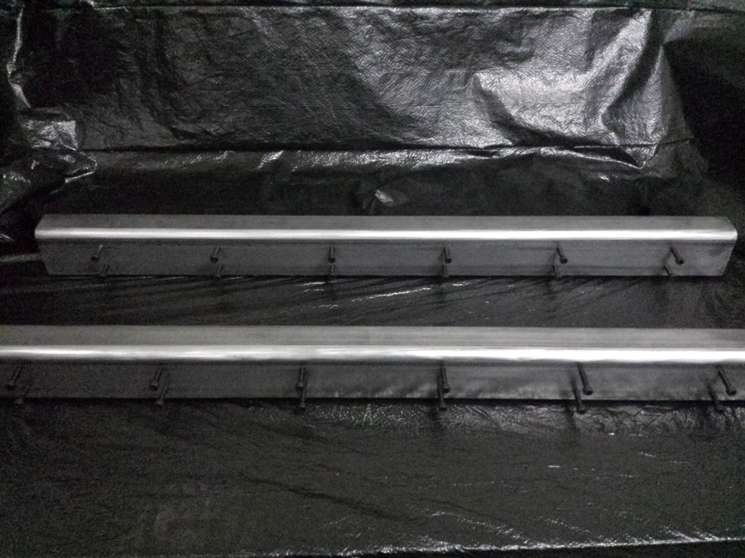

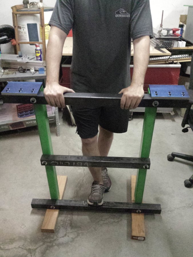

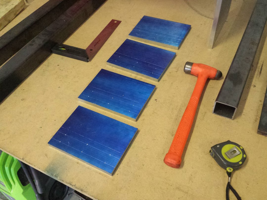

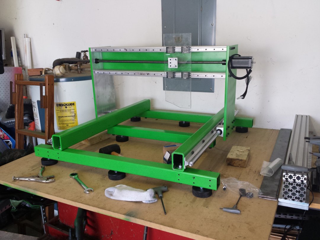

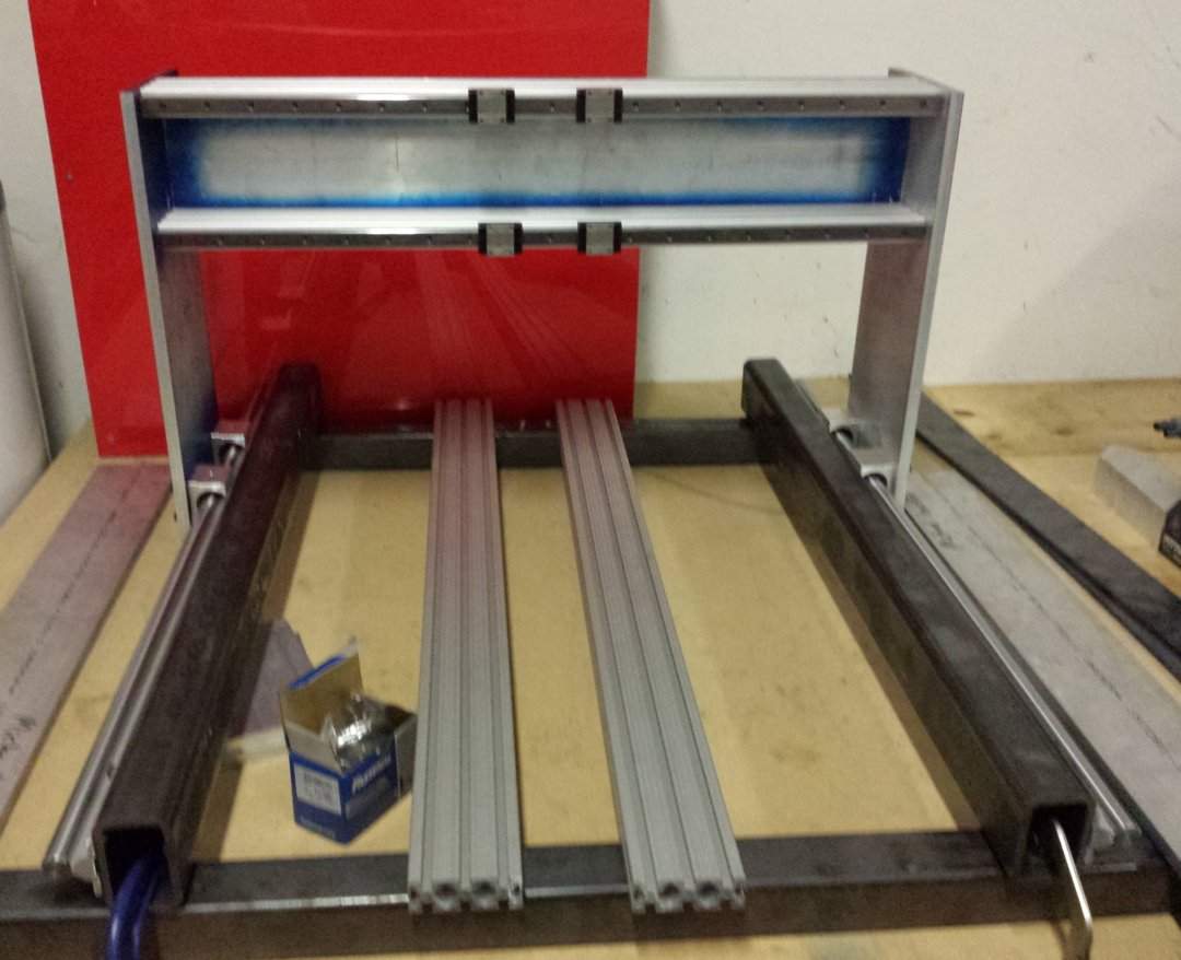

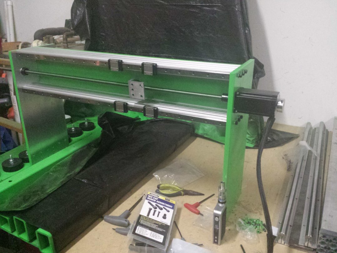

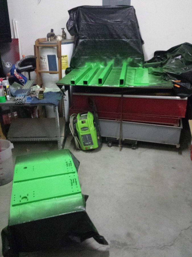

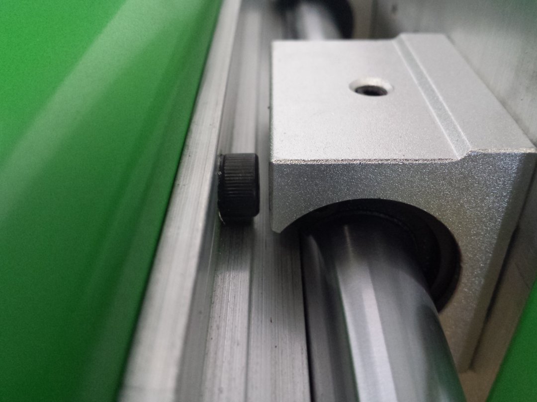

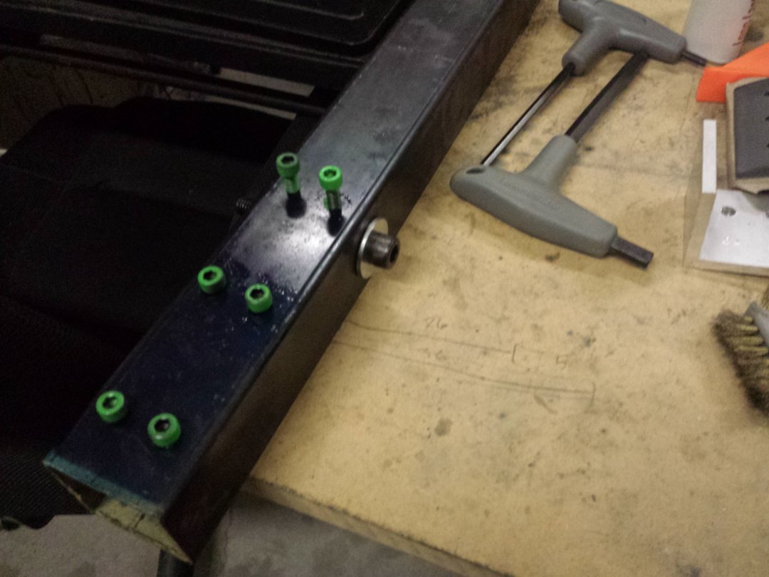

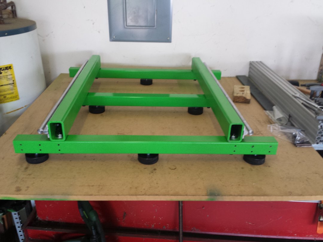

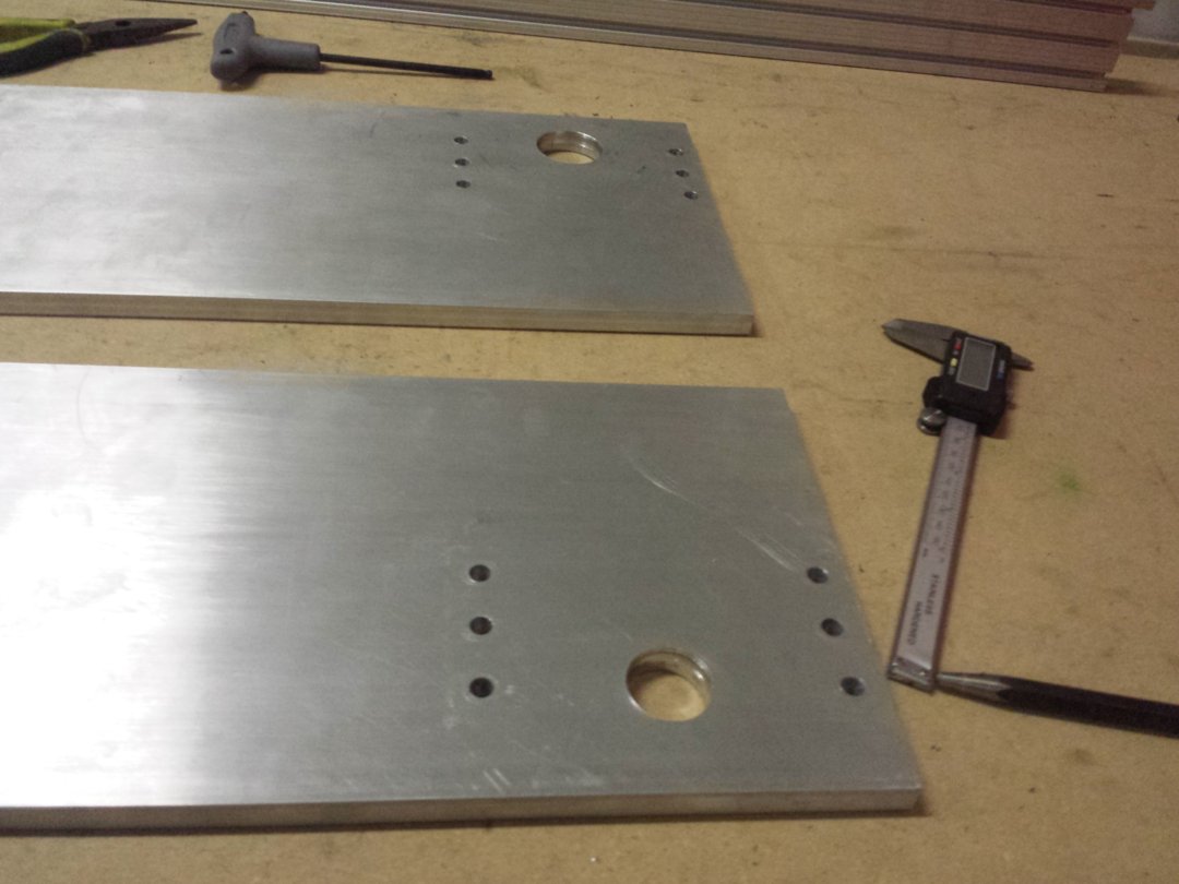

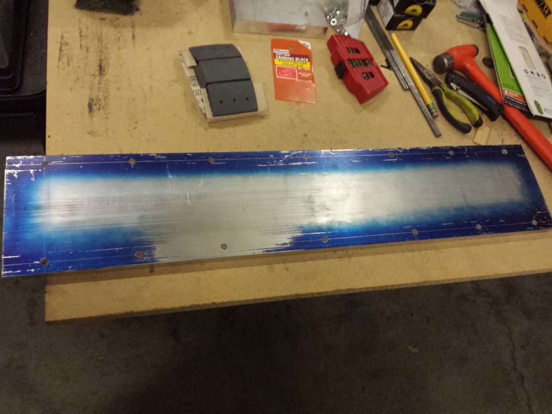

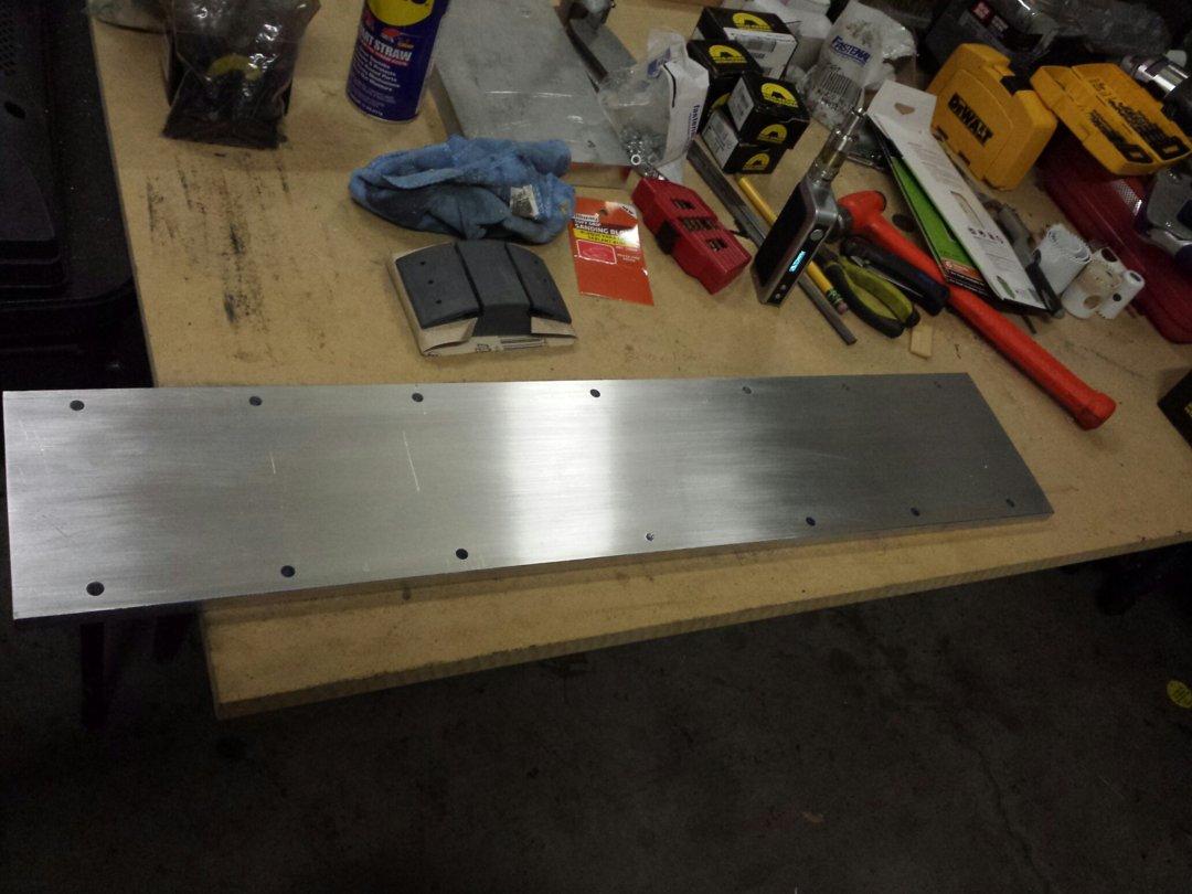

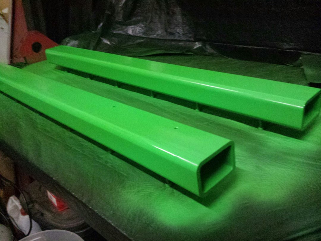

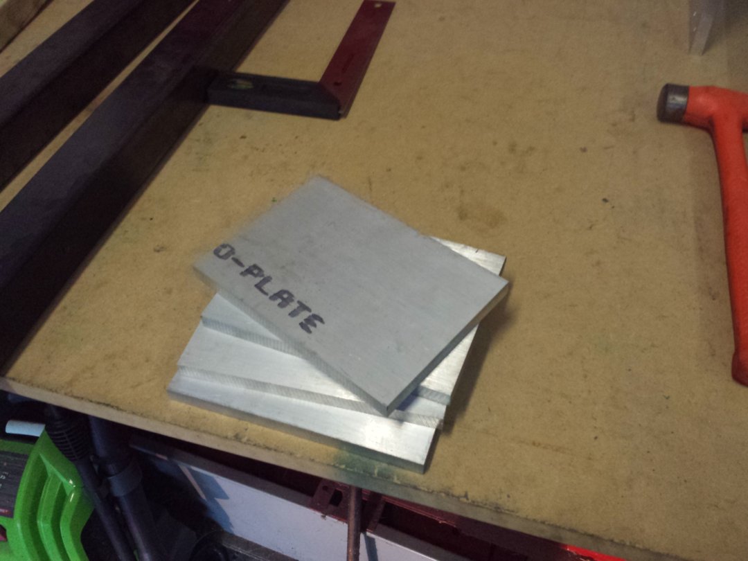

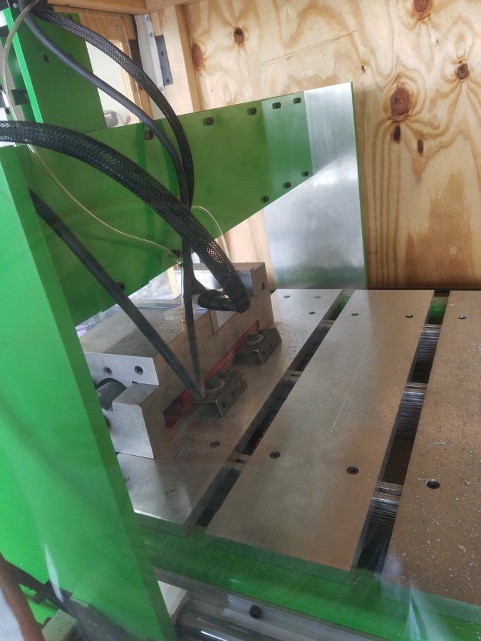

First, I came up with what I wanted to accomplish. I wanted to be able to cut aluminum as a primary material, and wood as a secondary material. I drafted up a plan in Google Sketchup, and while it is good for generalized ideas, I wanted something a bit more precise. Shortly after my first design, I started learning to use Solidworks, 123D for smaller parts, and finally Autodesk Fusion 360. I made the switch to Fusion and never looked back. Over the next couple months I encountered a lot of material design questions. It was hard to balance bang for buck, capability for cost, etc. In the end I decided on a bolted together steel frame made from 2x3, 0.250" Wall AS500 Steel tube. I opted for this to avoid any warping issues I have read others complain about. As an additional bonus, this makes the frame easier to modify for future upgrades or design changes, and adjustment for square can be maintained after moves if necessary. Moreover, I figured I would much prefer to have things too stiff than not stiff enough. For the X-axis I wanted a strong span, but nothing that would cause me to have to move to a bigger frame motor than the Nema 23. I ended up choosing half inch aluminum plate along with 1030 10 series aluminum extrusion for the X-axis. After selecting the frame and component materials, I made the decision on power transmission and motors. For the transmission of power I went with 1/2-10 2 start acme threaded rods with delrin anti-backlash lead nuts. It was a good selection for my first setup and was easy to procure parts to support this setup with a relatively low initial investment. For the linear movement I kept my eyes peeled on eBay to see if I could get lucky enough to get a matching set of 20mm linear rail and bearings. Luck just happened not to be in my corner. Working within budgetary constraints, I opted for the supported SBR20 bearings for the Y-axis, and some NSK (I think?) 12mm linear guide rails and bearings on the X-axis, and Thompson unsupported 16mm rails for the Z-axis. There was one thing I didn't like about this setup initially. When I first considered the NSK rails for the X-axis, I looked up the dynamic load rating on the rails, and after seeing the numbers decided that it should perform fine for what I was looking for. After holding the bearings in my hand, I was unsure as the size was quite small. Smaller than I thought. So i checked the static and dynamic load ratings again, and decided to try it. If it failed, at least I could still use it to build a 3d printer.

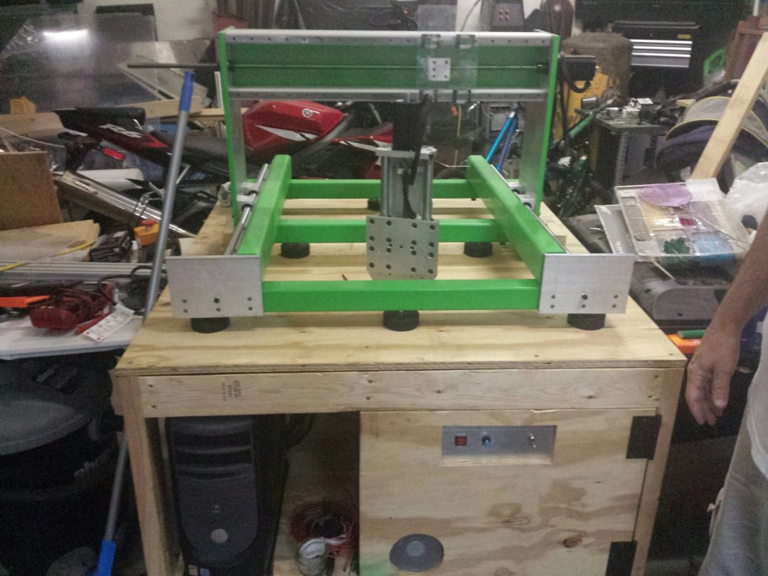

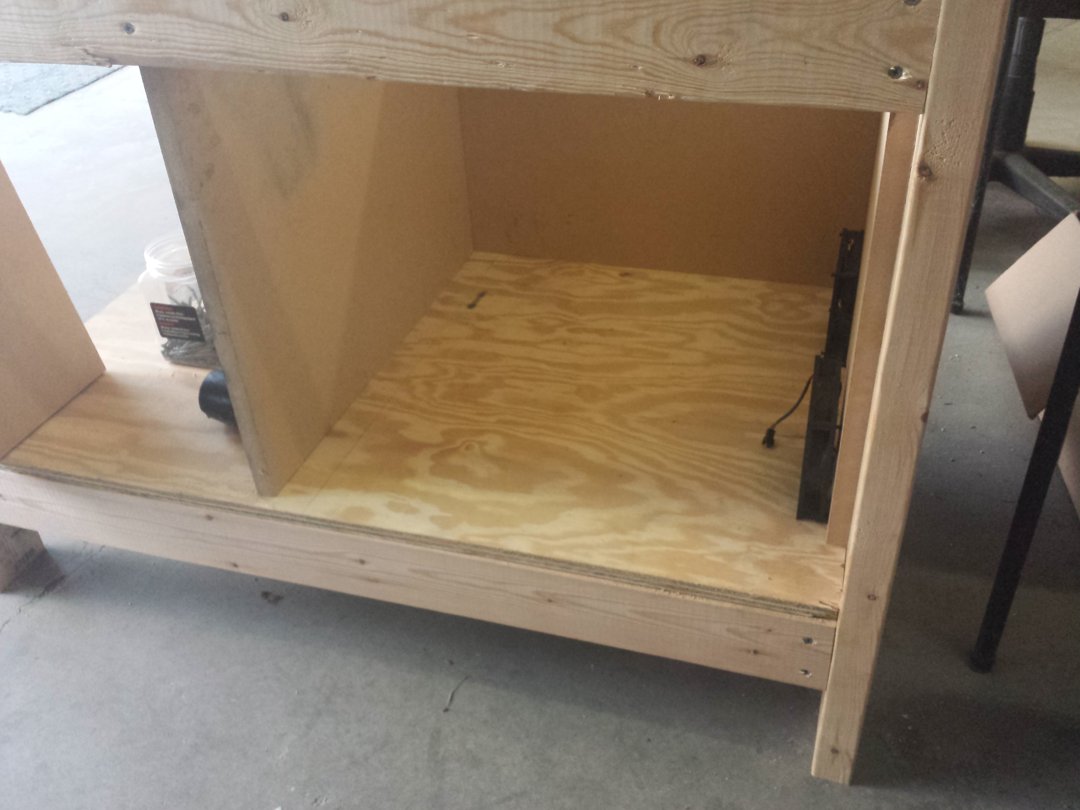

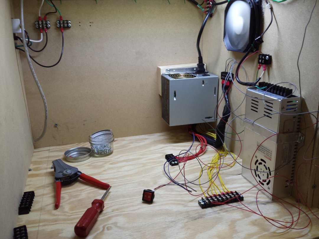

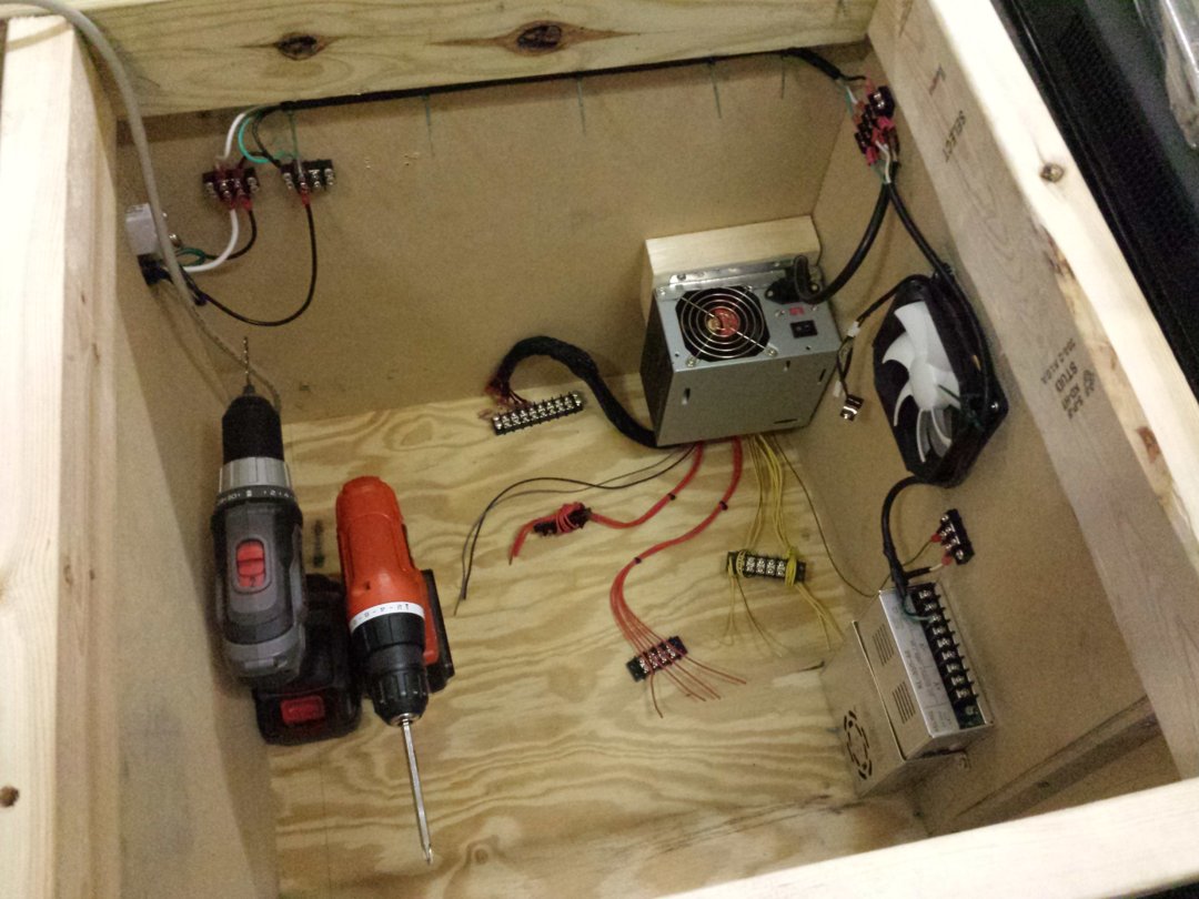

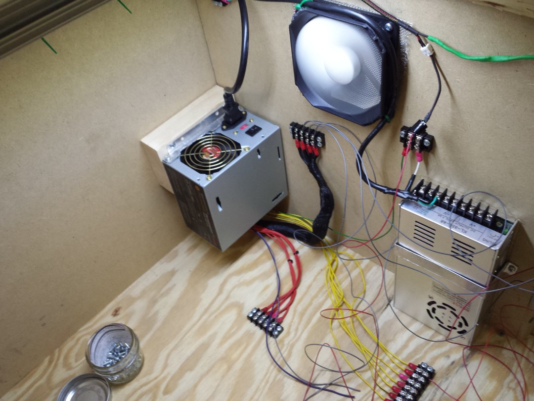

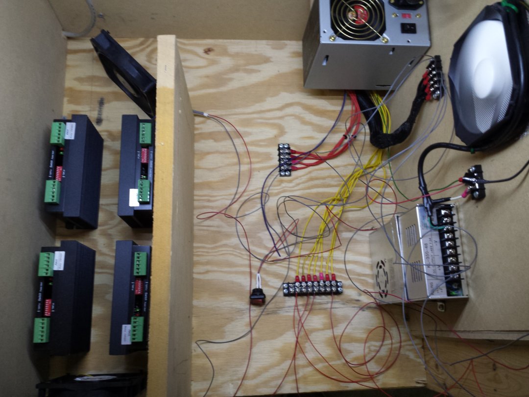

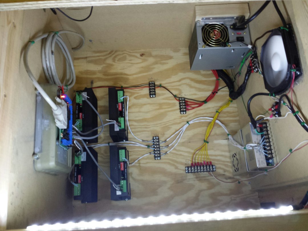

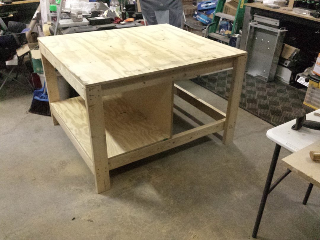

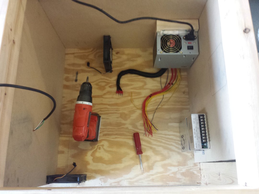

Once I completed the bulk of the machine, I forgot one crucial part to the entire build and that was a bit more permanent of a place to put it. I had been using a piece of scrap MDF to build most of the machine on. After getting it together and seeing the MDF bend to accommodate the weight of the CNC machine, I elected to build a wooden table that was a bit more substantial to support it. It worked out well, and shortly became an electronics enclosure as well. I implemented an intake and exhaust fan in strategic locations and started wiring all of the necessities to their respective locations.

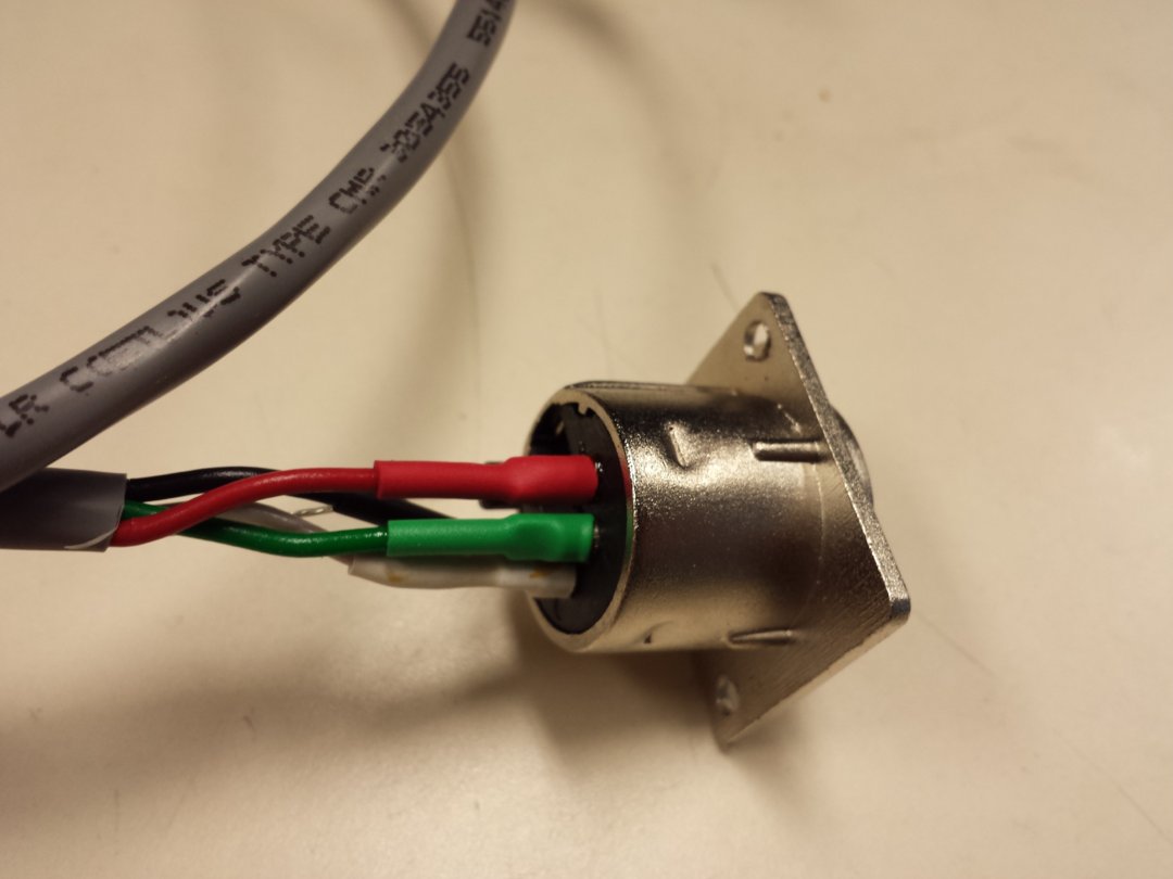

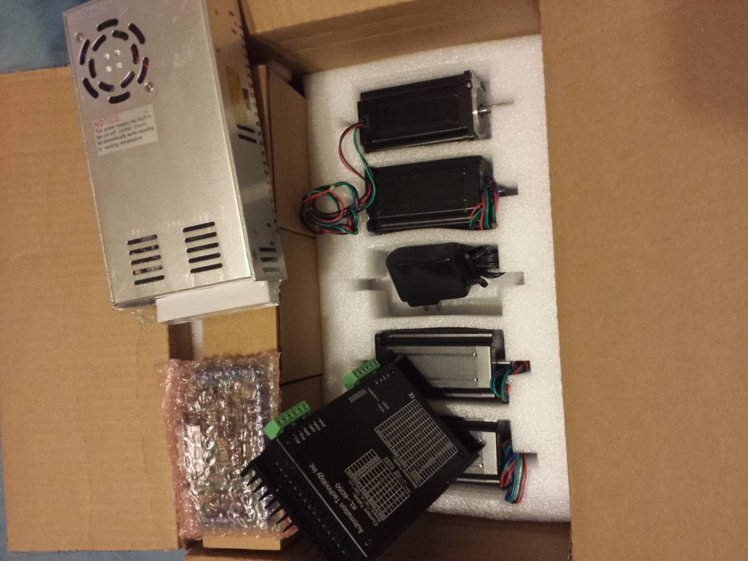

For the power supply I used a 48v 7.3 amp DC power supply. Again, this is an area that took an extra bit of thought as to what power supply to use to accommodate to what driver and which motor. I knew I wanted a Nema 23 framed motor, and started from there. I elected to use some 381 oz. in. Nema 23, 3.5 amp/phase motors. This was a great choice, and provided plenty of torque for my application and lead screw selection. I paired these motors with Keling KL6050 drivers, and have not been let down yet. The ease of setting up these style drivers leaves little to be desired. As for the wiring between components, I utilized 16g twisted shielded pair setups on 48v DC power delivery, and twisted shielded wire groups to any signal carrying wire. The Breakout board is a C-10 type board and it came with a neat little wall wart power supply. Before installation, I powered up the components to ensure communication between the Dell Dimension E310 I found laying around my house. The plug in 5 volt power supply I received with the C10 instantly burned up. I was at a loss. Call the manufacturer, and wait a week or two for a 5 volt power supply? No thanks. I nabbed a Thermaltake PC power supply from my local electronics supplier at a steal, and modified it to provide the missing 5 volts DC. The bonus about this is, I suddenly also had access to a 12 volt DC power supply, which comes in handy for a ton of other accessories CNC machines are known to have (Mainly LED lights, but can also serve to control relays, inductive limit switches and even 12v DC water pumps for charge cooling for future upgrades). The best thing in my opinion about using a quality PC power supply is the power comes out very clean, and can provide some respectable amperage in regards to the 5v and 12v DC rails.

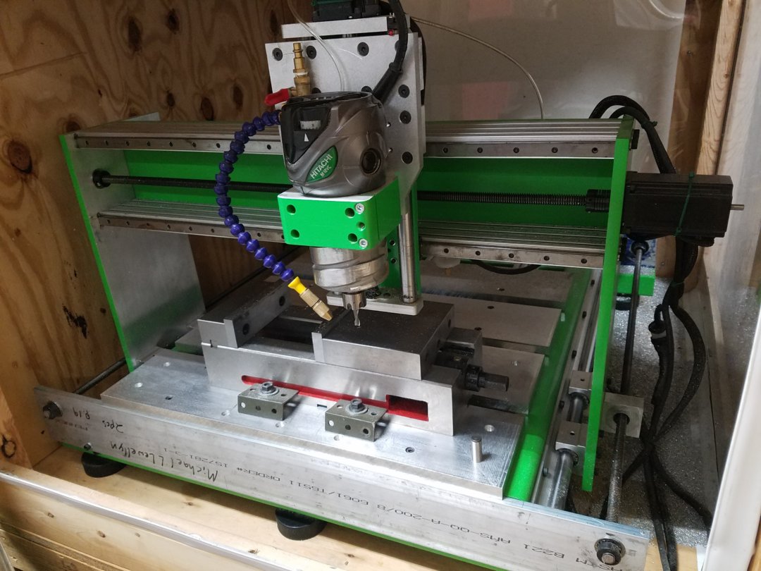

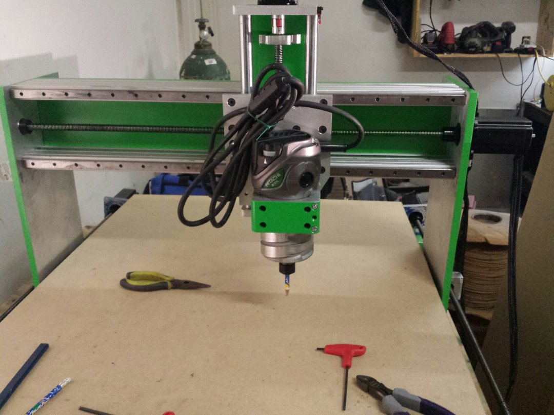

With everything connected, preliminary movement tests complete, it was time to mount the router. The cutting tool I selected was the Hitachi M12VC. Cost was certainly a driving factor behind this, as well as a wide range of high speed, low run out collets that were available. In addition to this, it has a class leading noise level of 79.5 dB and electronic speed control which helps in varying loads for keeping the router speed steady. I purchased the router through Amazon, and the collet set from Precisebits.com. Included with their collet set was a calibration indexing blank with TIR <0.000050", which proved to be helpful to ensure proper collet seating. I am happy to say that this set of collets improved the routers runout, and was a 'no brainer' in my quest for accuracy.

Work Envelope: 26"W x 30"L x 6" Z travel
