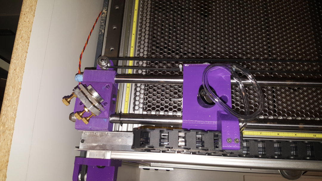

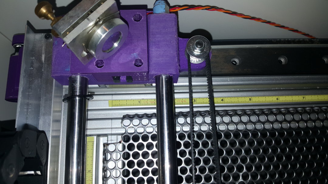

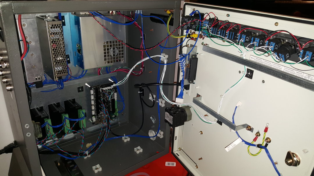

I ended up buying and ebay special K40 Chinese laser from ebay. Within an hour I was tearing it apart and building upgrades. There was so many improvements that needed to be made and were relatively easy to do. First thing was to remove the bed and install my own. Next I removed the vent and build my own. Then I needed a new controller because the hacked version of Coreldraw was horrible!

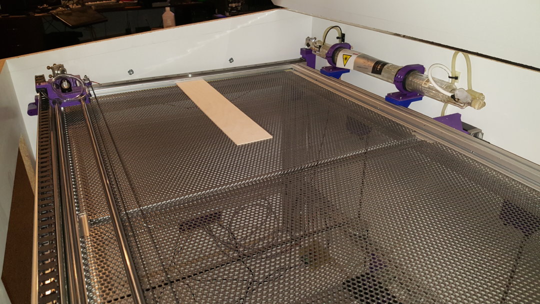

Pretty soon my K40 had expanded to a bed size of 12" x 24" with a 2 inch Z bed and pretty soon I wanted more! I wanted to put my guitar in it. I wanted to put my coffee table in it. I wanted to put anything I wanted into it but the limited space made it impossible.

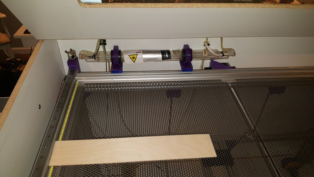

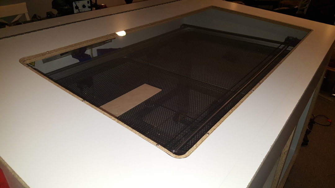

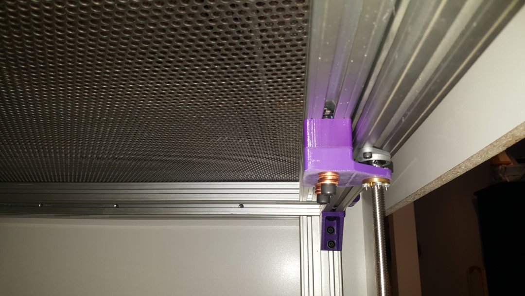

I decided to go for broke and make the largest laser setup I could with all the bells and whistles. I was able to acquire the many feet of 8020 aluminum extrusion. I took my time modeling all the parts and features. I should mention that because the 8020 was already cut (by the previous owner), I was limited to the sizes I used based on the lengths of material I had available to me. That's partially why it has a bed of 37 inch x 51 inches and not something nominal. The z bed has a travel of around 12 inches. So although I can't put my coffee table in it, it sure opens up a lot off doors to other things to cut or engrave.
