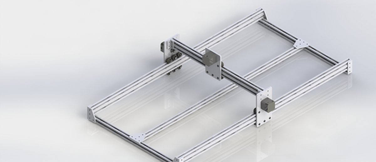

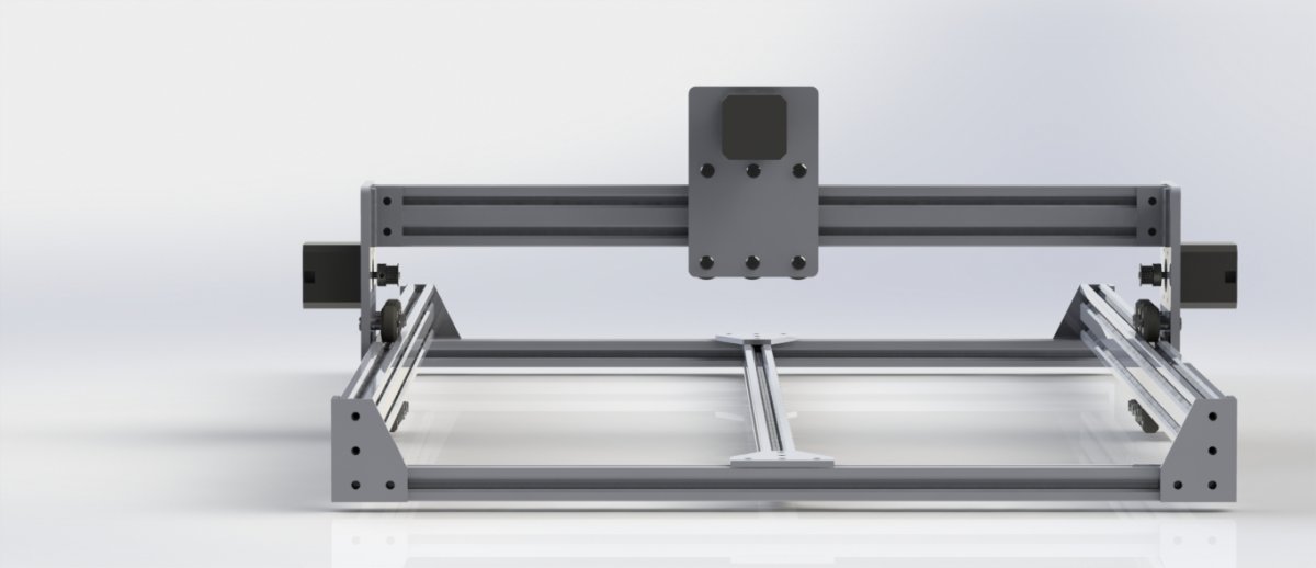

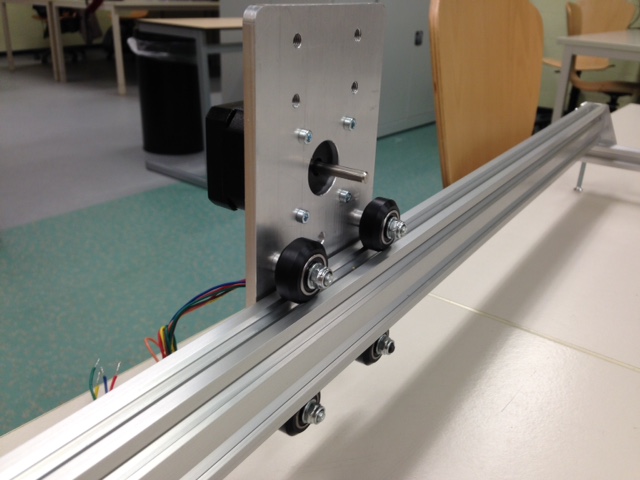

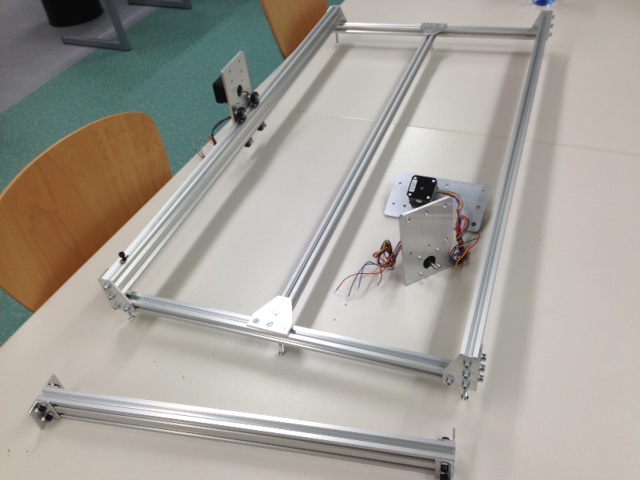

The team designed an XY-table as a basis for this project, keeping in mind that later on drivers, powersuppy, lasertube and mirrors, exhoust extraction and a protective casing have to be added. The design is made from Openbuilds parts, which we also used in our CAD model. It is based on many projects on this site featuring the OX configuration. The minimal workspace was requiered to be at least 300 by 600 mm, but we exeeded this by a lot.![]()

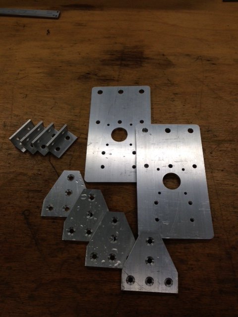

Steppermotors used are NEMA 17 with 0.9 degrees per step. We wanted to produce the mounting plates ourselves, becouse at our school we have access to a CNC mill and aluminium plate material was given to us for free by the workshop.

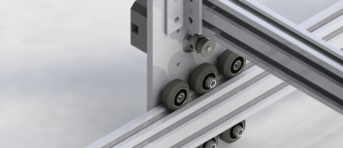

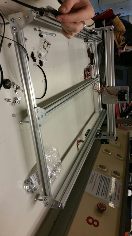

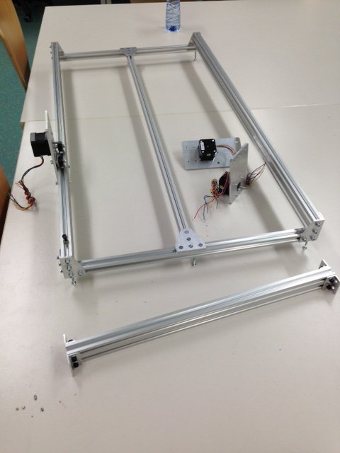

Unfortunately when we assembeled the frame, we encountered a problem. The wheels we ordered had a bigger diameter (which is good) than te wheels in our CAD drawing. That ment we had to make the plates again with slightly different dimensions. Final assembly of the frame could contiue and we were happy about the high stiffnes, low friction and low slack the assembly provided.
Fixation of the timing belts proved to be very difficult with the standard plates that slide in the V-slot. We will probably improve that later on. Also the corners of the axis that is mounted between the two plates are not very stiff and screwholes are positione too close to each other. Other than that we are happy with the result.
