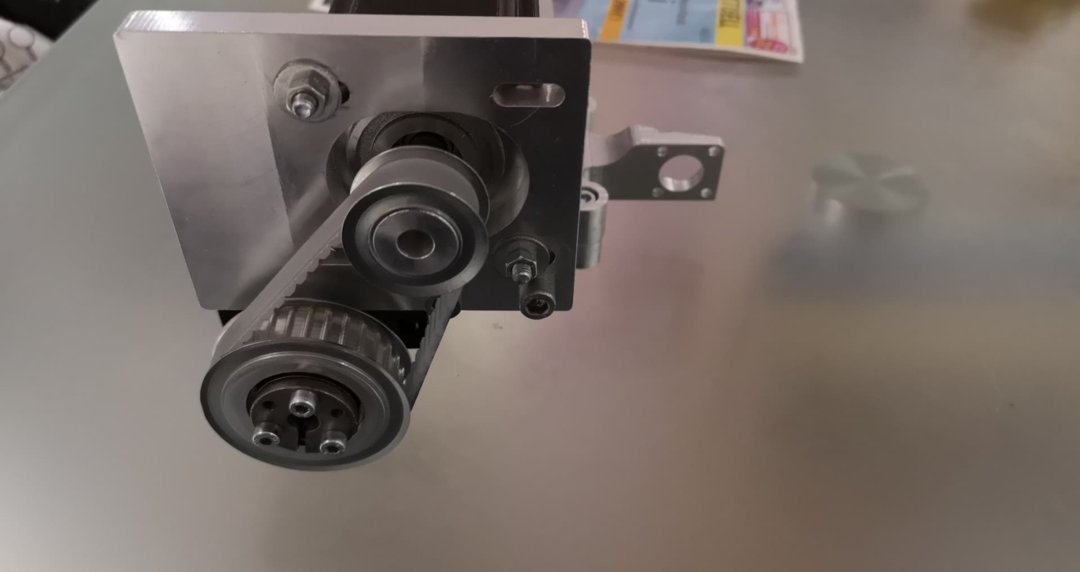

The main axis are from Festo DGE-25-ZR-KF, with Timing belts and linearrails in 25mm, working distance 650mm, Vmax 10m/s
the Y axis is Festo DGE-25 SP-KF, with ballspindle in 1605 and linearrails in 25mm, working distance 930mm, Vmax 0.5m/s

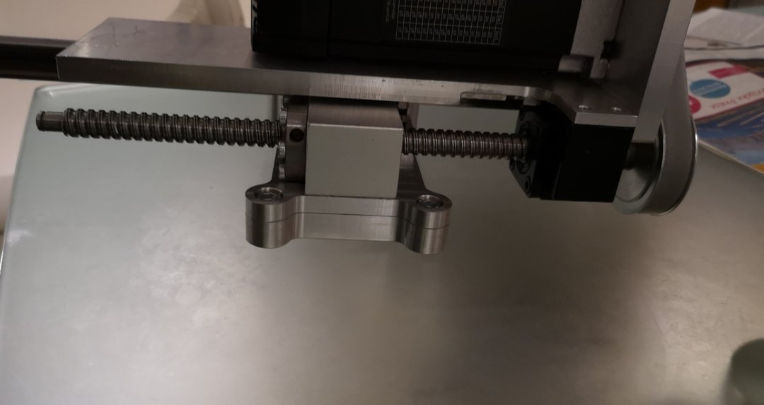

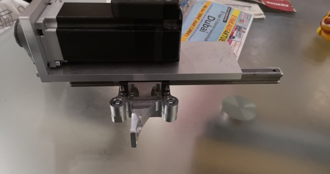

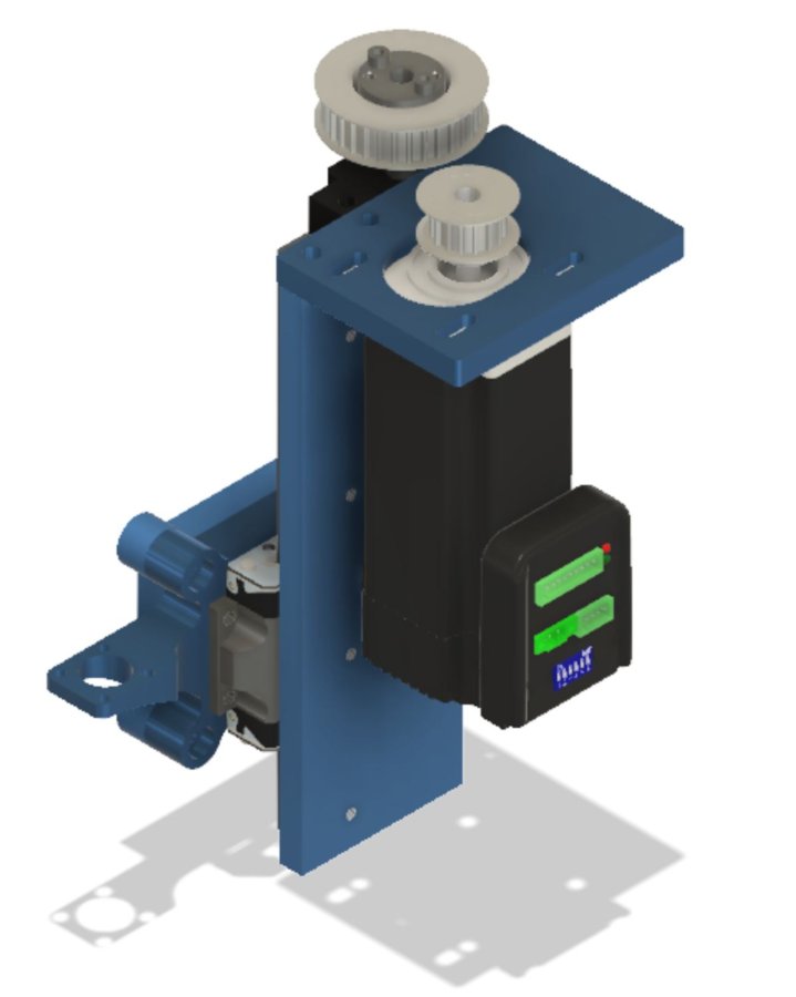

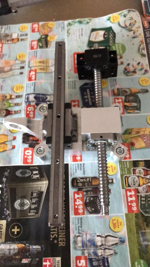

The Z axis is divided in two parts. on the top. Support the laserhead up.
The other part is movable down to 130mm. Guided linearrails in 15mm and ballspindle in 1204.
This mobeable part presents to Focus the laser to the working Level. Special Fittings needed to put a miniscus lense inside. futured to take two miniscus lenses, to have hp laser and a Incredible small laserpoint for example: engraving.

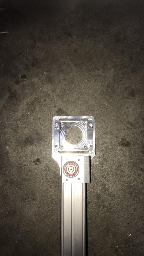

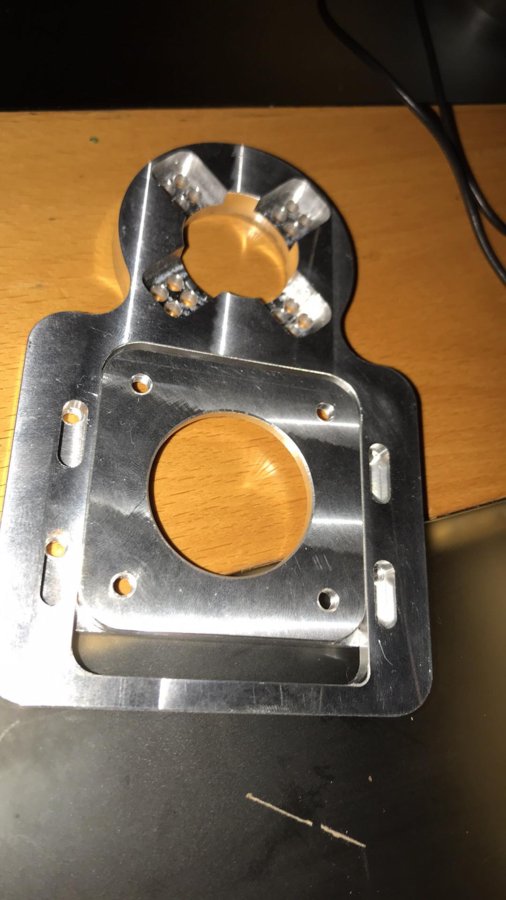

Every support is made by my own and on DIY Mill mashine.
