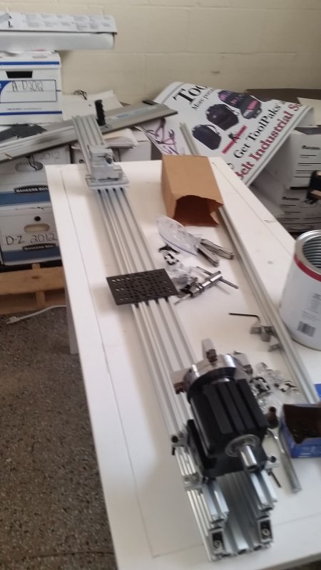

I have decided to use V-slot linear rail and have purchased a couple each of 1500mm sticks in 20x60 and 20x20 along with various fasteners and plates. Everything came in yesterday, so I hope to start a preliminary build this weekend.
This is my 2nd CNC build. My first was a router from Inventables. I didn't find OpenBuilds until afterwards, but V-slot seems MUCH more versatile than the "MakerSlide" offered by Inventables.

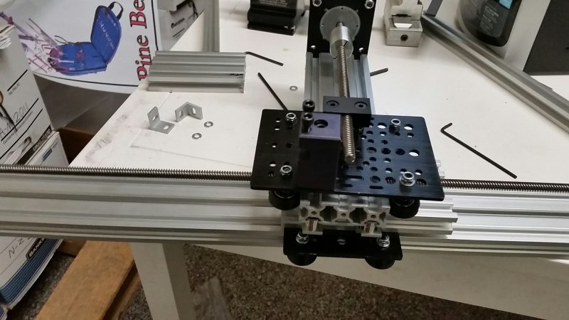

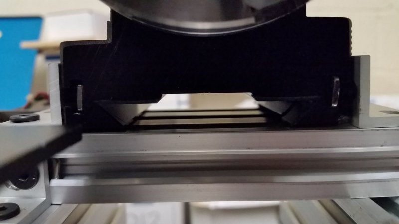

Trying to show a little progress with some pictures... The pic below shows how perfectly the Taig Headstock matches the open builds corner brackets... It's really great stroke of luck!!!

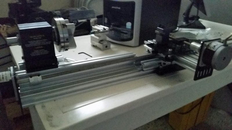

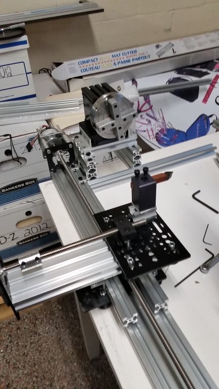

The below is just another overview of the whole thing for critique!
THE ABOVE picture shows this as it is "planned" so far. This is actually sitting a little to the right (facing the chuck) of where I was considering after realizing the original plan was never gonna work... I am wondering about the "rigidity" of it being that far from the carriage as it will create more "torque" on the carriage the farther away it is.... oh, well, that is where it is staying for now and up until I can test run the machine with either Brass or aluminium (or I may get real crazy and try steel).
Trying to figure out what kind of motor to use... I have some laying around, but I want this to be "pretty." We'll see what I can dig up out in the bone yard!

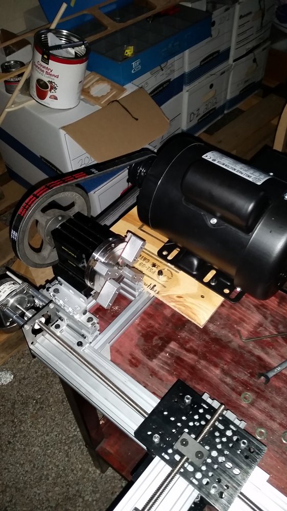

Ok, After a 4 month delay, I've made some progress: I got the spindle motor mounted!
I used a Single-Phase, 56C-frame, 1/2 HP motor @ 1750 RPM (anything between 1725 and 1800 would be the same thing, it's all in how the manufacturer labels it).. This one is from a Chinese manufacturer called Worldwide Electric.. It (or something similar) can be purchased at YOU LOCAL MOTOR HOUSE for around $100-$150... There are many of these type motors on Ebay, you just need a motor you can bolt down, but here is the one I bought from a local dealer (Worldwide Electric GP Motor NT12-18-56CB, TEFC, REM-C, 1 PH, 56C, 1/2 HP, 4.4 FLA, Less Overload)
I also added the pulleys and a belt, which can probably also be picked up at the motor shop or a small engine repair shop or even tractor supply. I used a 2" pulley on the motor and a 6" pulley on the spindle head. This gives me a spindle speed of 600 and 54in/lbs of torque, which means it WILL RIP A FINGER OFF your hand!!!
As you can see, this is not rocket surgery... I simply bolted a board to some "single" rails and bolted the motor to it. The belt can be tightened where the board attaches to the rails.. just loosen the bolts and pull the board-and-motor away from the spindle and then lock it back down - simple!
