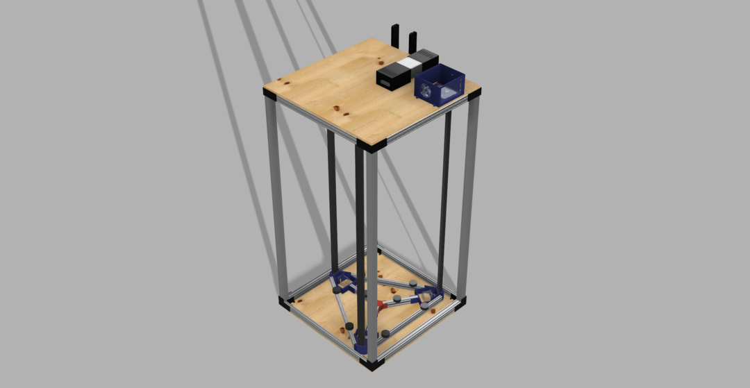

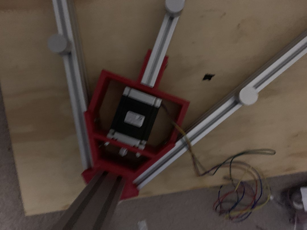

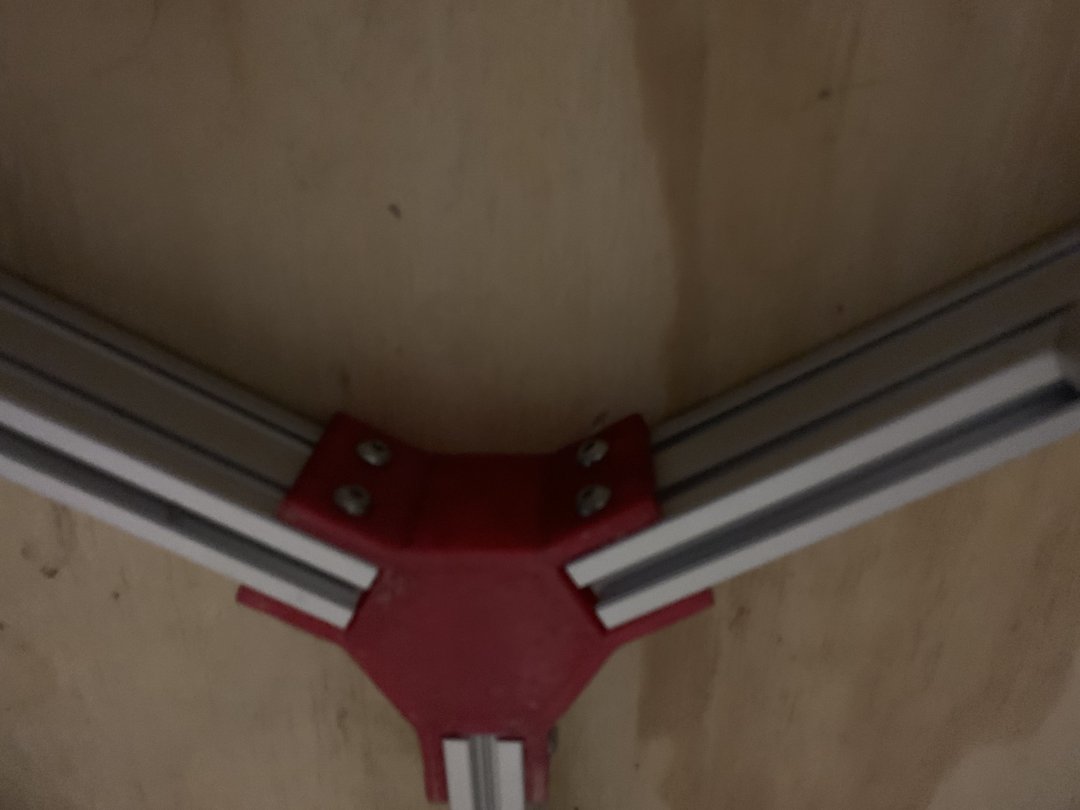

Here's the main structure.
The main structure consists of 2040 extrusions. It's 5ft(1524mm) tall. There is some wobble at the top but with the enclosure I'm going to have it connect to that to strengthen it up. All the printed parts are PETG. I'm working on a BOM, I'll have it up soon. I'll update this as I go along.
Moved the rest of the pictures to attached files. Figured it would be better for anyone on mobile devices.
Update: 8/31/2019
Updated main picture, to newest 3d model. I've also updated some stl's, the inside top and bottom bracket enclosures won't connected to upright, I forgot to move the hole when I made them thicker, from 2mm to 5mm. I'll update them later. They still work as the outer brackets hold everything very well.
