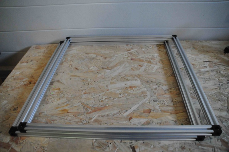

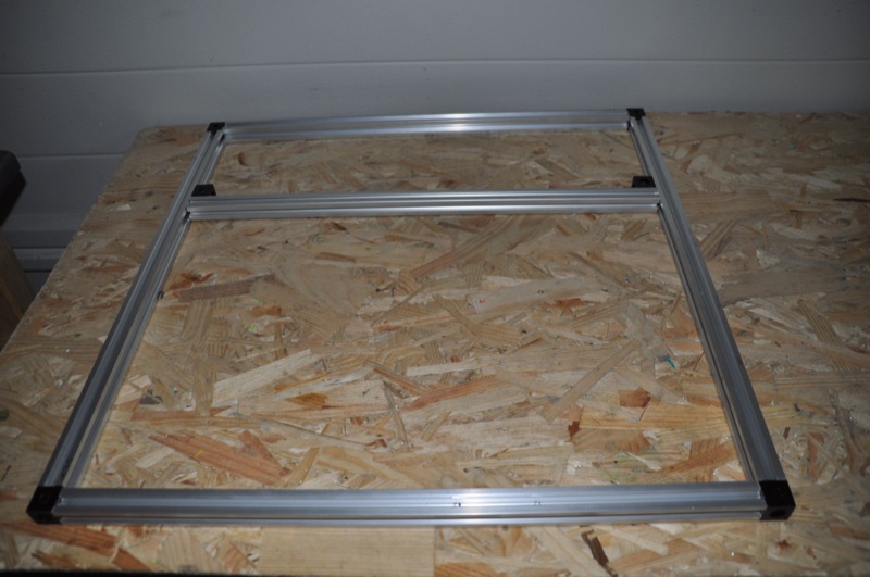

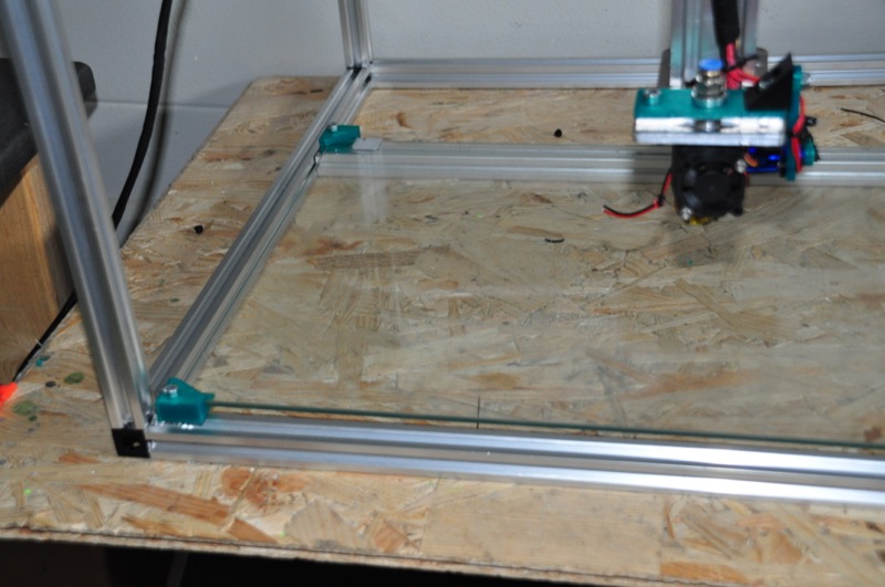

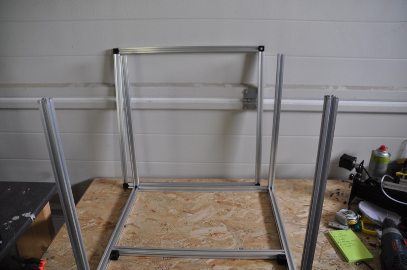

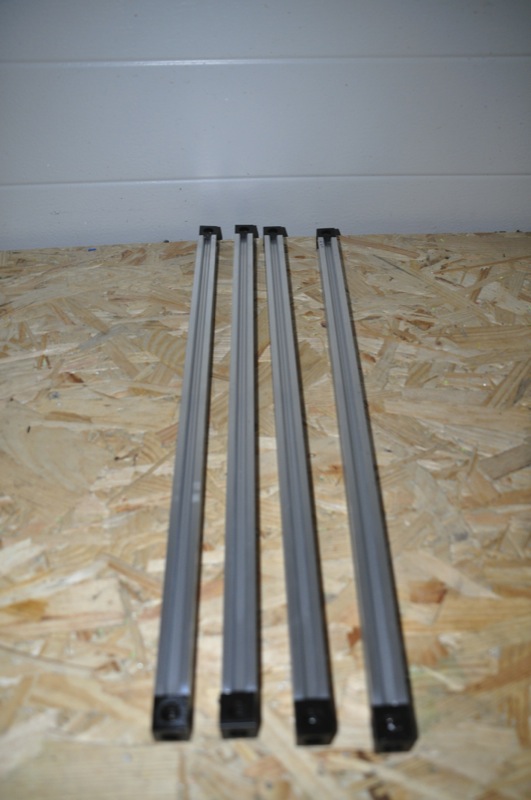

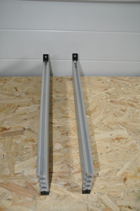

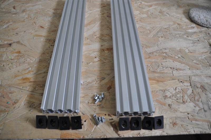

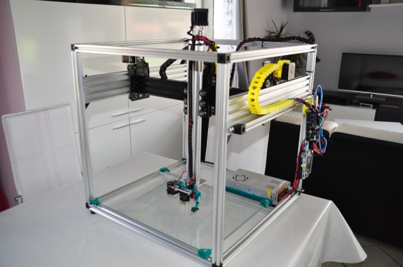

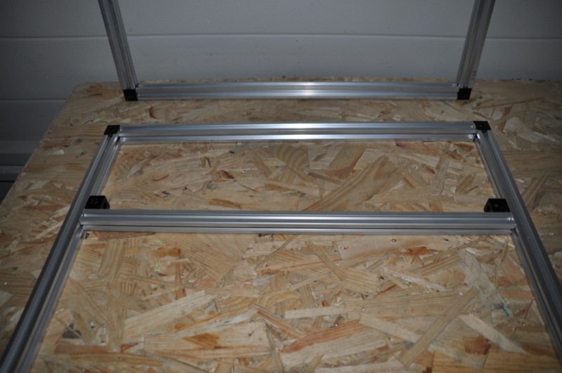

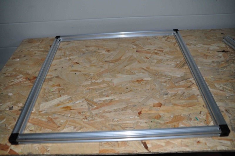

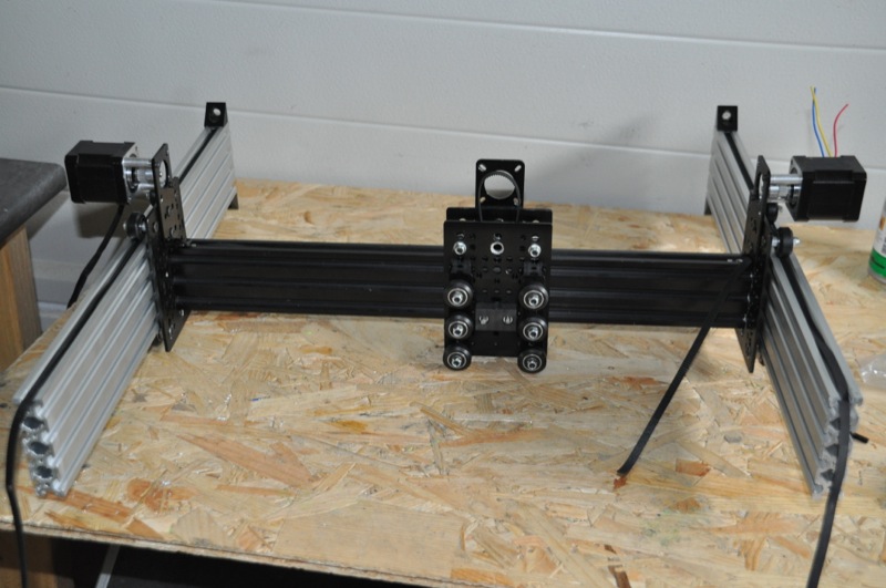

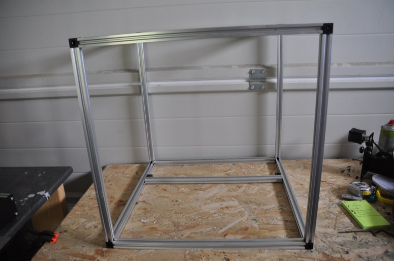

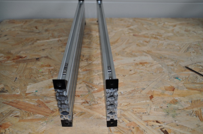

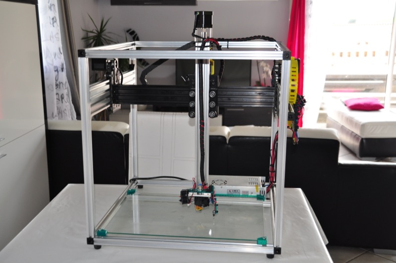

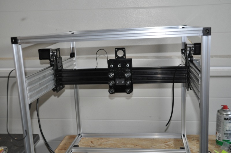

After a Prusa I3 , a Mendelmax 2 , a Vslot Kossel , i decide to build my own 3D printer based on openbuild products,
This 3D printer is fully scalable , so if you need a big printing surface you can build it.
Attention , this work is in progress ...

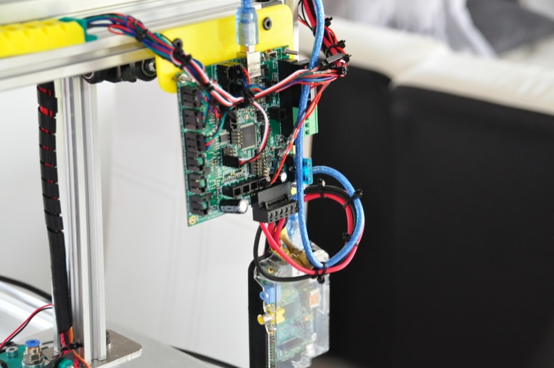

The Ramps 1,4 board was remove . I prefer the Rambo 1,2d Board.
video of the first movements

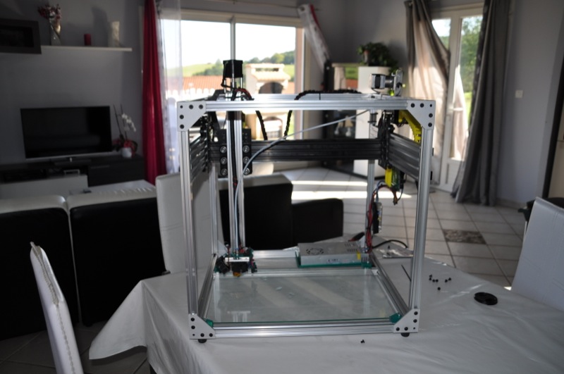

First prints are pretty good , on a 7 hours print ... no problem
I'm uploading the first print video on you tube .. stay in touch
My first big print is finished ...
My video is coming , but it is pretty long to upload due to my poor 2MB connection :-(
Video is avalable ... Enjoy
dimensional test ...Done; OK
Overhang test ...done ; OK
Bridge test ... done ; OK
Very Long printing test ...done ; OK
All works fine

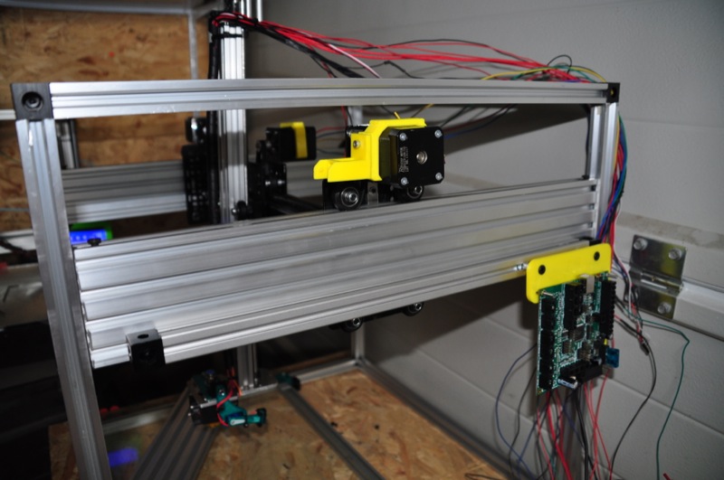

I will just add some mods in few day , like an LCD screen , a spool Holder ...
Mods :

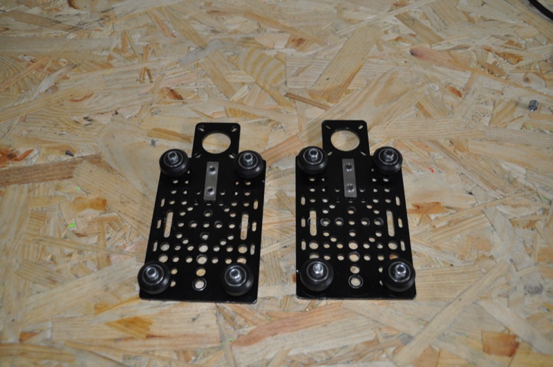

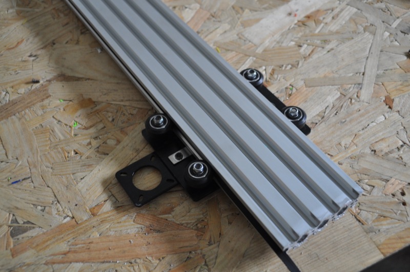

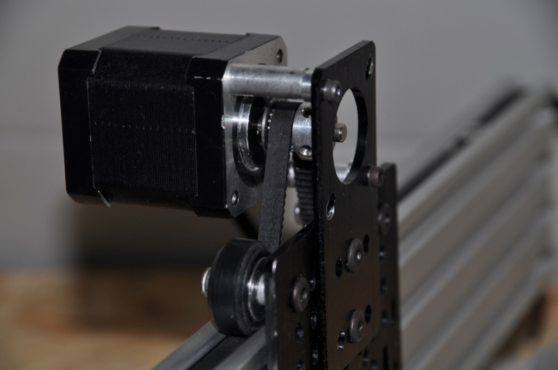

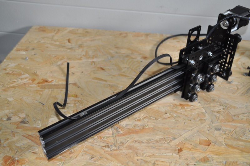

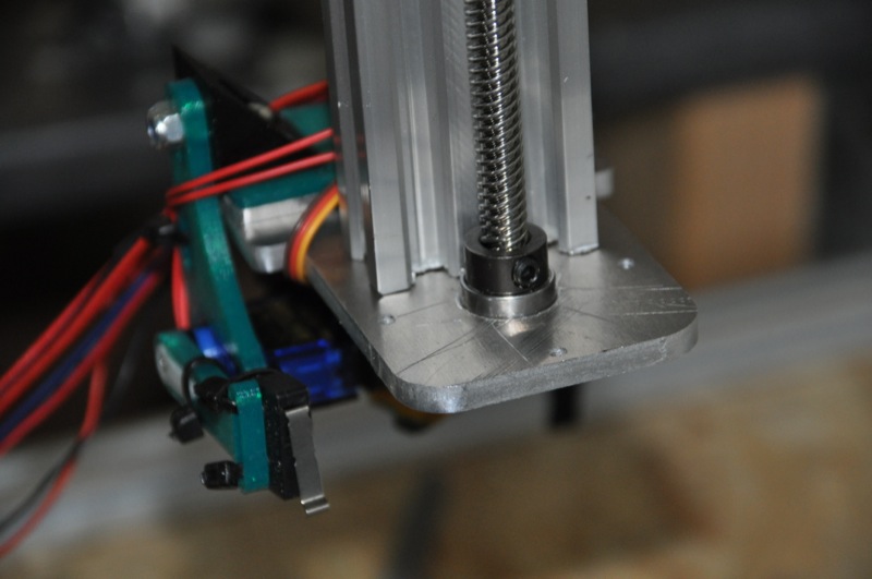

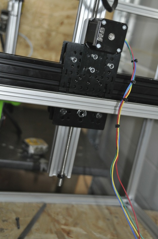

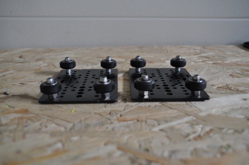

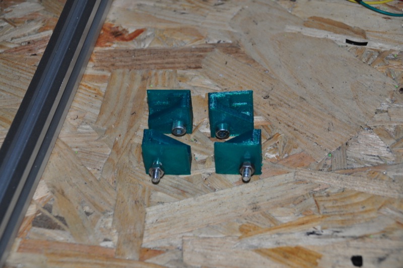

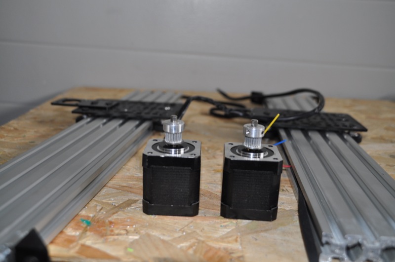

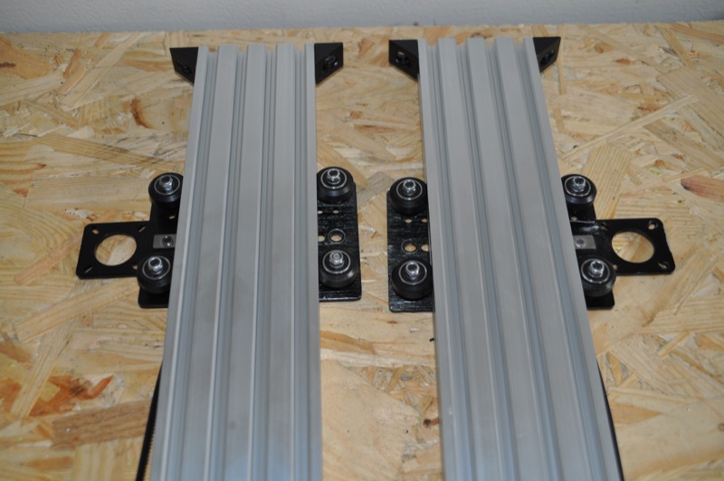

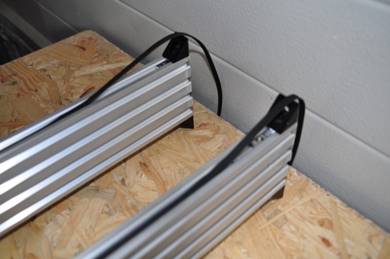

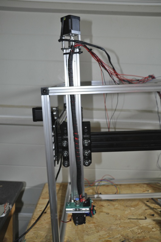

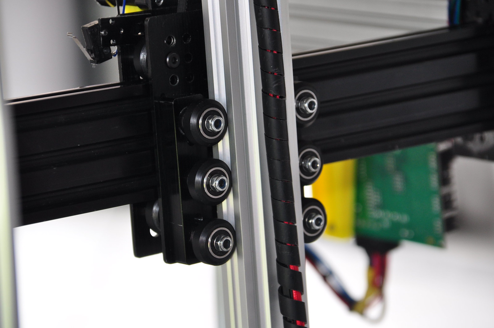

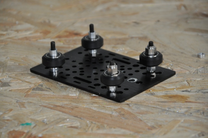

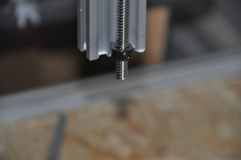

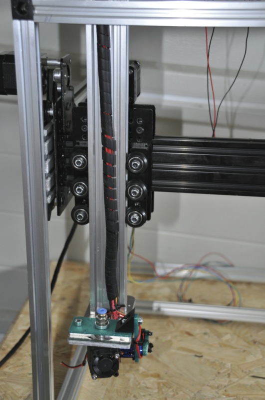

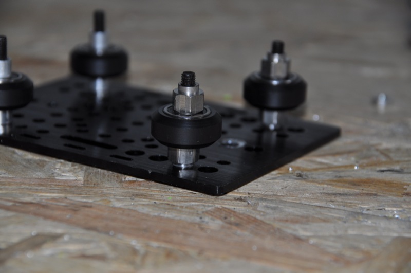

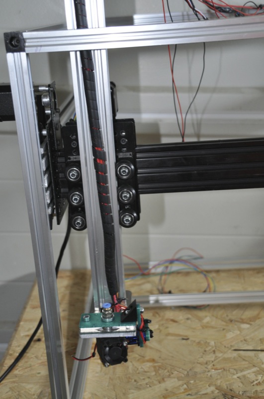

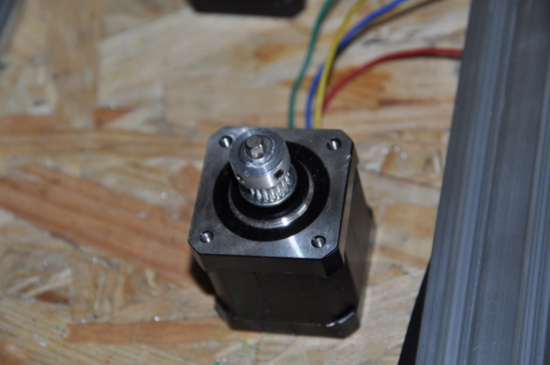

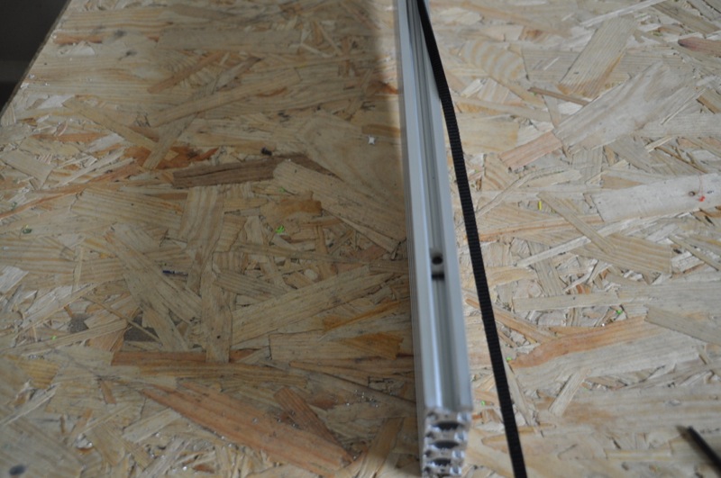

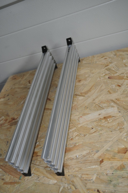

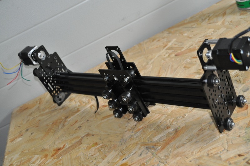

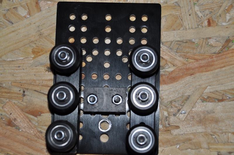

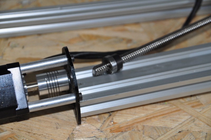

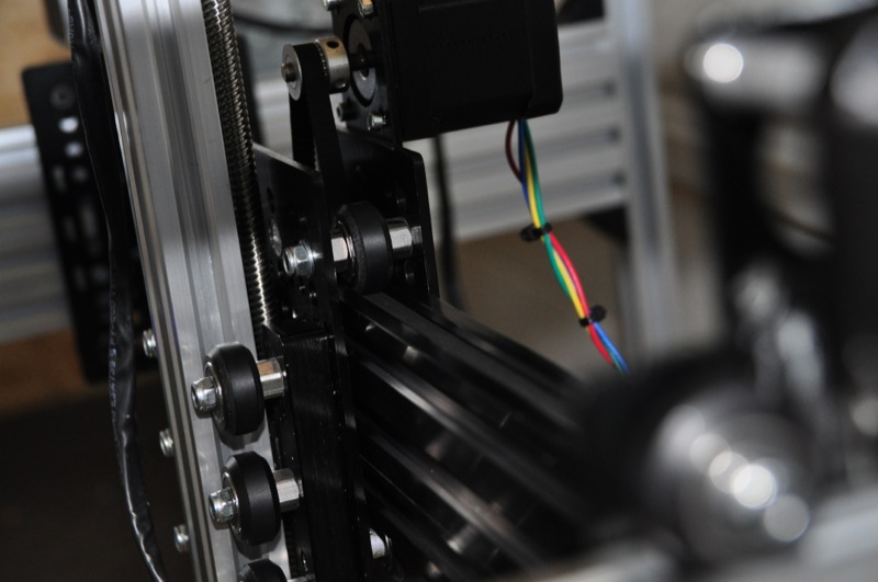

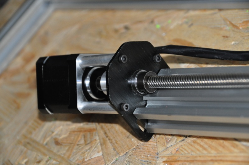

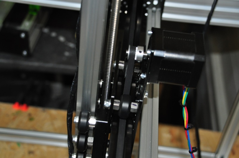

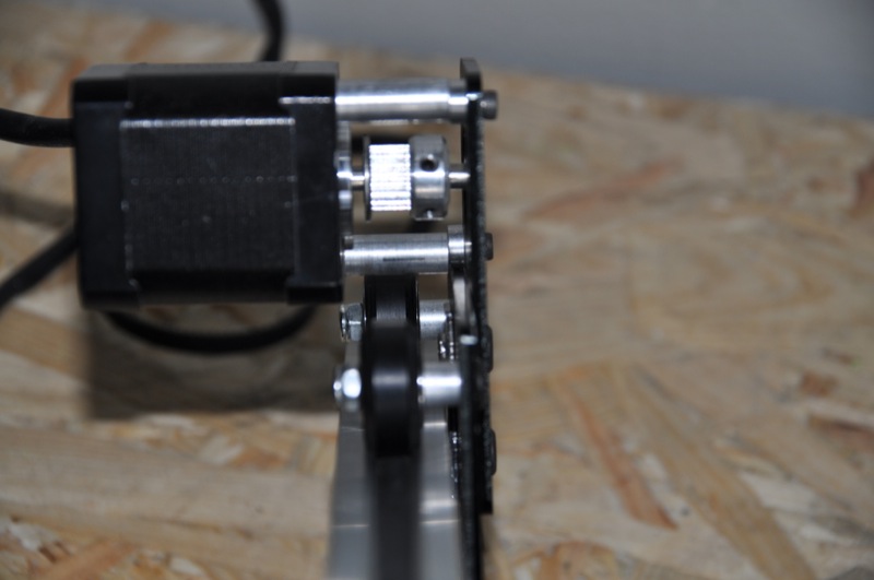

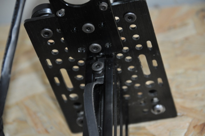

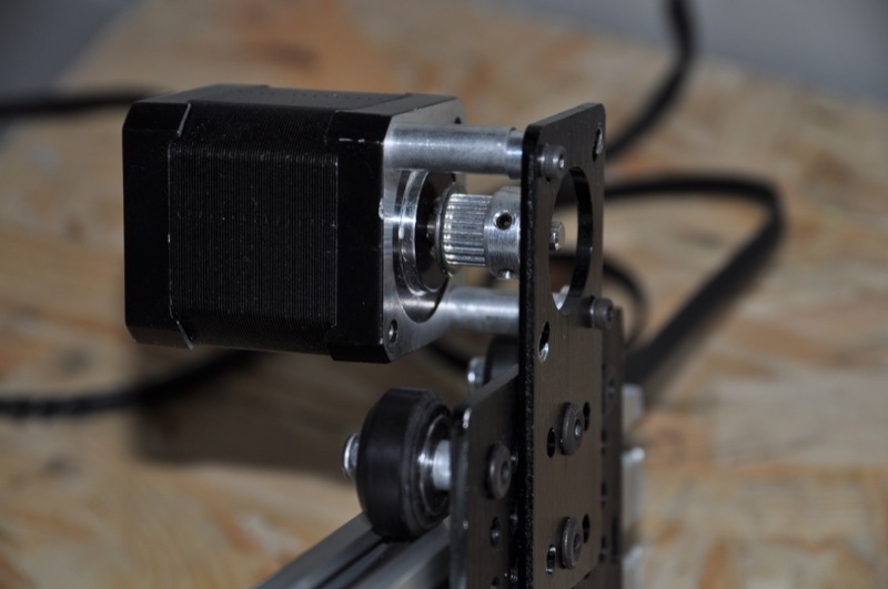

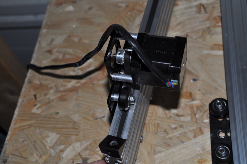

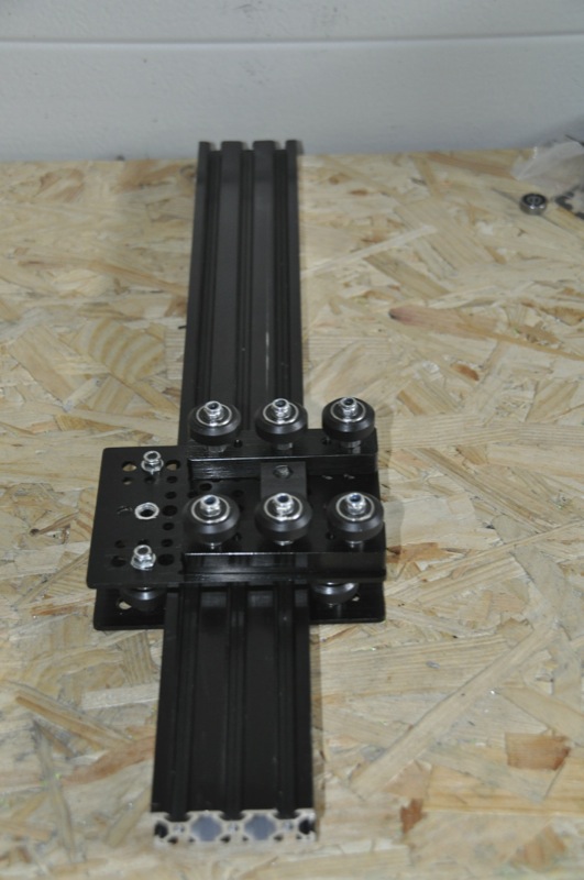

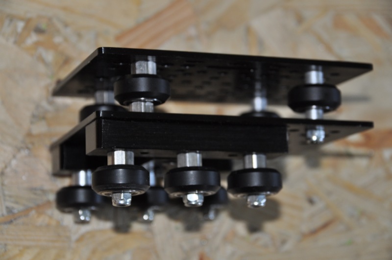

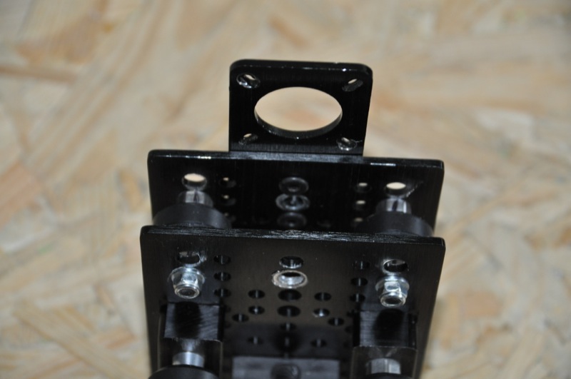

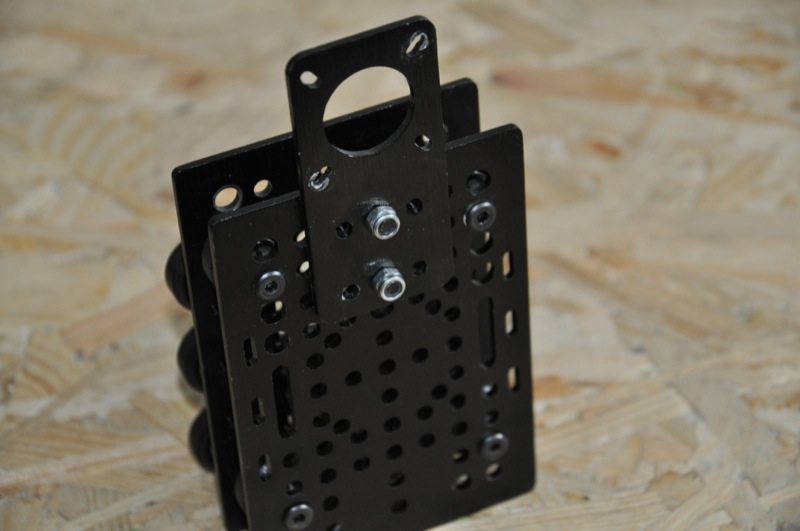

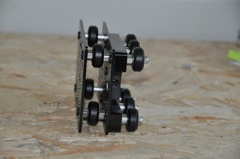

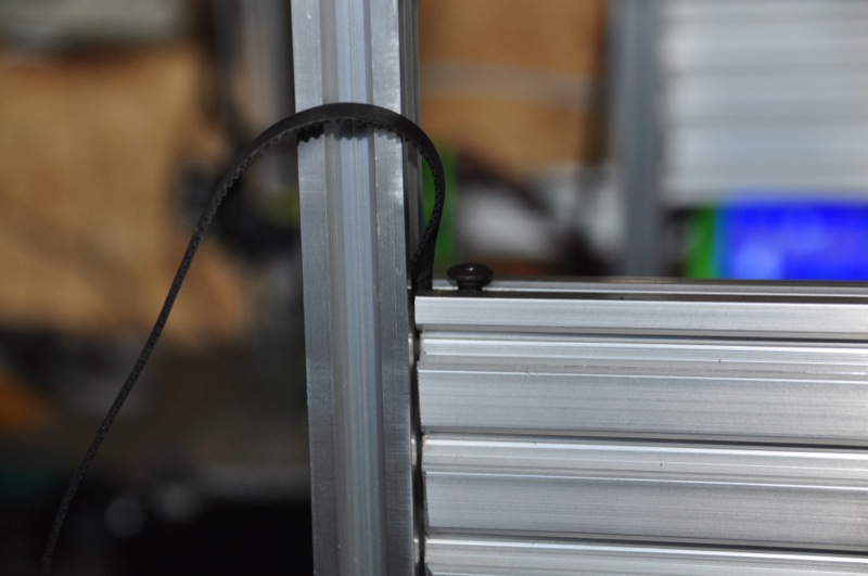

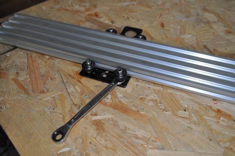

Now My Z axis use 6 solid V wheels instead 3 and Y carriage use 4 solid V wheels instead 3

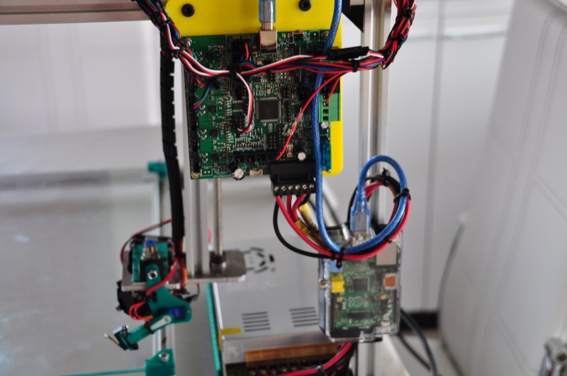

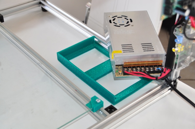

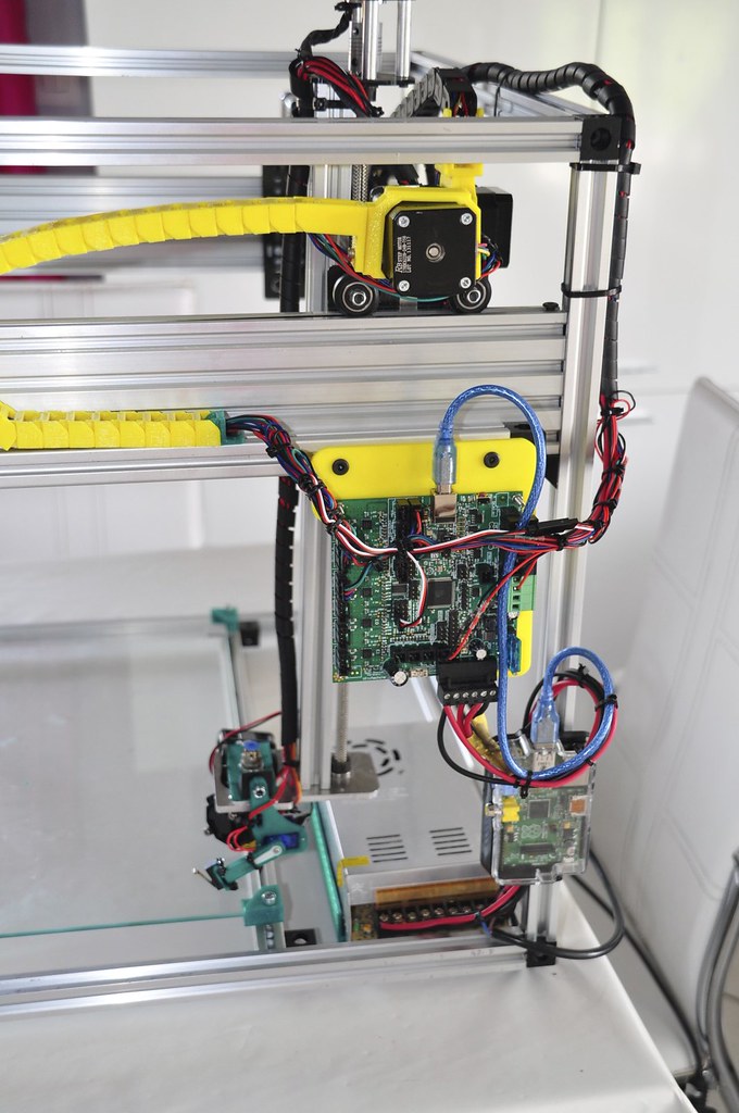

Electronic board is a Rambo 1.2d
raspberry pi mod :
z axis mod :

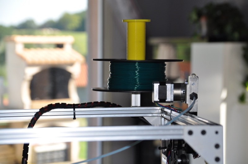

Spool holder mod :

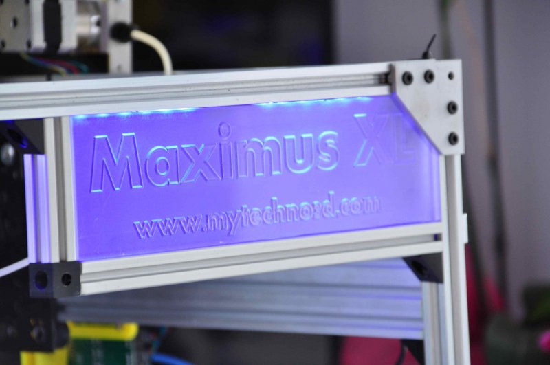

I just add some Led and plexi ...
I just add a raspberry camera ..

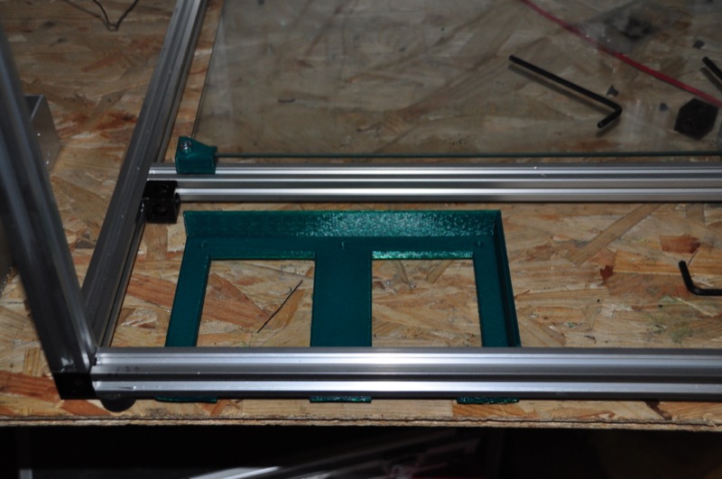

I received yesterday my heated bed (not kapton one but in silicone .. )...
First try with abs at 235°C and heated bed at 100°C ...
It works fine

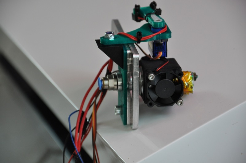

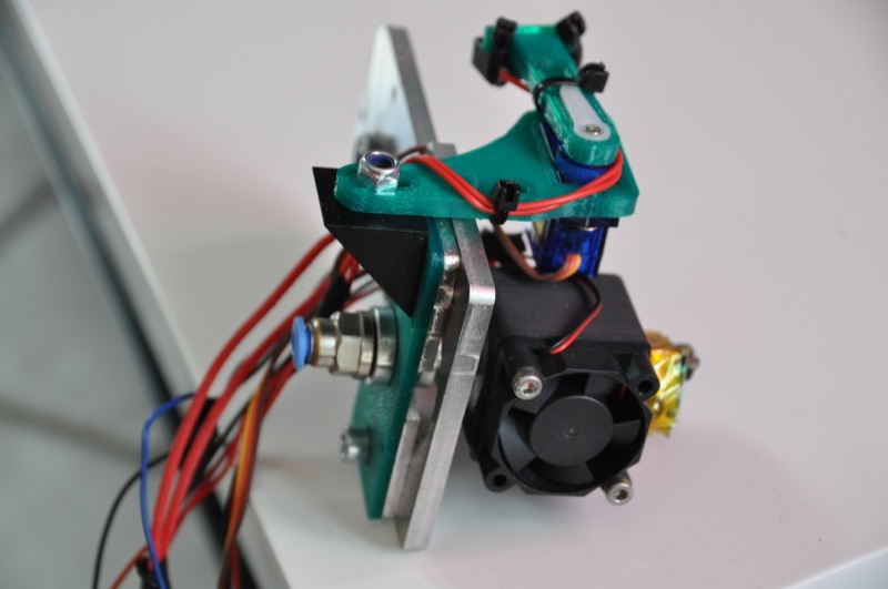

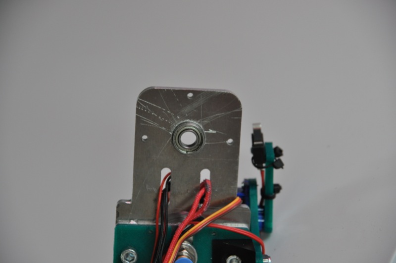

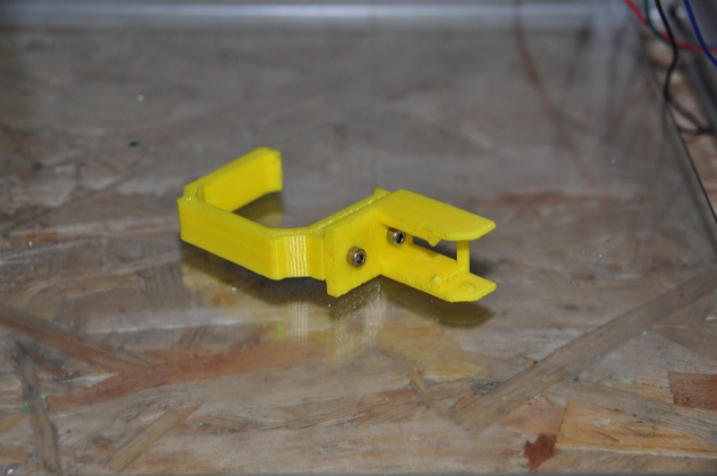

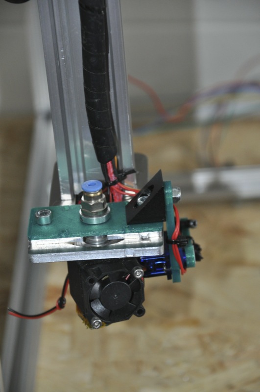

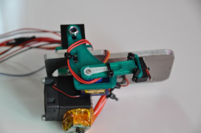

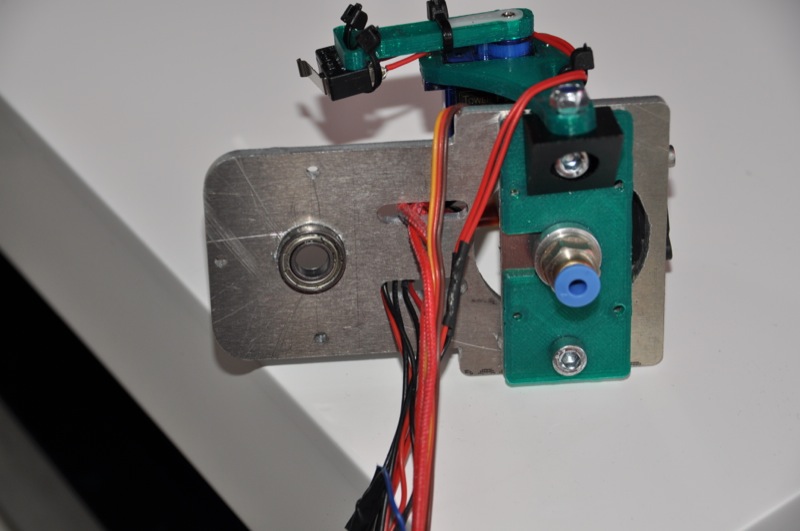

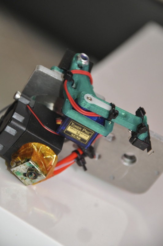

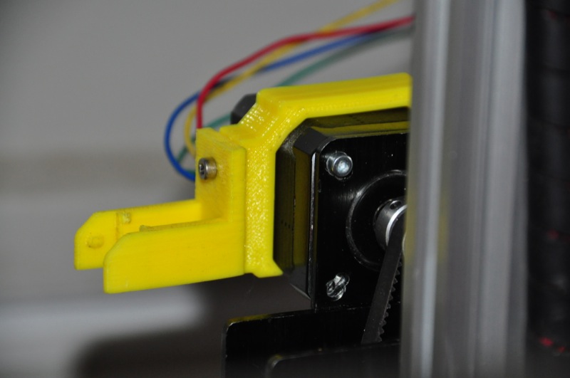

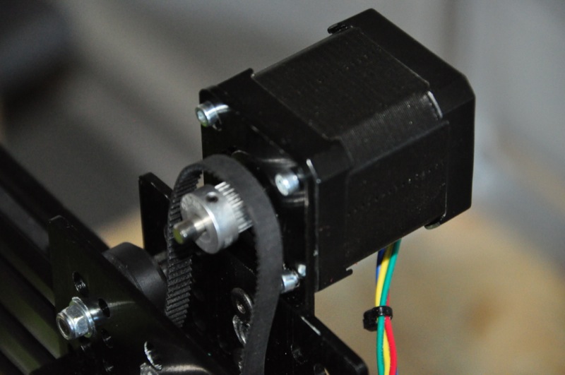

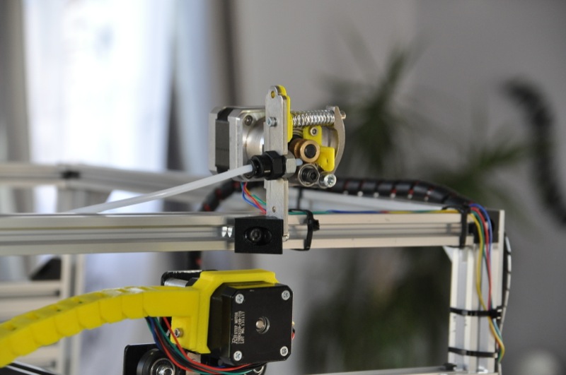

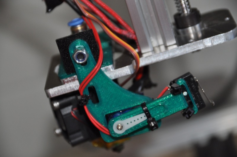

I just make a modification on the hotend retainer to have 2 hotends and 2 bowden extrudeurs

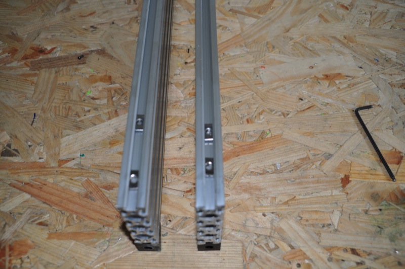

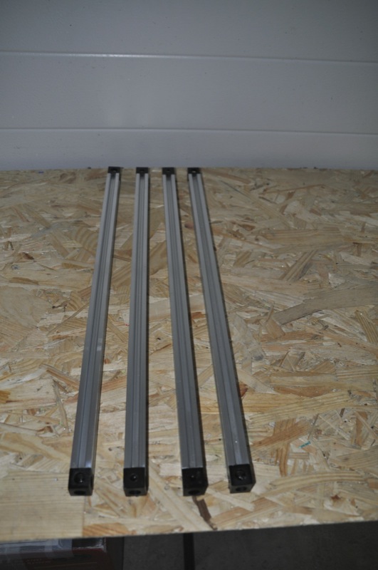

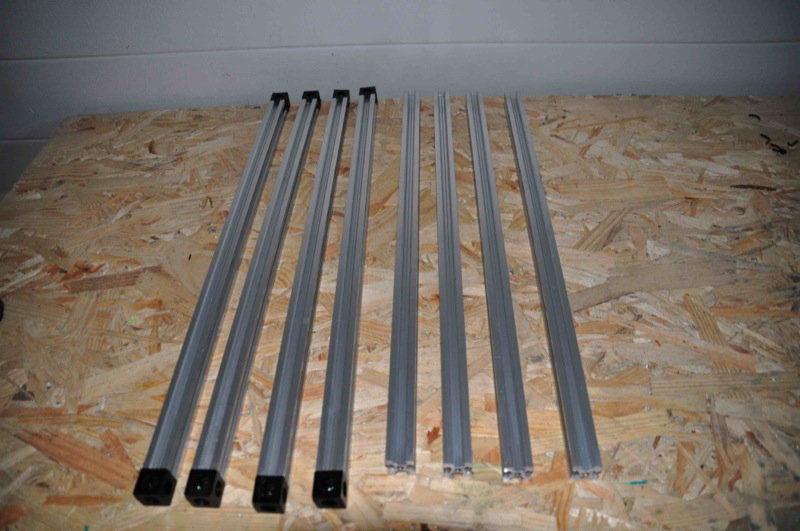

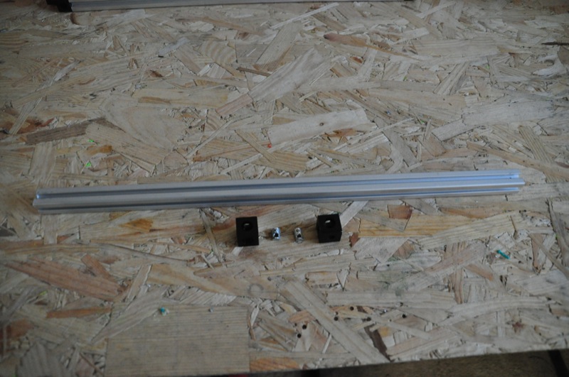

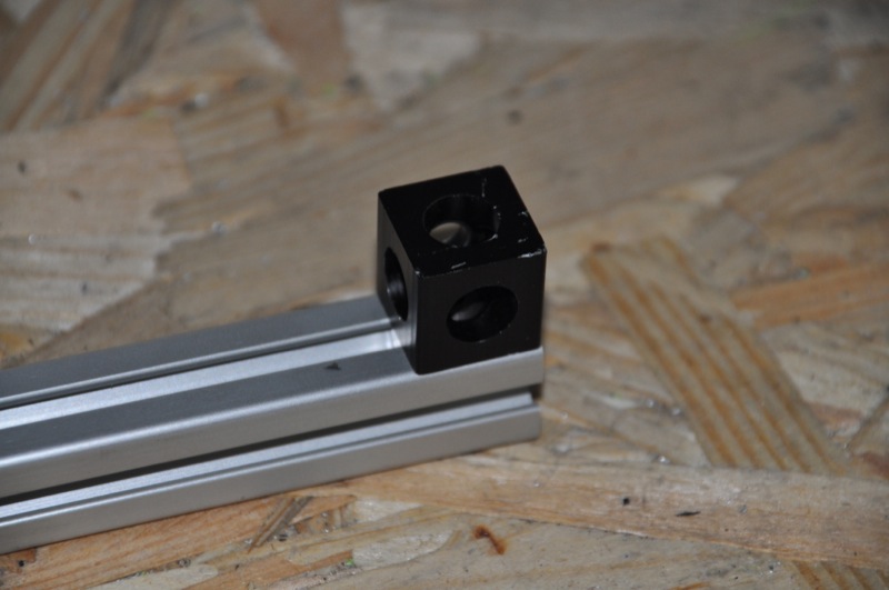

Parts list

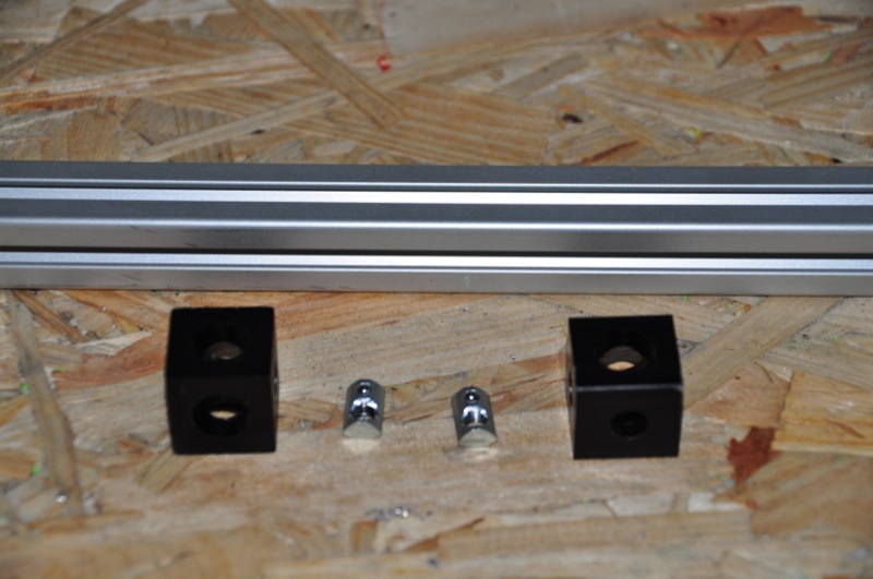

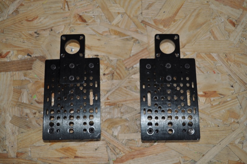

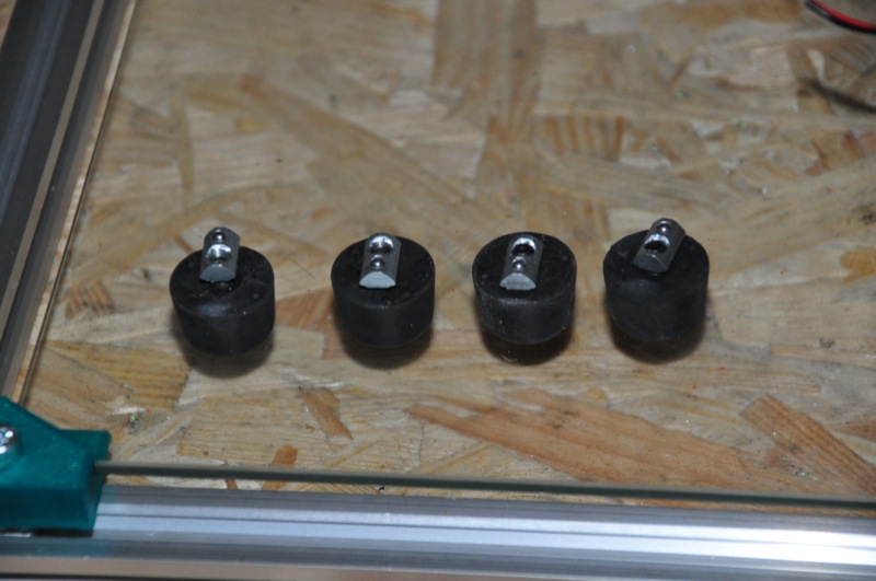

Qty Part Name Part Link Comments 5 20x20 x 1,5m Vslot extrusions ( 15x 500mm parts) Link Frame Parts 2 20x80x1m vslot extrusions Link Y axis 1 Printed parts set Link borosilicate foot , e3d retainer , psu support, cable chain ... 1 20x40x1m vlsot extrusions Link cut at dimension for Z axis 1 20x60x1m vslot extrusion Link X axis ( only need 500mm) 4 Nema 17 motors ( high torque as possible) Link x , y and z axis 1 Power supply 12 or 24 v Link 1 wiring kit Link 1 coupler 5x8 mm Link Z axis ( motor to 8mm acme leadscrew ) 1 Acme Lead screw 8x8 Link z axis 1 8 mm acme nut block Link z axis 2 Lock collar 8mm Link z axis 18 Solid v wheel kit Link 1 Bowden Maxstruder Link 1 Rambo board Link you may want use a ramps 1.4 instead 14 3 way cube corner Link 15 90 degree Angle Corner Link 1 spacer block Link z axis 1 Threaded Rod Plate Link 1 aluminium specific plate( hotend support) Link retain hotend end leadscrew 3 endstops Link x , y and z endstop 1 Fan 40mmx40mm Link for pla printing 1 vslot gantry plate Link x carriage 3 motor plate Link 2 for y axis and 1 for x axis 3 gt2 pulley 20 tooths Link 2 gt2 belt ( meter) Link 4 rubber foot Link 2 688zz bearing Link z axis leadscrew 2 Bowden PTFE 1,8mm ( meter) Link 100 t-nut Link post install t-nut 5mm 10 flat t-nut 5mm Link use to block the belt ( x and y axis) 1 8mm flat head screw Link 1 10 mm flat head screw Link 1 eccentric spacer Link 1 45 mm flat head screw Link 1 1/8 spacers Link 1 20 mm spacers Link 1 M3 screws Link x ,y and z motors
