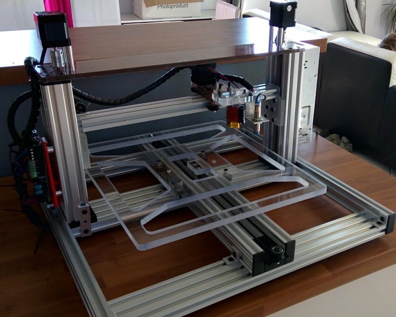

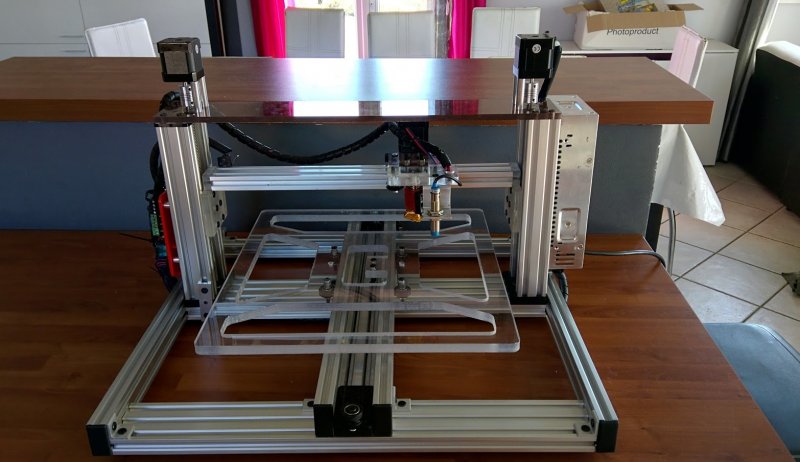

I am proud to present you my new toy .. Of course based on openbuild products ..
I have been inspired by the C-beam machine that Marc just presented us.
I have replaced the ball screw by belts on X and Y axes for faster movements.
Printing area : aroud 380mmx400mm
Bed Autoleving with capacitive sensor
PSU : 24 V 17A
Controler : Rambo Board
Hotend : E3D V6 and Chimera ( soon..)
Extruder : 2 x bowden Maxtruder
Material : PLA / ABS
Heated bed : 400x380 , 24V ,200W ( not order yet )
Steppers : 4 nema 17 and 2 geared nema 17 for extruder

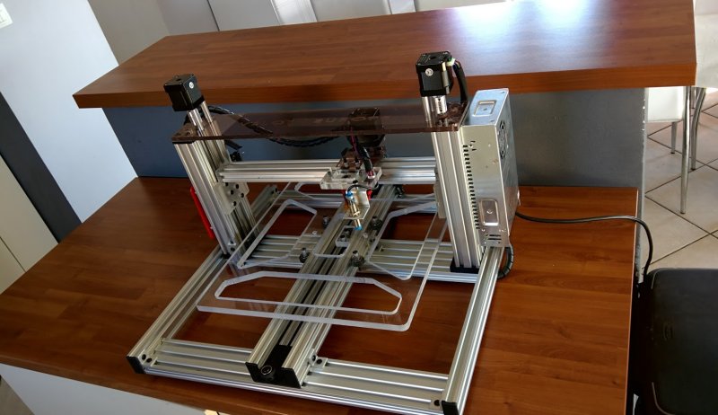

The first movement were made yesterday , i will post a video for the first print.
I hope that you appreciate its aluminum and glass style.

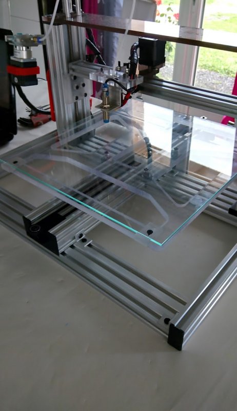

I just received the 400x380 mm glass , i will try to setup the autolevel this afternoon.

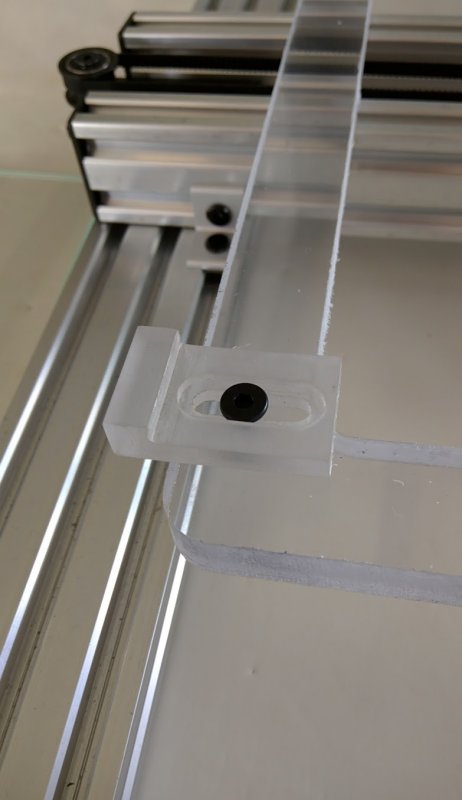

I also make some brackets to fix the glass ( i will post stl and dxf files)
Test of the autolevel :
Glass Brackets :
First Print ( without fan to cool printed part and without heated bed )
This is the real speed , this is why i love openbuilds products , it can be fast and accurate at the same time
