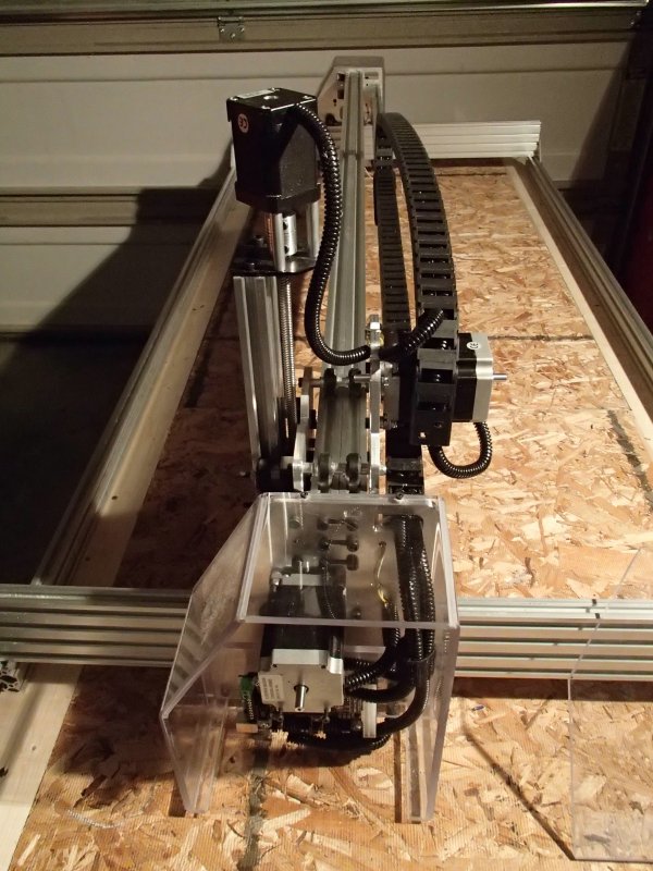

By October 2, 2014, myOX was virtually done ... or so I thought at the time ! It should of needed some fine tuning of GRBL parameters - namely adjusting steps to true scale. Do not forget, the ACME screw from OBPS is a 4 starts, that's an extra division the online calculators I looked at didn't make clear...
It was time for some pictures. The backstage pictures can be found in this post as myOX takes shape.
On the mechanical side, I came up with a few tweaks, some due to getting regular head M5 screws - required a few extra shims here and there, others just because I tend to be "lazy" (in a good way)- a quick and dirty, not that type of dirty, jig allowed for assembling the X/Z assembly in no time flat... But since then I had to take it apart a few time, including a few times as I though myOX was nearly complete ...
As with any other design one can customize, there is always room for some improvements. So be on ready for taking a few steps back from time to time. You will even reach a point where your OX will make parts for itself or a few offsprings.
At times I thought I was going to end up with a FrankenOX. But the dressing up of cabling, along with some custom plexiglass bending/shaping, is giving myOX a nicer look as it sits on its very own custom made workbench. There's pictures of all that along the way in the posts (see previous link). Anyways, follow the discussion threads down below for more on the myOX saga as it unfolds ...
October 8, late night, and myOX is drawing on its own ! I almost felt like pulling out cigars. Then, I realized I don't smoke nor have any cigars. Still, it was a proud moment to remember. Time for the YouTubing to start ...
But that was only the beginning of the fun. myOX was ... cross-eyed (divergent at that !!)
Because I didn't measure the pre-cut lengths, as of October 14 I have no choice but to take myOX to pieces and CUT the three 20x60 lengths to equal size. In theory, I should be able to trim them down towards 1500 mm since they are all nearly 4 or so mm longer. How can I do precision cuts ?
The old chop saw used to build the fence proved on a small piece of V-slot that it was not up to task ! Back to the internet I went, checking for a good miter saw which wouldn't double the cost of myOX...
Time passed and my attention went for the Evolution Rage 3 multi-purpose sliding bevel miter saw - a miter saw with loads of potential in anyone's tool shed. I could not ignore fact it was also on special at the local Canadian Tire - 300$. Thus quickly available and within my "budget" for a tool I was actually borrowing much too often from others. At worse, it would be my miter saw ... and I would not be able to do the precision cut needed... As it turned out, an adventure of its own, the Rage 3 CAN do the job. It just takes time to properly square blade, table and fence... From there, it cuts through the extrusion like 'butter'. The trick, thanks to some advice received here in OpenBuild, is to do a "shaving" motion - bring the blade up & down a few times to make certain there is no blade defection at work against you. I'll let you read the various posts and do your own research. It is an excellent all purpose miter saw. I already used it for a few other unrelated projects - cutting through aluminum and steel with no issue. Cutting wood is a dream. I wish I had this saw back when doing the deck and fencing ...
So here we are, Novembre 11, 2014 and myOX looks pretty darn near done with a first few test routing showing great improvement in its precision. Given the width and basic design, I don't think an OX this size - with a 52" x 20" working area (plus down to about 20" depth in Z), will get to 0.01 mm precision. But it looks like it will do all I am planning to date.

Ok, what is going on ? The Y stepper closest to the controller seems to be acting up. I ran a test piece "fleur de Lys" (curves and larger than the 80x80 fan grill). Was a bit agressive with the cut depth and could see some strain ... but tool pathes were consistant. So I tried the fan grill again, and this time it was completely messed up ! I'll have to check that stepper and the wiring ... but I'll regenerate gcode files as well since I played with meshCAM way too long the other night (not saving the original output file).
Now using the UniversalGcodeSender-v1.0.7 instead of the GRBLcontroller, still running off the olde MacBook. Can see more status info on what is going on, better manual control, ... just plain nicer. It could use the large "readout" instead of plain text.
Getting that much closer, if I could only figure out what is going with my Y steppers. I might need to feed more current to them. They are running quite cool (NEMA 23) compared to the warm Z (Nema 17). The X stepper (NEMA 23) is also running cool.

Those having read the long posts, will know about my power supply adventure. The 24V didn't do much helping. At least not with the problem I had. Thanks to John, I was set on the right track ...
First off, make sure you have your GRBL settings tuned halfway descent ! I had a few settings way off. Critical, beyond the steps per mm, are the step pulse and idle (depends on the driver chips) as well as the acceleration, feed and seek rates (speeds). All of these keep your steppers run smoothly (less 'chatter', etc.)
Then make certain the driver's current is appropriate for your steppers. The CNC xPro lets you set this for each driver/motor. Although you have to eye ball it (would be nice to have a read out ... for us beginners at least).
But the most critical, especially in the mystery regarding myOX misbehaving, was the temperature reached by the driver chips. I must admitI had the heat sinks and three fans in their bags - not installed ! Once the heat sinks stuck to the chips ... miracle of miracles ! ... myOX behaved like any good OX should. Perfect runs, no stalls ... just routing nice and fast.
So, once again, it was the "5 cents" part which made (rather broke) the entire system ! Or, more to the point, the oversight on my part not to stick to the plan of installing the heatsink from day one !!

After changing the smallish NEMA17 used for the Z axis to a hefty NEMA23, as well as finally adding the fans over the controller, myOx has now ran for over 3+ hours non-stop with not an issue. Each of the steppers are running relatively cool, the controller is holding up its end as the router.
So don't skimp on the steppers and don't forget to keep the controller 'cool' ! Both were my top issue from the get go ...
