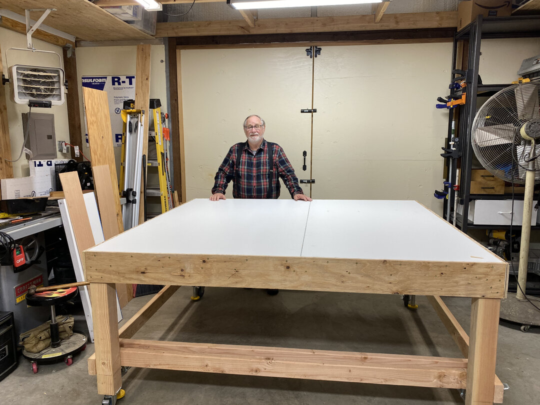

Began this project by purchasing two solid core 36" doors from my local building materials recycling store and using them for my table top. Table frame is made from dimensional lumber. I added casters to the bottom that raise the table for moving and lowers the table to the floor when the the machine is being used.

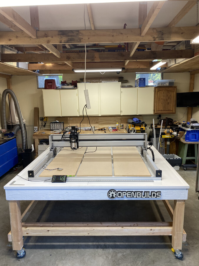

My son and I assembled the machine over the course of 2 weekends and everything worked correctly from the first power up.
My first CNC project was to route the OpenBuilds Logo and apply it to my table - as seen in the attached photos and videos
OB Lead 1515 CNC Router 2021
Build in 'Cartesian Style CNC' published by Safetywrench, Feb 14, 2022.
Building the OB Lead 1515 was straight forward. The on-line OpenBuilds assembly videos were extremely clear and easy to follow. Initial build of this machine is with OpenBuilds BlackBox which simplified getting the electronics to work the first time. OpenBuilds staff are friendly and helpful.
- Build Complete!
