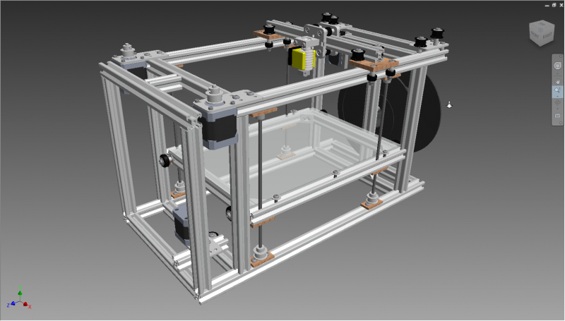

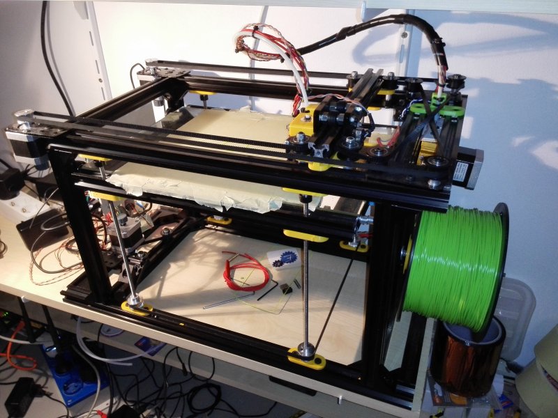

I designed this printer after being disappointed in the Makibox using its electronics i came up whit this design.
Its based on the CoreXY principle as the progress of building the printer i changed all the wooden parts for printed PLA versions (included in the .zip) so dont use this drawing as a final version. If you want to build it go and check all the pictures and models (All my Inventor files are included) also check out my blog for more information http://imkovb.blogspot.nl For youre conviniance i even include the firmware for PrintrBoard based electronics.
The result, i stated that work is finished it is.. as it is a fully functional 3d printer. But anyone who has build a 3d printer knows it is never finisched.
