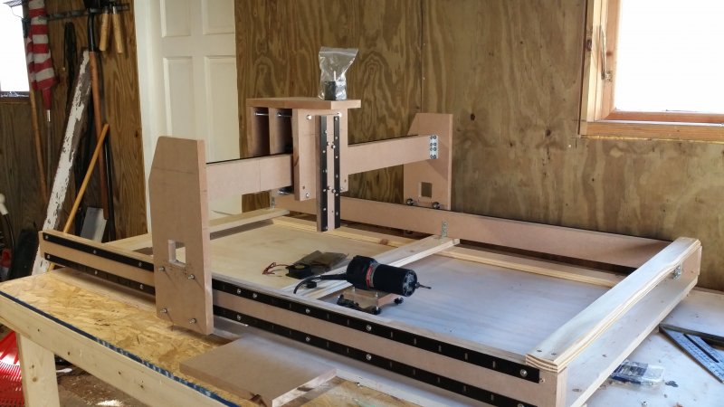

Ox Hybrid Modified design. Open rail instead vslot. Eventually I will use this CNC to cut my new Gantry plates and continue its metamorphosis.
Construction:

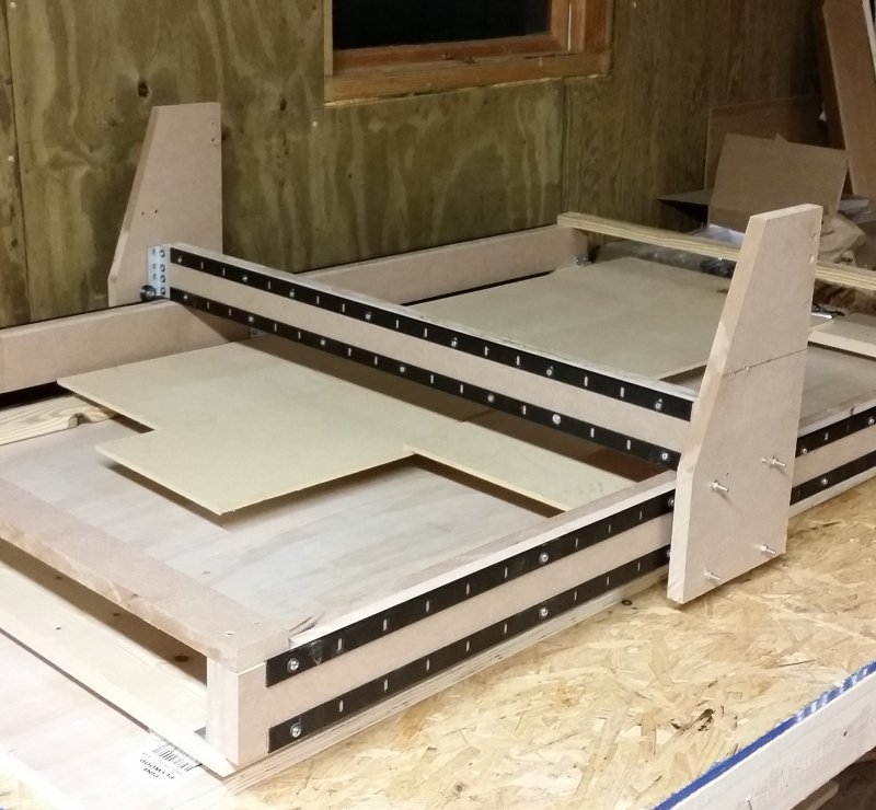

After weeks of research, i decided to venture out on my own and try a new way. I liked the V Wheels, but didn't want to go the V Slot route. So i decided to give the Open rail a try. I cut my Gantry Plates out of MDF as well as the Open Rail Base Track.

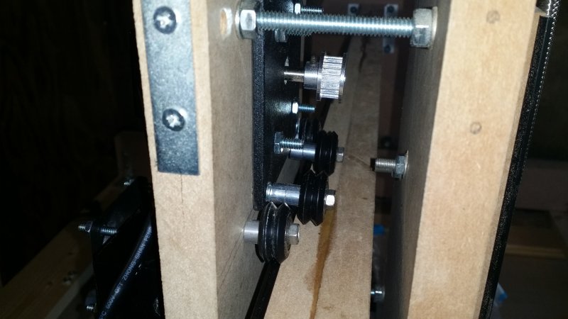

Getting the holes on the Gantry plate Carriage to line up perfectly with the V Rail was a bit of a struggle.
TIP # 1 : When drilling your own holes in a gantry plate (If not machining your plate) use a drill press, and hand drill tends to wander on you a little and even a few mm can make a difference.

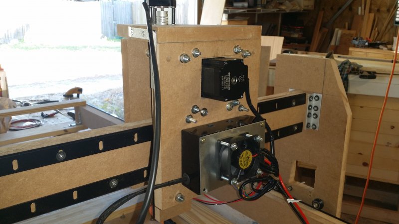

Wiring Has Begun:
A small project box (Which looks like it was made for this board) some rubber grommets and fan motor, and we have liftoff. I plan on putting a board under the box running left to right, to accommodate the side motors and the length of the wire, which will be in excess of 48 " (I actually have to add wire, as the nema 23 comes with about 30" of wire)
tested the board today at least to make sure the power works (It does). I will be adding the power on/off switch, the pause and restart switches, and the 2 remaining motors, then it will be time for the belts.

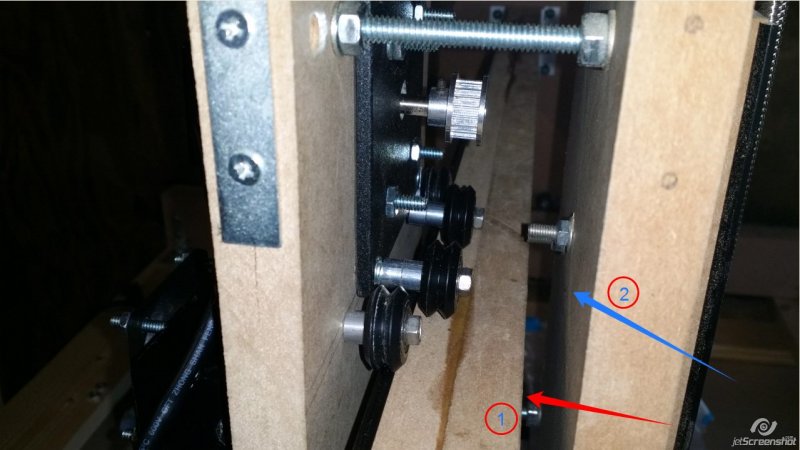

I attached the Motor to a metal plate to make sure i don't get any slippage. PLANNED CHANGES:
1. I'm going to add open rail on the opposite side
2. I will add to more v wheels to the opposite side to take the pressure off the existing v wheels near the motor. It should help distribute the weight better.
Ok, added more wheels and a vrail on the opposite side to minimize the pressure on the back wheels. Now im off to setting up the board.
