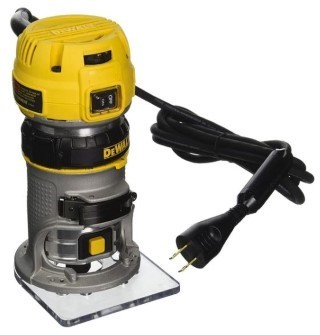

Dewalt Router Installation Video
Grab your DeWalt Router and Reducing Collet Adapter here
