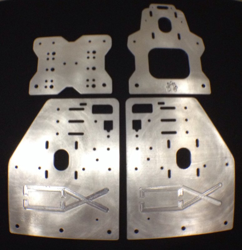

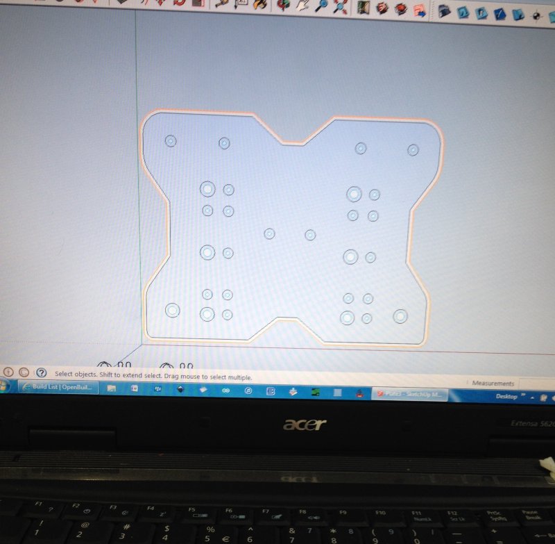

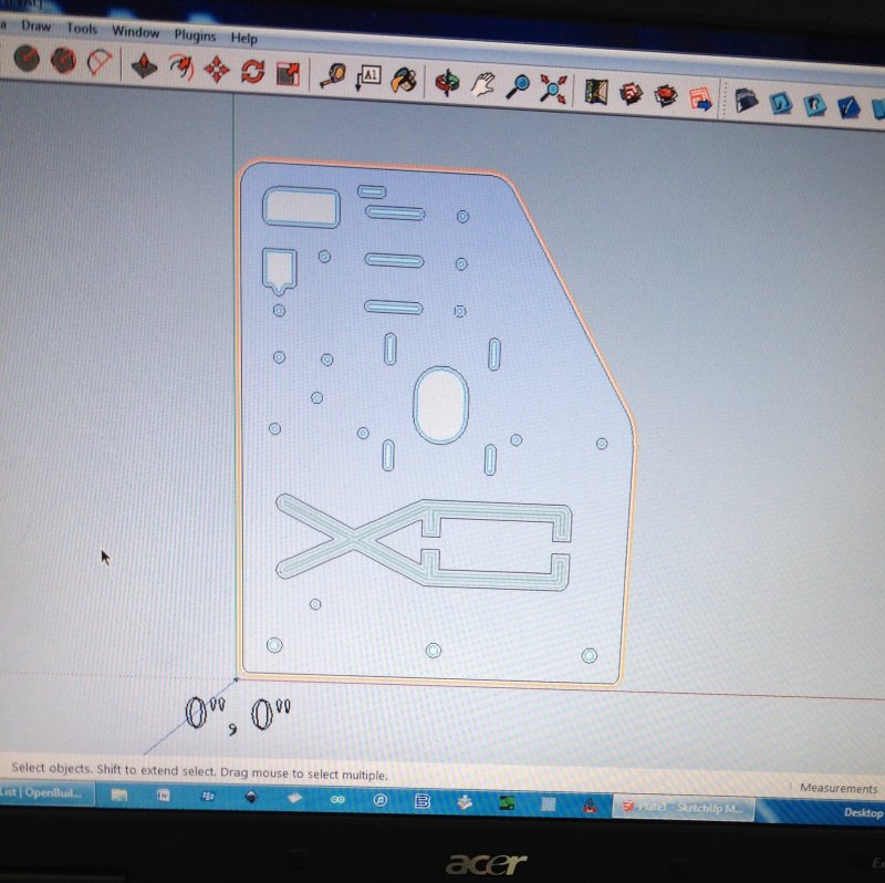

First thing was to get the g-code generated to mill all the plates required for the build.
All metal are off cuts, so some hash scratches will show and leave me with two options, bead blast or paint.
Here you see me coding things up
And then here a little video clip of me milling away

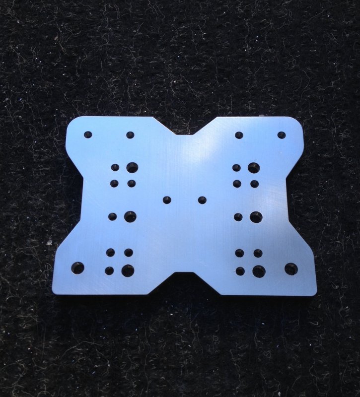

The end results left me with a smile none the less and it was off to see just how well I could clean up the plates.
I would like to keep them with a brushed look but may paint them in the end.

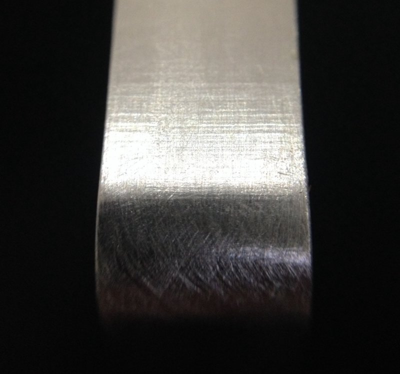

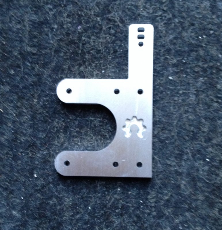

In the first pic you can see the scratches I was talking about
After sanding things are looking up

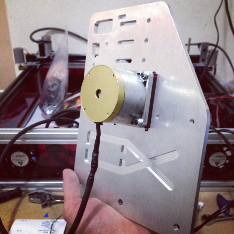

Little personal touch
Also opened up the center hole by 1/4"

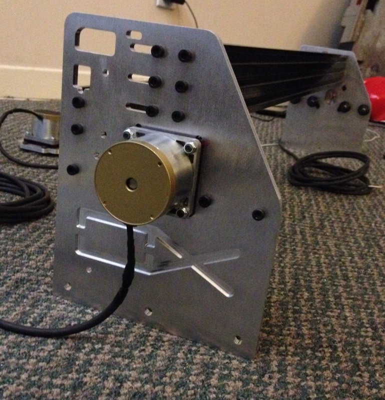

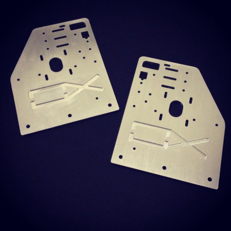

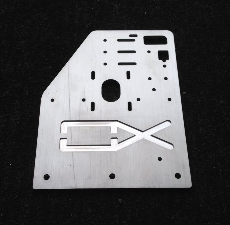

Pic of both side plates

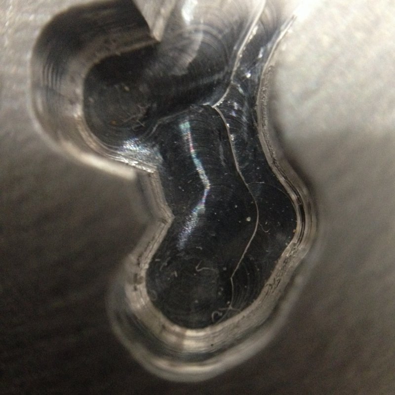

Here are some macro pics of the off mill finish I can achieve on my desk top and hope this gives you insentive to take the leap into building your own mill.
The mill in the video is what I used to mill the parts "not an OX" but hope to simulate the results with one

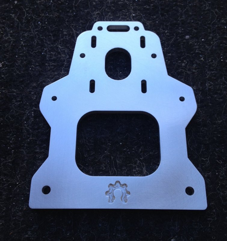

Finished plates

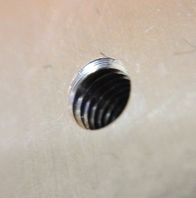

I tapped the holes on the z assembly plate for nutless wire straps

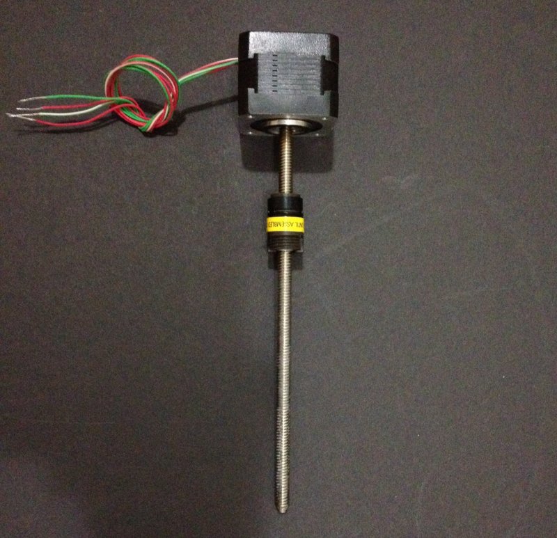

The Z axis stepper/leadscrew have crossed the boarder and in my hands
As for the 3 x NEMA23 motors and odd/ends I don't have from the original OX build, I will be ordering it all at one time to save on shipping

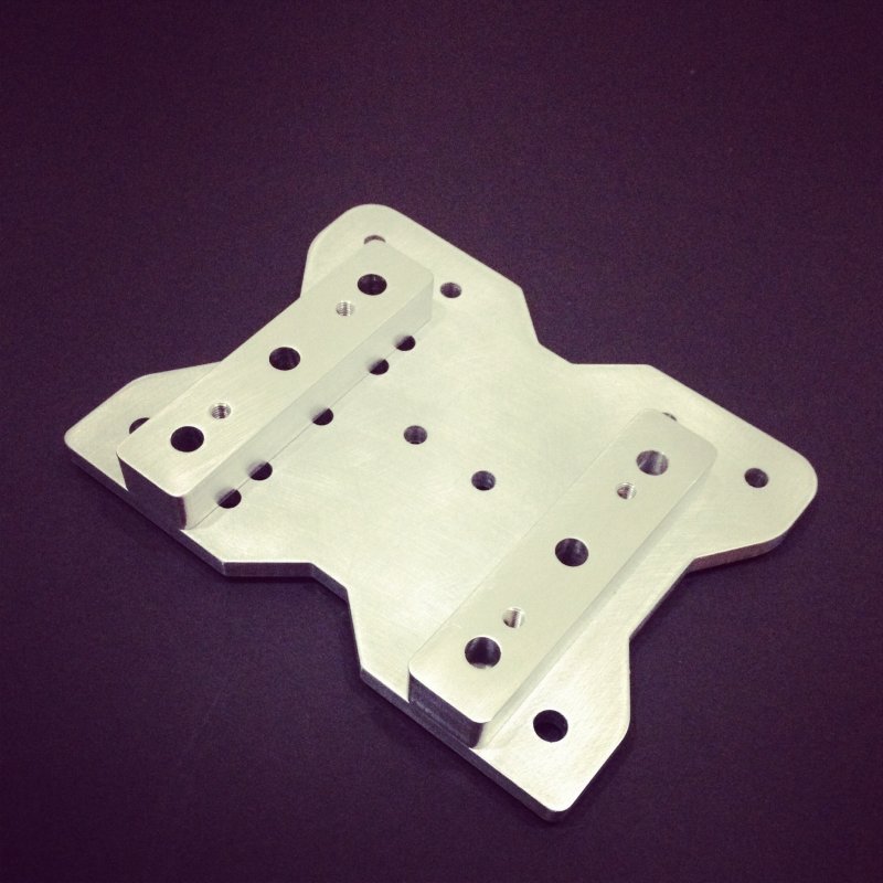

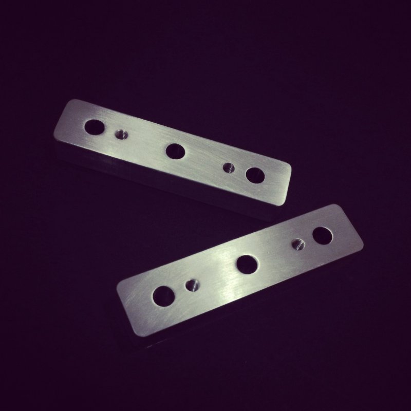

Next is to mill all the little stuff like, spacer blocks & plates for the Z axis.

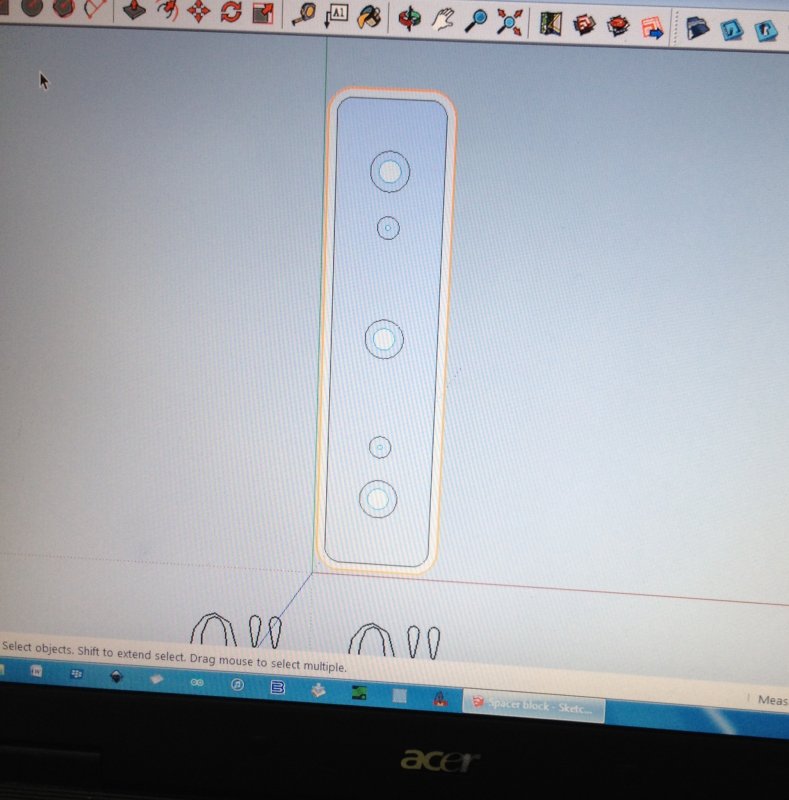

Here I code up some 1/2" thick spacer blocks using the info provided on the openbuilds store.
They turned out awesome so I tapped and cleaned them up
Test fit

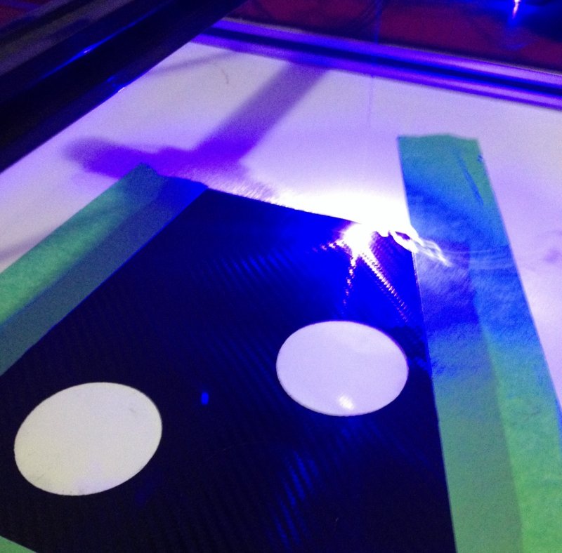

While working away I scuffed my 8mm wrench off the back of one stepper motor and didn't want to repaint it so I fired up Laser V and cut some carbon fiber style wrap
turned out nice so I'm going to do it for all 3 motors

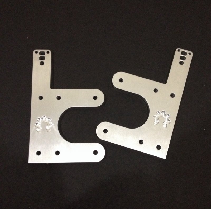

Next comes some end plates for the main supports and table top.
Played around in sketchup and designed this, 1 for each side.
Fresh of the mill
Cleaned and ready for a test fit
Fits perfect!

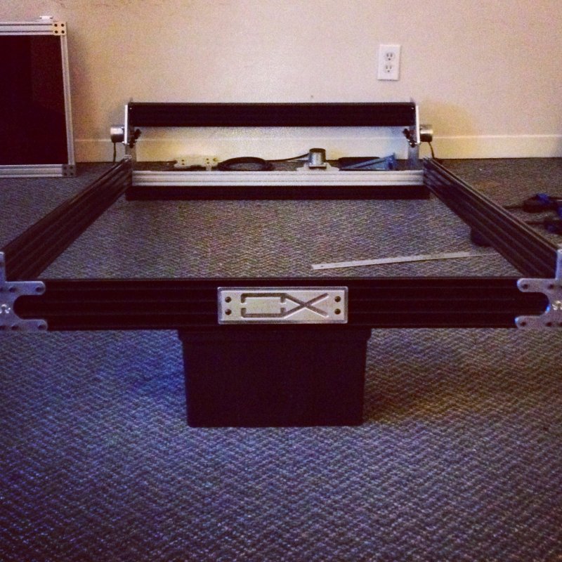

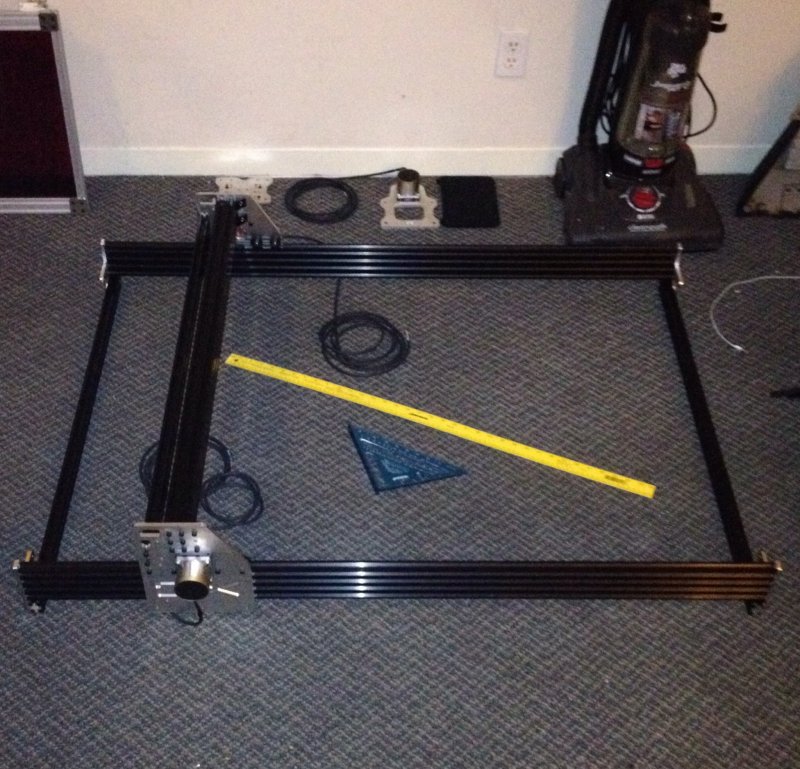

Next I cut some more extrusion @1250 mm and test assembled the main rail/table assembly.
I need to order some more extrusion as I didn't account for the raised bed design I have decided on.
None the less things are coming together nice

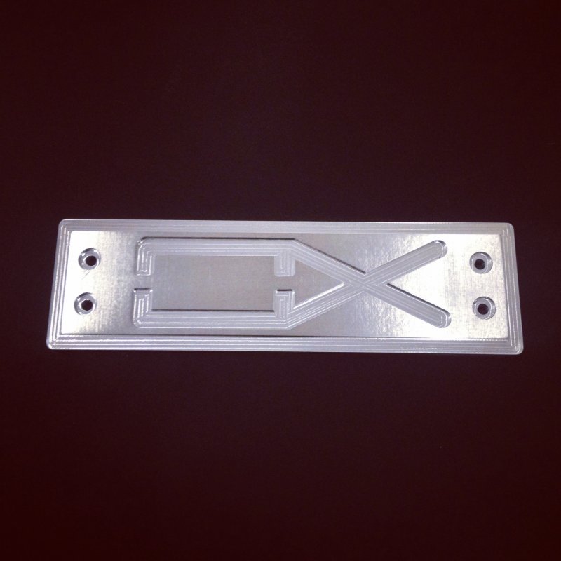

After assembling the base with all the extrusion I had on hand I decided to do a little more reinforcing and made a name plate to add some bling/join the two 20x40 in the center
It really stiffened up the frame/pulled things square

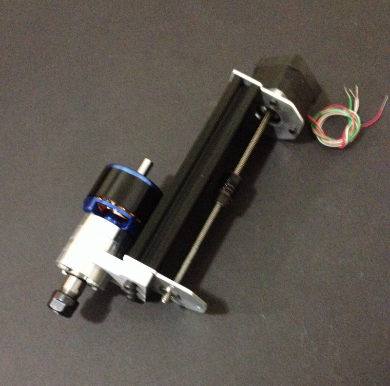

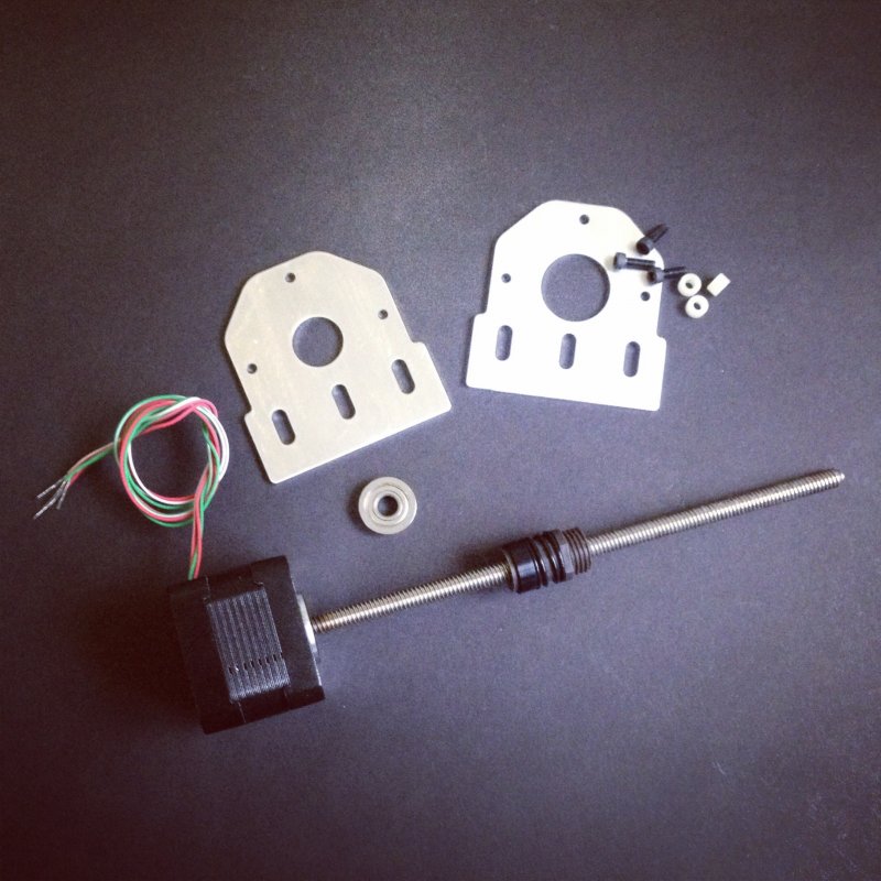

Next, the motor and leadscrew assembly.

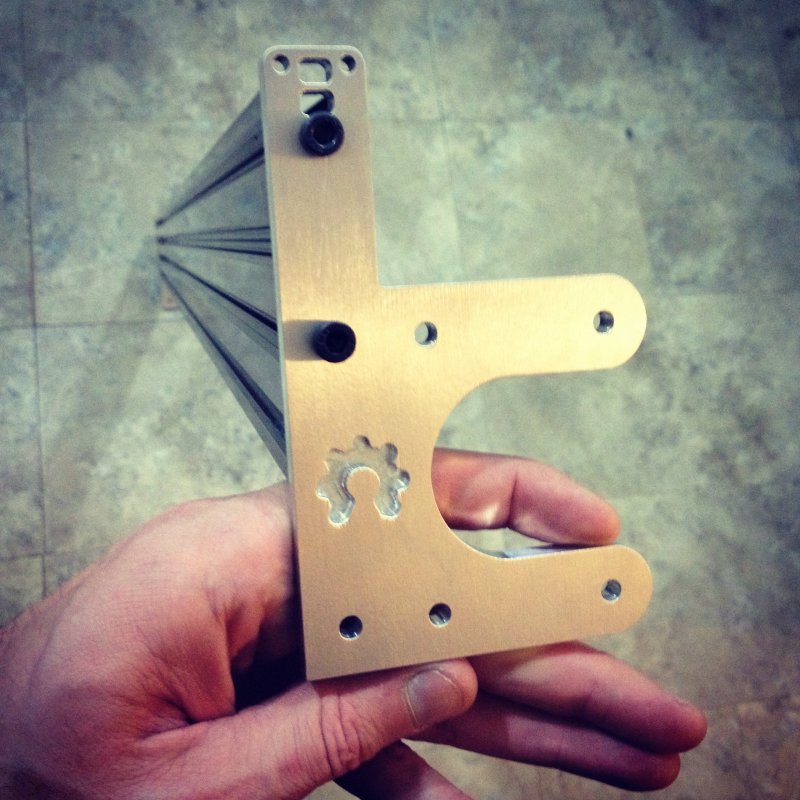

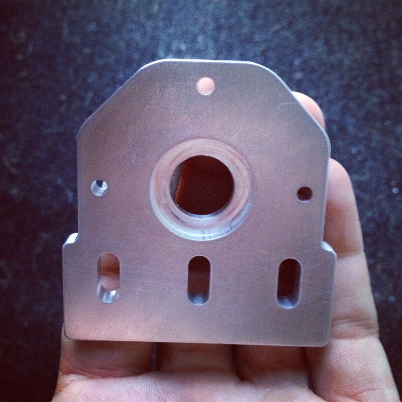

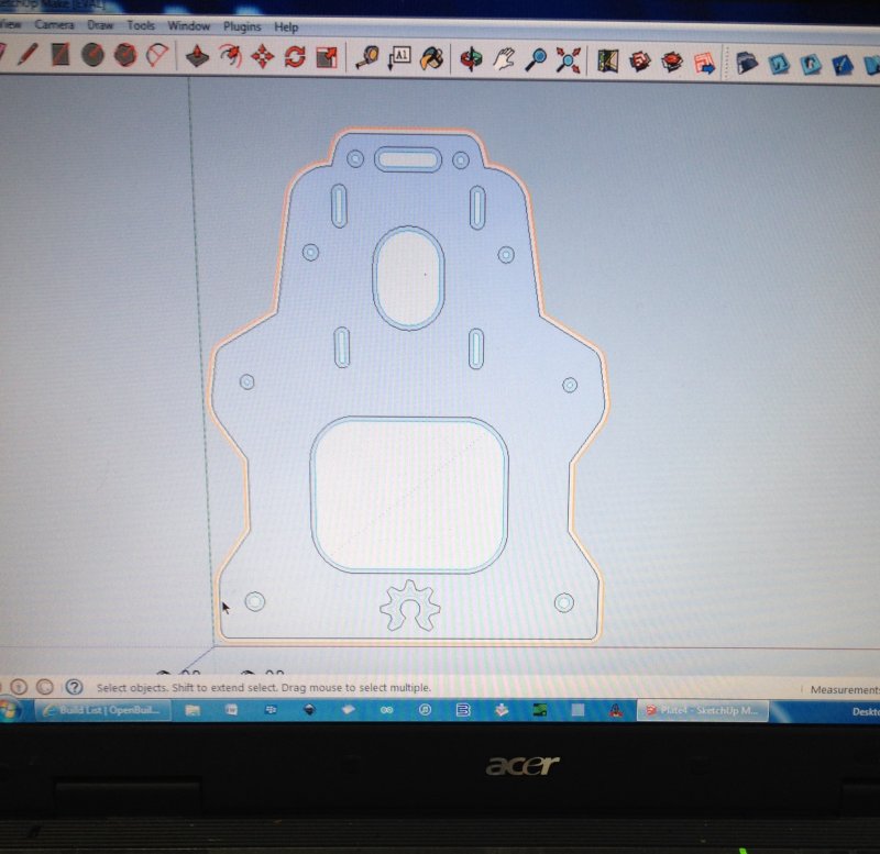

I was going to use open builds plates but wanted no exposed extrusion so I modified the files to suit my needs then milled them.

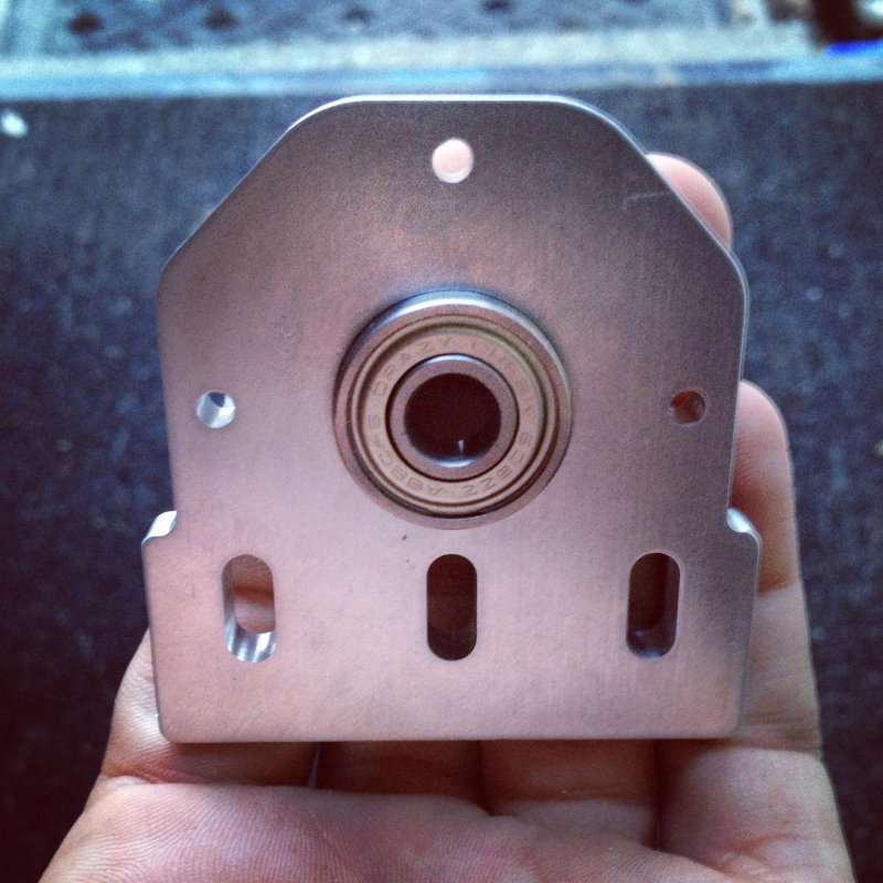

Then I made 4mm spacers and found a flange 8mm ID bearing for the end support.

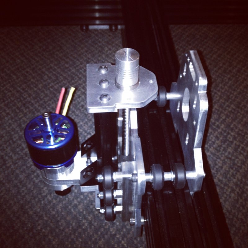

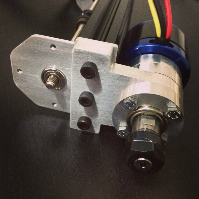

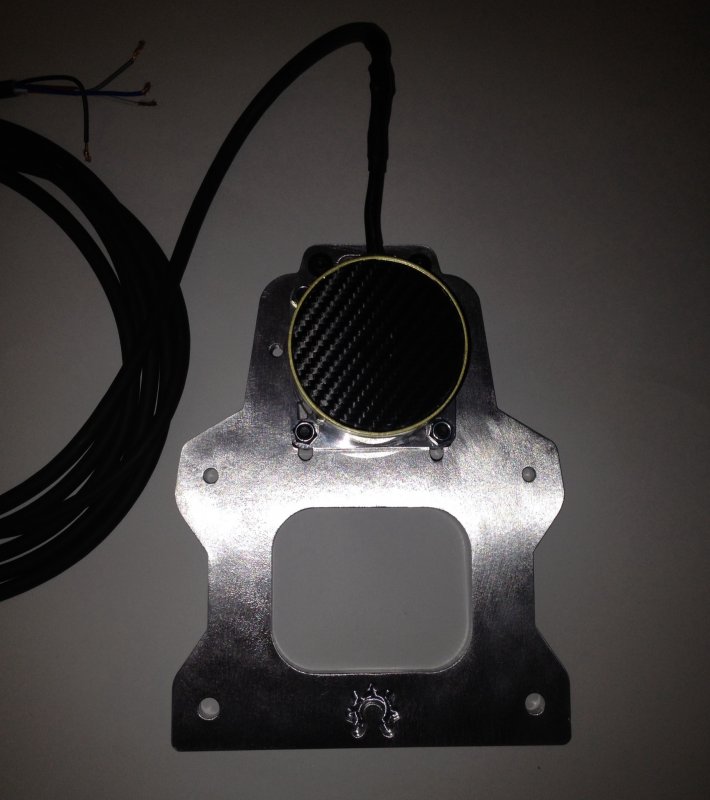

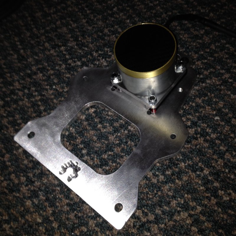

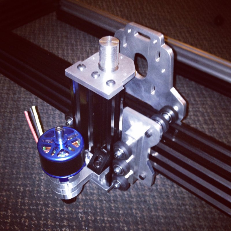

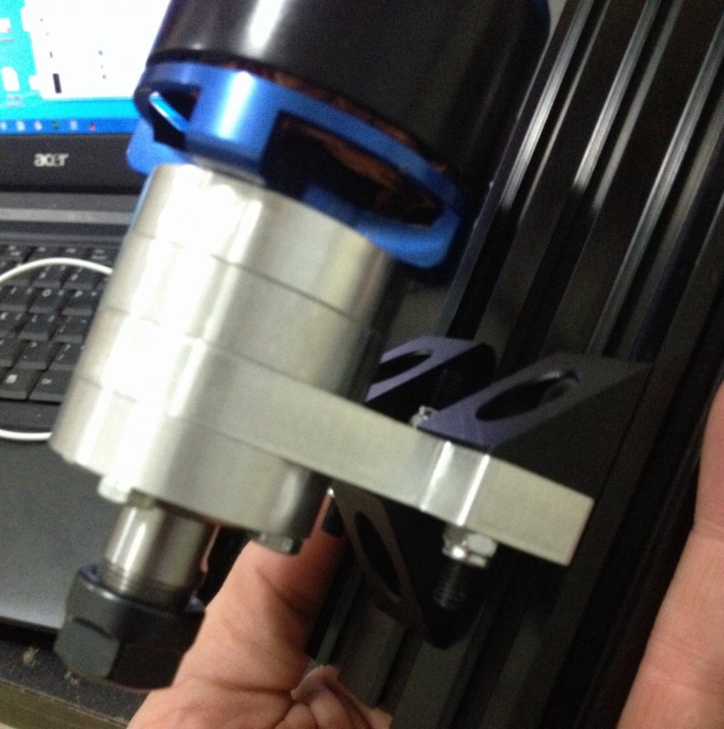

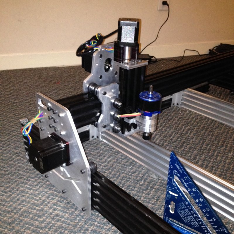

Here you can see a test fit for the OX RC spindle and now I can plan the nut design
After some test fitting I decided to change up the Z axis and mount the RC spindle so it would be adjustable with a turn of some screws
I then designed new top and bottom plates to hold some 608ZZ bearings

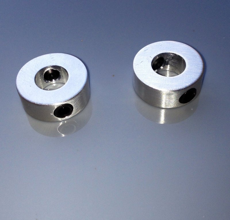

All I needed next was an 8mm lock collar but could not find it local so it was back to the mill to see if I could pull off the smallest part yet lol

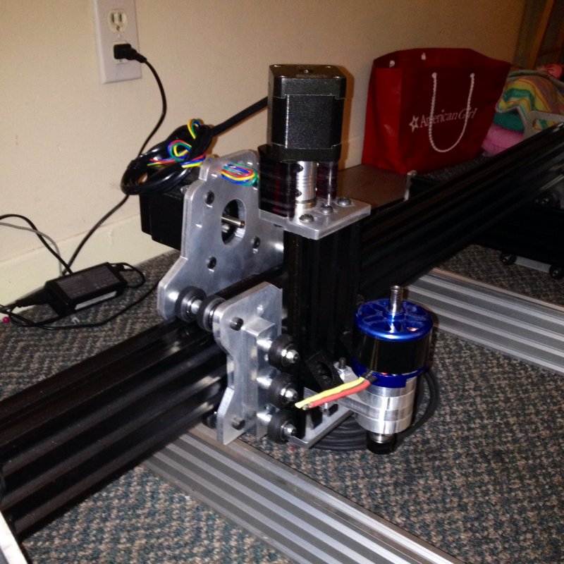

It was now time to put all the parts together and test it out
I must say I'm really impressed with the way the OX is coming together and it is really smooth

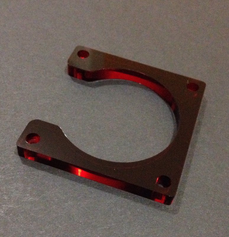

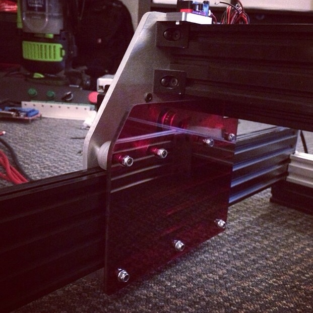

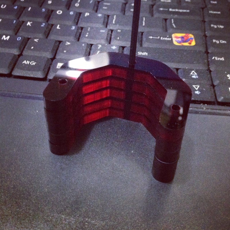

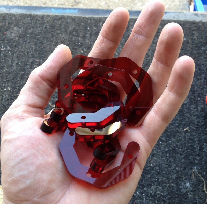

I had a little red 6mm acrylic left over and made up some spacers for the NEMA17 on the Z
I need one more to clear the coupler and then it's just odds/ends left.
Ran another batch of spacers with a new bit and really happy with the off mill finish.
Six spacers give just the right amount of space for the coupler
Here it is fully assembled and waiting on electronics

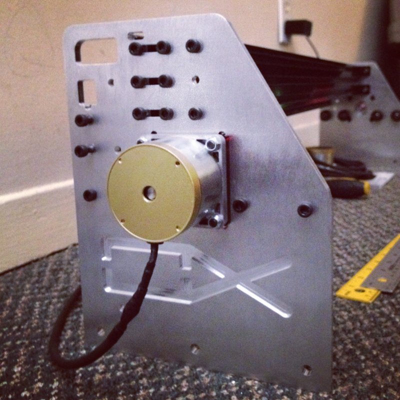

A lot of items have arrived and here you can see the RC Spindle test after wiring the machine

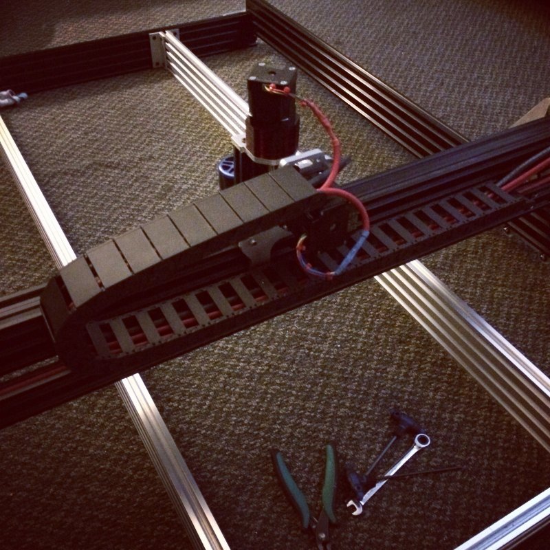

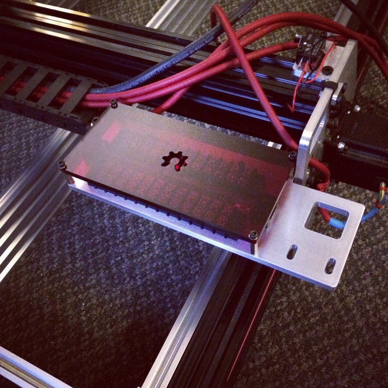

Also a pic of the drag chain installed
Here you can see some of the custom work I have done
Y Axis brace/guard
Terminal plate and guard
