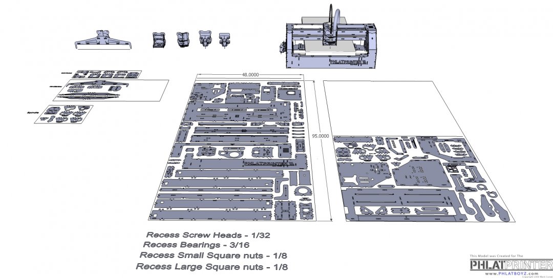

Hey guys, we received a few request for the Phlatprinter 3 files and recently found the old build video so we are sharing it.
Special thanks and props go out to all our friends and Phlatforum members you guys ROCK!
This build would not have been possible with out you.

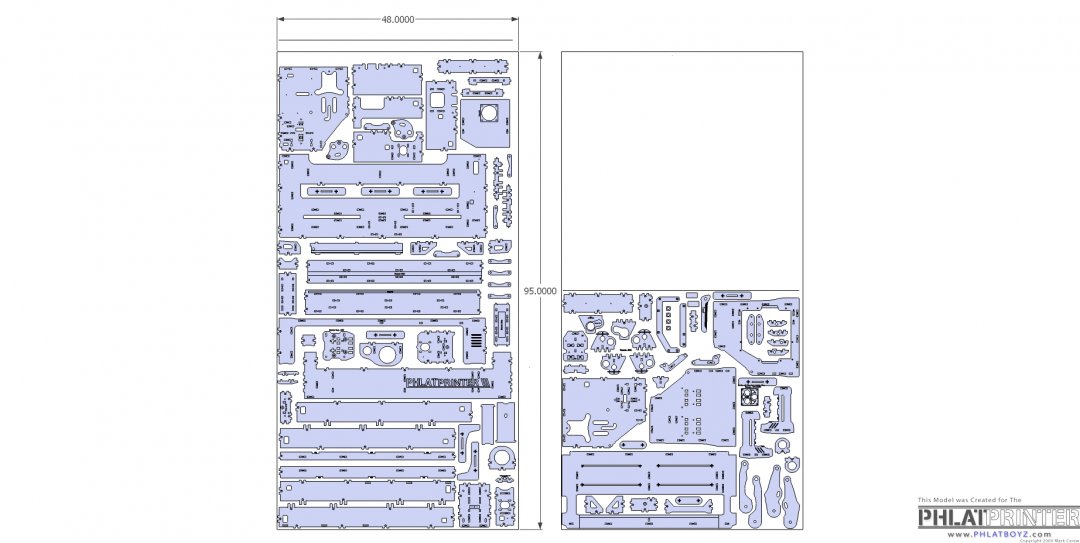

Notes: We cut these from 1/4" sheets with an 1/8th" bit.
The kit is no longer available, but we share this in hope it will inspire others to build.
INTRODUCTION & BUILD VIDEO

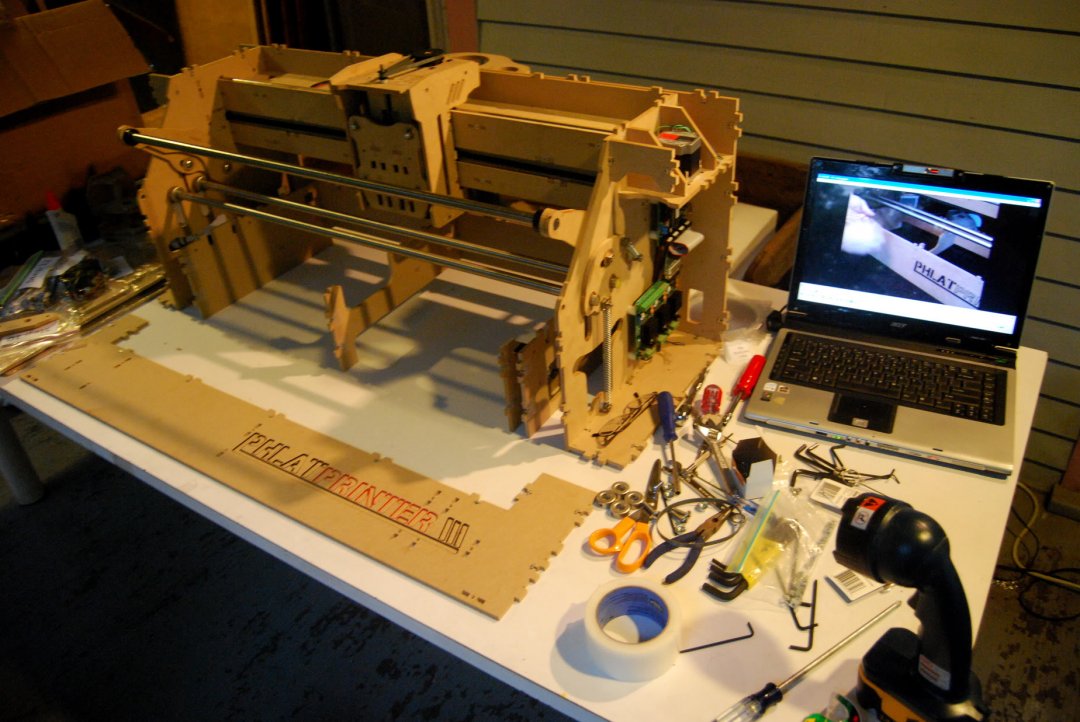

Build in 'Other Style CNC Mills' published by Mark Carew, Jun 20, 2018.

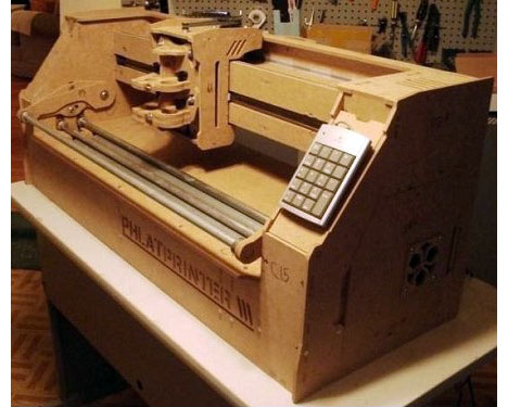

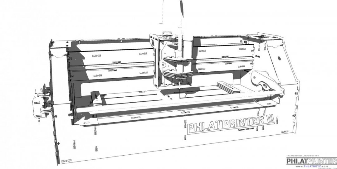

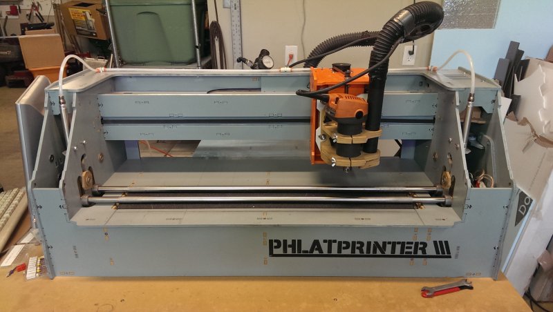

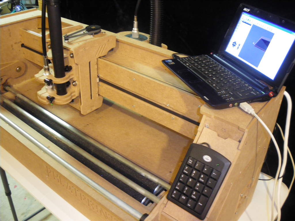

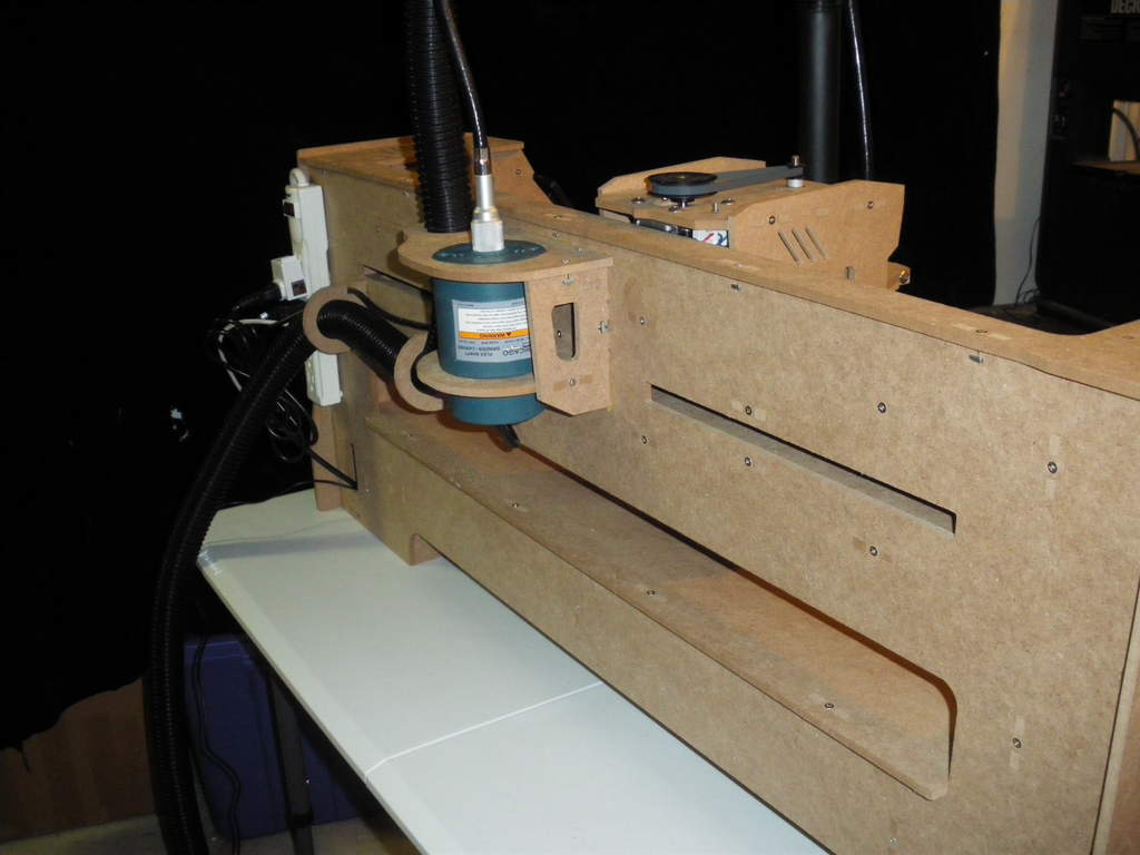

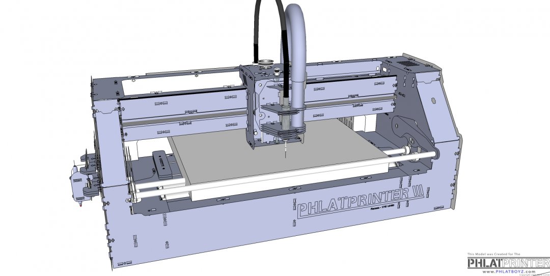

The Phlatprinter 3 was designed to be used in a small shop with the ability to cut large sheets of foam for RC airplane projects. The idea was that you could save all of your aircraft as models and tweak to perfection after every flight.
- Build Complete!
