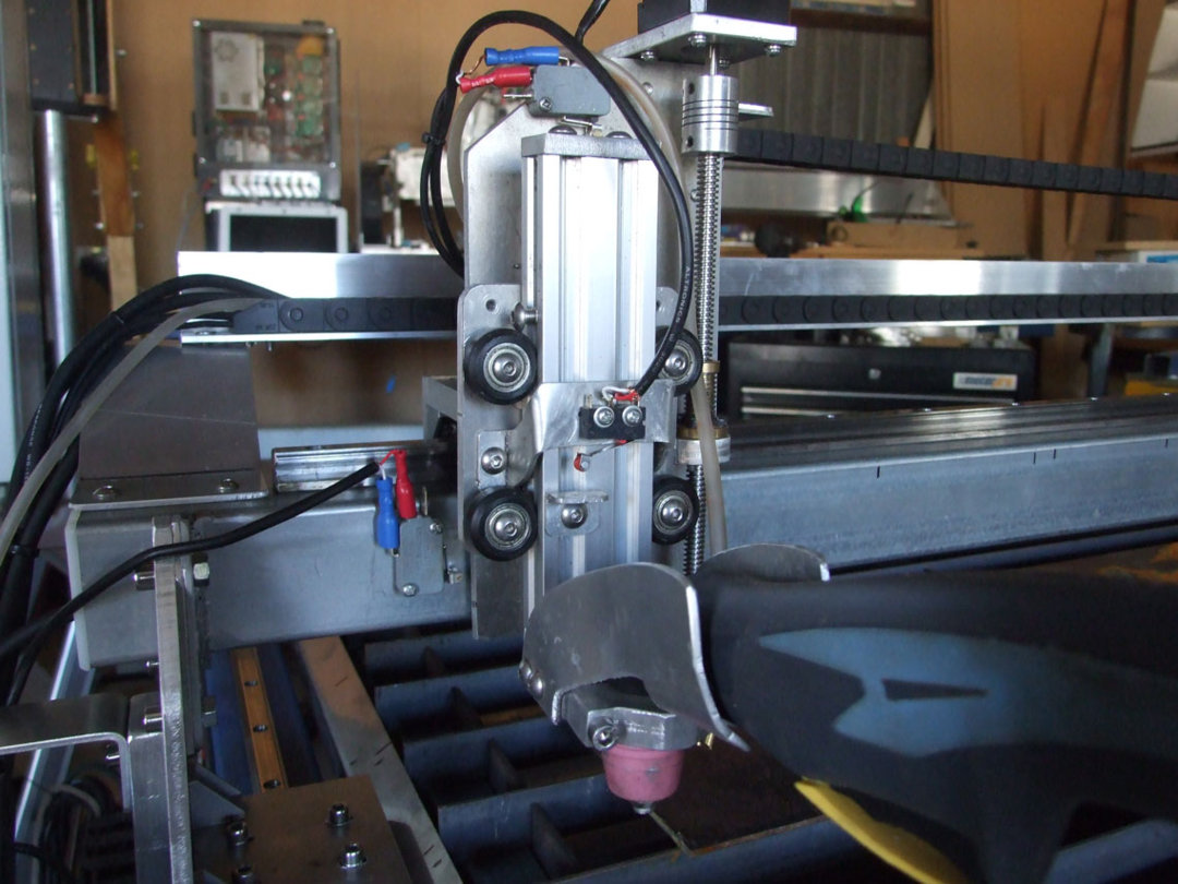

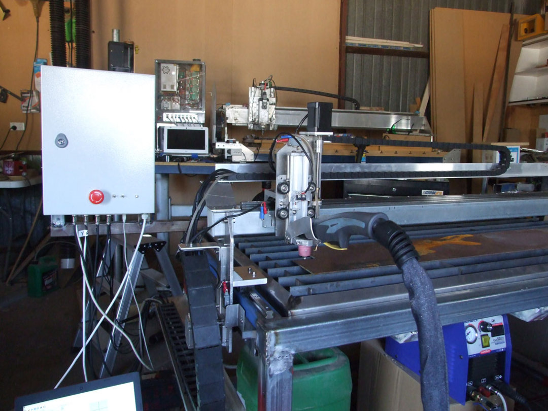

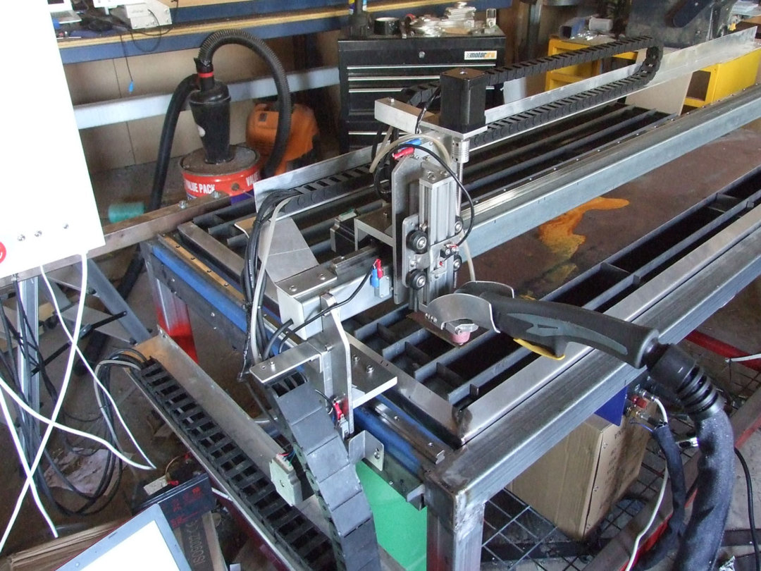

The plasma CNC that I have built has a water table that measures 1350mm x 650mm. The water is flooded onto the cut area while cutting and recycled around with a pump. This is to reduce smoke, cool the metal being cut to reduce distortion and also to keep sparks to a minimum. Most of the machine has been made from aluminium , the frame and table from steel, the water table, stainless steel.
- Build in Progress...
Build Author RegPye, Find all builds by RegPye
- GNU (GPL3+) General Public Licence
Reason for this Build
I have several CNC machines that I have designed and built over the years, but often I needed a special part to help with building some project and the need for a CNC plasma became apparent .
I started to research what would be the best solution for me and decided that after seeing so many different designs that I would be best to design my own from scratch.
The mechanics of the design are straight forward and based on common solutions, the electronics I thought would be simple also due to building other machines successfully, but plasma is a different animal, it needs some special attention due to the EMI problems associated with plasma systems.
