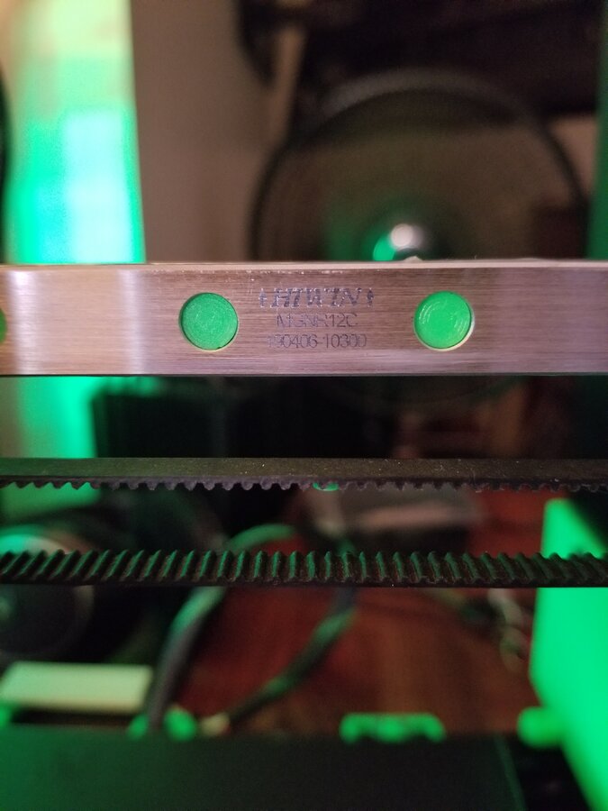

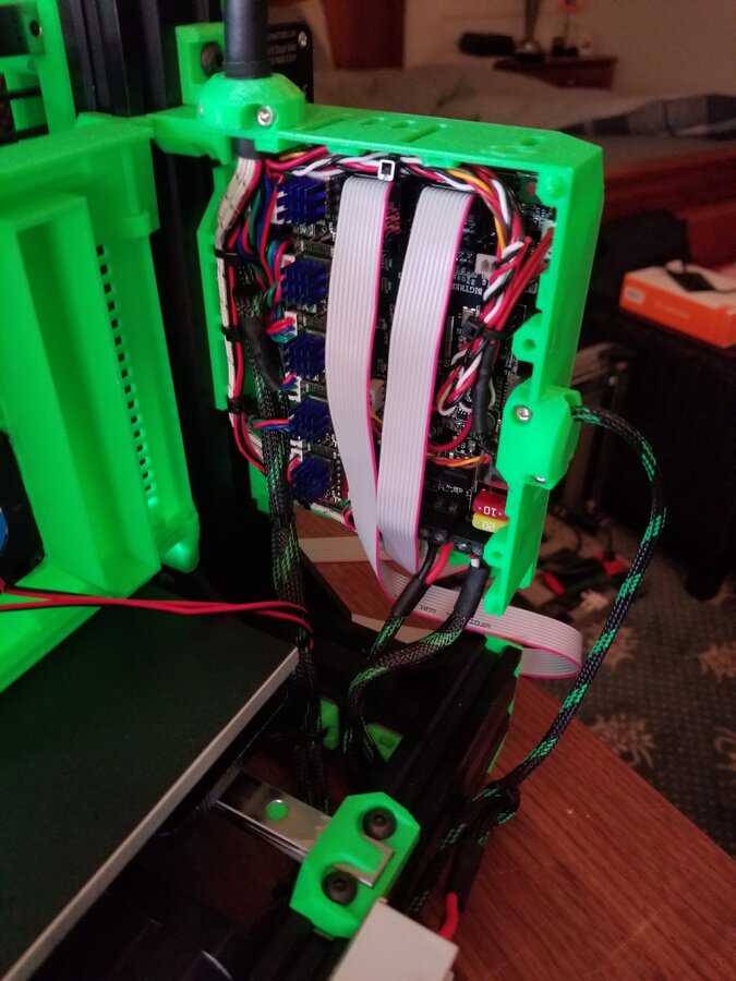

This is what I call the Prusa Dragon LR. It is based on the prusa bear modification but with a few differences. This printer is equipped with an SKR 1.3 (only because I couldn't get my SKR 1.4 to work with my BL Touch sensor), and TMC 2209 stepper drivers running Marlin 2.0.6. It is constructed to of 20x40 V-slot openbuilds extrusion(kindly supplied by openbuilds for free, more details later). It is sporting a set of ldo .9 degree stepper motors for X,Y, and E and integrated leadscrew ldo motors for z. And finally it is fitted with both, genuine Hiwin linear rails and a triangle labs dragon extruder, for that super price motion and one super convenient one handed nozzle changes.
