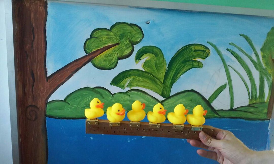

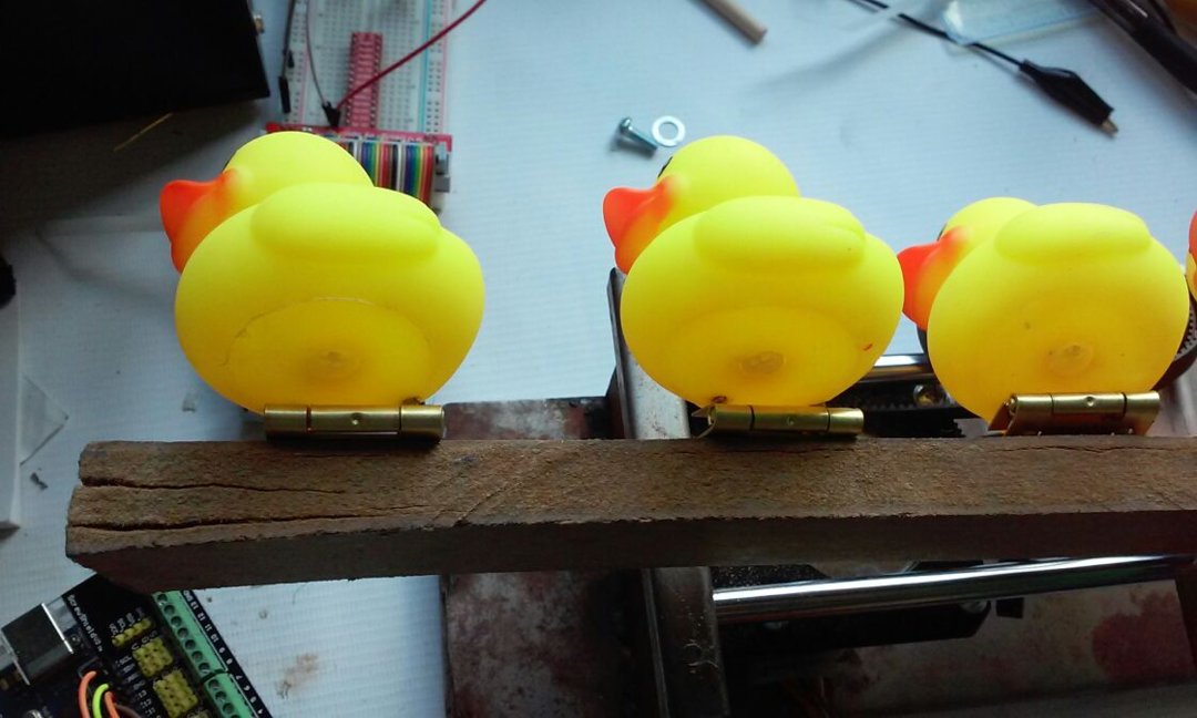

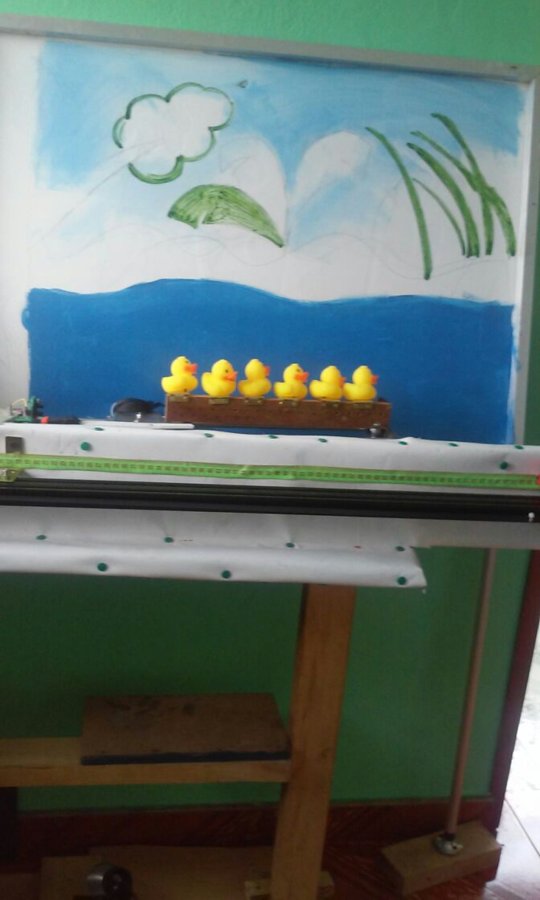

Paint, wood, hinges, duckies, and few screws were used to build the setting

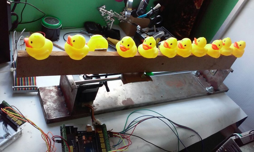

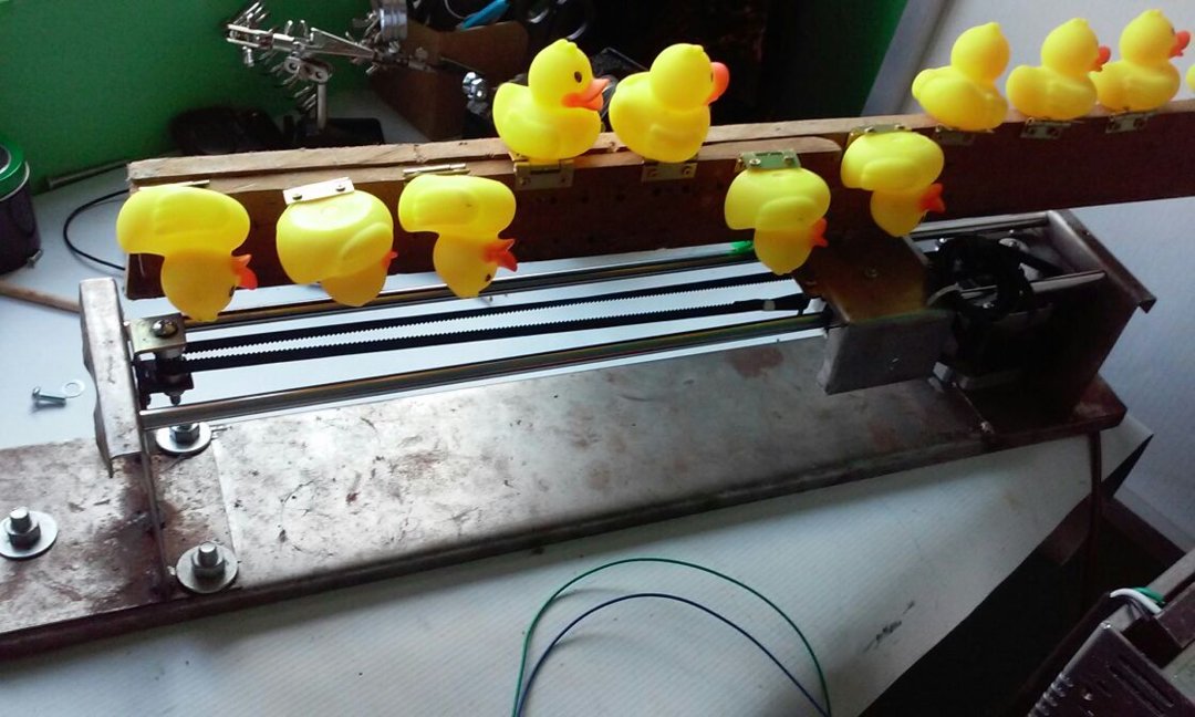

To rock the ducks, a nema 23 stepper motor was used to move a mounted cart over two-8-mm aluminum rods.
The barrier mounted over a V-Slot® NEMA 17 Linear Actuator Bundle (Belt Driven)
To make the fast move, an Odrive board and a brushless motor has been used.
The code for motors, Nema 23 and brushless-outrunner-motor, has been provided on this build.
