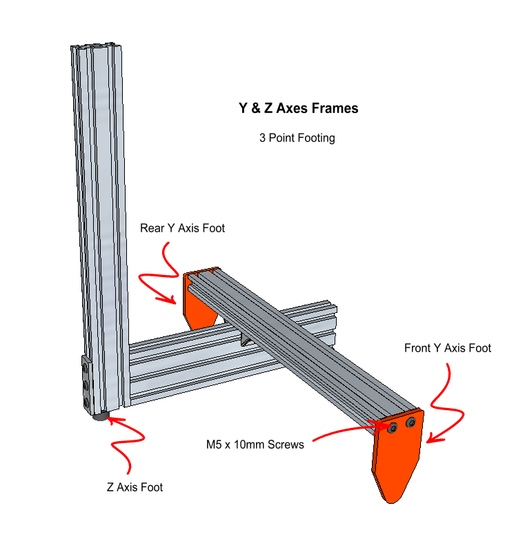

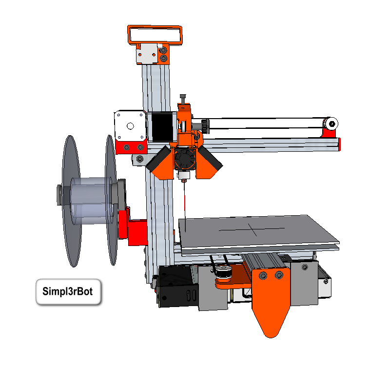

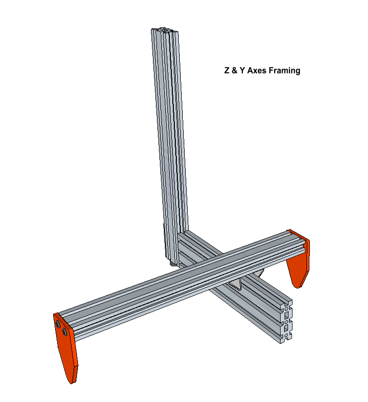

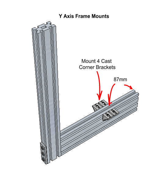

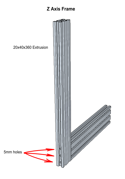

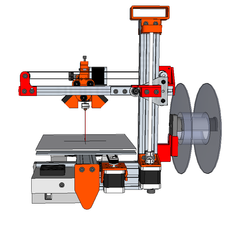

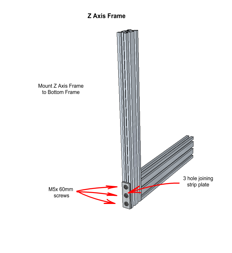

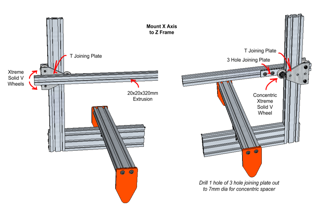

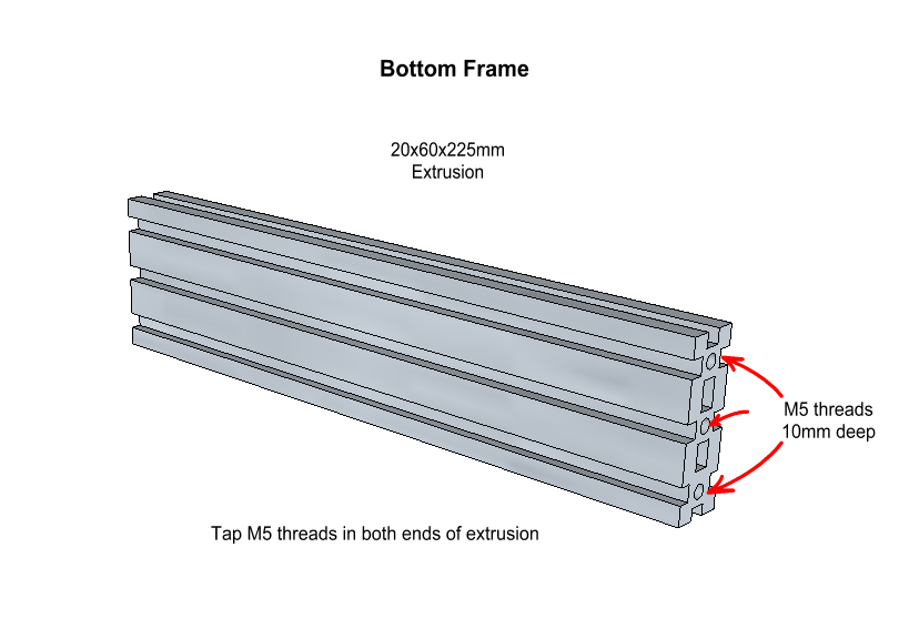

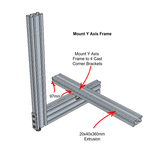

      After studying other cantilever designs I came up with a more rigid framing design for a cantilever type printer. The X & Z AXIS framing should be rigid enough to support using a full size build bed (8"x 8") and a direct drive extruder without vibration or leveling problems.
      The purpose of posting this design is to reveal the framing concept, not a full printer design. Builders are invited to use the framing design and their own favorite extruders, build beds, PSUs, and controller boards
      The images included in the attached files tab are merely a sample of how components could be added to the framing design for a complete full sized printer.
