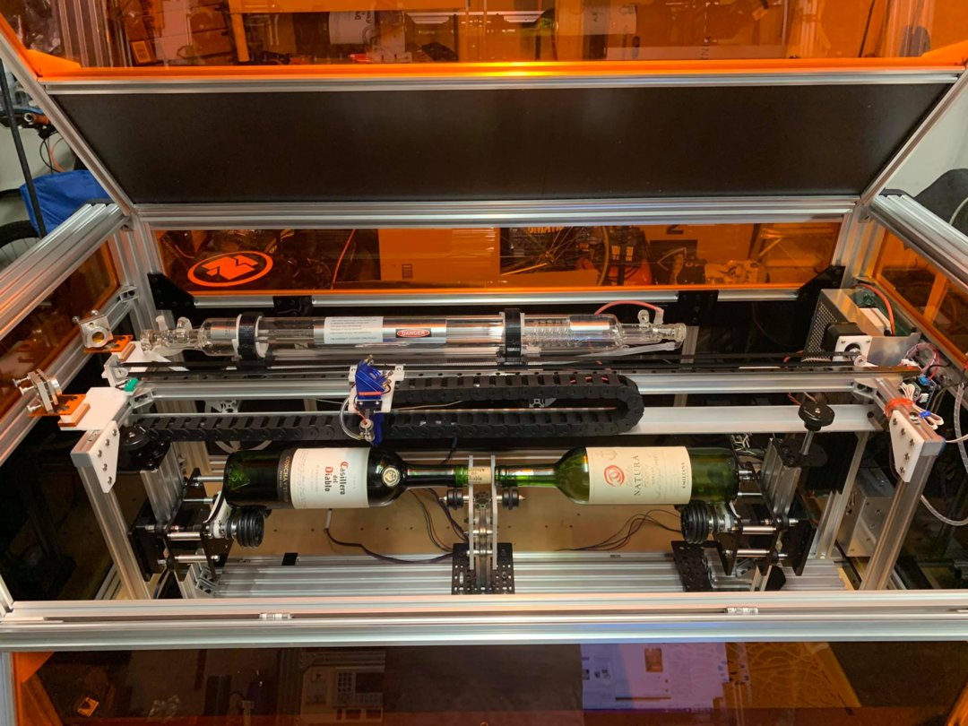

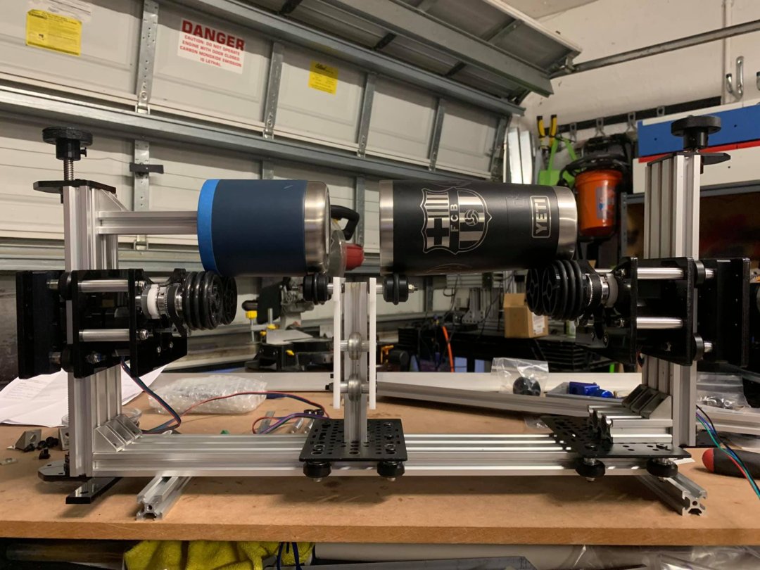

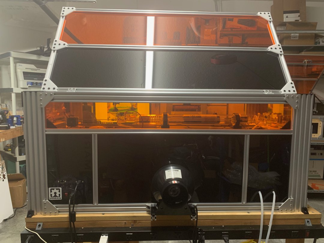

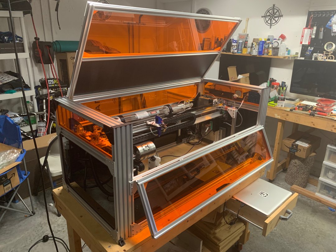

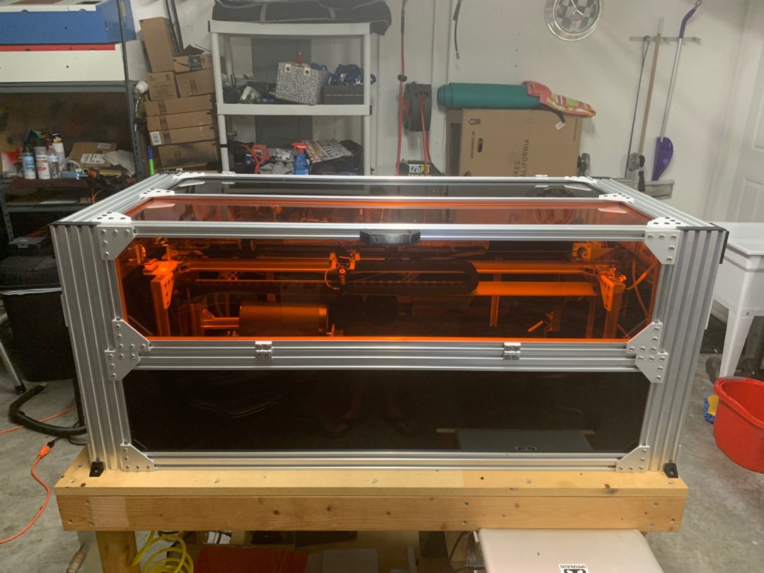

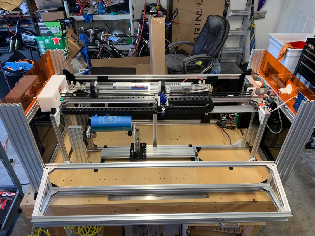

A laser engraver dedicated for round objects.

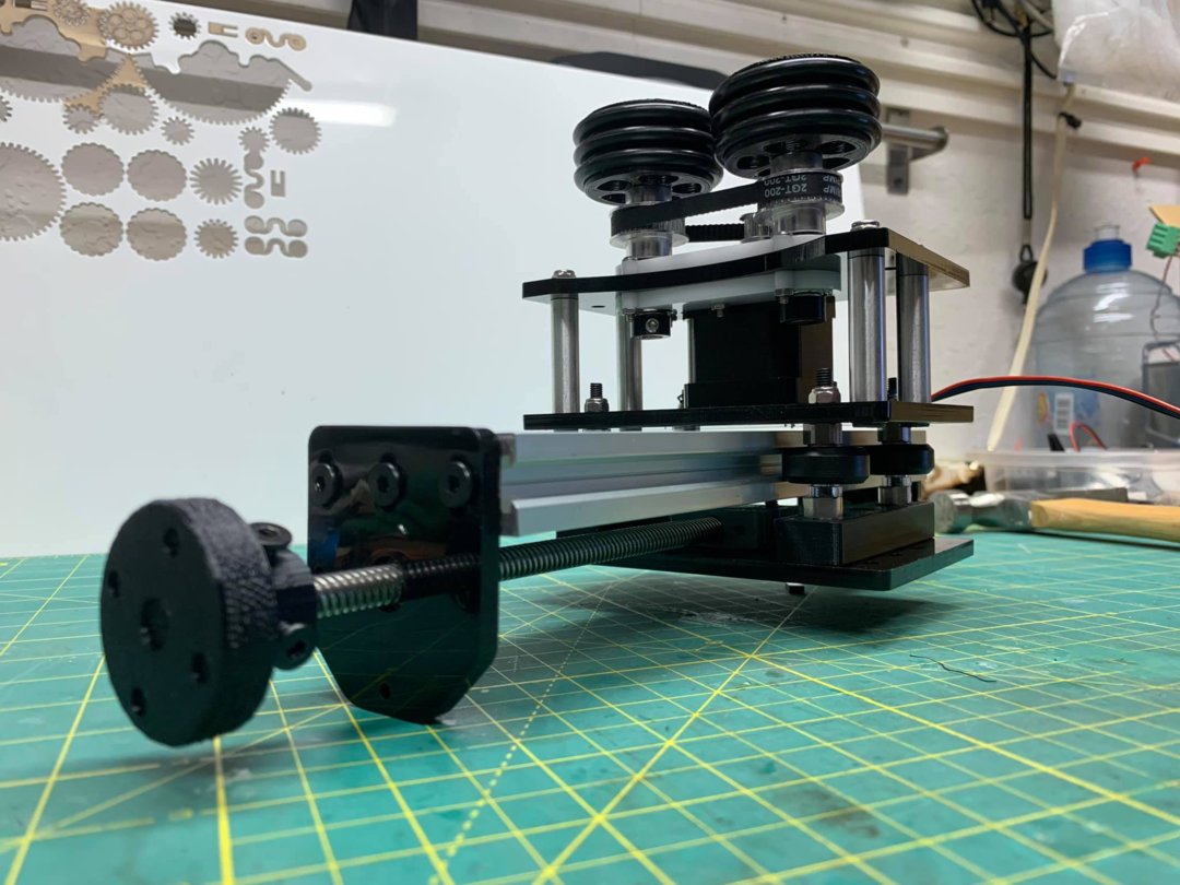

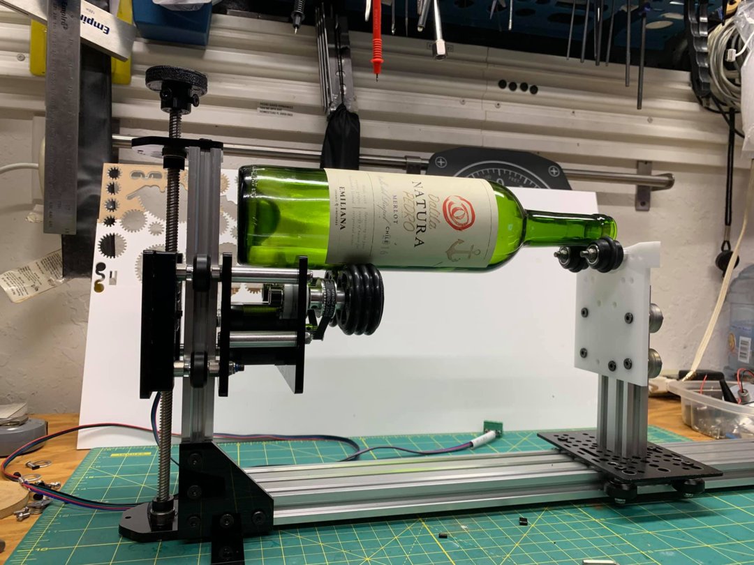

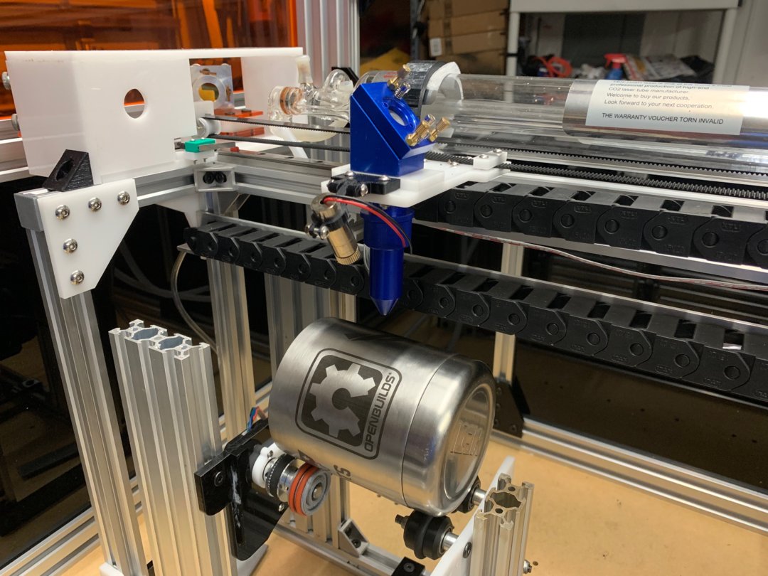

The Rotary Module

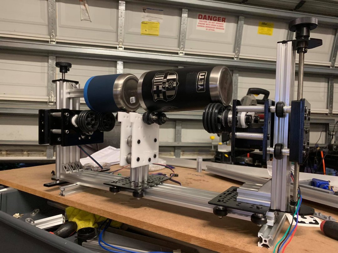

The rotary module is based on a normal friction type rotary attachment for laser cutters/engravers,
but the way this machine came up capable of doing I came with the idea to incorporate a Z axis to it for easy focal distance adjustments, and be able to fit all kinds and sizes of round objects.

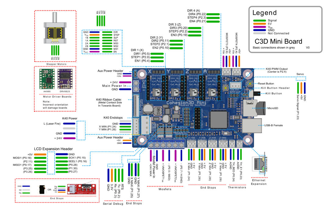

Electronics

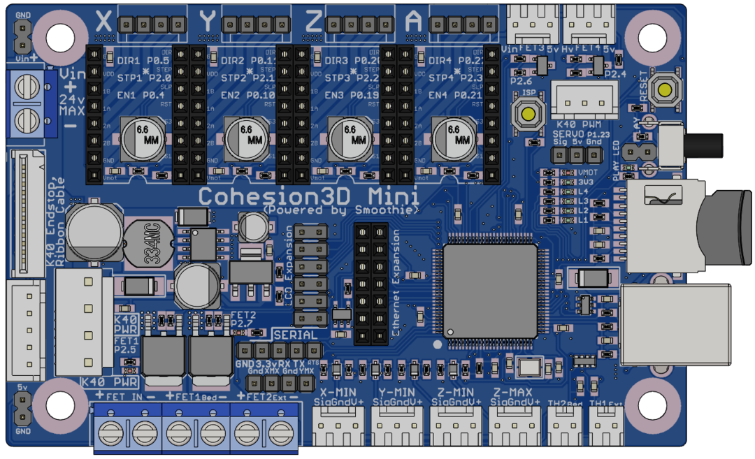

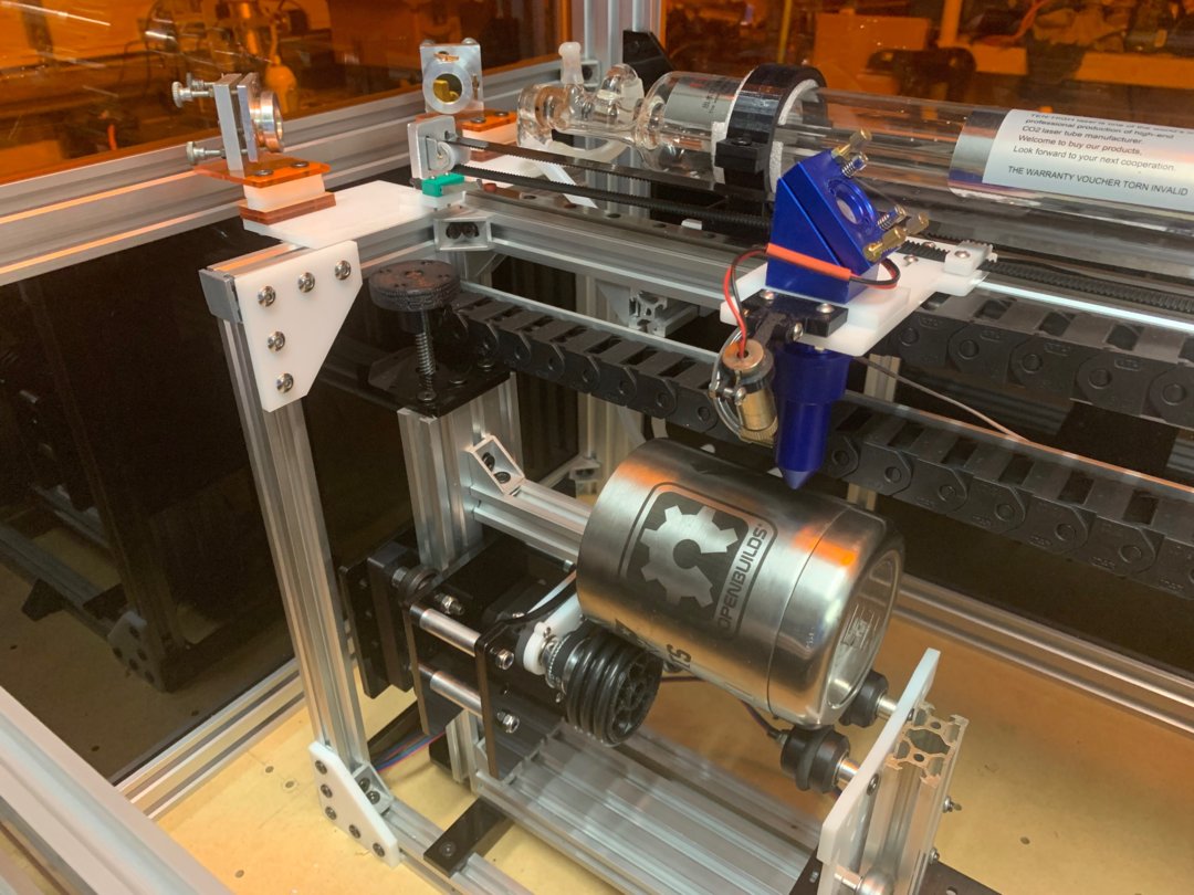

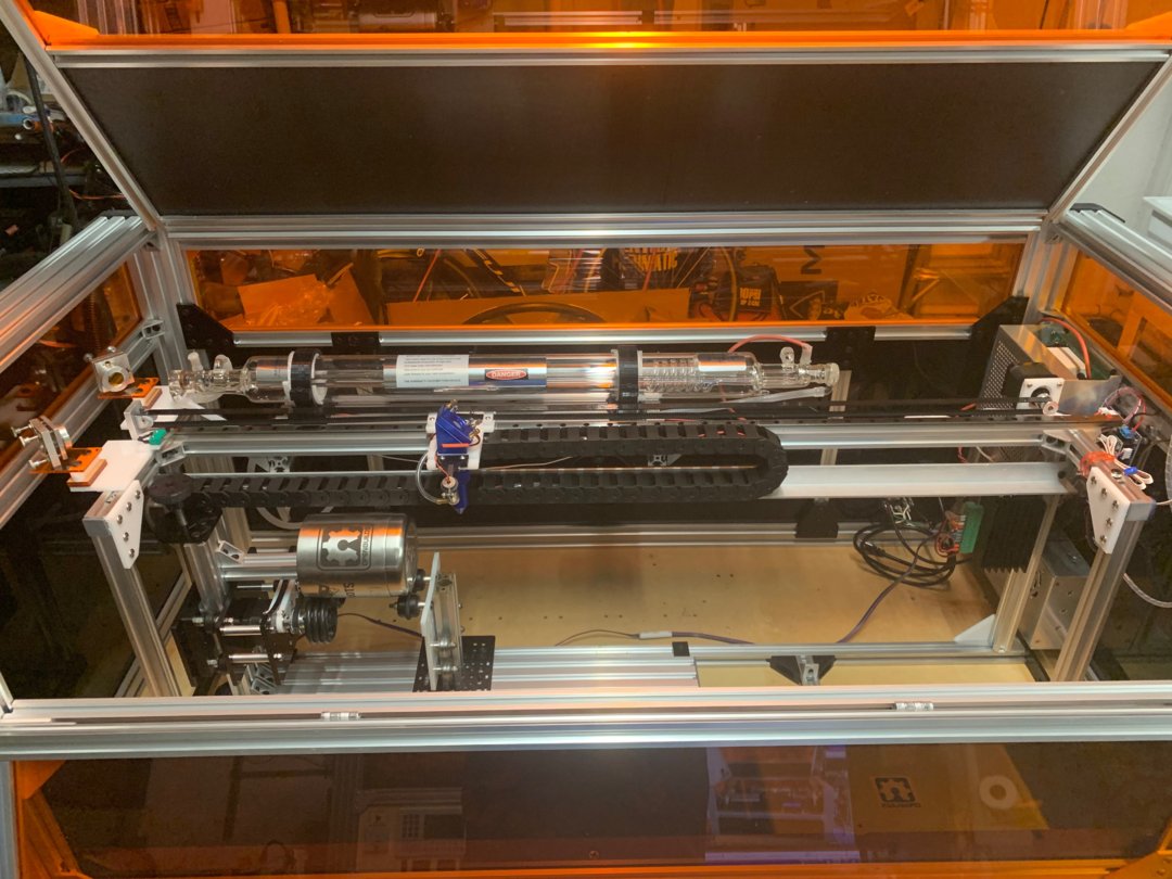

The main brain of the machine is a Cohesion 3D Mini board designed to be use in a K40 Laser cutter/engraver as an aftermarket upgrade, but the C3d Mini board can be used for many other things, like this Build,

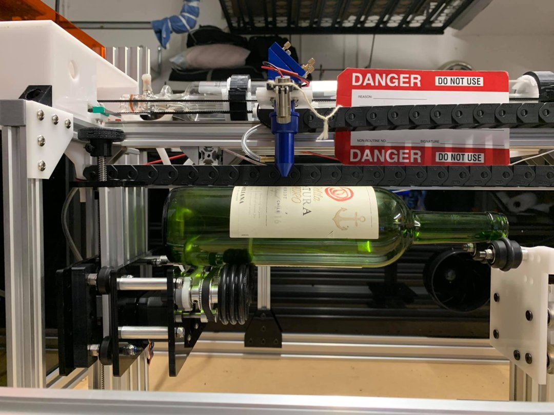

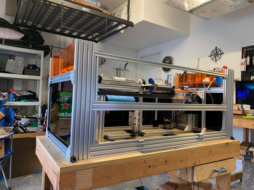

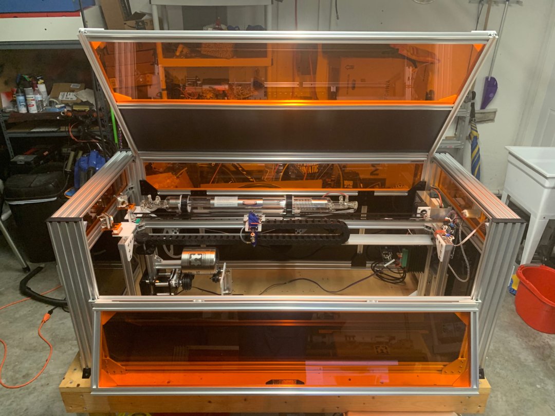

The Franken Rotor
Build in 'Laser Cutter Builds' published by pedrofernandez, Jun 25, 2019.
Yes another K40 Franken machine dedicated for round objects,,,
- Build in Progress...
