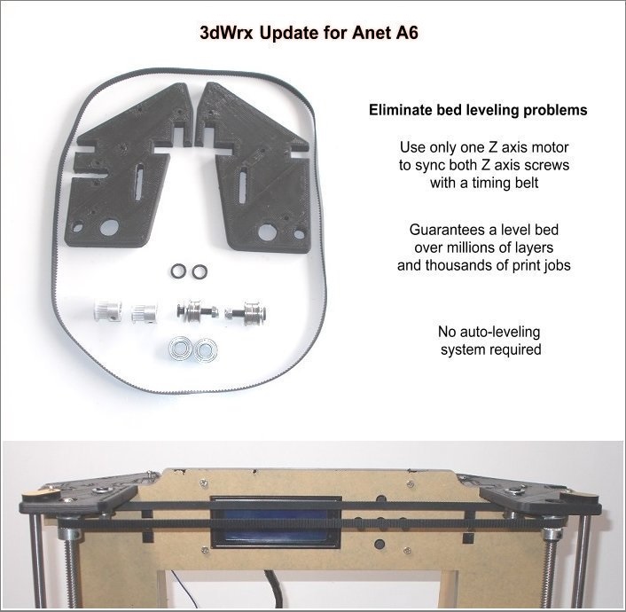

Over the last few years I've developed over a dozen printer designs using this "Synchronous Leveling" concept and have published them on this OpenBuilds forum and sold them on my website and Ebay.

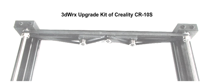

I then designed an Upgrade Kit to accomplish the same thing on a Creality CR-10s printer and another Kit for the Anet A6 printer. I've sold more than 100 of these kits on Ebay and off my 3dWrx.com website and have more than 100 customers who can confirm they've never re-leveled their printers after installing the upgrade.

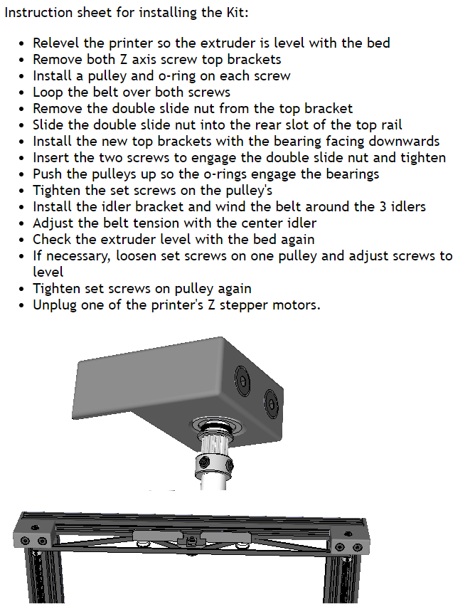

Since you already have a 3D printer, I'm releasing the SKP & STL files for those kits here. By downloading the STL files and consulting the parts BOMs, you can build your own kits and convert these two printers at a fraction of what I sell these kits for.
By reviewing the pictures and instructions and the SKP files you can probably see how to design your own upgrades for other cartesian printers you may have. One of our members, @Steve Jeppesen, has been quite creative at doing that.
