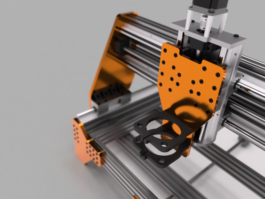

      08/08/2016

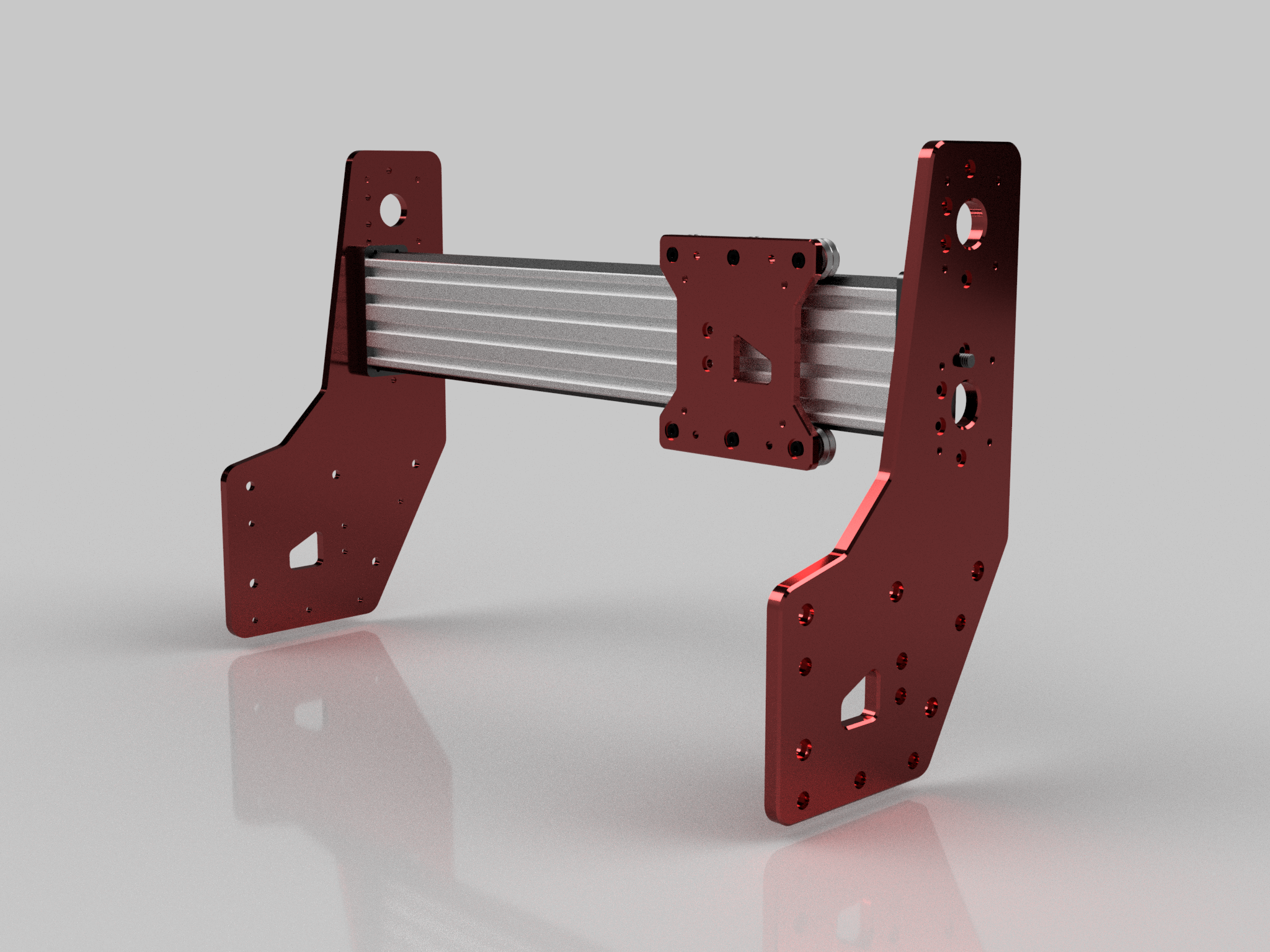

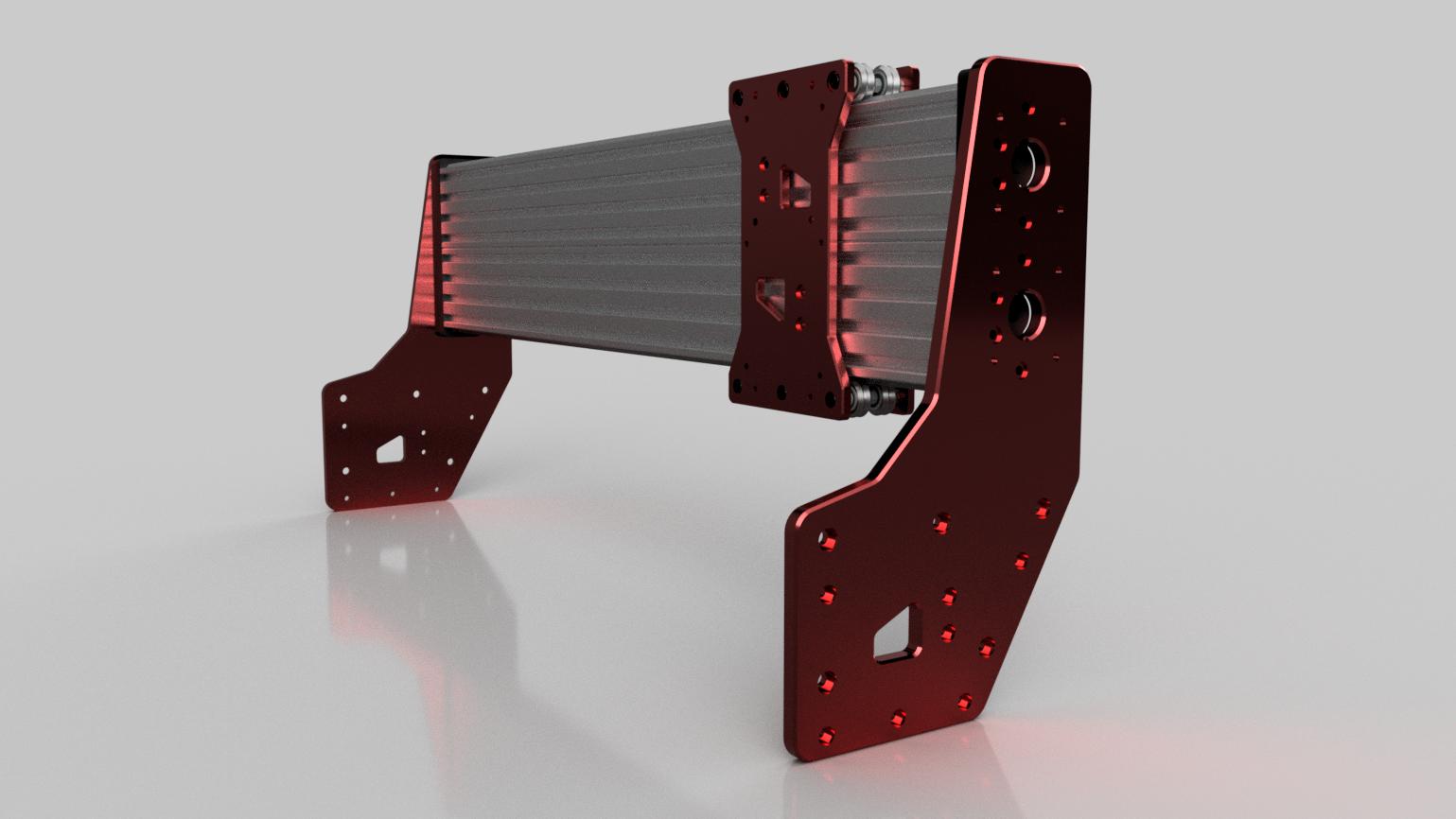

      BIG update. I scrapped the idea for the key stock and stainless wheels. I didn't want to spend more money on getting the machine set up if it wasn't going to give me the rigidity I wanted. So...I'm going linear rails. I found a killer deal on some ballscrews and rails so I caved and bought them. I'm waiting on the rails to show up in the next 1-2 weeks and then I can verify dimensions and start cutting the new plates. There won't be much Openbuilds left in the machine, but I love this community so I will keep sharing so we can learn together. I could use any tips or ideas you guys have. :)
      Probably 20 hours of CAD and here's what I've got...

      Finished up the assembly (minus fsateners, that would take forever). Just going to go with a simple design for the Z axis and motor mounts. Everything looks good so far, just waiting for funds to start the project. I'll need a lot of aluminum, wheels, and the key stock (super cheap).

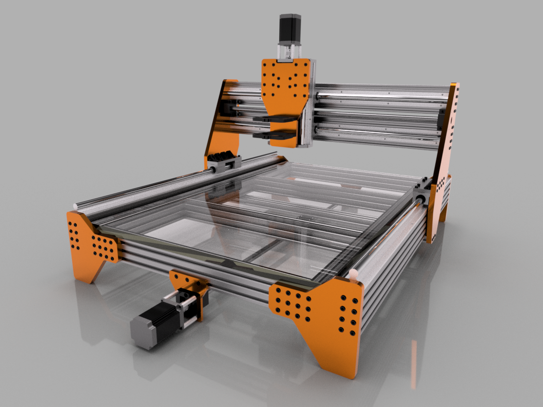

      Finished up most of the design today. Still need to decide what I'mm doing for the Z-axis, whether to go with the steel reinforcement or not.
      I decided to create 'feet' for the y axis ends to serve a few purposes. One, it will allow me to attach the base frame supports with minimal hardware. Two, I can attach leveling feet to the end plates to eliminate the need for a torsion box. Three, looks pretty cool ;)
      Here's a few more renders of the fully assembled design:

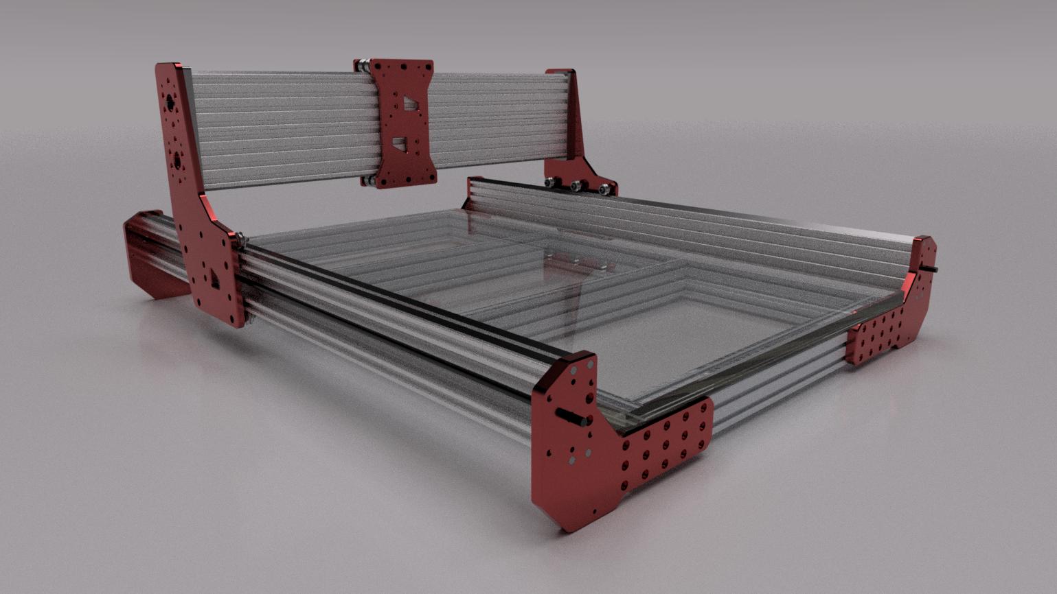

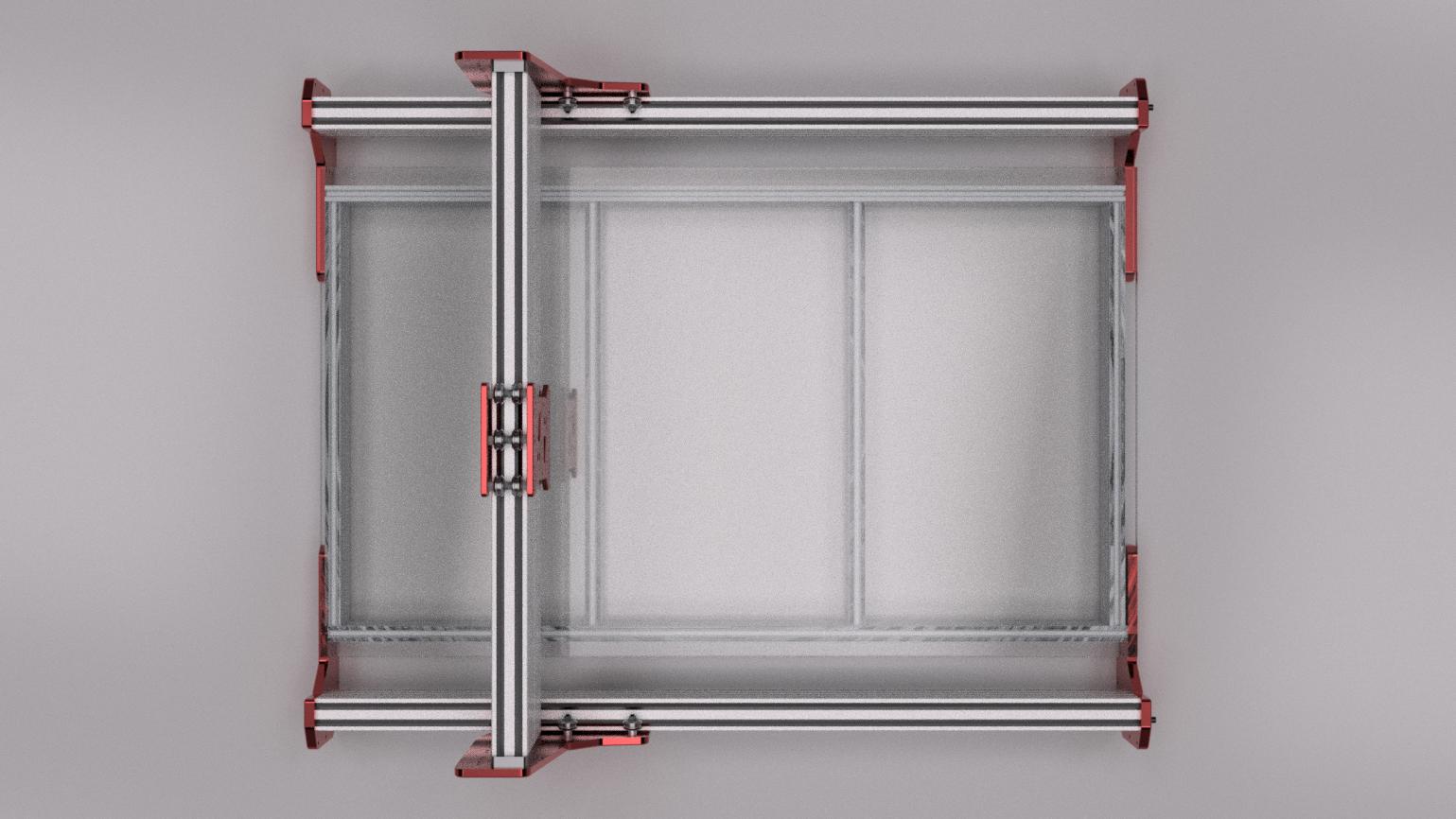

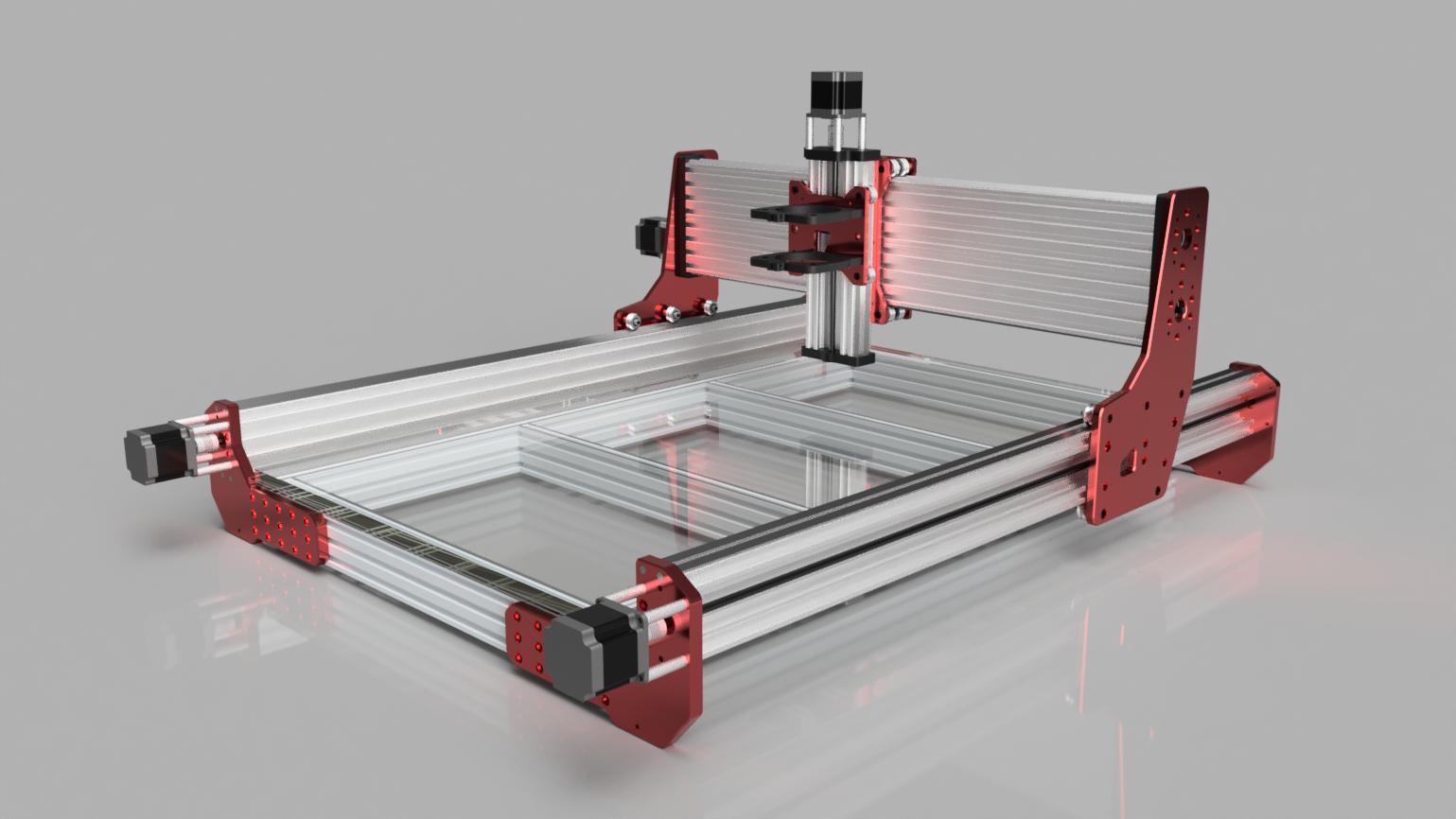

      07/25/2016

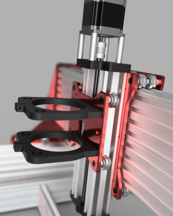

      Howdy!

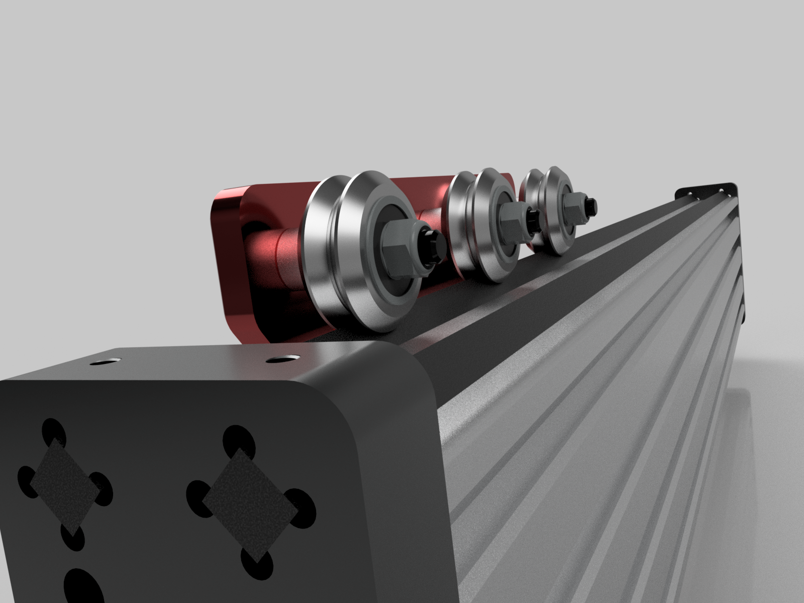

      I only finished my build a couple of weeks ago and I'm very happy with the results, but I've got the upgrade bug. So far my machine is running really well even with aluminum @ .04" DOC and 60 IPM and 11500 RPM. Those are good numbers but I get a bit of chatter on the X gantry as the bit get dragged behind and then snaps back into place while pushing in the y directions. I believe this is mostly due to the deflection of the Xtreme V wheels and the relatively small wheel base. I also have to baby the machine to keep the wheels from getting aluminum stuck to them and marring the rail.

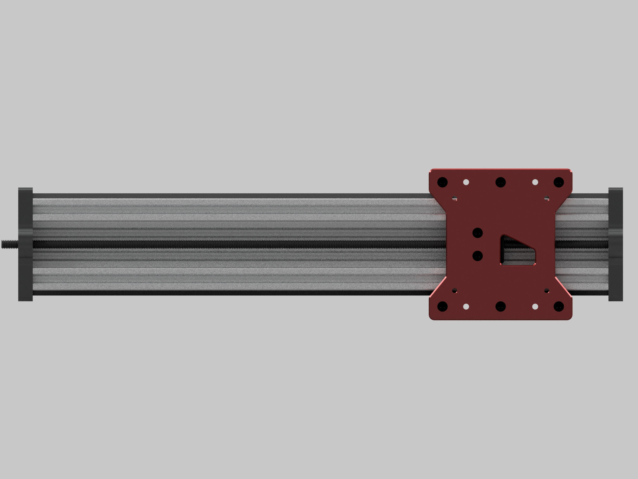

      Another issue I want to address is the anti backlash nuts. Currently, the only way for me to adjust them is to completely disassemble the axis. I want to create a sort of window to give me access to the nut block.

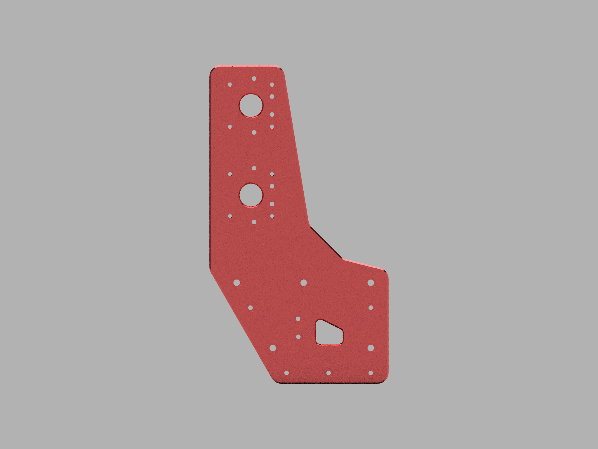

      I also want to create new Y axis plate that will accomodate a second C Beam rail to attach the Z axis to. I wont add it immediately but when I do it it should have a tremendous effect to resist torsion and deflection of the z axis.
      After I was inspired by Rick 2.0 and Metalguru I got to designing a new machine revision. I plan to use 1/4 x 1/4 key stock in the V Rails to create a steel support rail for some stainless v wheels. This will require new gantry plates, end plates, and new wheels. I've uploaded some renders of my plans so far.
