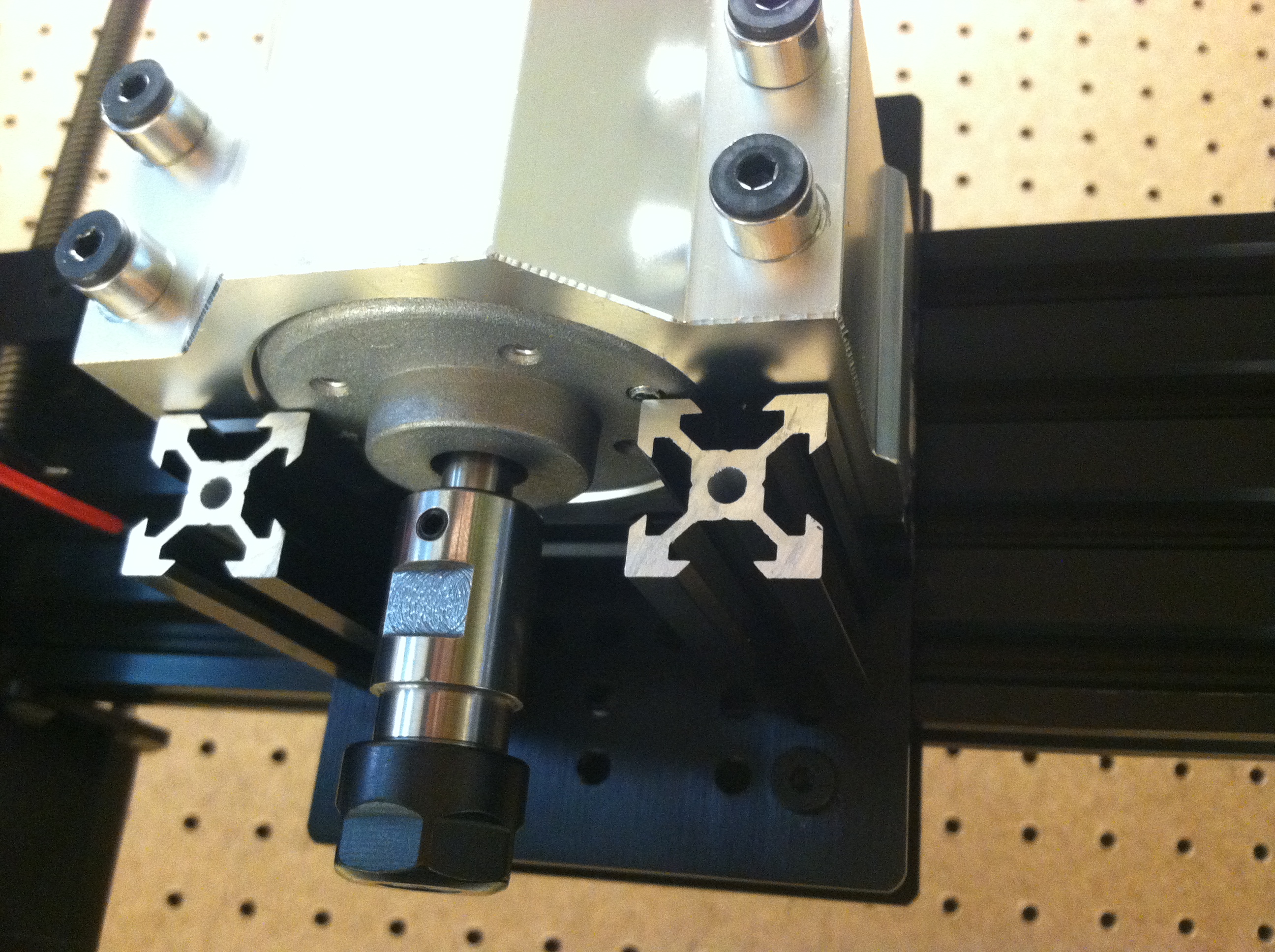

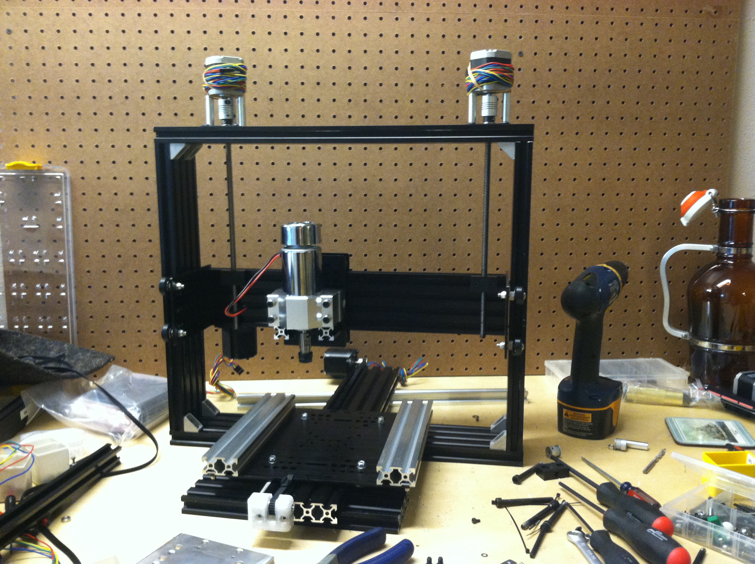

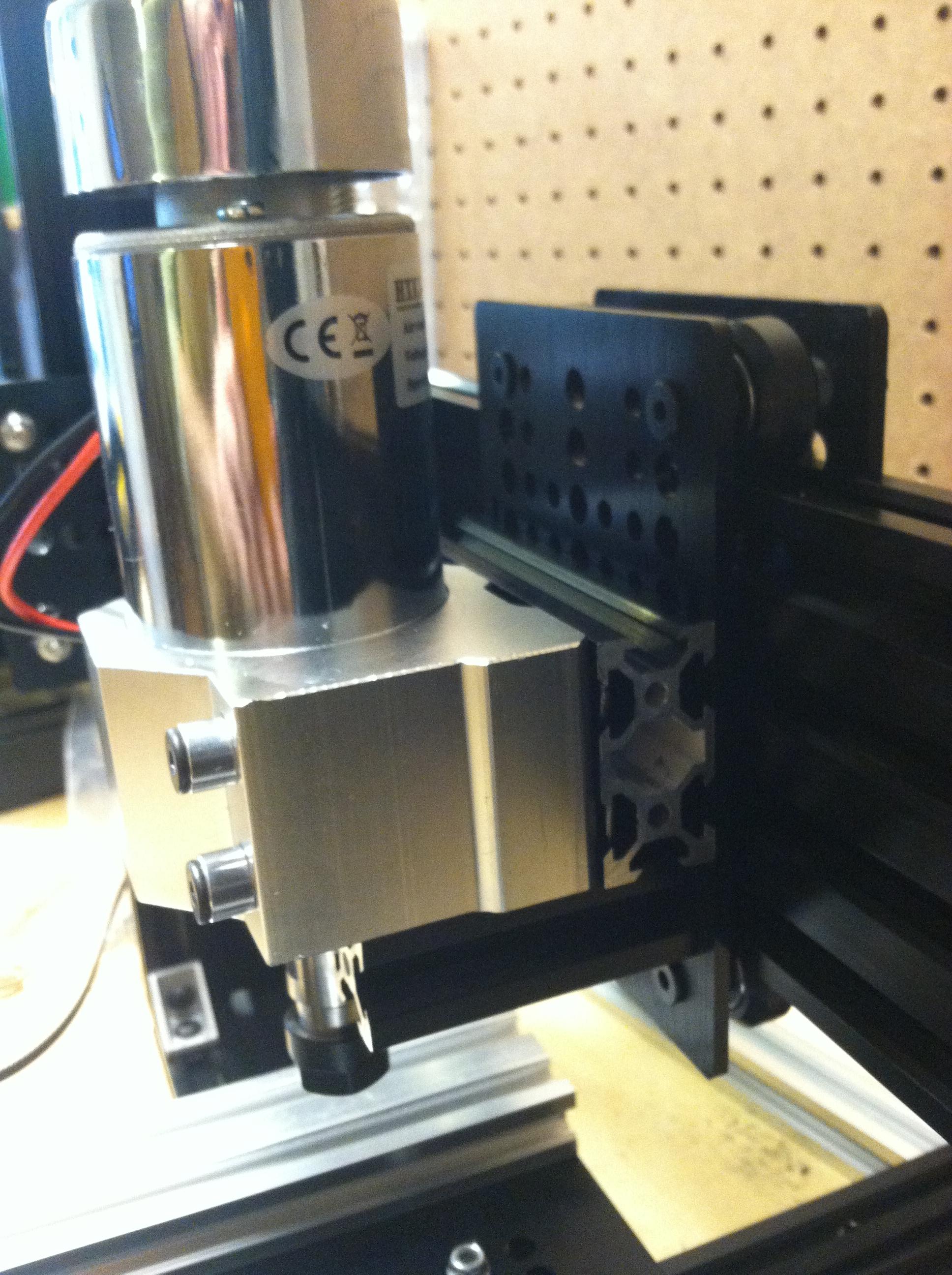

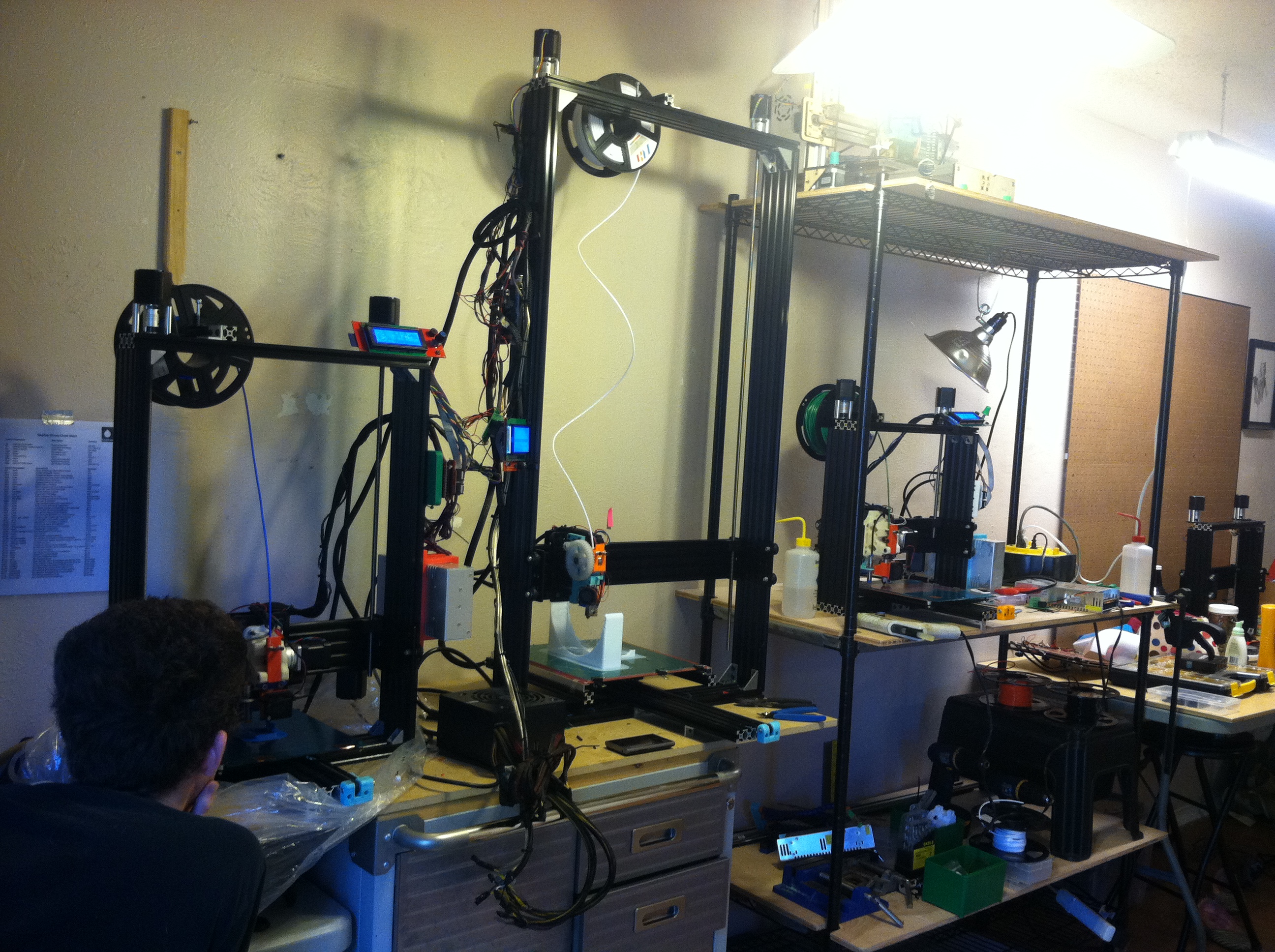

Voxel OX is a super-sturdy 3D printer and CNC platform design I came up with for our 3D printing shop. It uses mostly 20x80 v-slot extrusion, is pleasantly quick to build, and rigid enough to hold a 400w spindle. We've completed over half a dozen variations of this build. Print quality and reliability have turned out to be excellent and dependable.

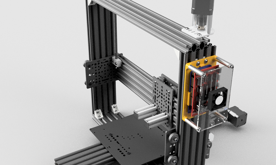

A couple short 20x20mm extrusions make the universal extruder mount that can be used to mount cooling fans and various accessories. STEP files for a Greg's wade extruder variation, RAMPS & LCD mount, adjustable Y-idler and 3D printable rubber (TPU) dampening feet included in the assembly, could be used in other builds. Some parts might be missing or will be updated soon (message if you need them sooner).

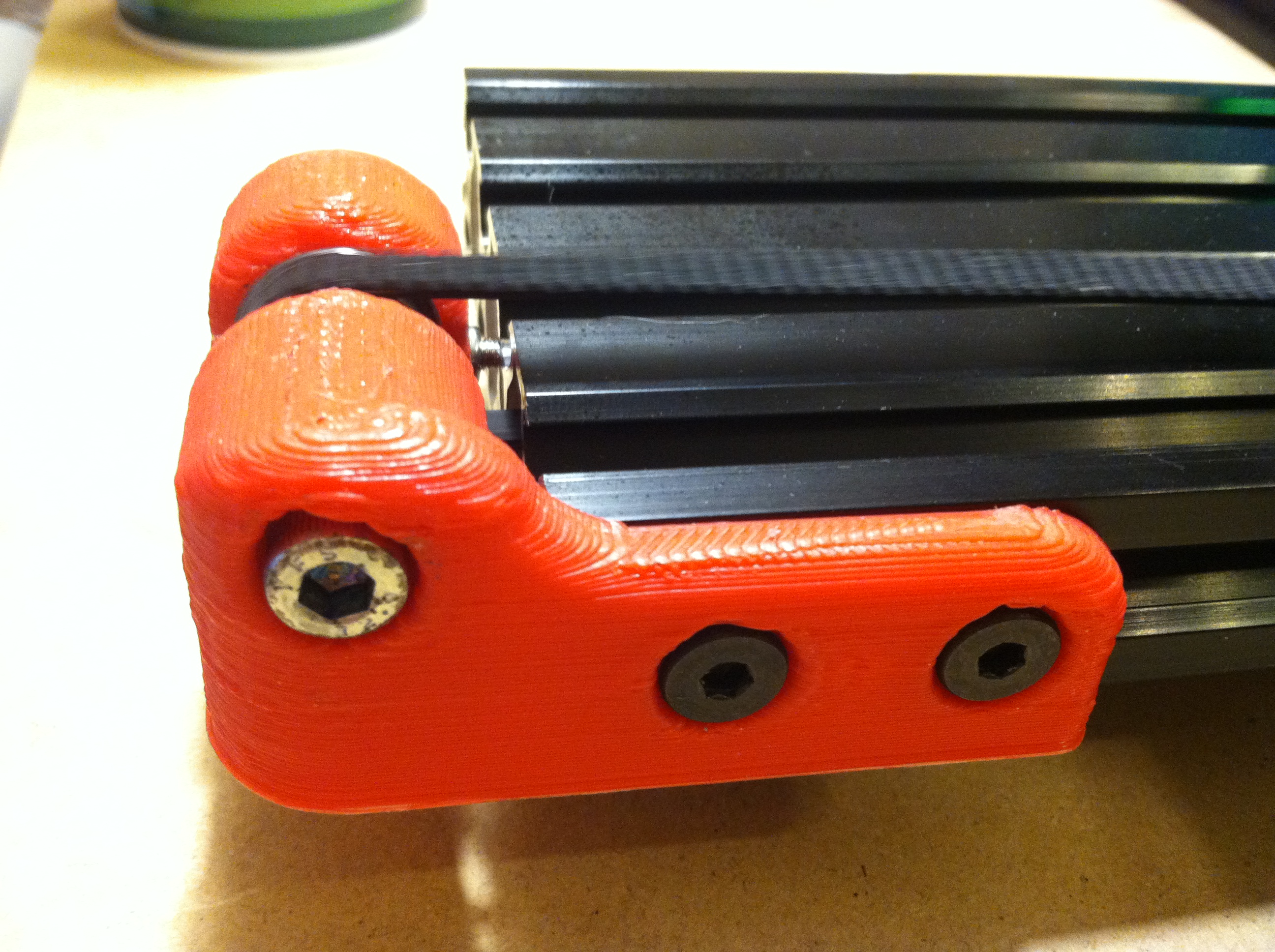

2) Assemble the x-axis and it's wheel carriages. The x-axis rail has 2 holes on each side tapped with an M5 tap for the the non-eccentric side of the carriage plates.

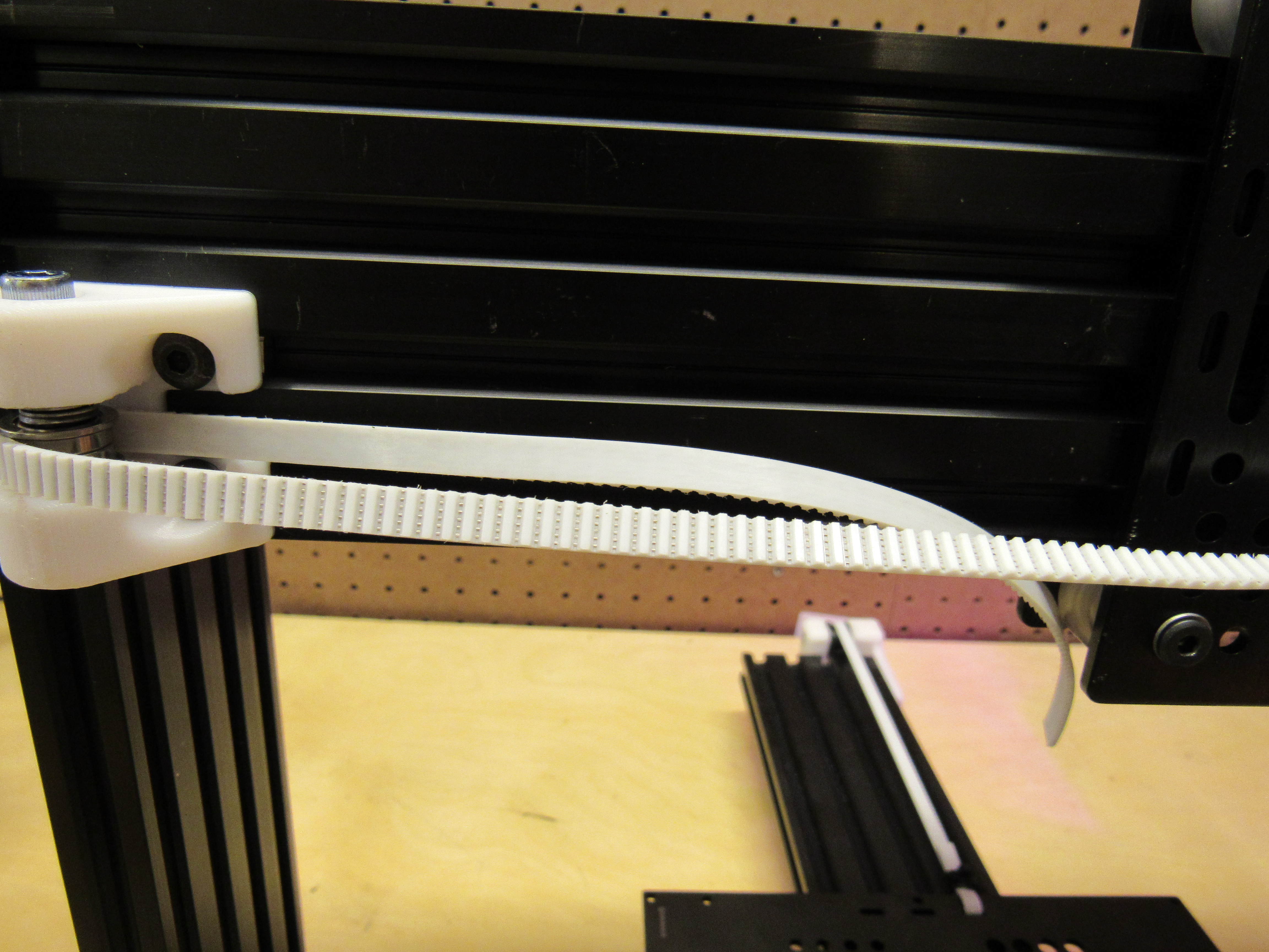

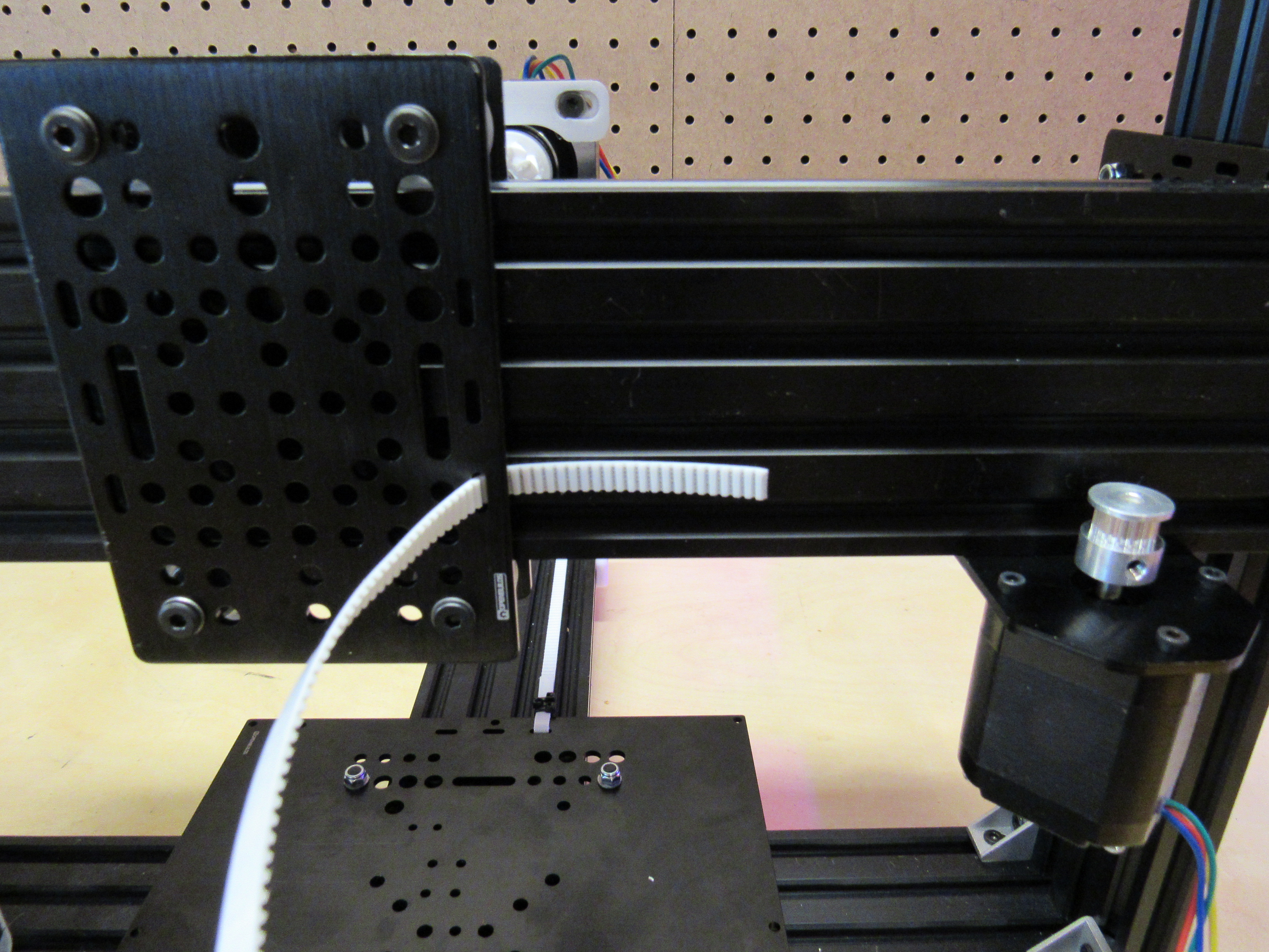

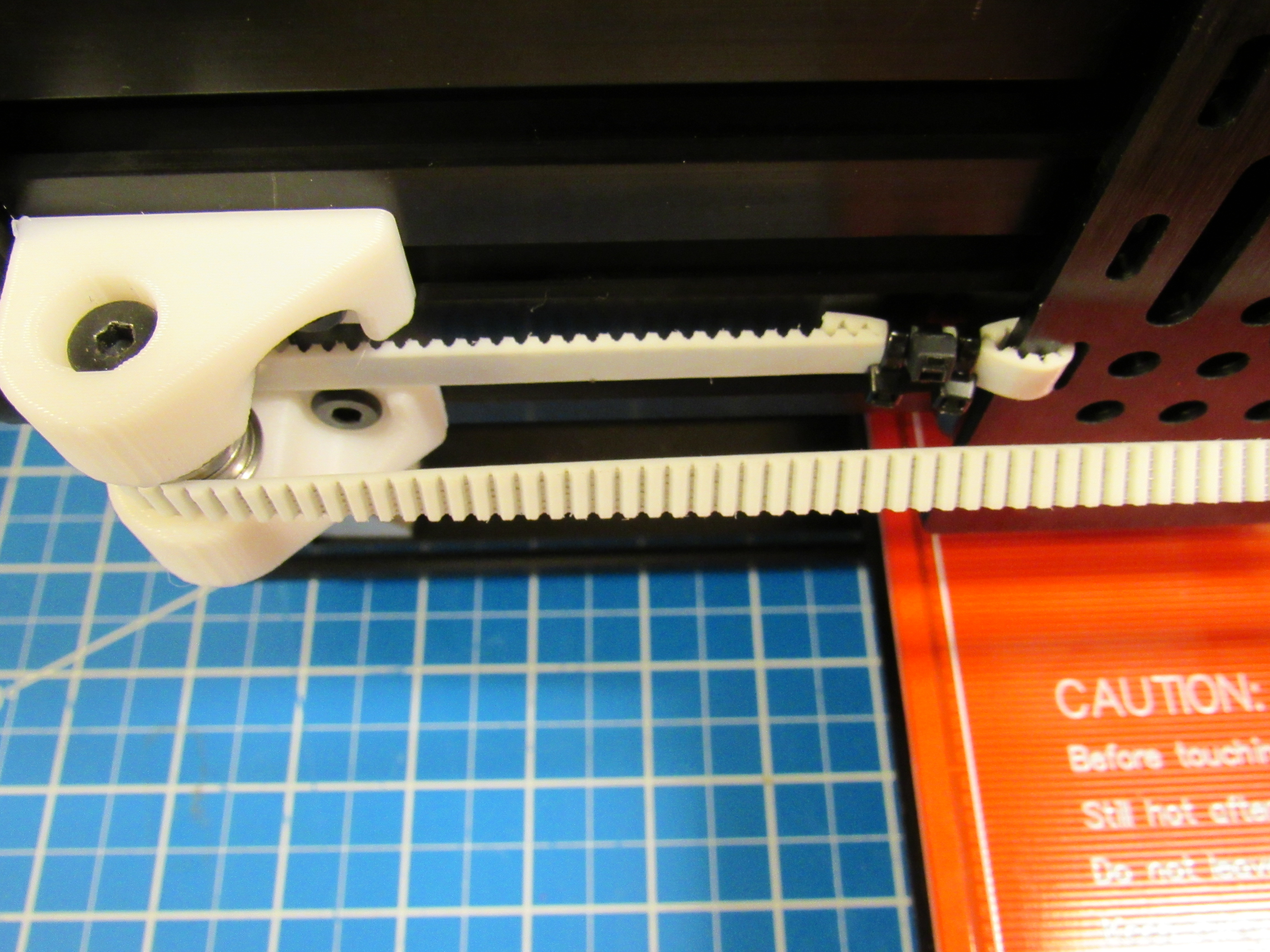

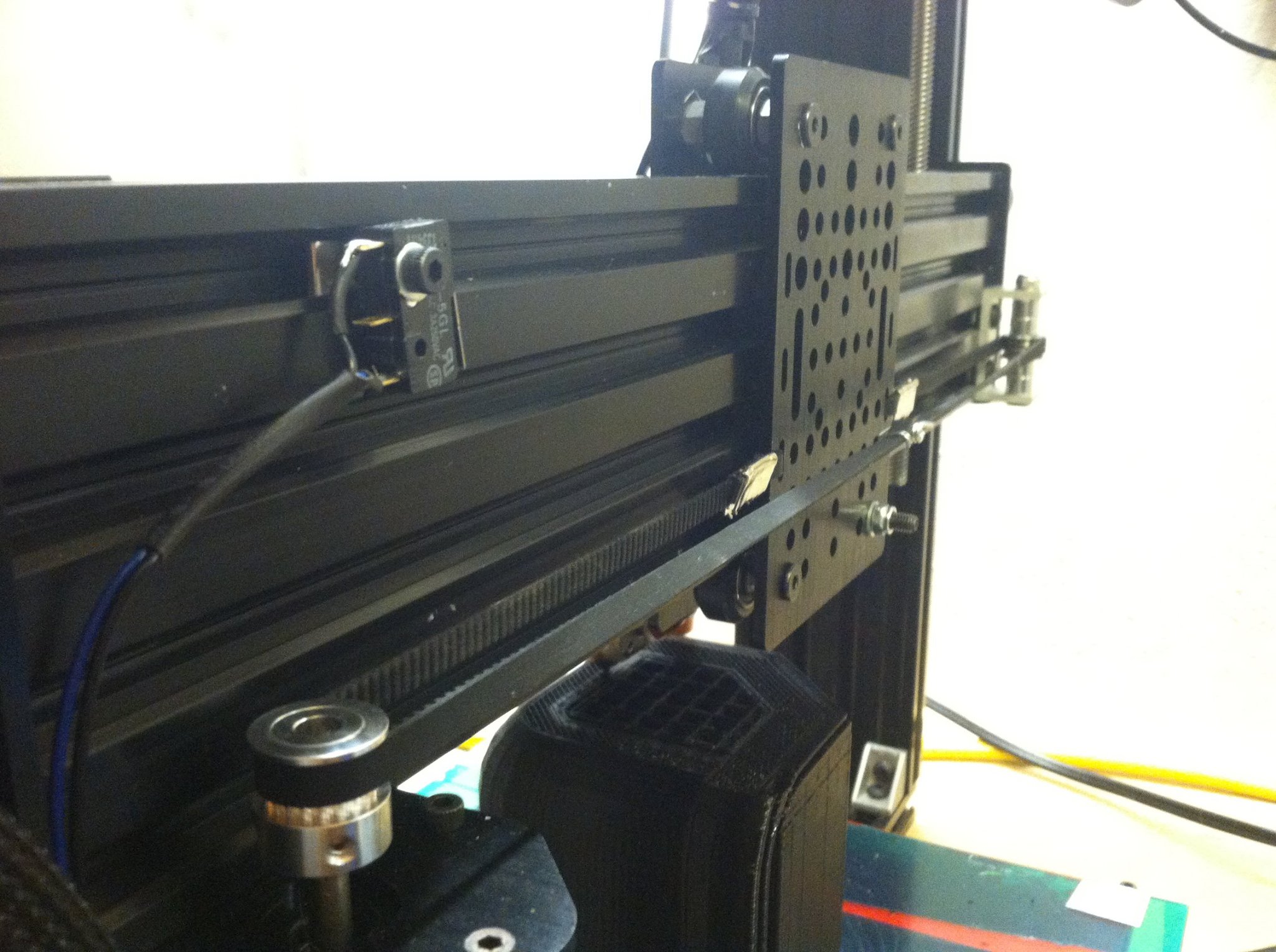

X belt assembly
Running belt for X and Y axis can be a little tricky. The following method, calls for twisting the belt around the idler in both cases. This allows for smoother motion. The exact order of operations allows for easy looping and threading through the slots.
Step 1) Thread entire belt through right side of the plate (bottom slot) and around the back of the motor pulley with teeth facing the direction shown below.
(fig. 1)
Step 2)
Run the belt over, then under the idler. There should be a belt twist in-between the motor pulley and the idler.
Next, push the belt through the slot (teeth facing left) into the slot and under the plate. The carriage can be moved to the left slightly to help push the belt out.
(fig. 2)

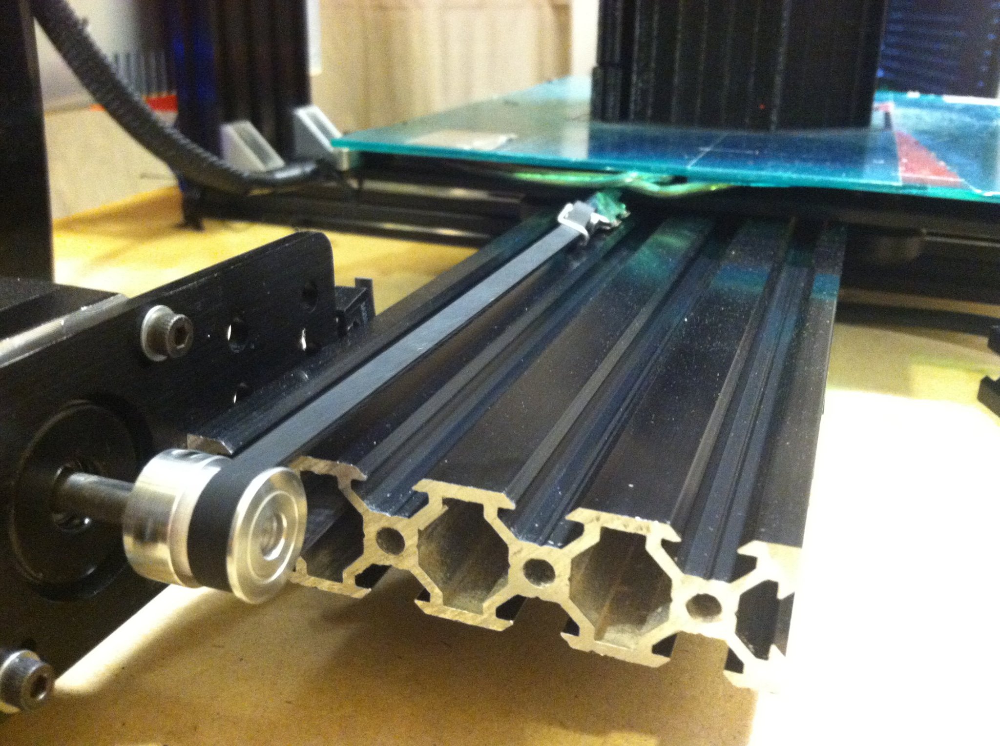

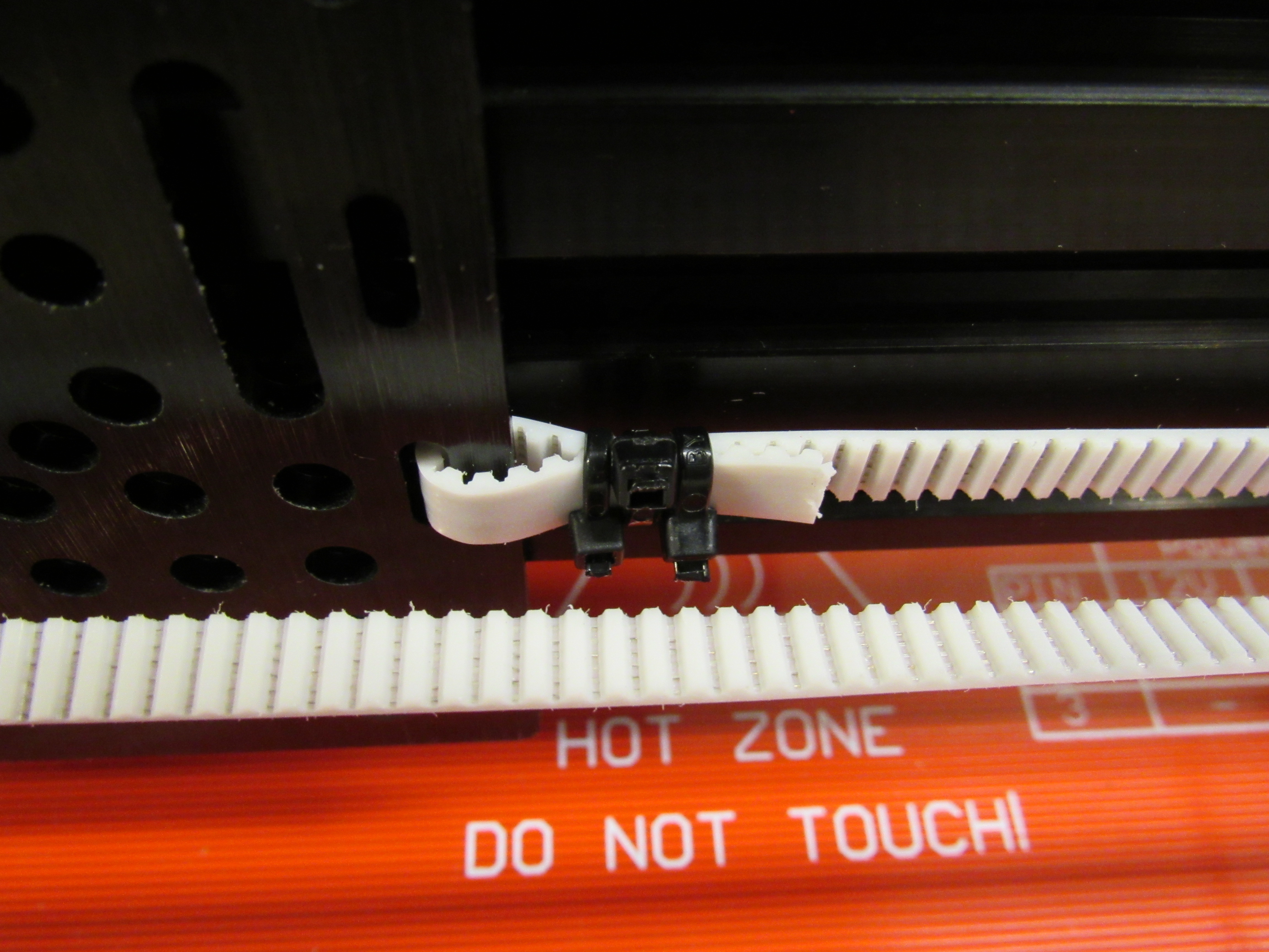

Step 3)
Move either the motor mount or idler to give about 1cm of slack. Next, zip tie the ends of the belt so that the teeth touch each other. 3 zip ties should be enough to secure the belt. Clip the excess.
(fig.3)
(fig. 4)

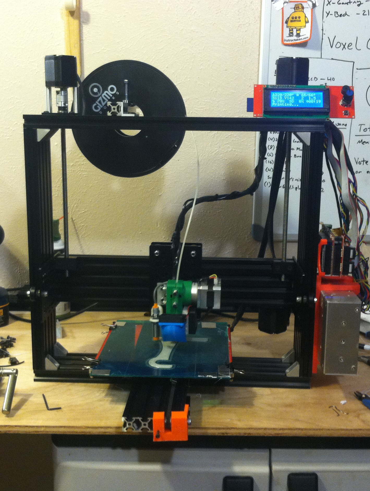

The Arduino/RAMPS uses generic Marlin firmware. Of course, others could be used.
Here's an Auto-leveling Instructable I wrote containing sensor and setup recommendations and some firmware related info for Marlin. Here's the link for the latest firmware for 10" x10"16" (auto-leveling enabled) version of Marlin I'm using. Edits for max travel / machine size and other minute changes might be needed for your setup.

If you would like a head start with the build, we have stocked enough extra parts from OpenBuilds as distributors to have a small inventory of pre-cut pieces, assembled frames or complete machines in various sizes. For more info, you can send us a message here, contact via prototobuilds.com , ProtoBuilds or email [email protected]
This design is easily extendable by changing a small number of parts. Want it 16in tall? Just change the (2) z-axis rails and add (2) longer lead screws. Want the y-axis longer? (1) rail and longer belt is all that's required. The x-axis can be extended by changing the top and bottom frame, x-axis rail (3 pieces) and longer belt.
So far we made a few different sizes and one that used 1000mm long rails and lead screw for a sky-scraper like machine which seems close to the practical limit for height using this design. The 16" tall version using 500mm lead screw turns out very rigid.
For complete assembly, containing part lists and sub-assemblies downloadable in multiple formats including Autodesk, SolidWorks, STEP/IGES and Fusion 360 use the following link:
Full Assembly (View only, use the dropbox STEP file assembly below for download)
Assembly made using Fusion 360 (free for Individuals, Startups, and Students).

Features:
As Built:
- 20mm x 80mm and 20mm x 60mm black V-Slot frame
- Variable build area
- Up to 75mm/s print speed and up to 200mm/s travel speed
- Lead screw driven Z axis
- Belt driven X and Y axis
- Adjustable Y axis tensioner
- Each axis expandable up to maximum OpenBuilds extrusion profiles and available lead screw.
- Auto-leveling
- Heavy duty frame
- Mounts any Greg's wade extruder (custom Wade's STEP files included)
- Mount option for 400w spindle
- Any axis dimension ranging 8", 10", 12" or 16" x/y/z (8x8x8" in most pictures)
- E3D V6 Hotend, E3D Volcano, or Generic J-head compatible
- 76oz-in high torque NEMA 17 stepper motors
- Electronics:
- Ramps +LCD and Arduino kit
- drv8825 drivers (for more current over A4988 Pololu)
- Mechanical X/Y Endstops
- 12v 30a power supply
- Inductive sensor
