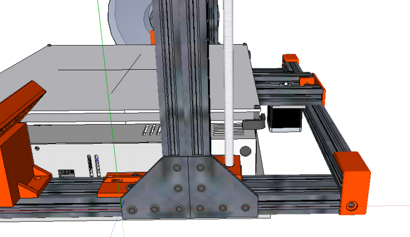

The most obvious Vulcan improvement is the placement of the PSU and controller box within the base frame under the build plate instead of housed in an appendage attached to the printer. The Vulcan also uses the 3dWRX 'Posi-Drive Leveling' concept. A single Z axis motor driving two Z screws with a timing belt keeps the two Z screws in sync with each other for the life of the printer, eliminating the very cause of leveling creep. See White Paper
The main improvement of the MAX version is the rigidity of the Z frame mounting and Z gantry by using all metal, off-the-shelf components. The Z upright extrusion is again a 40x40mm extrusion mounted to the base frame by two L shaped joining plates butted against each other.
This mounting will eliminate the swaying on the Z frame found on CR-10 printers.
The MAX version likewise use all metal, off-the-shelf T shaped joining plates for the Z gantry.
Between the improved rigidity of the Z frame mount and Z gantry, the MAX X gantry will be as stable as the Y gantry, which carries far more weight. The only limit to high speed printing will therefore be the adequacy of the melt zone in the extruder. High speed printing moves a large volume of filament to be melted, and the 20mm tall melt zone of the E3D Volcano was developed for melting just such a volume.
