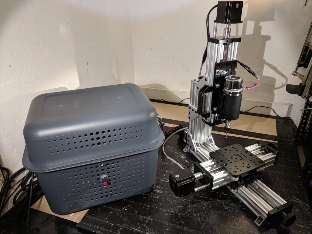

Completed! Buttoned up the power supply, finished all cabling. Time to start carving!

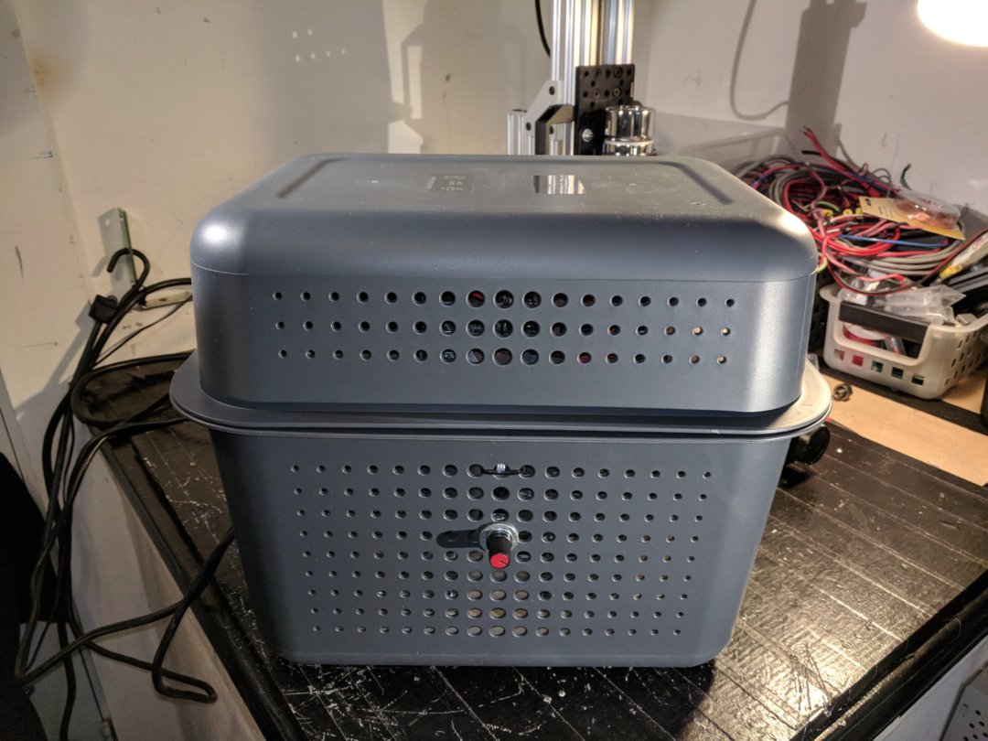

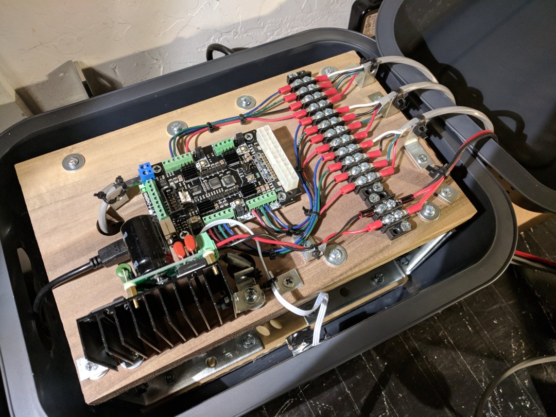

Finished the dual Power Supply with separate PS for the spindle and the stepper motors. Variable speed control for the spindle. I moved the terminal blocks away from the edge for protection and the enclosure has a removable top and slots to route the cables through. The enclosure courtesy of The Container Store including the matching top (see pics).

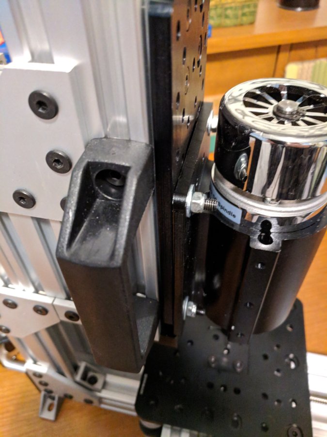

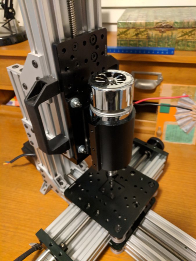

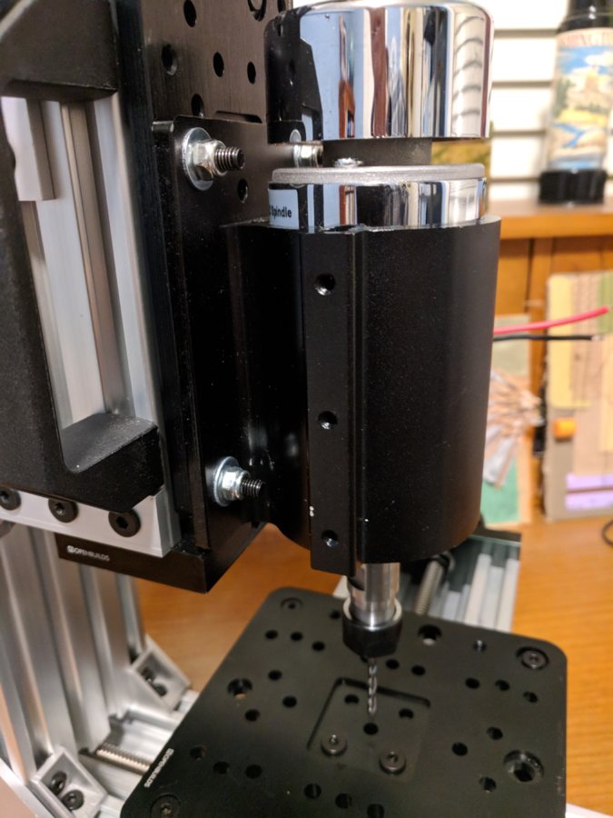

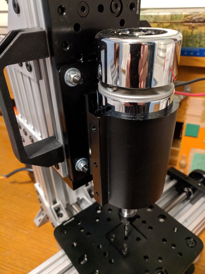

Finally mounted the new spindle after trying many different approaches. I wound up using the matching spindle mount but had to enlarge the mounting holes in it (which were 70mm) to fit the 60mm holes in the MiniMill's Z plate. I also had to drill out the Z axis mounting plate to recess the mounting bolt's heads (a hack job; should have taken more time). But at least the new spindle is mounted! Next step is to hook up all the wiring to my now external power supply. Added some new pix to files and drawings section

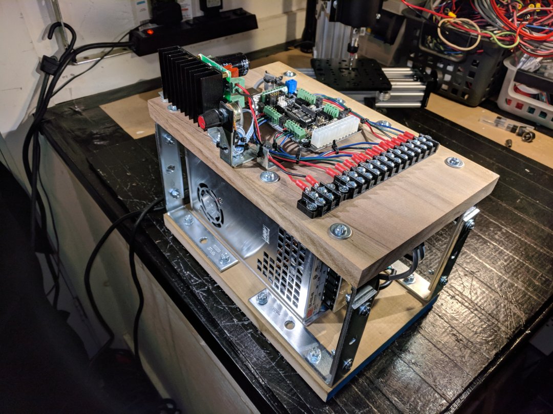

Decided to go with a quiet spindle, which required an additional Power Supply, which led me to slap together a little enclosure to house both Power Supplies, the logic board and the speed controller with its large heatsink. I brought all the connections out to a terminal block and I will wrap the whole thing in some clear plexi with ventilation holes for the Power Supplies to prevent accidental contact. I posted a couple of pix in the files and drawings section

Just finished basic mechanical build and prototype wiring. It works! G-code Sender moves x,y & z correctly. I mounted the logic board using cable ties against an old metal project box plate with the pink plastic padding the logic board came with as padding... and then quick and dirty routing of wires behind the PS
Not sure if I'll ever redo that work as it seems to hang together OK. We'll see how it works once the CNC is in use.
