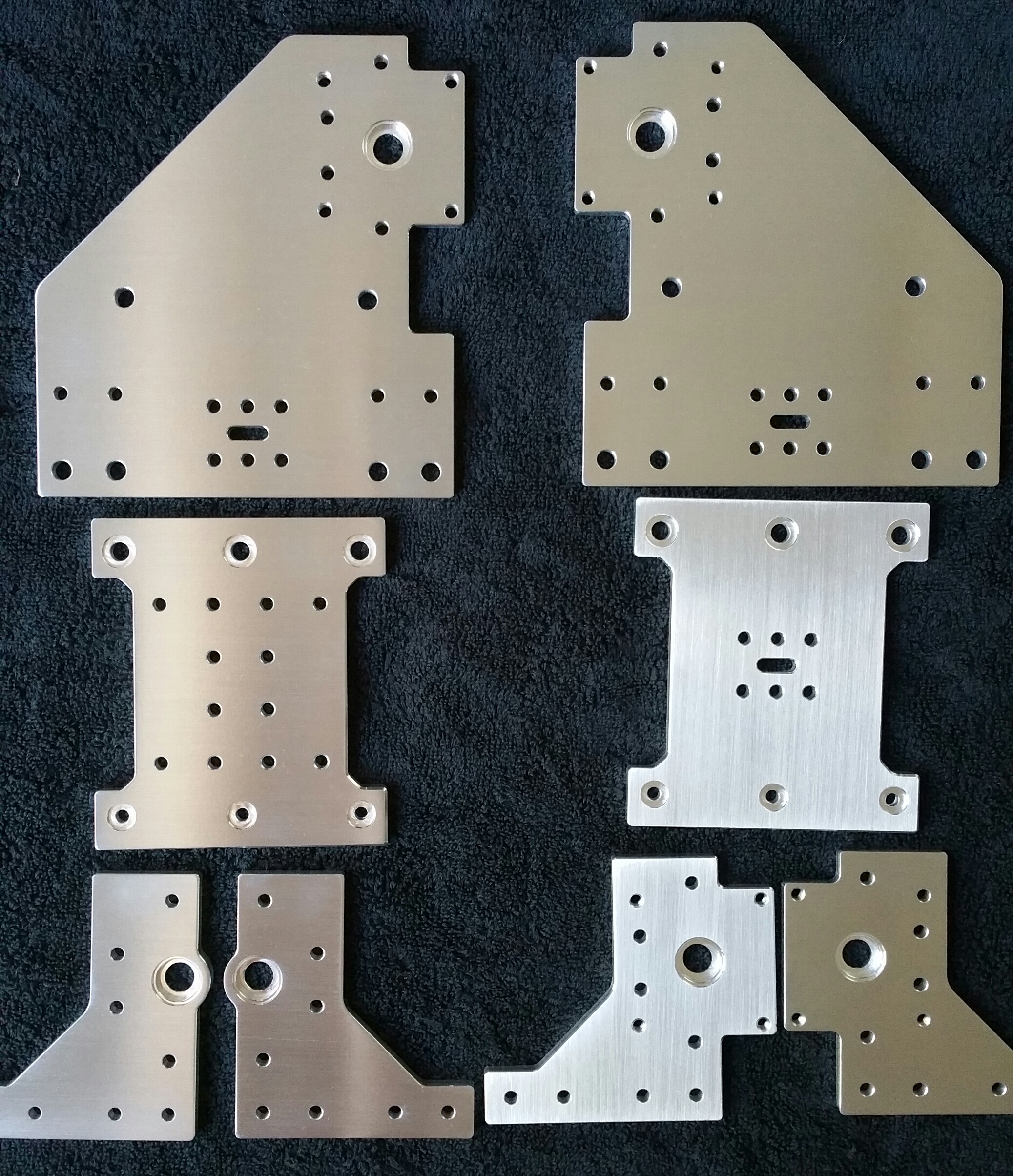

To cool not to share, Thanks Chris!! He cut this plate set from my dxf files with a quick turn around while my c-beam is busy making Thaumatrope discs for @flannelladybug The plates look great! I can not wait to get them in hand.. Exciting times ahead.

      Do you have counterbore holes for the M5 heads? If so, how did you true the end mill for the bearing cuts? Great work... Thanks - Brad
    • Kyo
      All plates are machined from only one side ( no flipping of the plates for machining, was one of my self imposed design requirements ). no additional counterbores or pockets other then what can be seen above.
      Chris cut this set of plates for me. :thumbsup: My c-beam has had a fixture installed for a run of wooden toys. I did not want to have to reset the machine in tell the whole run was over.

      Could you tell me who build them and where can I buy the Y plates?
      Yann
    • Kyo
      @yannyann Thanks.. While I did the design work. Chris made this set for me. He has more listed on ebay (search: sphinx cnc ) and send him a msg. I am sure he would make you just a y axis set. :thumbsup:
