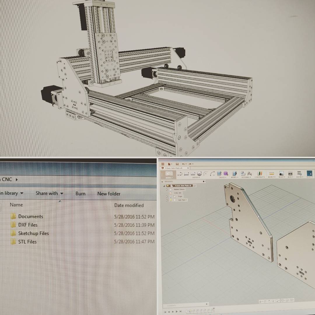

Just a little teaser of things to come :)

      I am very impatient to have the files I want to make this C -beam machine.
      You have make a good job, I have try to make some parts on Solidworks but without quotation it's more difficult.
    • Kyo
      Thanks, Soon very soon. All files will be posted in the build thread. Waiting on a few more parts to arrive. Then the build begins. Working on the build guide steps as I type this. :D

      What bed are you considering? I am planning to have a mister believe a metal bed is in my future.

      For bed I am not 100% decided as of yet. My first thought is going with a base 1/4" aluminium plate something like Mic 6 for flatness and to add a extra bit of weight and rigidity to the frame. Followed by two replaceable 1/2" mdf spoiler boards.
      With the flat vertical walls the back side of the C-beam offers in this build; incorporating say a vacuum formed form fitted "tub" that could be secured in place and provide a water tight area for mist coolant or even flood coolant might be possible. It would just be a matter of swapping it in and out when needed.

      Nice find, I will have to bookmark those links. I am afraid I can not jump on a group buy currently. My build budget for this cnc is tapped. As designed you would need a 420mm wide by 500mm long bed to fit this build.
