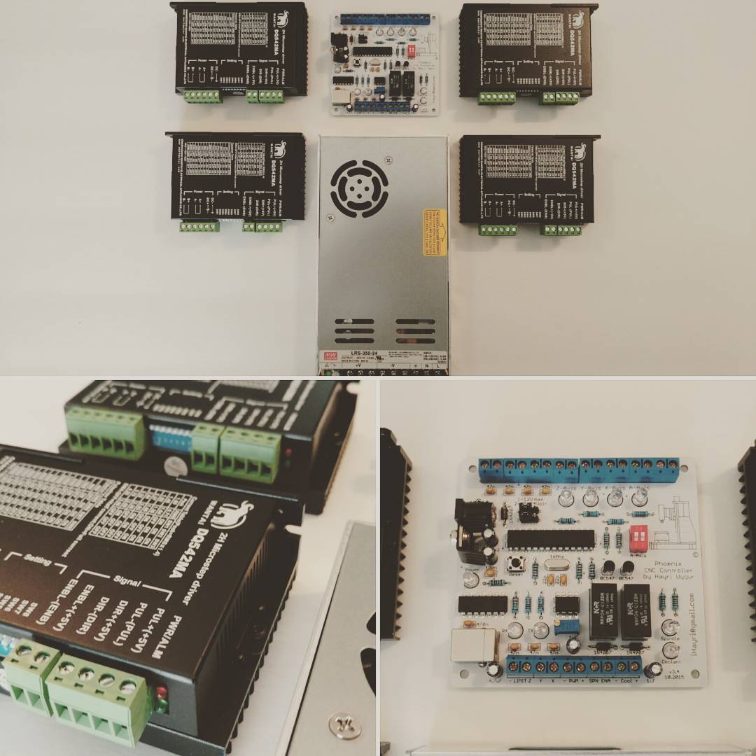

Working on the wiring diagram for the cnc tonight. Here is a little sneak peak; 4-axis usb grbl controller, 24v power supply and the new dq542ma drivers. This should be fun !!

      So you have had your CNC for a while now.
      Would you recommend anything different in terms of electronics?
      Is everything stable?
      Are you satisfied with these drivers?/controller?
      Thanks for your time. BTW How is the enclosure documentation progressing?:(
    • Kyo
      @Buj
      Another member here owns the cnc now. Wish I had the space to keep all my builds... If I was to redo anything on the Sphinx build it would be the enclosure itself. I should have used a larger box with more air flow. ( one of the first mods the new owner did ) The dq542ma drivers + Phoenix cnc controller are a great combo that I would use again. :thumbsup: I no longer have the video / documentation for the original enclosure build I am afraid. However check out @Savvas build he is doing a excellent job with documentation and also uses the Phoenix controller.
