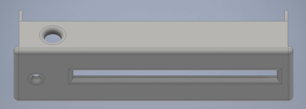

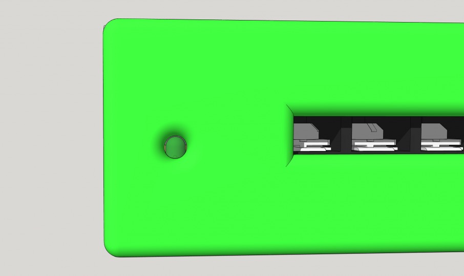

This is simple cover that matches the height, width and add 3 mm to the length. there is a hole to see the LED and one to adjust the potentiometer.
This has been successfully printed and tested I used PETG at 30% infill.

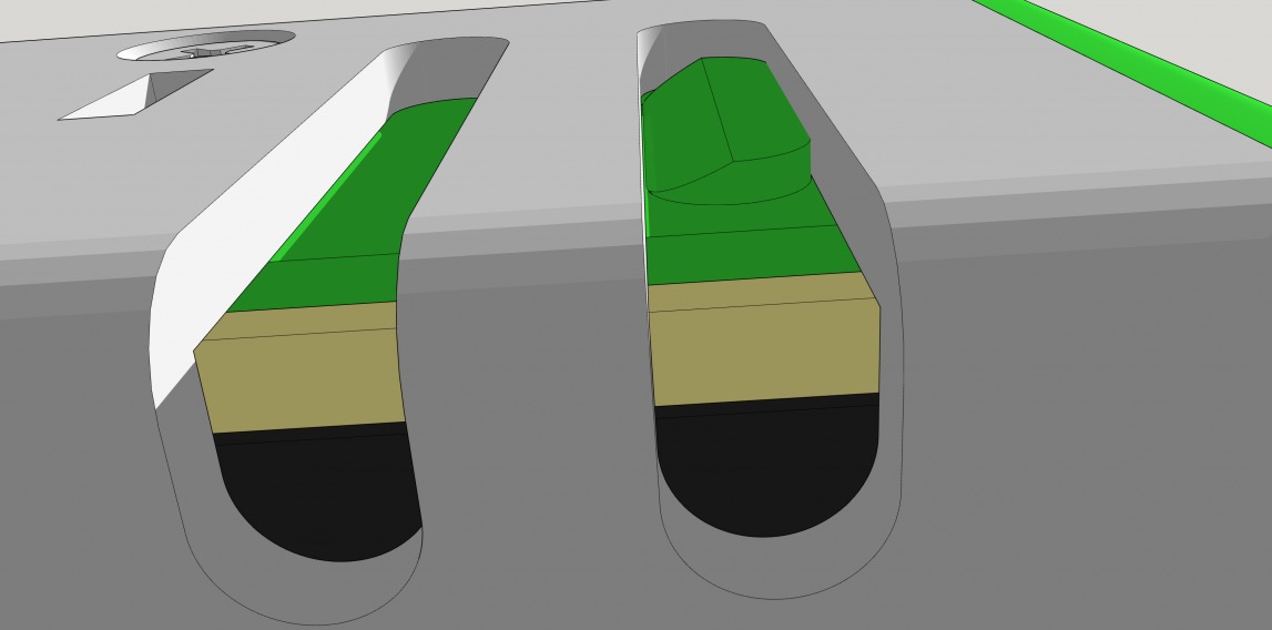

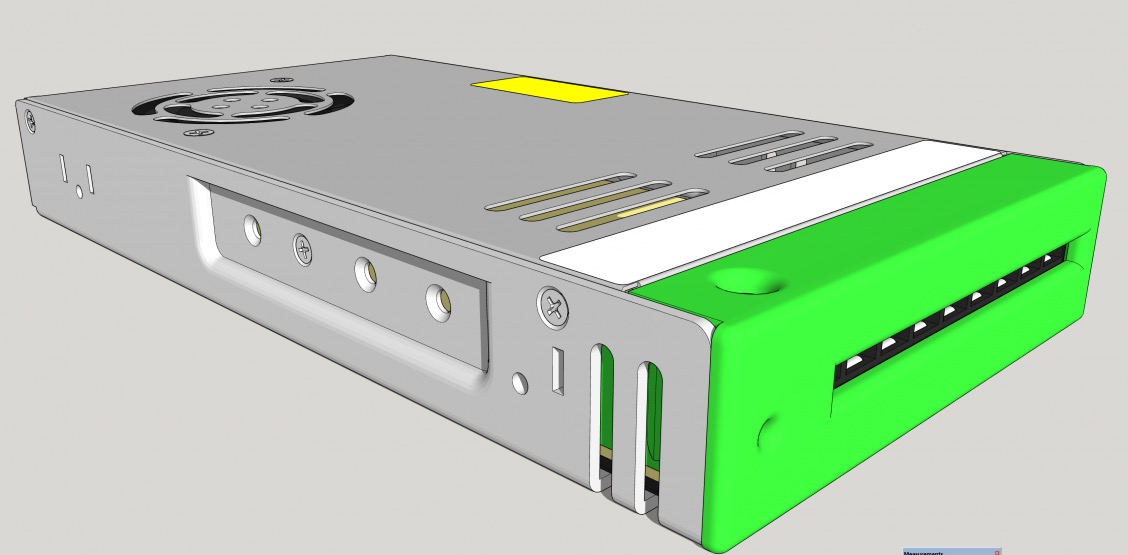

And a thank need to go out to Ronald provided the 3-D modeling of the power supply for the case attached pic.
Small no thrills cover for the new 12v and 24v power supply. V2
