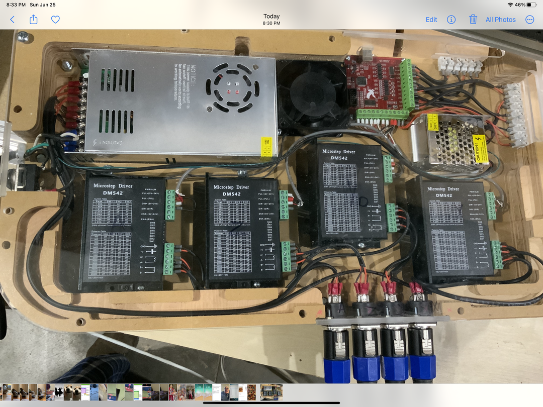

    I unplugged my control board and forgot to take pictures of where the stepper motors plugged into. Each driver has an actual plugin for each stepper motor, the plugins on the board are labels "A", "Z", "X" and "Y". I can follow each wire to its place on the control board. My problem is I only have one"Y" plug BUT to "Y" stepper motors. Not sure how to plug in (2) "Y" motors. When I use my "A "plug to plug in my extra"Y" stepper only one side of my CNC works. Something is very wrong here. Are there any experts out there that can help me.

    15,644
    4,471
    We don't use an A label, so perhaps xPro. If so, 2nd Y motor plugs into A

    I am building the Worker Bee 1000. I switched out both Y motors and the Y plug works with both motors but the A one gets no response

    I’m running mach3 I noticed that the “A” driver had red wire running to B- AND BLACK RUNNING TO B+. Switch them around but still nothing. I think it was originally wired correctly so I’m going to switch them back. All the other drivers are wired red to B+and black to B-. These are lol brand new drivers

    mach 3 is software, what model drivers/hardware are you using? a pic could be helpful as well.
    Here it is

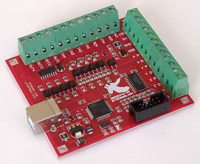

    Ok that helps, so you should see from the controller board Y-Pulse and Y-Direction signal wire running to both Y drives, in parallel, trace those wires and troubleshoot.
    Make sure you are getting power to both drives and and they are lighting up, should be a power and or enable LED on them.
    Make sure the dip switches are set the same on both Y drives.

    I can configure the “A” driver as a slave and it will activate the y axsis on the left side while the right side is separately activated by a separate key. I know the “A” driver has power since I can activate it. Dip switches are exactly the same

    After tracing the wires from the A driver they are going to the “A” side of the control board. My “Y” driver wires are going to the Y side of the control board. I do notice that my B+ and B minus coil has been flip-flopped on the “A” driver compared to the white driver

    I always thought A was used for rotary axis on mach3? Is the machine setup for dual home switches? I'm sure it's possible to use A for Y2 but unless you can do Y1,2 homing independent wouldn't it be easier to parallel the output from Y to both drives?
    Was this machine working fine before the disassembly?

    Or wiring the Y output from the BoB in parallel to both drivers might be easier

    So that would be running the pulse and direction wires from both drivers to the Y axis on my bob. Is that correct?

    If that is the case how do I run 2 wires into the same plug-in when there is only room for one wire

    Twist them together and insert. And use appropriate sized wires, its a 20mA signal so 0.2mm2 is plenty
    If you really have to, split it up a couple inches away into a Y.

    Of course not you are just splitting the step/dir/enable signals between two drivers

    I think you are confusing power wires from the motor with the signal wires coming from your controller board.
    Move the signal wires from the bob A channel and land them the same way on the Y channel of your mach3 board.
    If the ferules on the wires make it so you can't fit both just cut them off and twist together the two signal wires. The motor power all comes from the drivers not the bob.
    Also the reason one of your motor pairs are swapped around is to reverse one of the Y motors. Swapping any one pair of wires (one coil) will change the direction the motor runs.
    If your machine is belt driven you would need one motor reversed.
