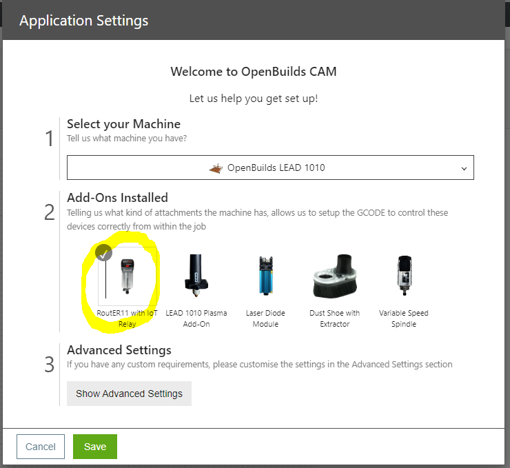

    What about the speed issue I am seeing in jogging it, I just doubled the settings from 500 to 1000 and 1000 to 200 on them? Why is the router head not starting after I have compiled the code in the open builds cad, do I need to add a geode in the compiling, I assumed it added it?

  8. Peter Van Der Walt
    15,139
    4,337
    CAM > Settings tab > Settings button > Tell it you have a Router

    Where do I find the z calibration is it in the grbl side or can it be done in the software side. There is no slipping. So definitely z calibration.
    so use the iot router spec instead the variable? Supprised there isn’t a choice for a fixed speed router. When I set up on that screen is it better to use the true movements I’ve of the bed or use the indicated size of 400mmX400mm?
