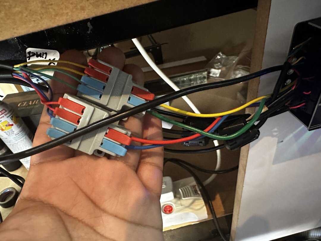

  18. Mohamma393
    Oct 18, 2022
    79
    received BB32 today and restored grble confg backup from my blackbox4 with some changes
    connected Y1&Y2 steppers in Y1driver
    jog X&Z no problem but,
    Y axis vibrating at 3500mm/m(old rapid speed)
    slow down until 1200 then its move smoothly but also not good torque, i stop it by hand with some resistance
    i checked wiring all good, then to connect them on blackbox4, its handle up to 1600/1700mm
    that drop too much around 70% and not strong
    im not sure i mess something or black box cant handle them
    video below

  24. Mohamma393
    Oct 18, 2022
    79
    tried to join motors wires with additional connector
    and insert them directly in BB connector
    2red 2 blue 2 green 2 yellow , same result
    one video 1400mm no problem , another one 1700 stalling
    photos shows how i joined steppers motors (removed limit switches to show you wiring better)
    #24 Mohamma393, Sep 10, 2023

  28. David the swarfer
    3,595
    1,967
    if this is a belt drive machine then you have the motors wired incorrectly, one must be reversed.
    if it is leadscrew driven, then the wiring is ok (if both leadscrews turn the same direction) and your acceleration is probably too high for the current setting.
    and, have you flashed the BB32 with the latest software and the correct version?
    you are wiring the 2 Y motors into one driver as though you are going to use the 4th rotary axis on Y1, therefore you should flash the XYZA firmware, did you?
    if you are not going to use the 4th rotary axis, then flash the XYYZ firmware and use the Y and Y1 outputs for 1 motor each.
    and did you set the current as per the documentation that Peter linked to ? without enough current the motors will stall and sound just like your video. once the current is adjusted you can change the acceleration and max speed settings to suite the machine.

  29. Mohamma393
    Oct 18, 2022
    79
    its ballscrew same as lead screw
    I increased current little but red led show up
    Will check acceleration which always 350 for year no problem
  30. Peter Van Der Walt
    15,641
    4,467
    Is the motors ours? 3rd party might have incorrect specs (resistance for example) that causes issues in parallel where ours don't
