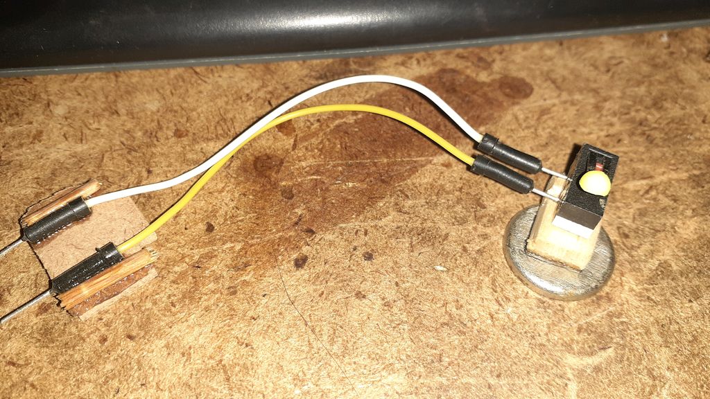

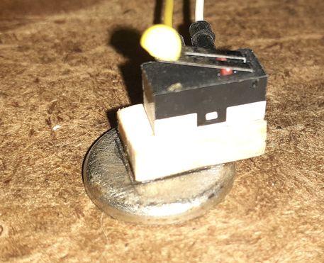

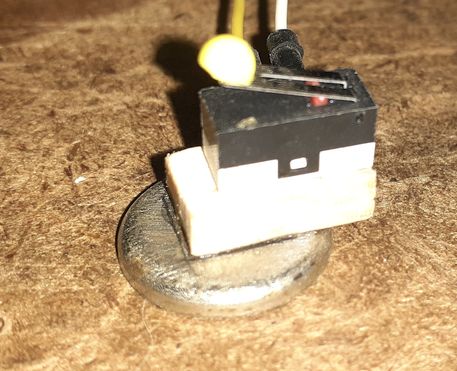

    for non conductive materials you can use a microswitch. This is my one, just a microswitch glued to a magnet (the silver disk) so I can stick it to the face of the collet.
    The yellow half ball is an airsoft pellet filed to about halfway. this make positioning of the probe a bit less critical since an ~equal radius from the switch lever is maintained as the lever moves.
    It could be built better, I threw this together to see if it would work, it does.
    Note that this connects to an optocoupler that feeds the controller. github.com/gnea/grbl under the limit switch section describes the why and how. Or you can use a 2K2 pullup resistor to the control pin and connect the switch between the pin and ground. Probably ok unless your VFD spindle is running.
