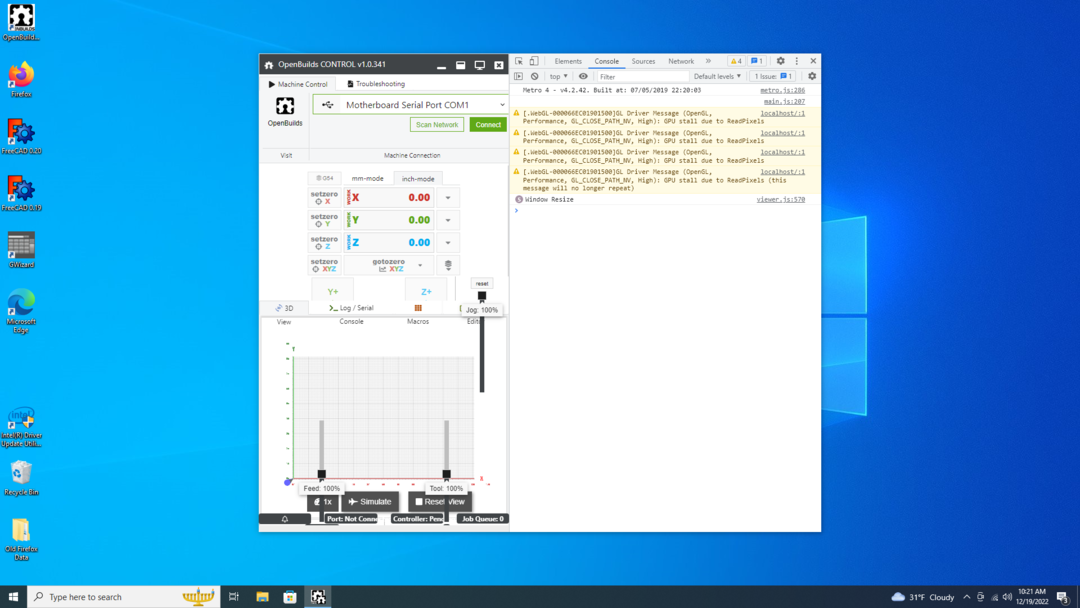

    Here is the screenshot from devtools/console, I finally got it to open... Screenshot (10).png

  23. Peter Van Der Walt
    15,648
    4,474
    No errors in there, but keep an eye on it when you experience issues. In the same screenshot we see a list of ports so the "problem" was not preset... we want to see the console when its showing Waiting in case theres any errors there
    Pretty normal, as the computer runs port scans, it triggers the DTR pin of the serial port, causing controller to reset.
    Better USB cable still a good call for other EMI related potential issues. Filter (ferrite clip) alone won't make much difference to initial connection but will protect against high frequency noise
    That's a bad idea though, throw a Earth cable down the hose please - when the charges build up in the hose, order of several kilovolt, guess what happens when it discharges into nearby wiring, making its way down the line and possibly frying a computer USB port or USB chipset? If you see what I am thinking - unearthed Dust hose causes high voltage discharge spikes into your electronics. At best causing a disconnect, at worst already caused damage to your Computer causing intermittent symptoms (not unlikely)
    The "bump" is when the OS scan/opens the ports - triggering DTR (Data Terminal Ready) causing Grbl to reset. Pretty expected. Number of bumps is not really a clue to anything, but you'd have to watch the OSs USB stack closer to see if the bad cable had trouble enumerating causing multiple attempts.
