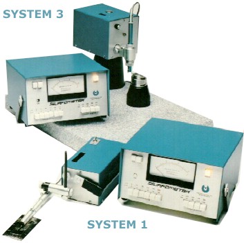

    Hello all! I'm new to the BlackBox Community. I recently purchased a BlackBox in the hopes I can convert a CMM that died here in my shop into a Job specific Surfometer (probe that runs across the surface of a machined part for a "Finished surface" readout). So far I have my BlackBox hooked up, running properly on a test bed. However, I am now running into an issue that I'm hoping someone might have the answer for. I ran a simple Gcode Text file and placed in an OpStop or pause command (M0). I would like to wire an external input device or button for a resume program command tied to a mcode or gcode. Is this possible? I do not see any information regarding external inputs in the DOCS, nor have I come across exactly what I'm looking for in the Forums.
    TL;DR Looking for a way to Resume Program using an external input tied to an Mcode to continue running my program after an M0 pause command.
    Thank you in advance!

    I'm not looking so much to store and data. I want to restart the program using an external I/O device tied to an Mcode, or Gcode. The type of read out the Surfometer gives is very different than a normal digital indicator. The device runs a small brass needle using a small motor across a 0.01" space and gives an analog reading of the surface's micro. We use it to check feed lines after machining to hit specific tolerances.
    I would like to write my Gcode program to OpStop at a specific location. Then a team member will turn on surfometer, then after it is finished with its first reading, press a button which continues with the part program to the next location. I'm trying to make this gauge as user friendly and as simple as I possibly can.
  4. LyonCAD
    LyonCAD New
    Jan 17, 2023
    This is the type of device we are using to measure the surface micro.
