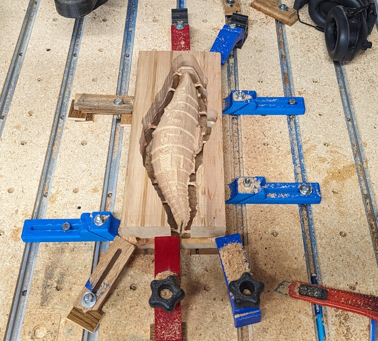

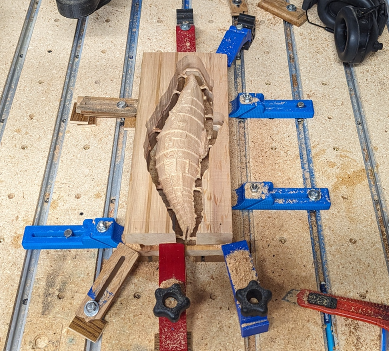

    I have a 3D printed version that work great. However, I used 1/4-20 bolts to make them compatible with my t-slot. I also have a grid of 1/4-20 inserts that I use to make corresponding grids on jigs that I fasten to my spoil board. I do not mount them in V-slot. But I bet you could modify them. Here is a photo of what I am using. Sadly, I spent about two hours looking on thingiverse.com and other sites trying to find the stl file and could not. I printed them about two years ago. I have all my bolts pointing down and either fastening to an insert or a t slot nut. I have two sizes but use the longest ones the most because between the inserts and the t-slot, I can reach anywhere. I do not have a picture handy of the smaller ones. If interested, I could take one.
    What I like about these clamps is they put both side and down pressure on the stock piece.

    I use custom hold downs that I made. See photo. These are walnut, about 3/8” thick. Use them with 1/4-20 nylon bolts into threaded inserts.
    I also use some home-made cam clamps when I need to clamp from the side.
    It all works great.
    Let me know if you want more info. Happy to share.

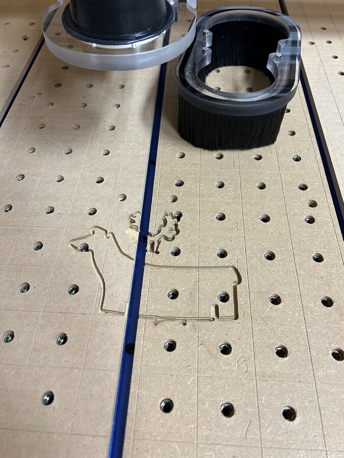

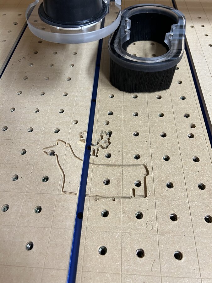

    I drew up the CNC base including spoilboard in Fusion360.
    The LEAD machine uses v-slot for the base, so I got some 30mm long t-bolts to fit those slots and bolted some screwing blocks to the sides of the base extrusions.
    Then I screwed a single big piece of 1/2” MDF to those screw strips from the top. That way, I should never have to lift the machine to replace that board. I installed t-track about every 5” or so on top of the 1/2”MDF. Then I put strips of 3/4”MDF between the t-tracks. I screwed that down with drywall screws, countersunk by about 7mm.
    Then I drew up the spoil board in VCarve Pro, so I could lay out all the holes for threaded inserts, avoiding the drywall screws and t-track. I ran a job to pocket out the holes for threaded inserts. Then I screwed in EZ-Lok threaded inserts, 1/4”-20. Be sure to use the coarse threaded ones in MDF, got em on AMZ. My grid lines and threaded insert holes are all on 40mm centers.
    Altogether, there are about 600 threaded insert holes in my design. I only pocketed and installed threaded inserts in some of them for now, where I’m most likely to need them. With the design saved in VCarve, I can pocket and thread additional ones as needed, easy as pie. Also, having the design in VCarve allows me to make fixtures with bolt holes that perfectly fit the spoil board.
    If I were doing it over, I would leave out the t-track and the 1/2" MDF. I'd go with a single piece of 3/4" MDF with threaded inserts. That would gain me 1/2" of z-axis clearance. And now that I'm using the machine, I don't think I'll need the t-track.
    I’ll try to add some pics of the build process so you can see the guts of it.

    Gee…I wonder who was milling up some slot-together reindeer when they didn’t get the Z zeroed out correctly?
    Hahaha.
